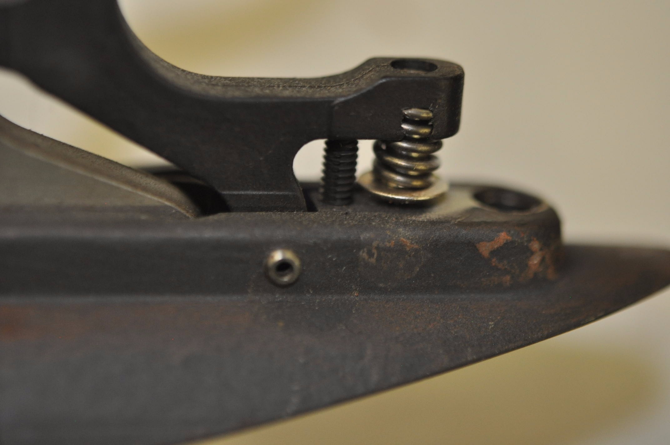

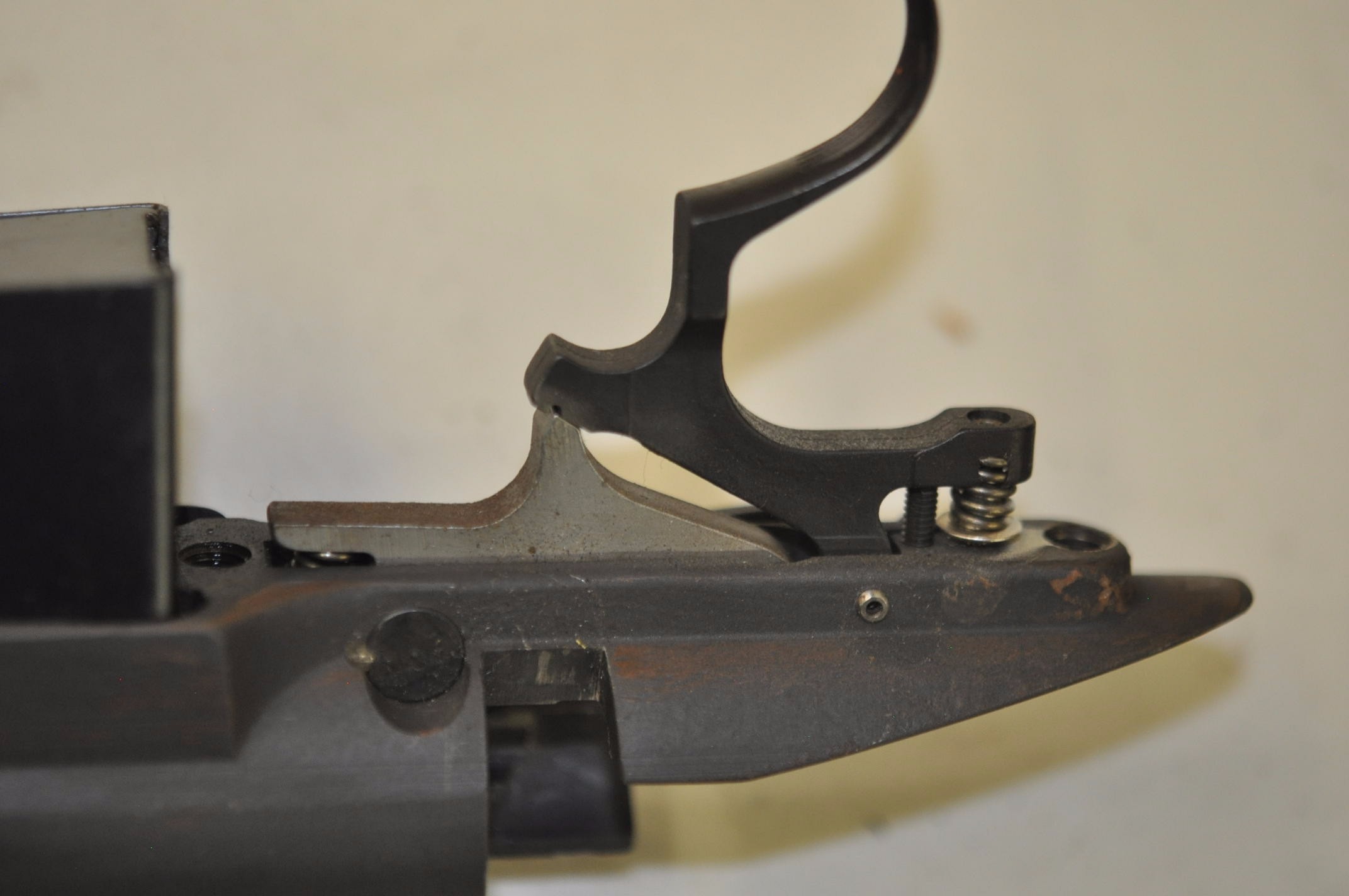

I am looking for more information on the Palma match trigger and gun it’s self.  My serial number dates 1975.  Hoping i can find the parts to make it work like it was origional before I go to a aftermarket trigger.  I would like pictures of how the trigger group is installed in the action also. It looks like to add a factory model 70 trigger the underside of the Palma action will have to be milled out under where the 2 Allen screws are. So the trigger spring and sear adjustment bolt fit right.

Carl, Here is a picture of the Palma trigger group. It is basically a modified standard trigger. I hope this helps. There was a recent post in the last few weeks concerning these rifles and a brief history was included. The 1968 Palma did not use this trigger, just the 1971 and ’76 models.
Hope this helps.
Steve

Thank you very much for the pictures. I hope I can find something to make it work.  Or if anyone knows of where I can find one to buy please let me know.   Thanks Carl

Carl, Good luck with your search. I have never seen one of these triggers for sale apart from the rifle. I think your best bet might be to try to make one by modifying a factory piece.
Steve
