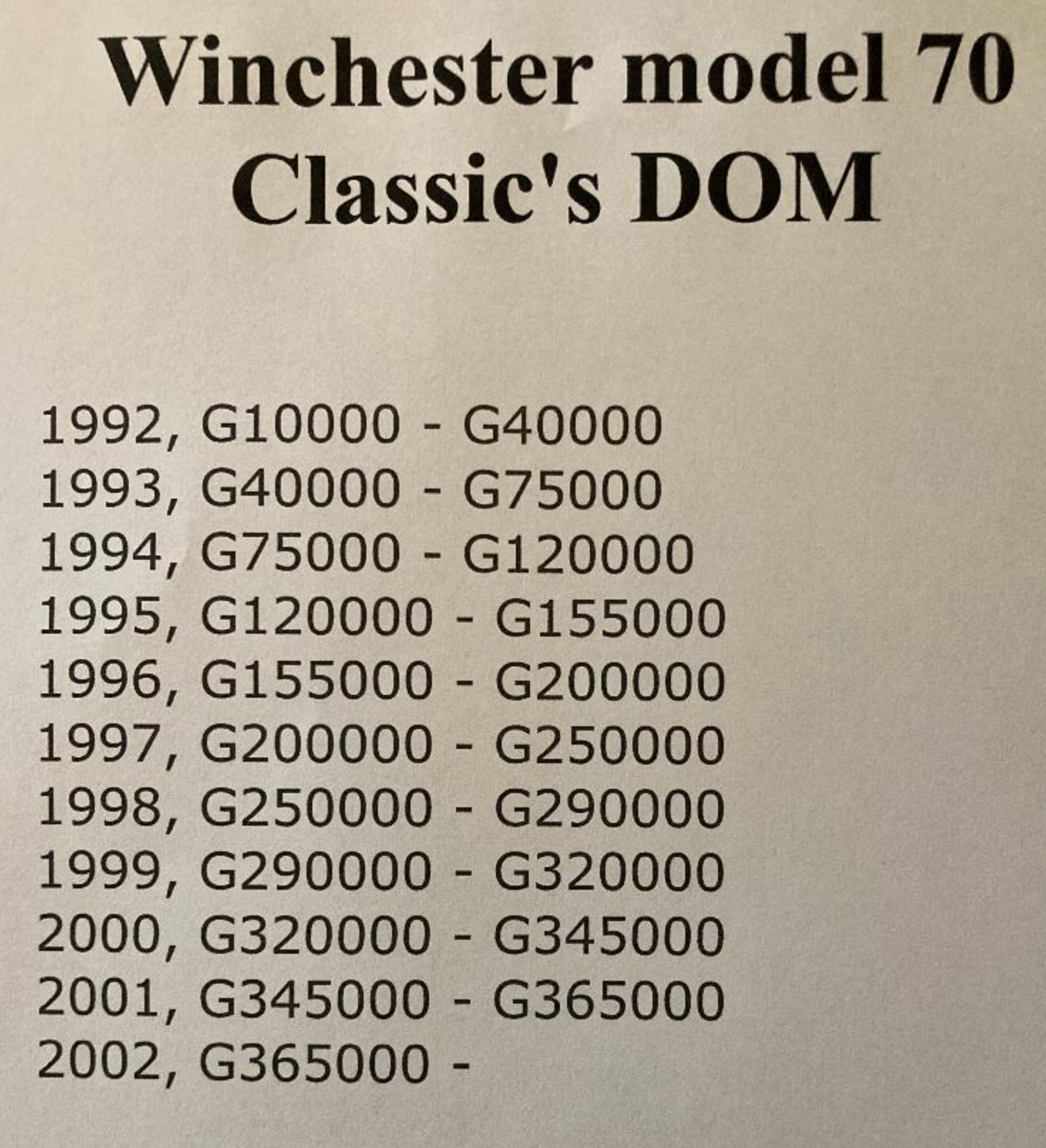

The (very approximate) 1992-2002 S/N ranges for regular production M70 Classics (CRF action) has been posted on the 24hr Campfire, where some contributors have an interest in these post-1992 rifles.  I believe this is observational data, not based on factory records, but it’s perhaps better than nothing.

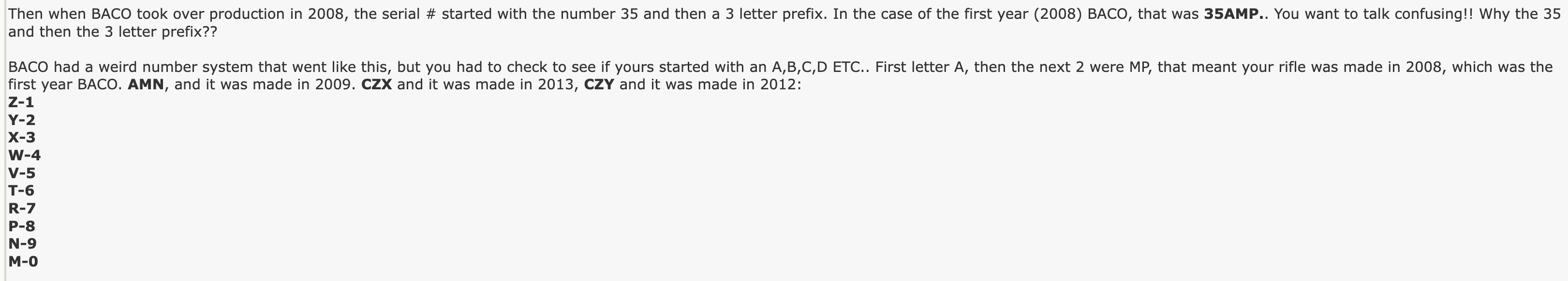

As for the FN/BACO M70s made in SC and later, they can be dated if you can read the “code” in the serial number.  These are the rifles for which the current “Winchesterguns” (Browning) can/will provide DOM information to callers.  This is a clip from a 24 hr Campfire post.

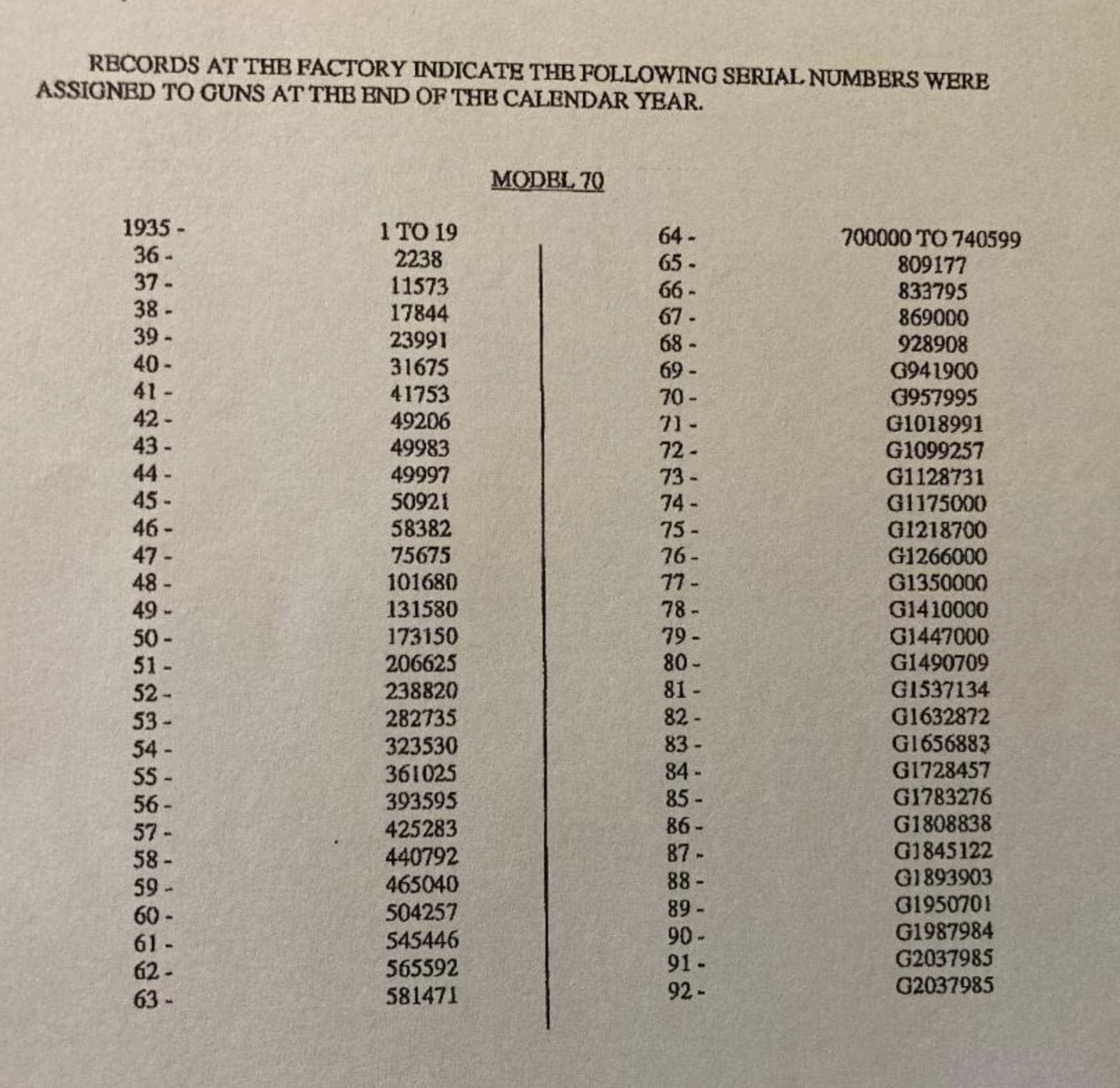

We know that the Madis table is rife with inaccuracies (at least for the 1935 – 1963 time period). That fact causes me to doubt the validity of the 1964 – 1992 part of the table. However, and due to the lack of a better (verified) source of information, I suppose that it could be used to update the WACA Resource Tool look-up tables.
I used the DOM information that Roger Rule published in his book to create my spreadsheet tables (that were inserted into the Resource look-up tool).
For those that do not have a copy of Rule’s book, the information below is the Excel spreadsheet table I created.
For any WACA member that would like a digital copy of my Excel table, send a PM with your email address or send an email to me.

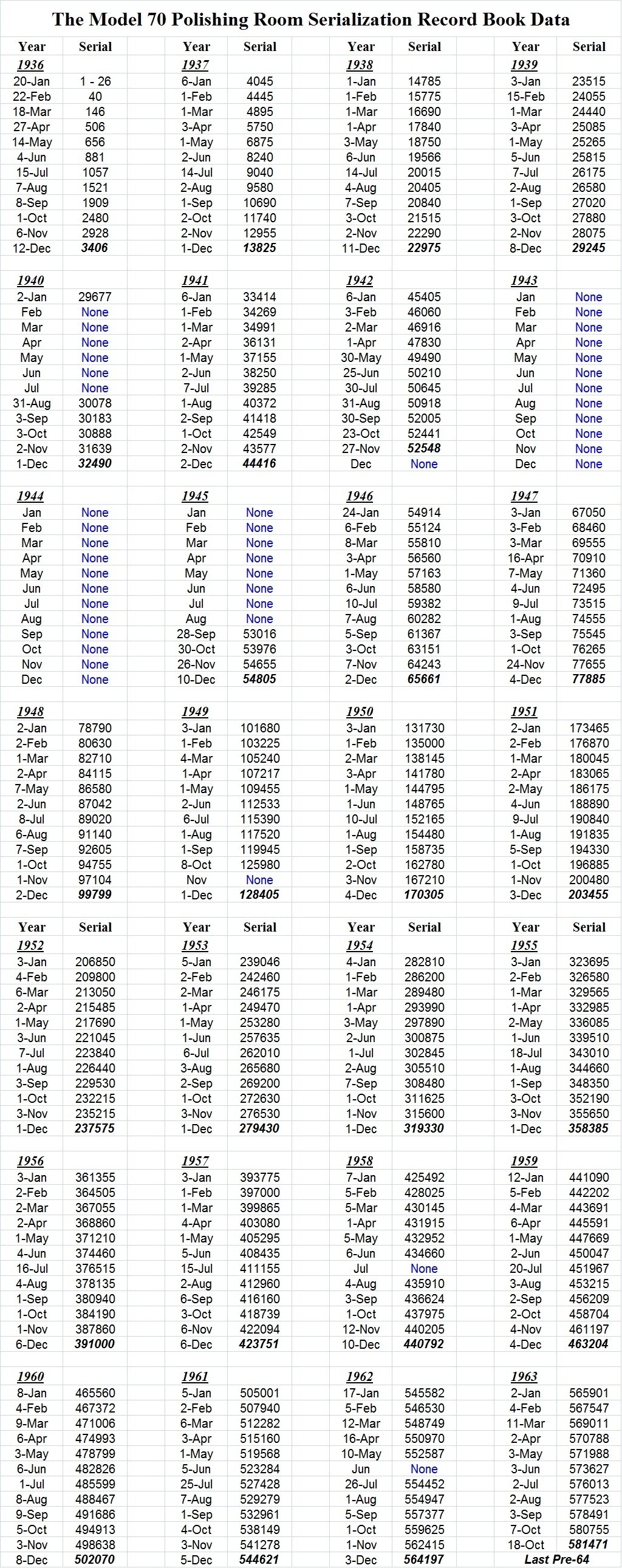

If you want to send me your Excel copy I’d like to have it. Would save me a lot of typing (and the attendant errors I’d no doubt introduce). You know my e-mail.  Those (1936-1963) numbers in Rule are supposed to be derived from daily PR logs that he had access to.  They are not in Cody, but Pauline has some (or all) of them.
The stuff I put above pertaining to USRACo production of M70s is not verified/verifiable insofar as I know.  I only included it b/c I haven’t found anything else to use when answering post-63 M70 questions, and I always tell the person asking that post-63 DOM dates are “approximate”.  What, for example, did Madis use as a source for 1964-1992?  PR logs or “annual production” figures? Or worse, some combination of sources?
PR logs (SNA date) are accurate b/c receivers were numbered sequentially, e.g. s/n 100 preceded s/n 101, etc.  But “annual production” figures, even if accurate, have no clear relationship to serial number b/c receivers were not used to assemble rifles in S/N order.  For example, Rule also (quoting Madis) has a table (Table 2-2 “Annual Serial Numbers for Model 70 Rifles – Total Production”) where he states SERIAL NUMBERS 1-2238 are from 1936, 2239-11573 are from 1937, etc.  This CANNOT be accurate. Even if we know (from PR logs) that exactly (3406) M70 receivers were serialized in 1936, and IF the M70 production total for 1936 was (2238) as Madis stated and Rule copied, that doesn’t mean that receivers 1 through 2238 (of the 3406 available) were the ones used that year.

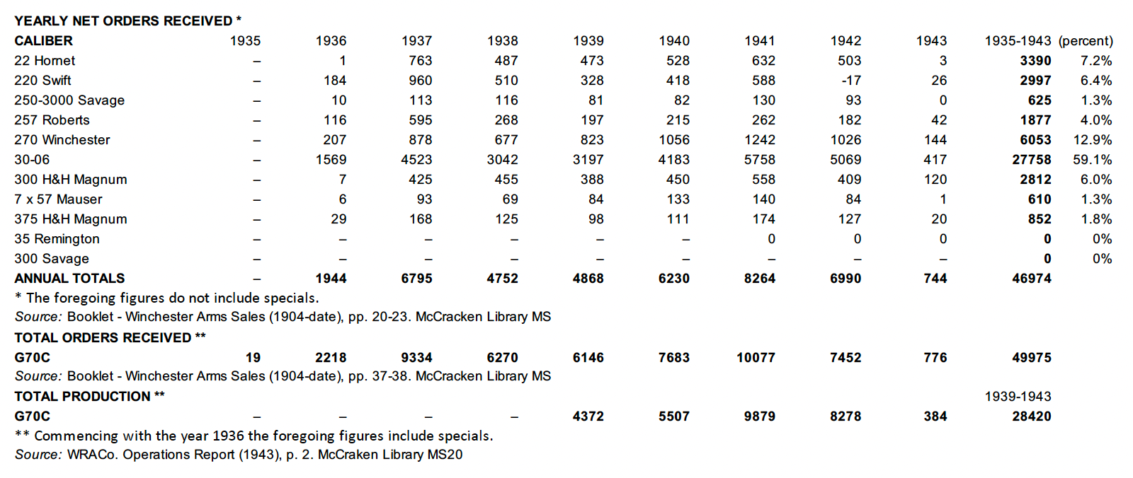

Here’s something that will cause confusion… For a handful of pre-war years, the McCracken Library has copies of summative reports on M70 production (either by Model or by Model/Caliber – NOT by Style).  Some are “Net Orders Received” by Model or Caliber, some are “Total Production”, some include “Specials”, some do not.  All are actual factory documents prepared in-house and for 1939-1943 all three reports are present.
Staring at this table I put together will cause vertigo… But the bottom line is that none of the numbers agree, if for no other reason than because they are reporting on DIFFERENT things.  Orders ≠ Production ≠ Shipments, etc.
