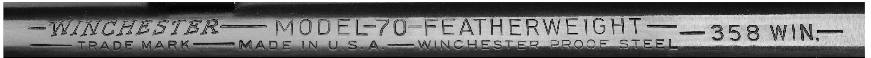

FWIW… This is an example of a correct looking 358 WIN barrel roll mark.
