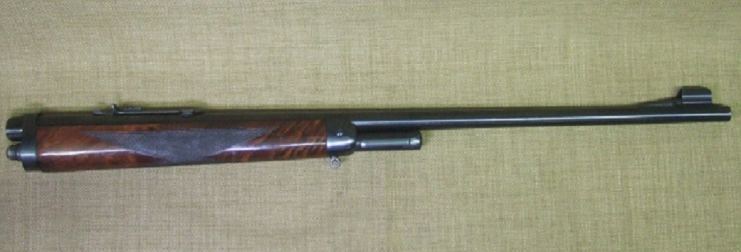

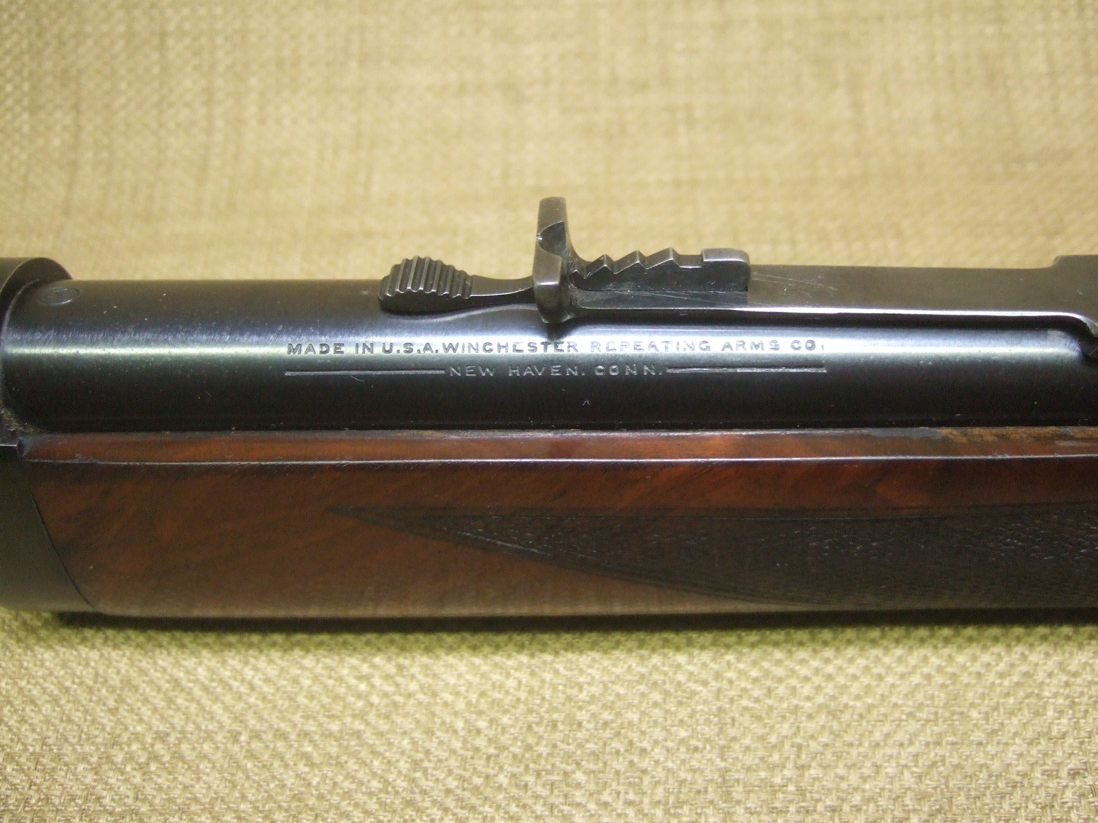

Many years ago my dad came into the front end of a TD that fits that description.  The barrel was stamped on the underside with a “49”, assumed to be 1949.
I have no opinion either way, but here are some pics to mull over.
1949-barrel-TD-assembly-2.JPG1949-barrel-TD-assembly-3.JPG1949-barrel-TD-assembly-4.JPG1949-barrel-TD-assembly-1.JPG

I’ve got one too, 64 front end on a 94, about 98% gun, 9 stamped over 6, under barrel date is 47 or 49, it’s been years since I’ve looked. If I were a betting man, my money would be on it left the factory that way.
Mine is a solid frame

I can understand someone switching out a Model 64 barrel on a standard frame rifle and then changing the model markings from a 64 to 94, but why would you go through the trouble to do it?
Dont mean to be argumentative but based on its merits, at least for the example I posted pics is of a TD assembly that would have required additionally threading to accommodate the TD ring in addition to milling of the existing barrel threads to accept the receiver.  Also note the placement of the barrel markings and proof on the example provided, they look to be in the right place and not cut off or too close to the TD ring.  Am assuming too that Mike’s is a TD as well.   I dont have the TD assembly anymore to look at again but I see no indications the barrel has been reblued or to suggest its not original.  At that time I showed it to a number of collectors who also had no problems with believing it was made that way at the factory.   Still on the fence because I cant answer the question of why.

As I stated earlier mine is a solid frame.  The overstamp is nearly identical to the one pictured above.  Again about a 98% gun, don’t think any of the screws have been turned on this rife since it left the factory.
Picked it up at an estate sale about 30 years ago.
