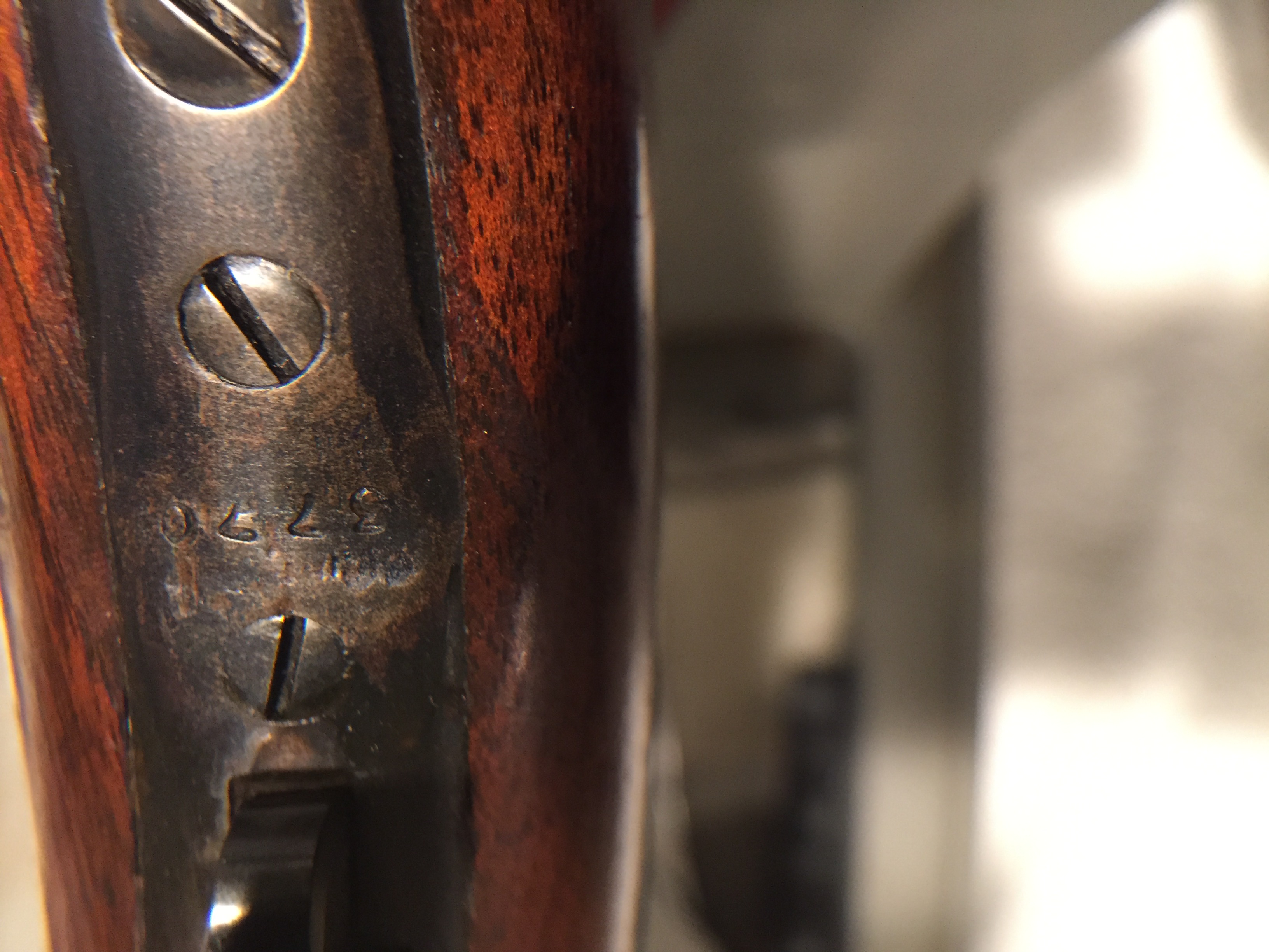

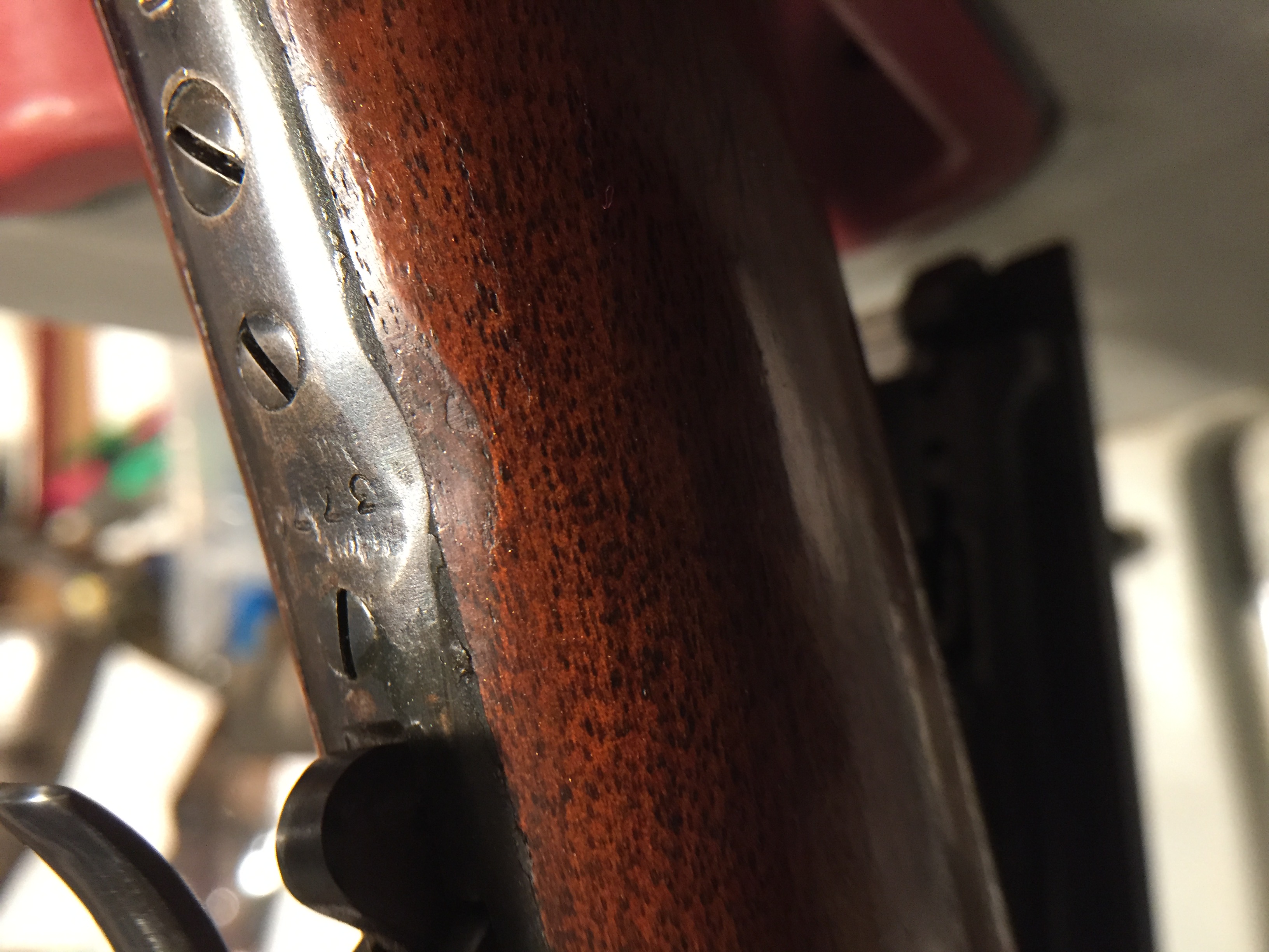

I want to thank everyone, especially Mark and Bert, who participated. I have attached pictures of the serial number area on the tang. It looks pretty obvious to me that it has been altered. Of course the seller did not show this area on the photos he posted on Gunbroker. And, he has not replied to my emails that I sent him as soon as I opened the shipping carton.IMG_0169.JPGIMG_0170.JPG

Thanks for posting the picture.  There is no doubt that the serial number has been altered and whoever did it made a complete mess of it.  They ground so deep that they got into the wood.  The font on the numbers is completely different than the very square stamps Winchester used on 1895’s.  After seeing the pictures, my guess is that it was stolen by Bubba at some point in its history and he ground out the serial number, then just picked one at random to replace it.  The seller should absolutely have disclosed this issue and refund your money.
