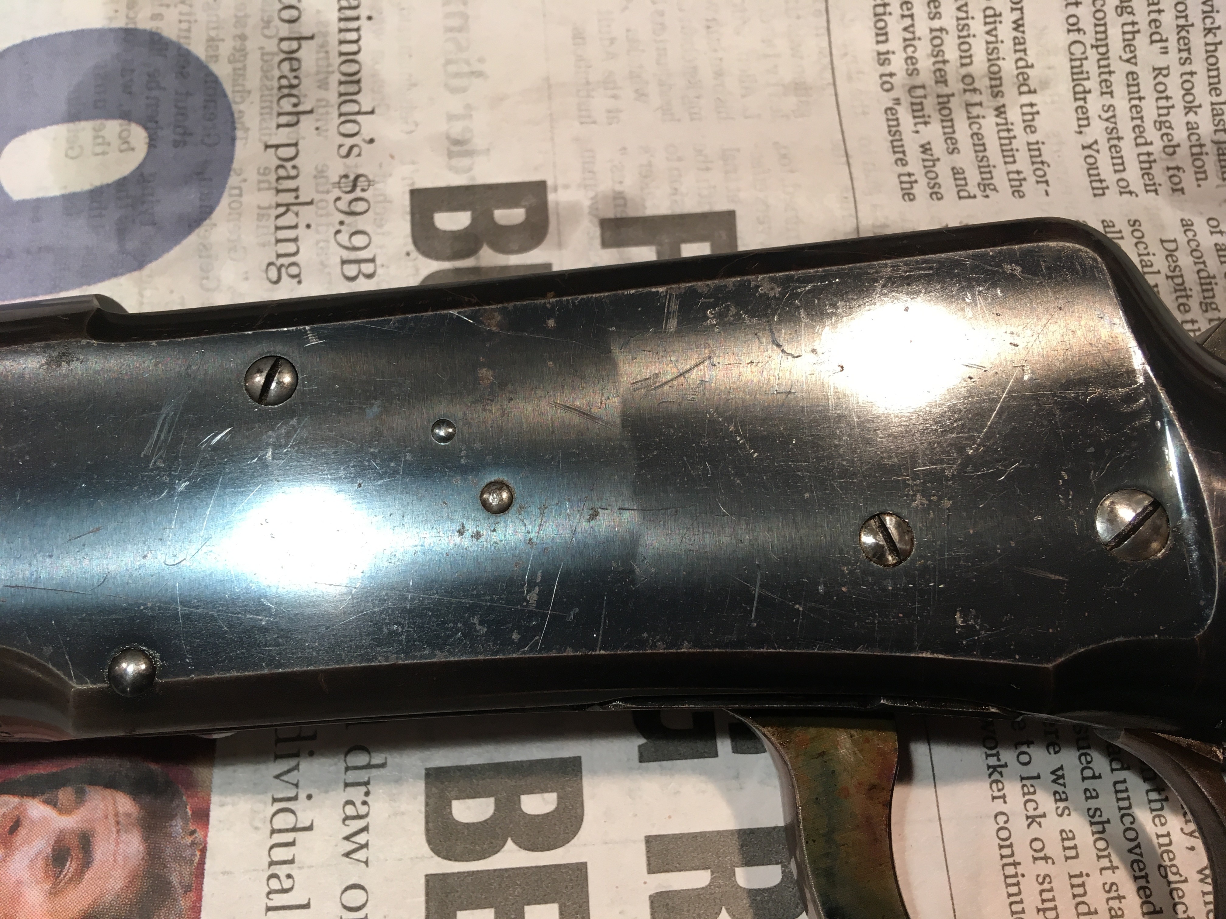

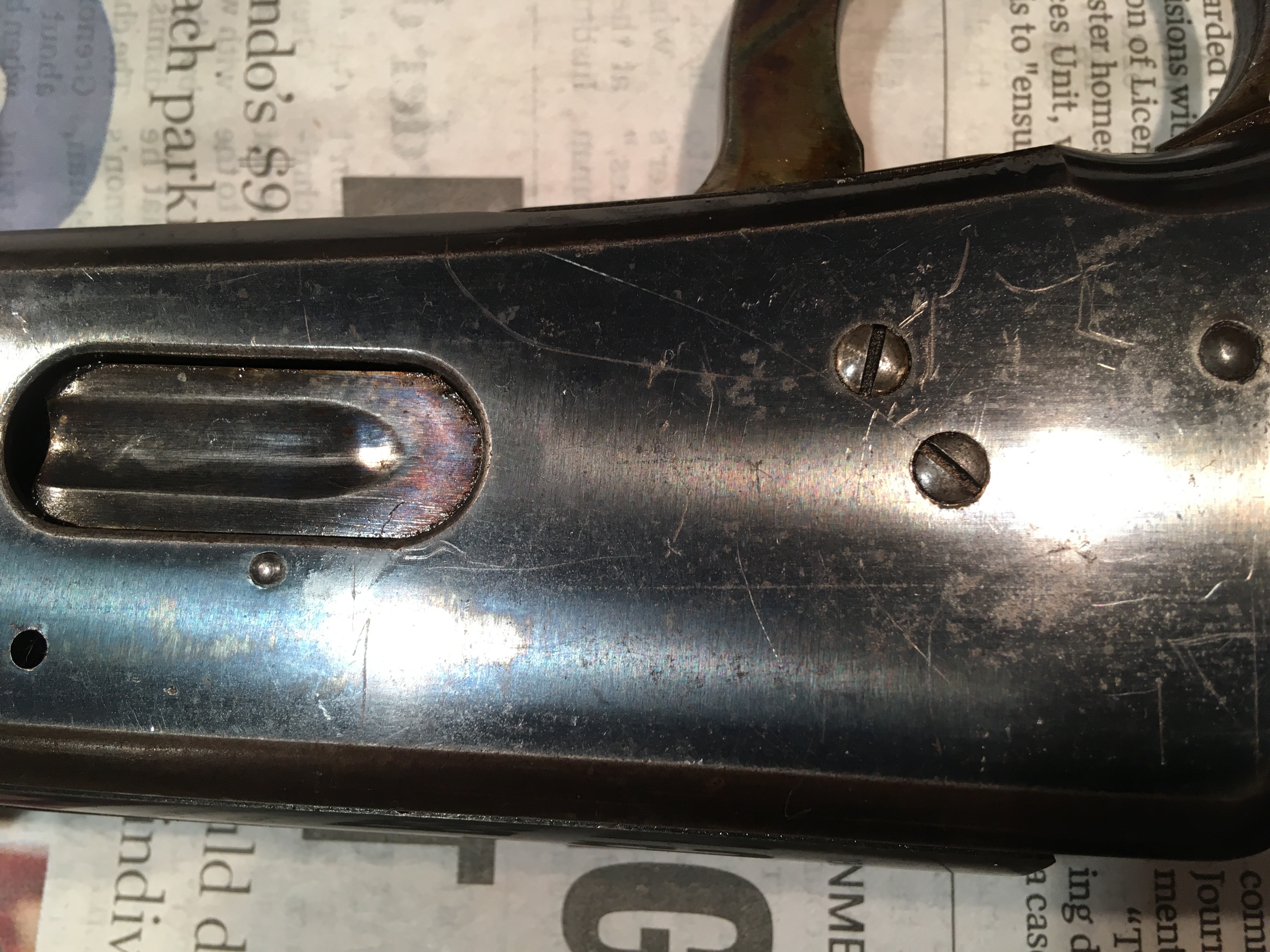

I just purchased a Winchester Model 1894 through Gun Broker. It was described as “untouched” form an Estate. However as I inspected it I noticed a distinct line running through the bluing on the receiver. More clearly on one side and less clearly on the loading gate side. I have attached pictures.
Anybody have an explanation for this, or have seen this before?[Image Can Not Be Found]IMG_1333.JPGIMG_1334.JPG

Those look like factory polishing marks to me.  A good thing when determining originality of the bluing on a receiver.

 Richard, The color and finish looks good and original, nice gun from the little bit I can see. I think when the factory buffed the receiver they went two different directions. On colt SAA’s they do that around the front sight, they call it feathering. I’m sure a 94 collector can shed some light on the subject. T/R

Actually they buffed the receiver in 4 directions.  Some years ago I had the chance to look at the finest gun that I have ever seen. Each side of the receiver had 4 distinct squares where it was polished in alternating horizontal and vertical directions showing the buff marks.

Agree with all the above…I have two rifles with the same marks…factory polishing marks. Now you can be sure that it was not reblued or it would not have those marks.
