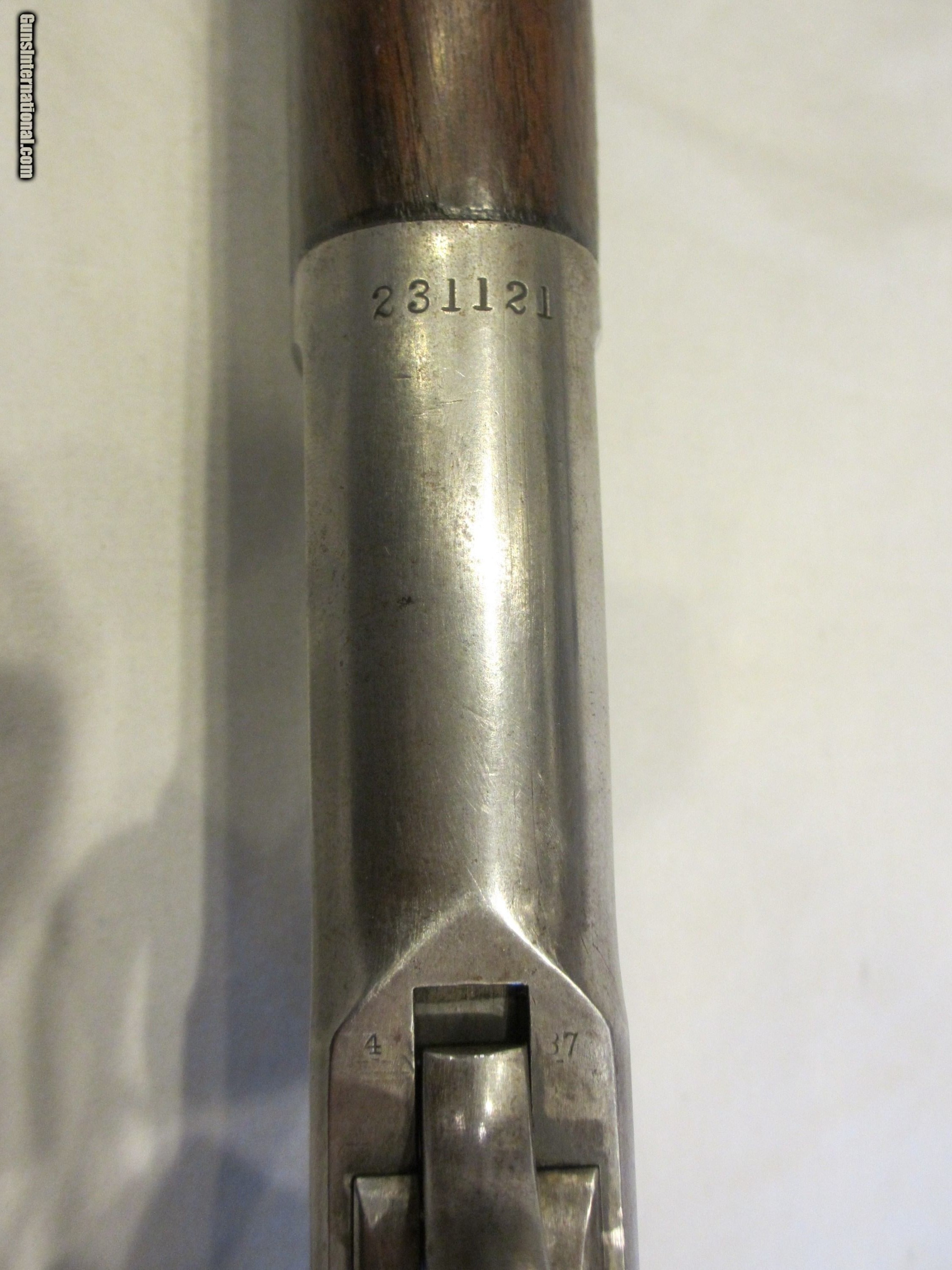

I have an interesting 1892 Winchester carbine in .44-40. .  It has deluxe wood( xxx) and Winchester sling swivel studs. Condition is 90 % +. I have not consulted  the Cody museum. What puzzle’s me is the serial number. It starts with the letter “L”. From what I can find in all literature, there was never a letter used in the serialization of this model of Winchester. However, from my experience this is an original Winchester from New Haven Connecticut. I would love to upload photos but I have problems with file formats as such. Before I waste time doing so, am I wasting time?

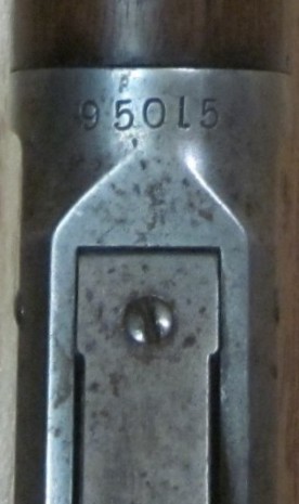

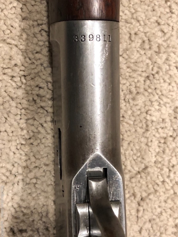

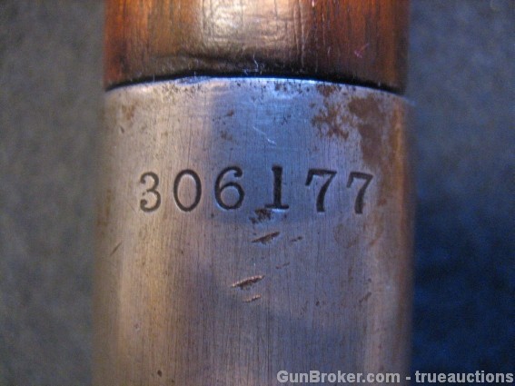

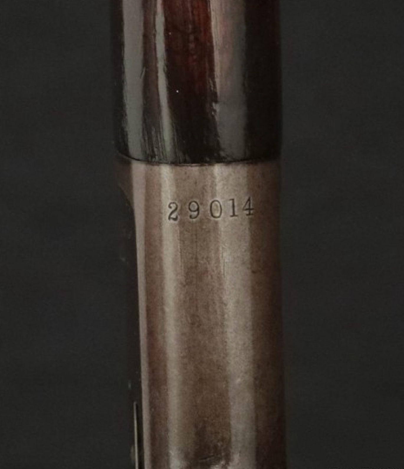

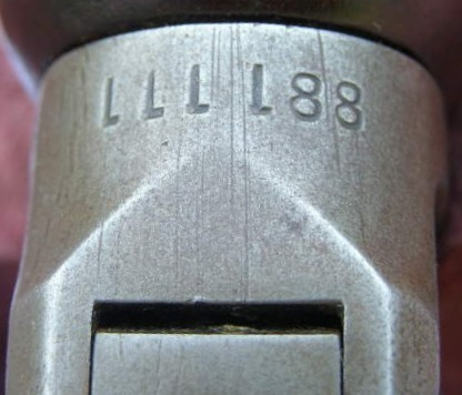

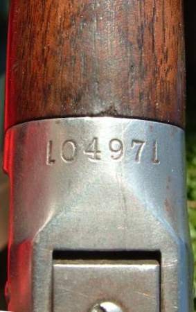

Brent,

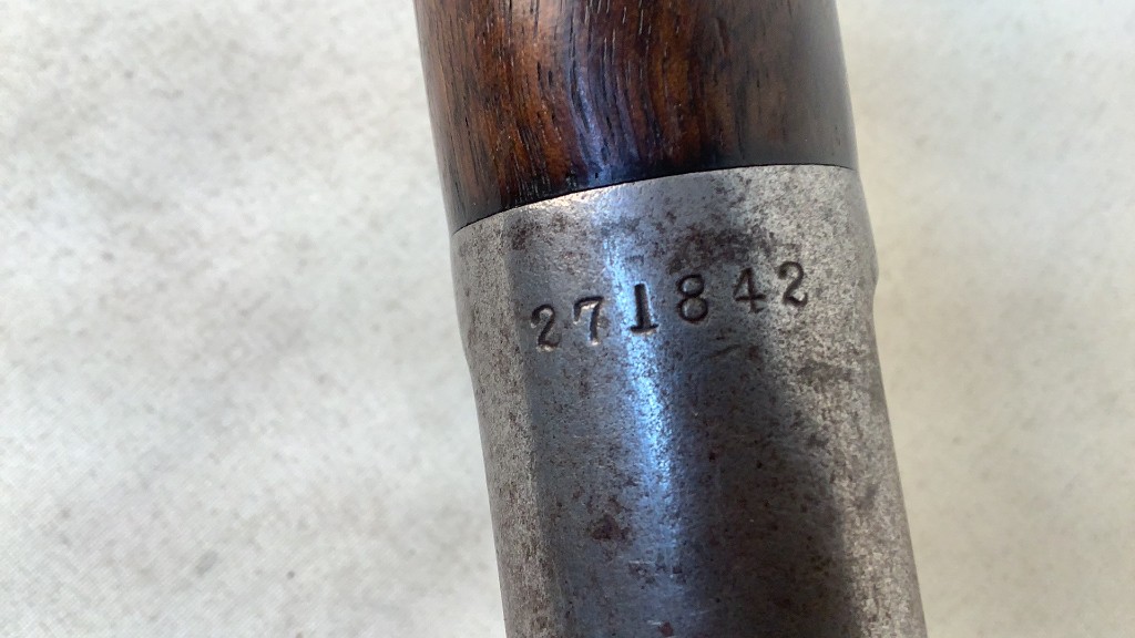

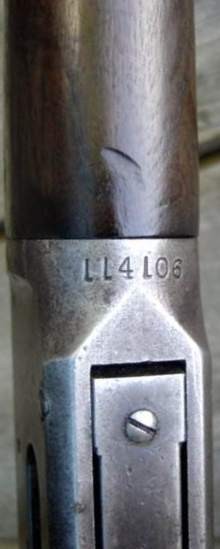

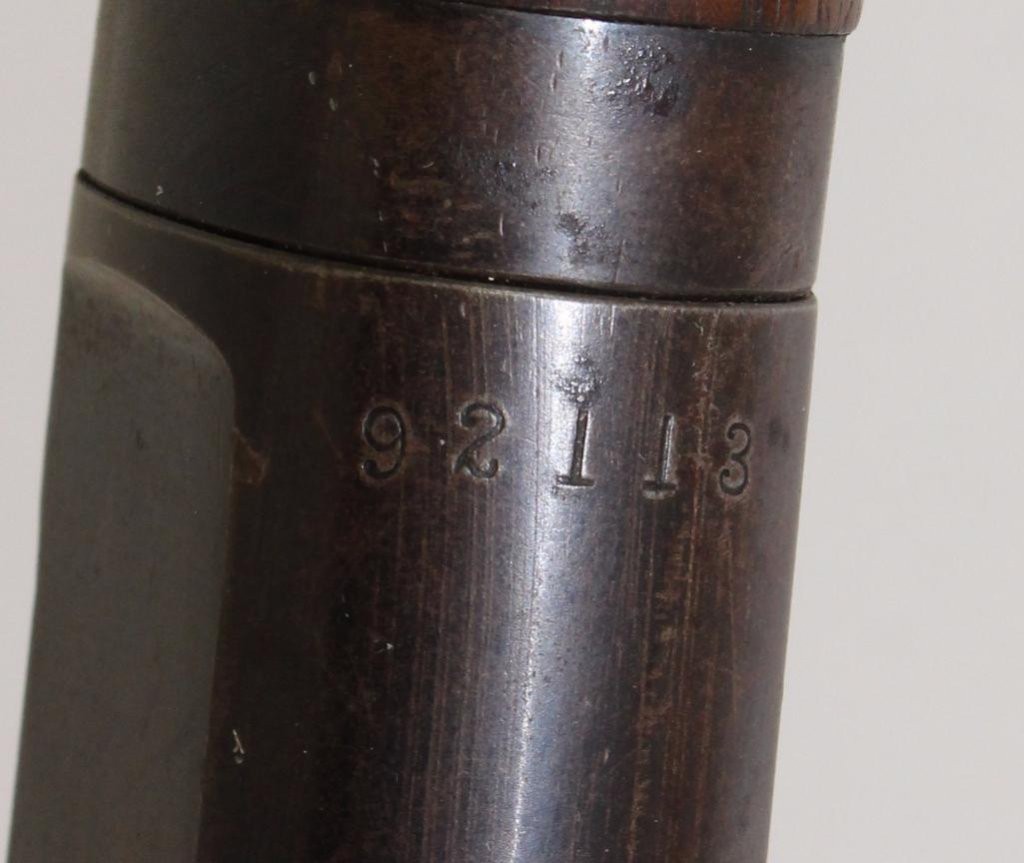

The leading digit is actually a poorly made “1” versus an “L”.  It is found on the late 5-digit (90000+) and very early 6-digit serial number on the Models 1892, 1894 and 1897.
Here are several examples;
Forum Posts: 2765
May 31, 2026 - 11:17 am
Hello Brent,
If you will email the images to me I can deal with the format issue and post them for you.  [email protected]

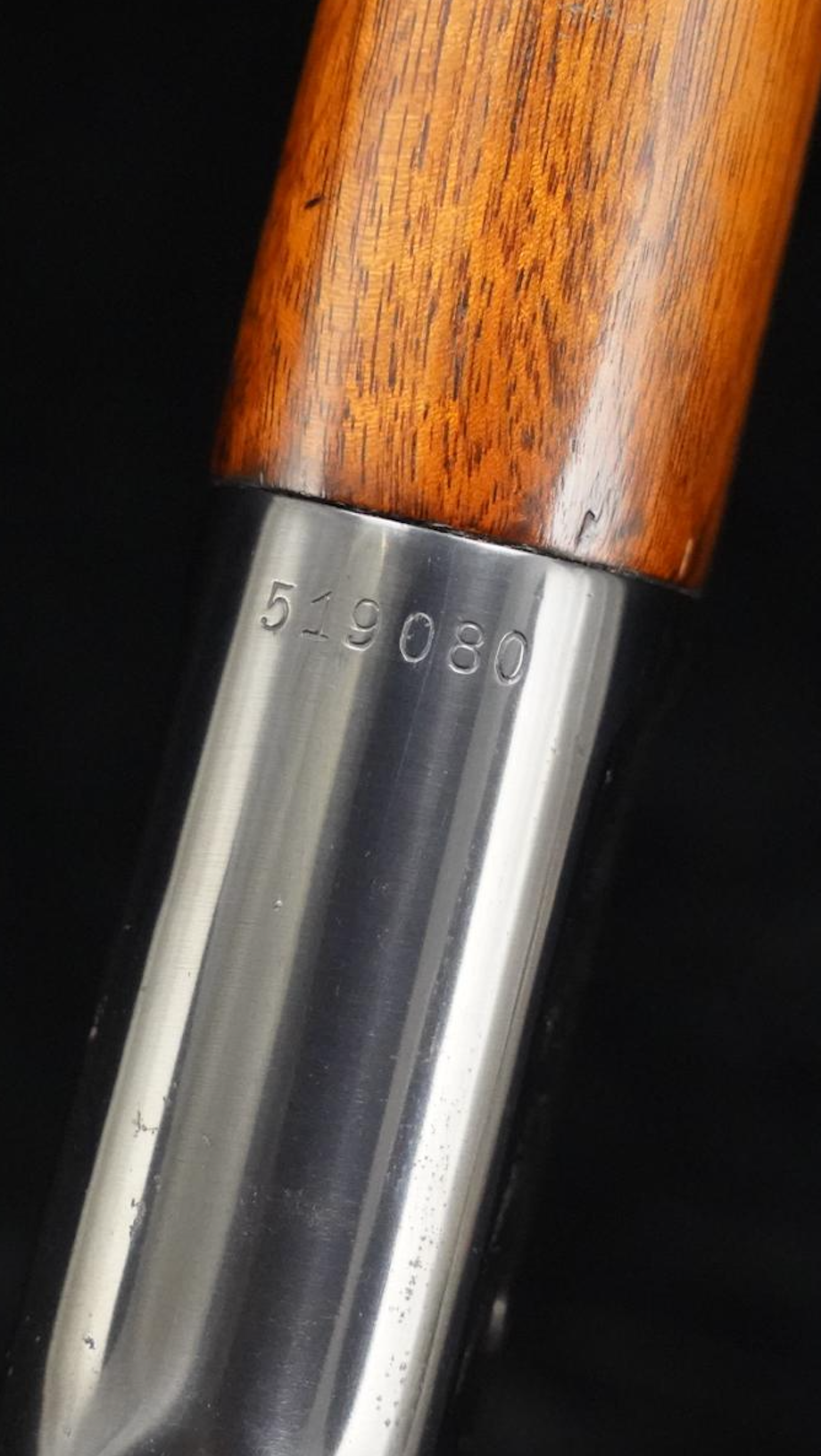

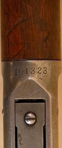

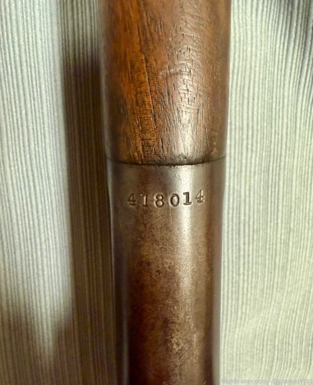

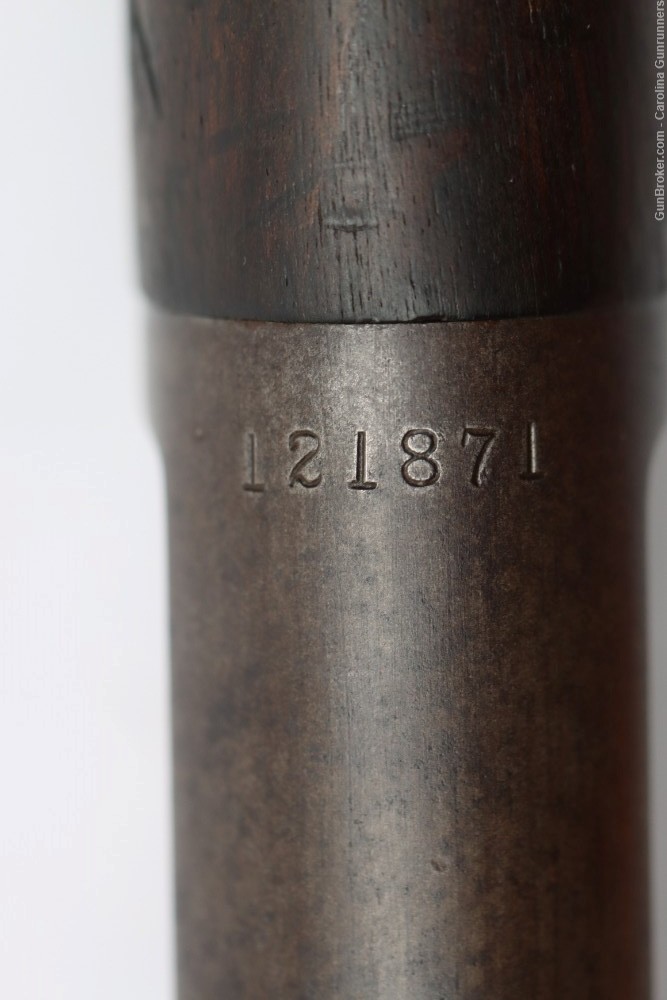

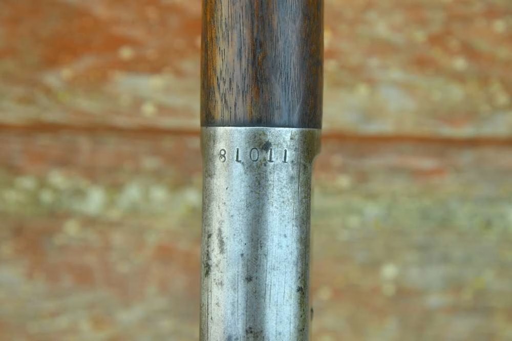

The changing morphology of the ones digit used in serial numbers within the Model 1892 sequence is a bit interesting.  Early rifles had a one with a clearly defined upper serif and that style is typical until about the 70000 range when the upper serif disappears and the bottom serif alternates from being on each side of the vertical thus producing a one which looks like and inverted “T” or the bottom serif is only found on the right side resulting in the one resembling an “L”.  This usage is consistent all throughout the 100000 serial number range and continues well into the early 300000 range with the “T” version the most common.  Finally, in the mid 300000’s does the upper serif begin to be slightly present again.  By the early 400000 range the horizontal upper serif is quite strongly pronounced and visible.  By the early 500000 serial number series the upper serif is changed again to a more common presentation and angled downward to the left.
Screenshot-2026-05-31-at-7.13.28 AM.pngpix810389490.jpgScreenshot-2026-05-31-at-6.54.24 AM.pngpix568964538.jpgpix754020419.jpgIMG_4014.jpegWinchester-Model-1892-in-44-40-Win_102980657_103796_0AE23F6FAA864D52.jpeg1150-4.jpgpix947583052.jpgpix179925458.jpeg
