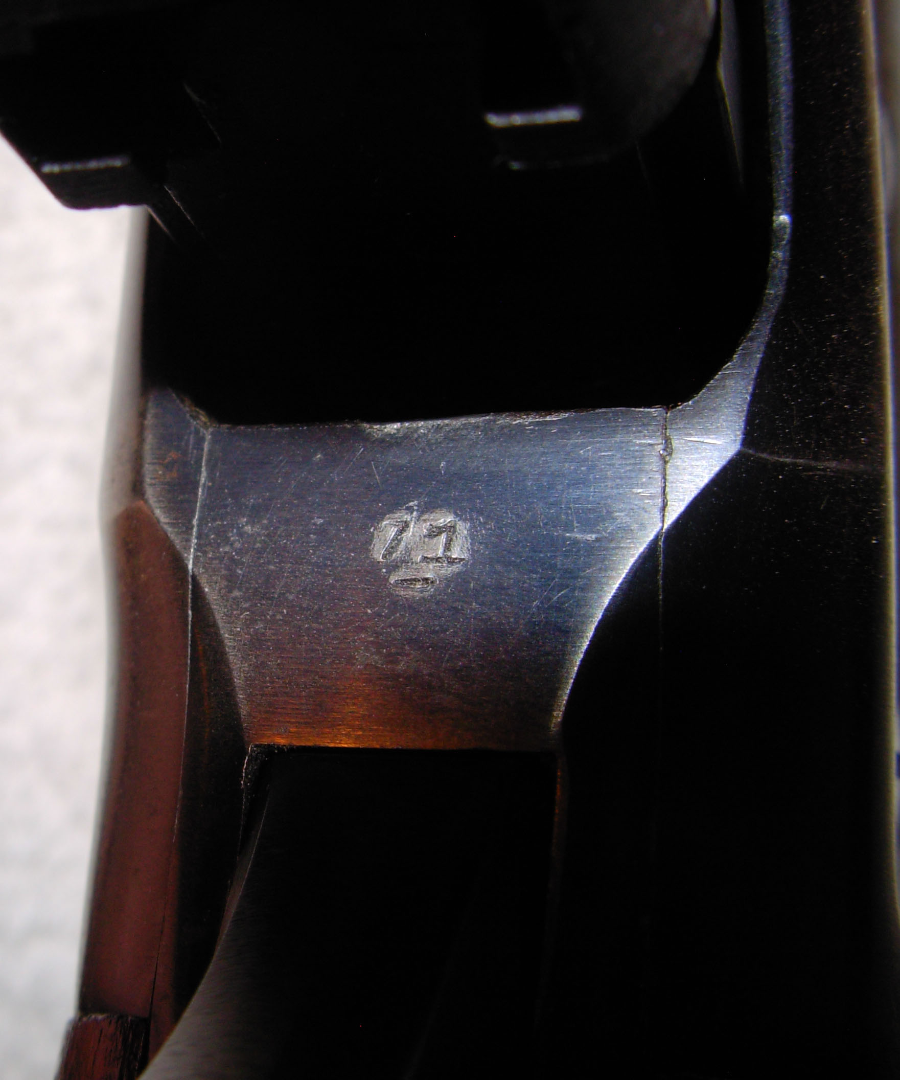

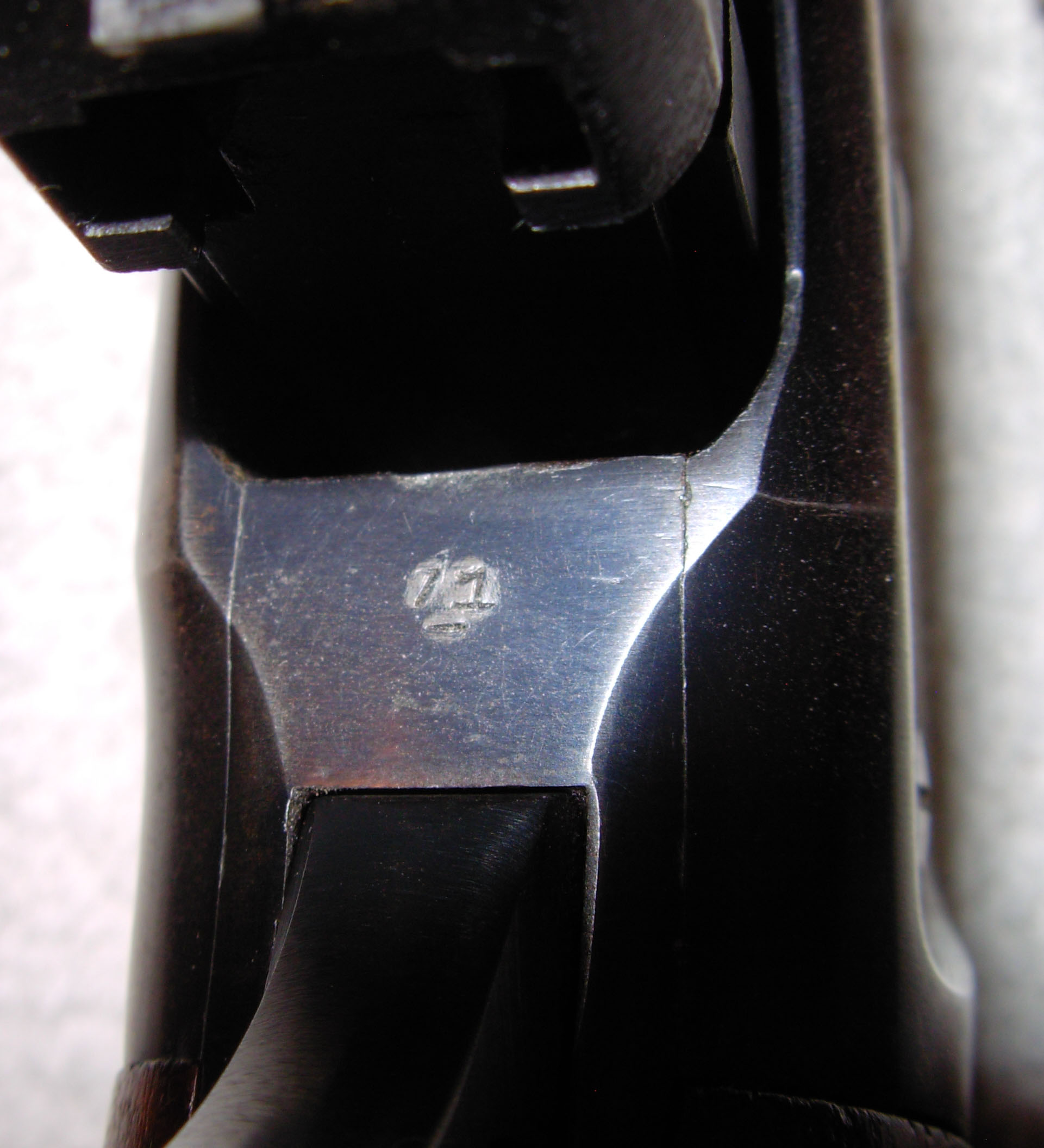

Mike:
Could this be a sample of the inspector’s mark you refer to?
This is directly in front of the trigger.  It is on an 1923 rifle, TD, 32 WS.
Forum Posts: 14956
September 13, 2016 - 3:53 am
That is an inspector’s stamp, but it was not for the purpose of checking the bluing. Winchester inspectors stamped hundreds of different combinations of numerals and letters in the location in your pictures for at least 5-decades.

As Bert noted, there are a large variety of inspection marks on Winchesters, I’ve been researching but have not yet found one directly attributed to checking the bluing.  Also keep in mind that these stamps can serve more than one purpose… final inspection of the lower tang and as a check on the bluing.
It’s also possible that Winchester only did the inspection for a short time, once they got the process right, they may have stopped checking.
Lots of possibilities.
