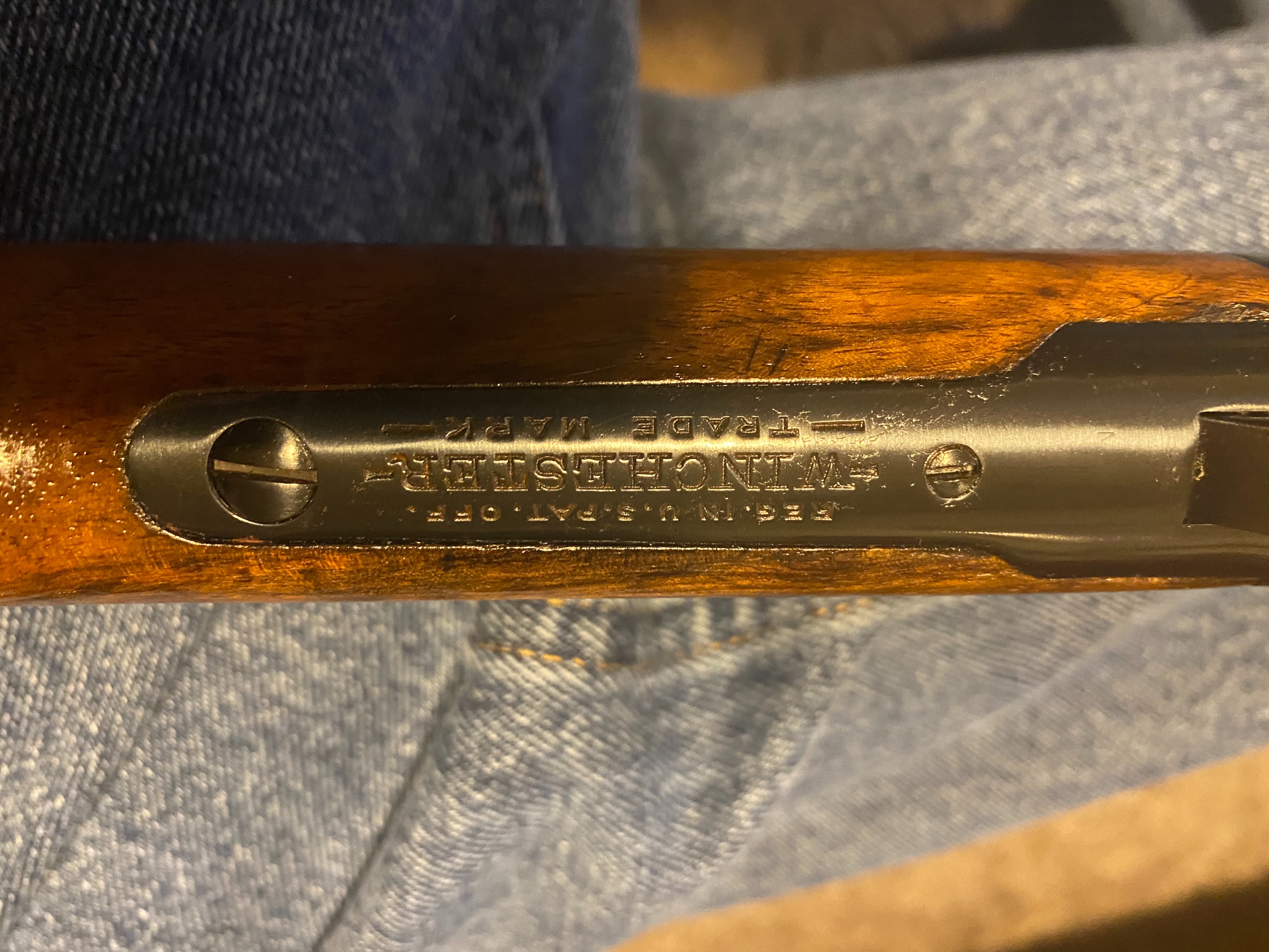

I recently acquired a Winchester 92 rifle, with a 24” octagon barrel. It is chambered in 25-20, and is a takedown version. Based on the serial number I see that it was made in 1909. There is no marking to indicate that it a model 92, I had thought that the top strap would have model 92, or 1892, stamped on it but instead it states “REG. IN US PAT. OFF., – WINCHESTER -, TRADE MARK“.

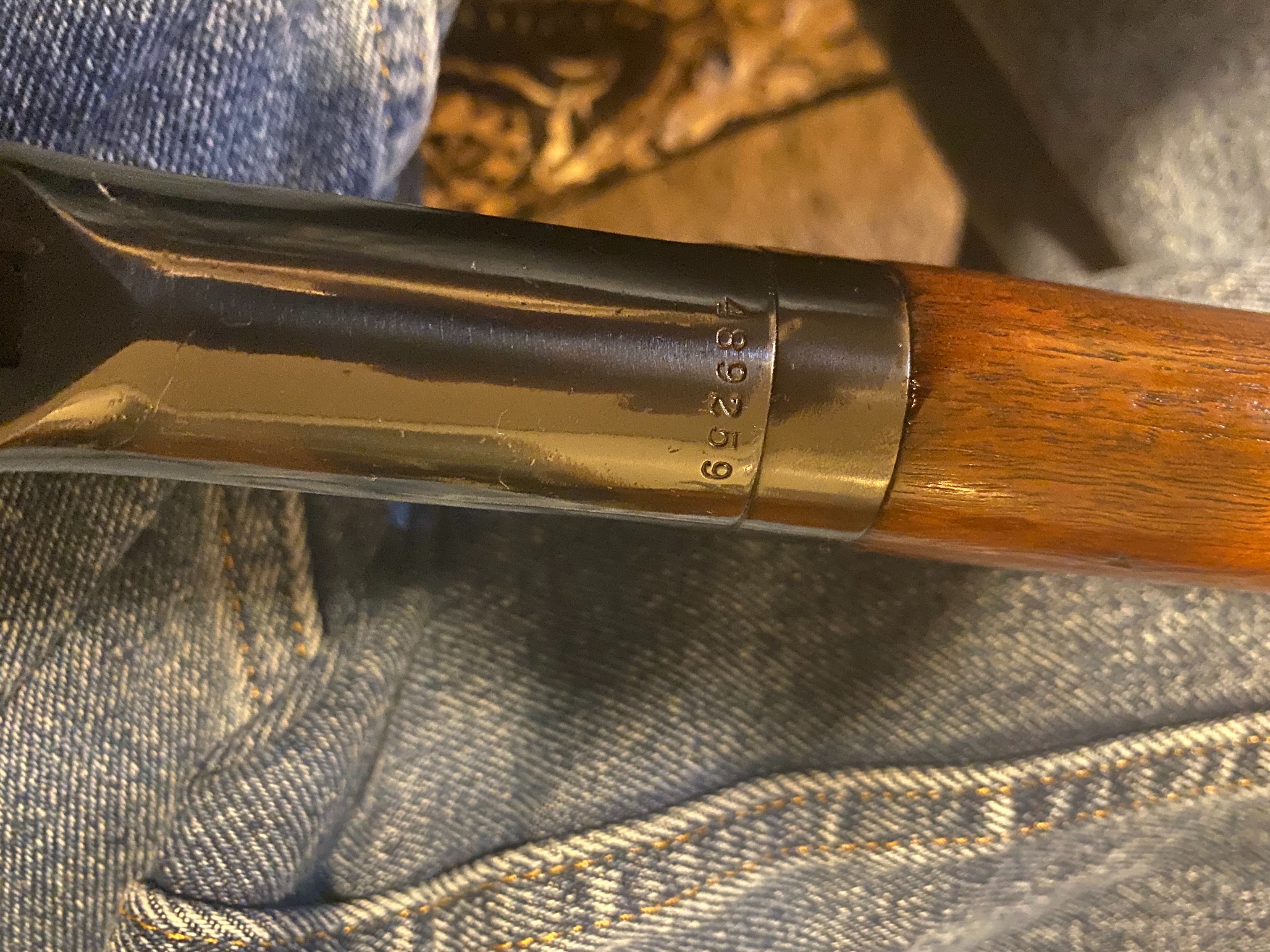

The 92s with this upper tang marking will rarely be found. It is the export model. They appear between sn’s 437920 and 522162, but ony for export.
If you look very close you will see (mod 1892) just behind the hammer on the upper tang running 90deg’s to the tang marking.

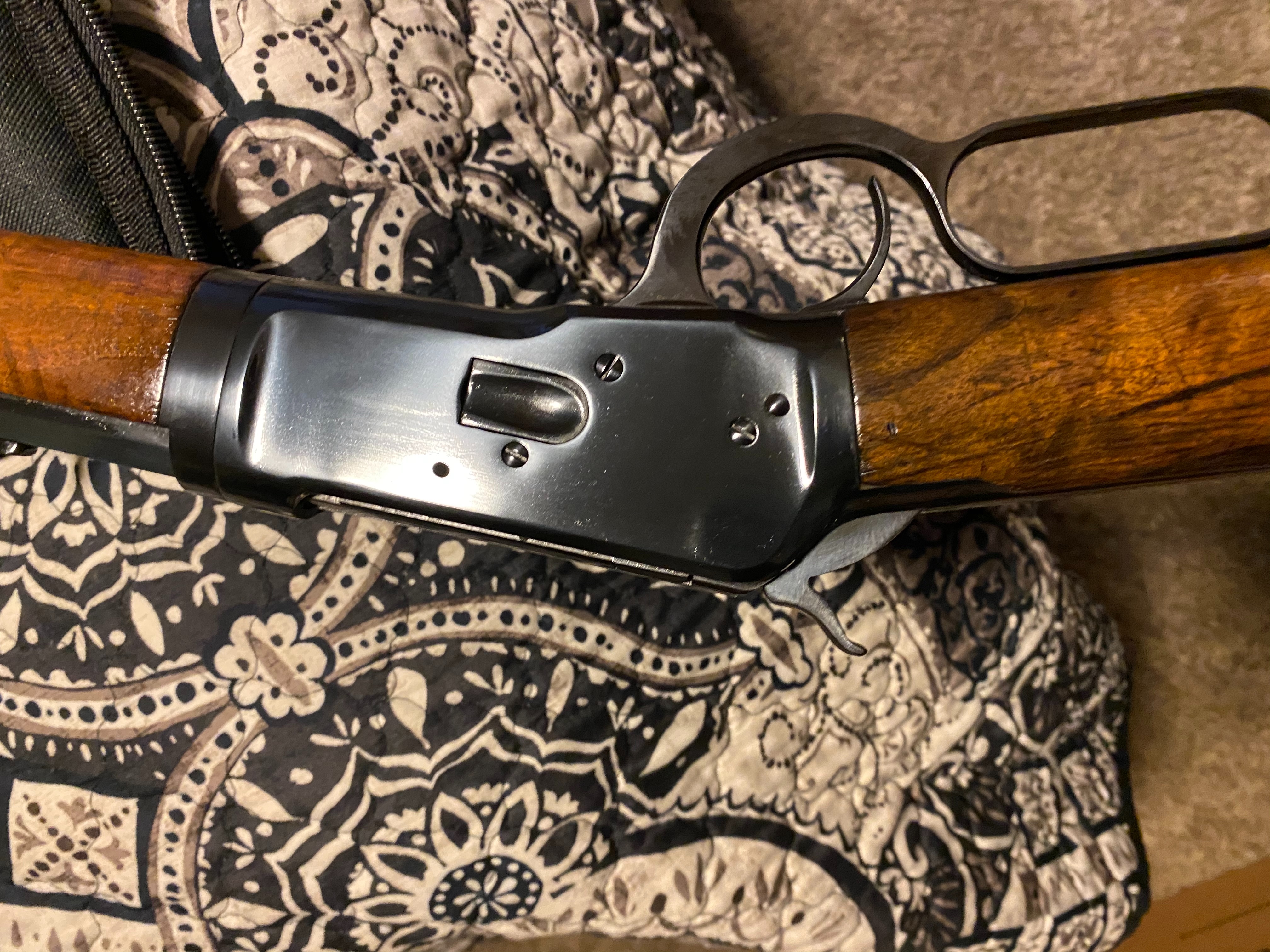

You are spot on about the serial number. Mine is 489259. I’m not seeing any marking stating 92 anywhere though….49778B0A-5079-4550-A913-F6F21A2D1FB0.jpegEDAB8FCF-B7EA-46ED-AAD0-45DEF4C52EAB.jpegE7509CD9-8484-4259-A20D-389BEF49FF97.jpegA1D2A6DF-98AC-4C45-BC1D-567997277CE9.jpeg5D5F53AE-9209-4C08-9231-F84C582882BB.jpeg

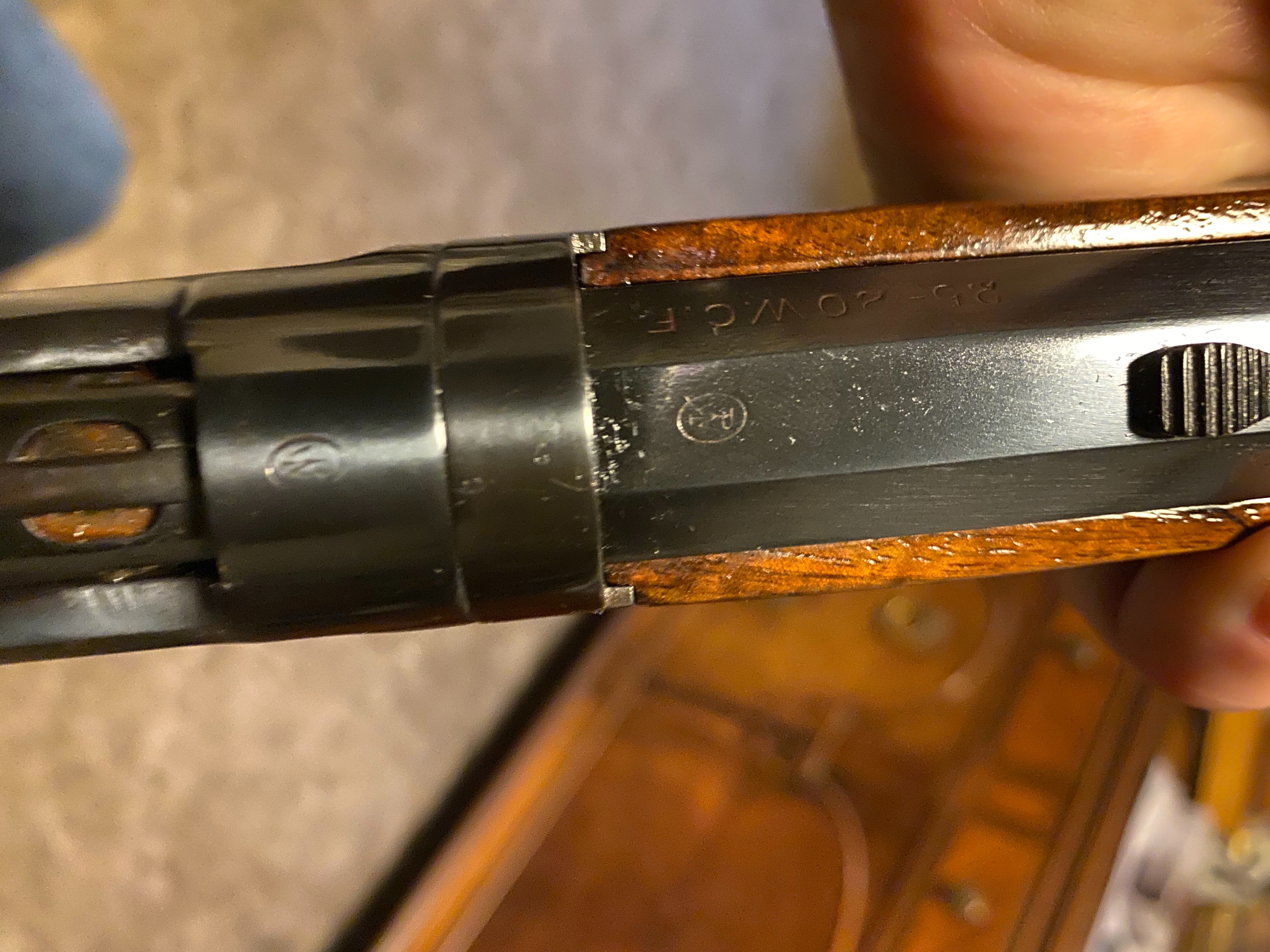

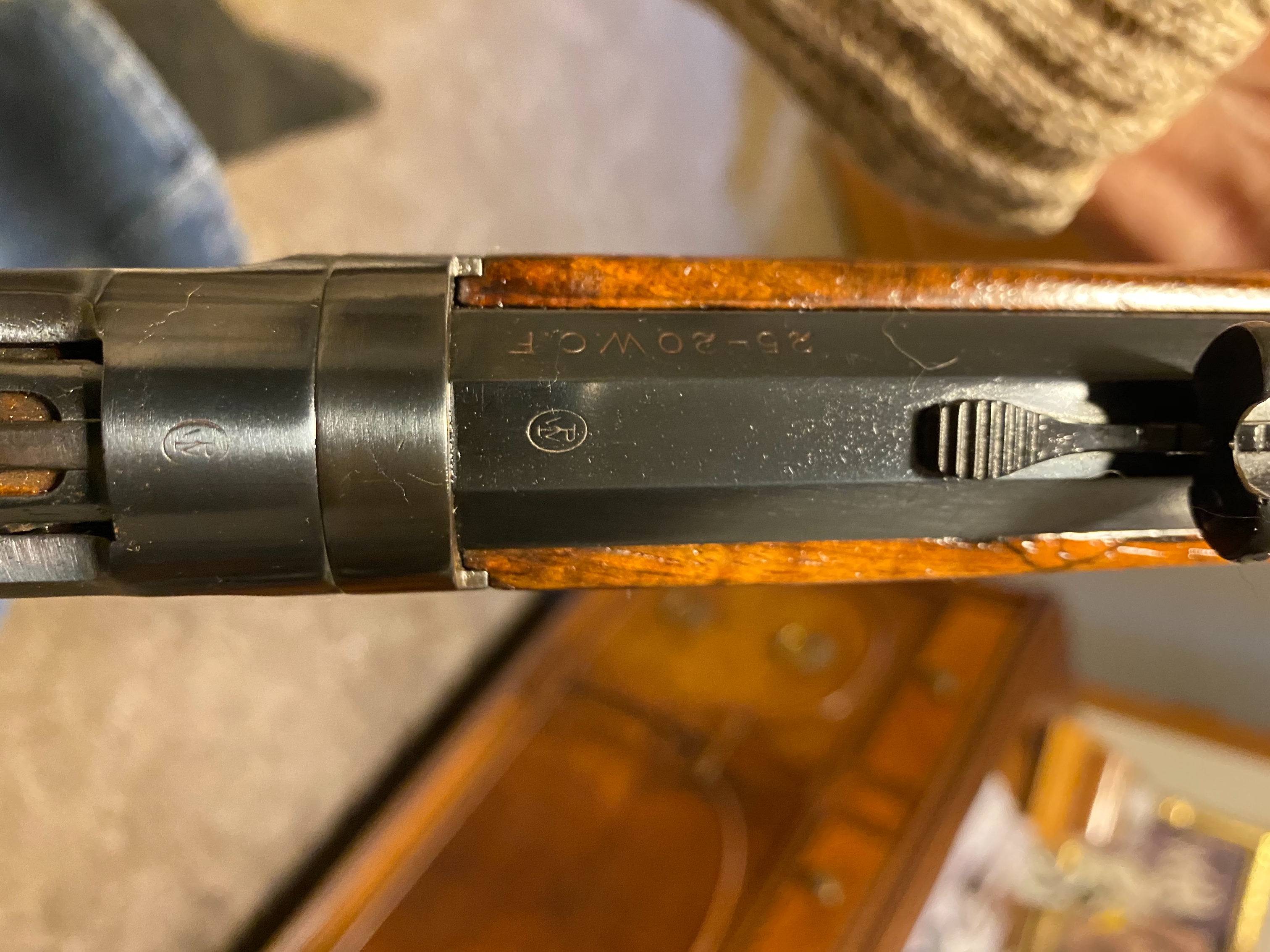

I have to state that it appears that this rifle has been in storage for the past 111 years. I’m attaching a photo of the markings on top of the barrel.
How many take down 92’s were marked for export?A8CD71C2-1463-4938-AC48-5056C4D3765A.jpeg6ACF0672-F3FA-4106-A16F-051906DF10BB.jpeg

I don’t want to be the bearer of bad news but your rifle has been refinished, hence the 95% blueing. If you look closely at the complete picture of the top tang you will see the remnants of the letter M, (just behind the hammer) The model designation has been polished off and the rifle has been reblued. There are several other obvious indicators that it has been reblued also…..

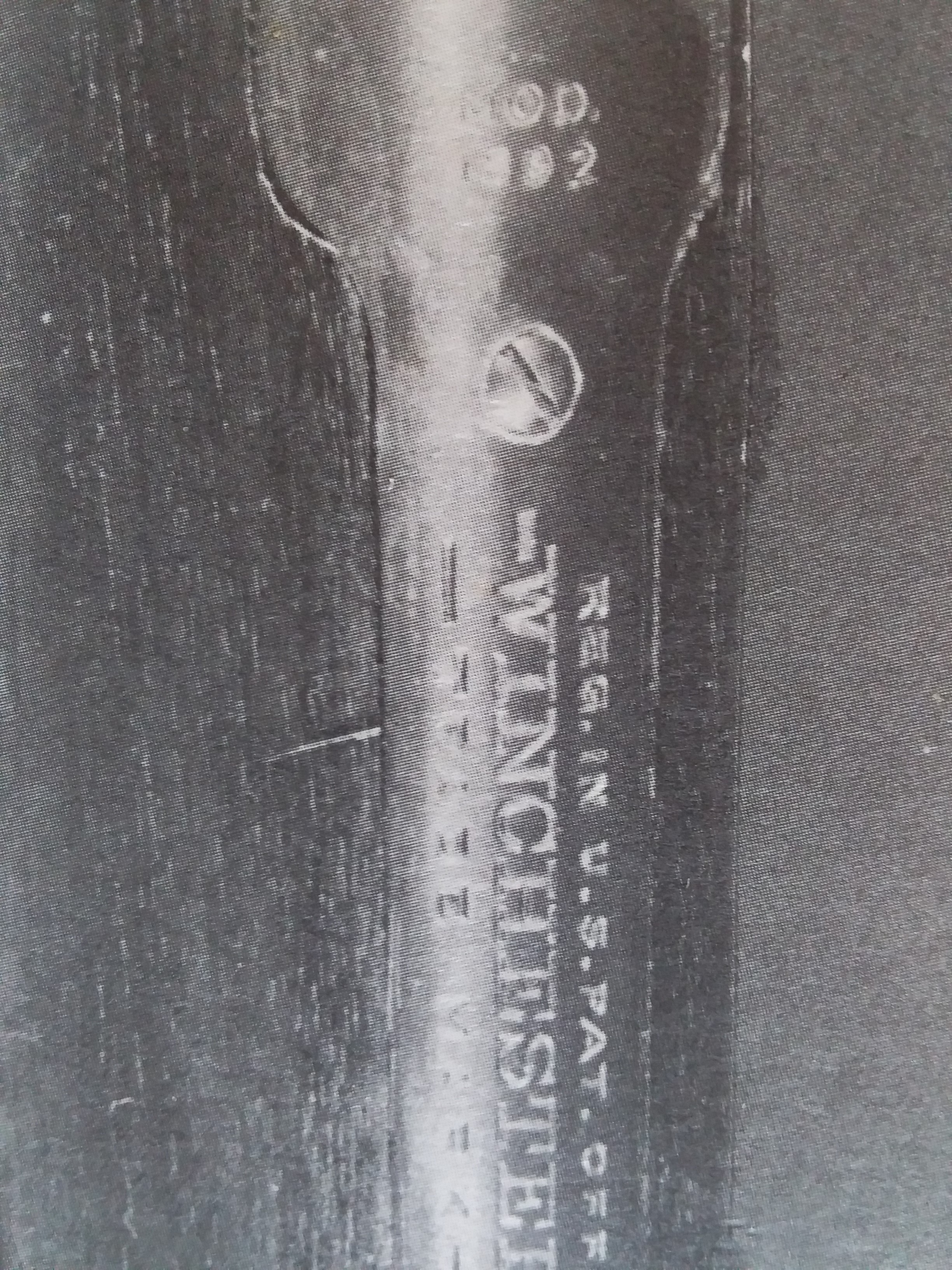

I just took a couple of hasty pictures of the marking on mine (also a .25-20)
Unfortunately, yes, your rifle has been reblued.
https://imgur.com/G4EcNb9
https://imgur.com/KrHX1Zm
