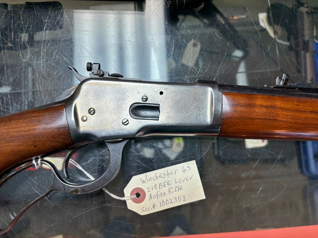

Hello.  New here.  Getting involved with Winchester Lever Action Rifles.
Found what looks like a nice 65 218 BEE in a LGS.  It has a plated receiver.  Could this be legitimate.  I tried to upload a picture but right now I am a guest.
Serial # 10023xx.
Thank you.

Please provide the complete serial number and send the pictures to my email.

Looking forward to seeing the pics but my guess is not original…
It is not… somebody removed the bluing and left it in the white.

Ah, that would make sense. Based on how many times I’ve chased a 65, asked you questions about a 65, and read your articles on the 65….I’d be REAL suspect of any plated 65’s…

Forum Posts: 14866
April 10, 2025 - 5:02 pm
Zepp said
It appears to be raw (in the white) steel with the original bluing purposefully removed.
