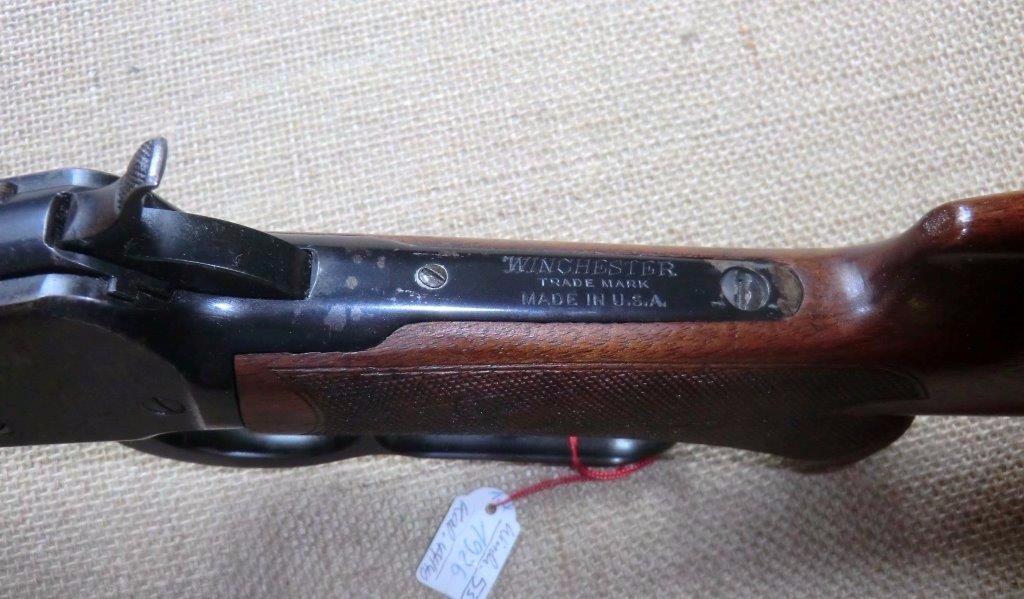

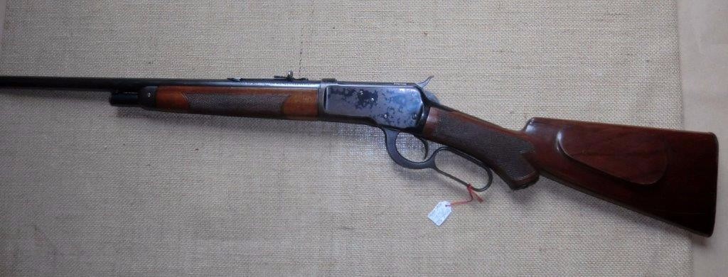

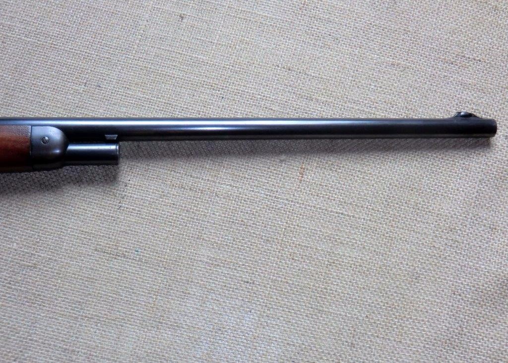

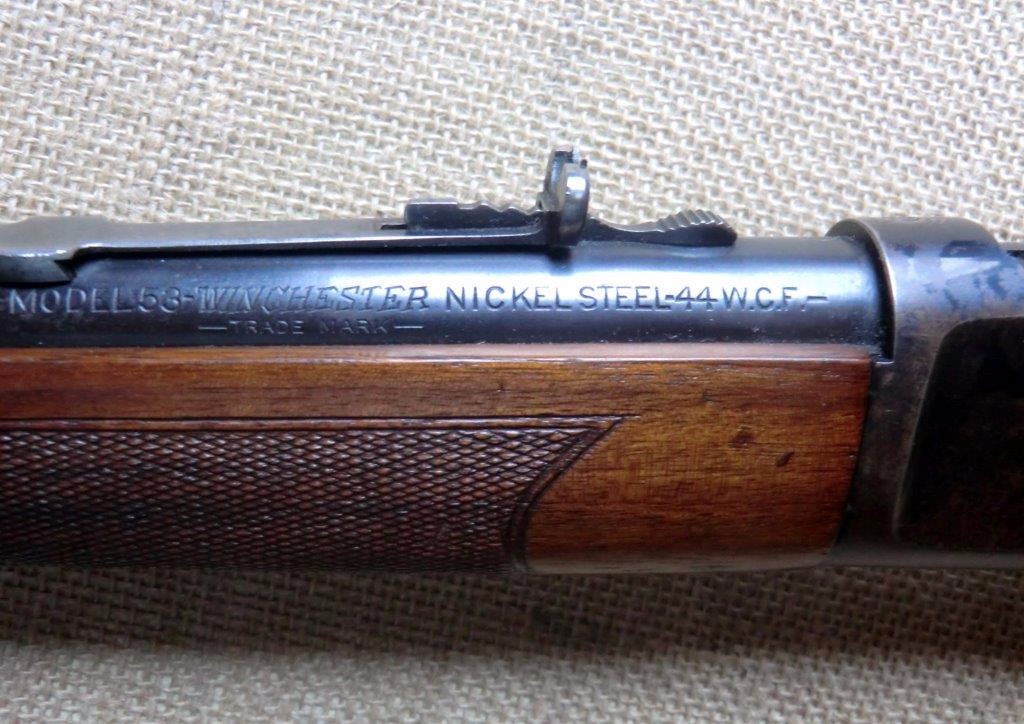

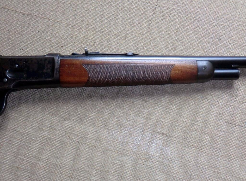

Hi experts,
found this Model 53 with unusual stock:
what do you think about it? Original or not ?
Greetings from germany
Stefan
pdog72
Wyoming - Gods Country
Forum Posts: 1295
January 26, 2011
August 18, 2017 - 4:02 pm
Steff
My vote is no. I don’t see anything about it that looks correct. The checkering is wrong, the cheek piece is not the shape I’ve seen before, and the fore end length is too short. I’m curious if the barrel has another dovetail underneath where the original cap attached or does it have an incorrect barrel too?
                                                                               ~Gary~
Forum Posts: 2756
August 18, 2017 - 4:26 pm
Hello Steff,
I would agree that the rifle does not look correct for a number of reasons.  What is the serial number and upper tang stamp style?
steff
Forum Posts: 241
September 11, 2008
August 18, 2017 - 4:49 pm
I doesn’t buy the rifle. Have only pictures.
Many thanks for your help.
How realistic is the probability for the gun to get a correct, original stock to change it?
Stefan
pdog72
Forum Posts: 1295
January 26, 2011
August 18, 2017 - 5:37 pm
I wouldn’t waste my time on it. The pistol grip stock is also something of concern since the rifle should have been a straight grip. I suppose you could stretch your imagination and assume it was a special order deluxe pistol grip 53 that ended up with different wood on it. Just too many issues to even consider it, in my opinion.
                                                                               ~Gary~
Forum Posts: 2756
August 18, 2017 - 5:40 pm
Steff,
Model 53 rifles did not have cut off magazines with flat end caps and a magazine retaining ring on them.  My guess is that the receiver and magazine may be from a late Model 92 and that the wood and barrel are non original.
steff
Forum Posts: 241
September 11, 2008
August 18, 2017 - 6:41 pm
You are absolutely right. The weapon is not worth it.
Unfortunately it is the only model 53 which I have seen in Germany in my whole time as a collector.
Thank you
Stefan
Forum Posts: 5863
August 18, 2017 - 8:34 pm
I like the fact that it is a .44-40.  Most M53’s a person runs across are in .25-20 or .32-20.  I find the .44-40 darn desirable in the M53. I have never owned a M53 in .44-40.  I agree this rifle is not original so of course it is not a rifle for a collector.  However many of us collectors are also shooters and hunters so a rifle such as this can have its place.  As a hunter/shooter, I find it has appeal.  By the way, there are many ways this rifle may have been altered, but I will weigh-in and say the receiver blue is original.
