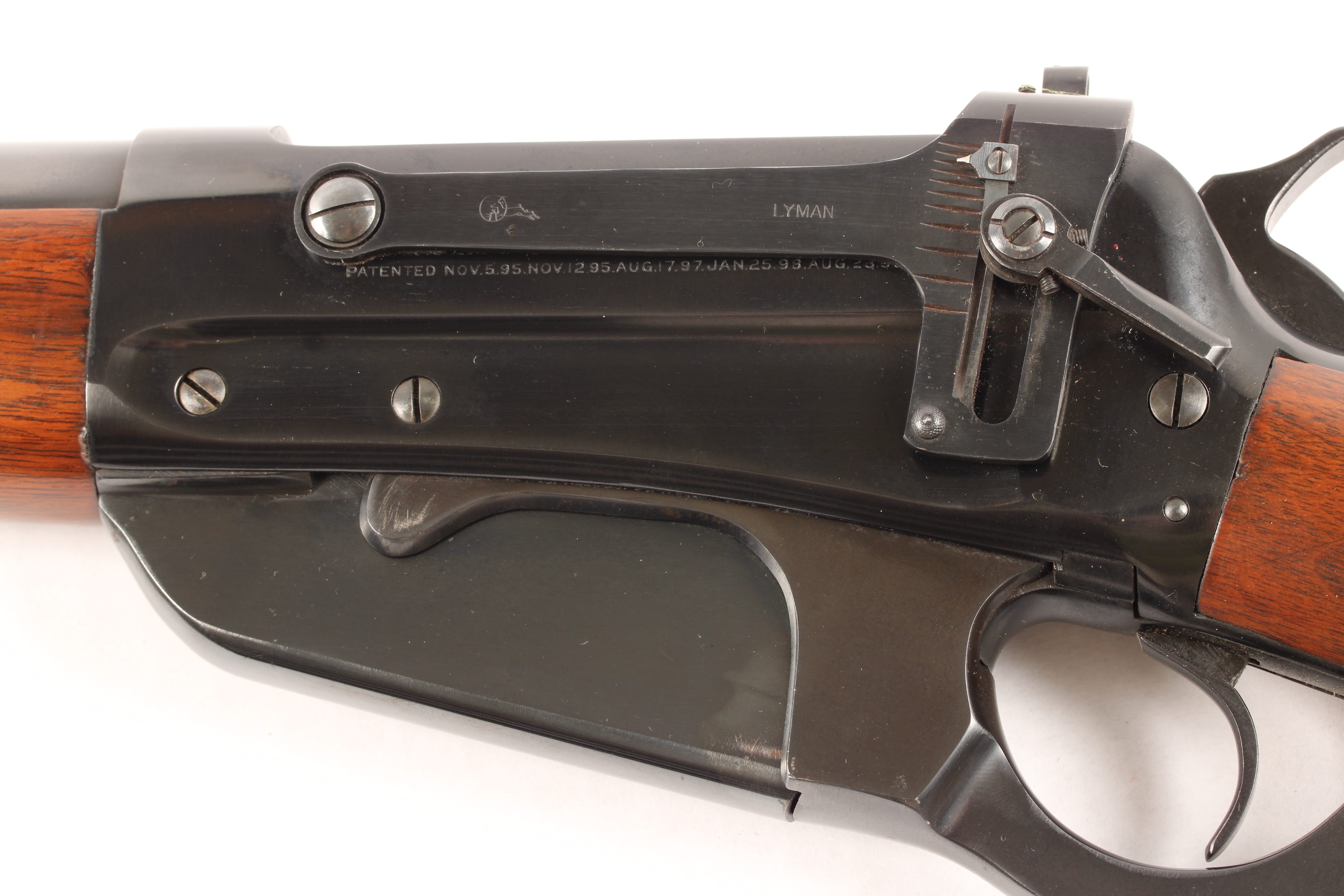

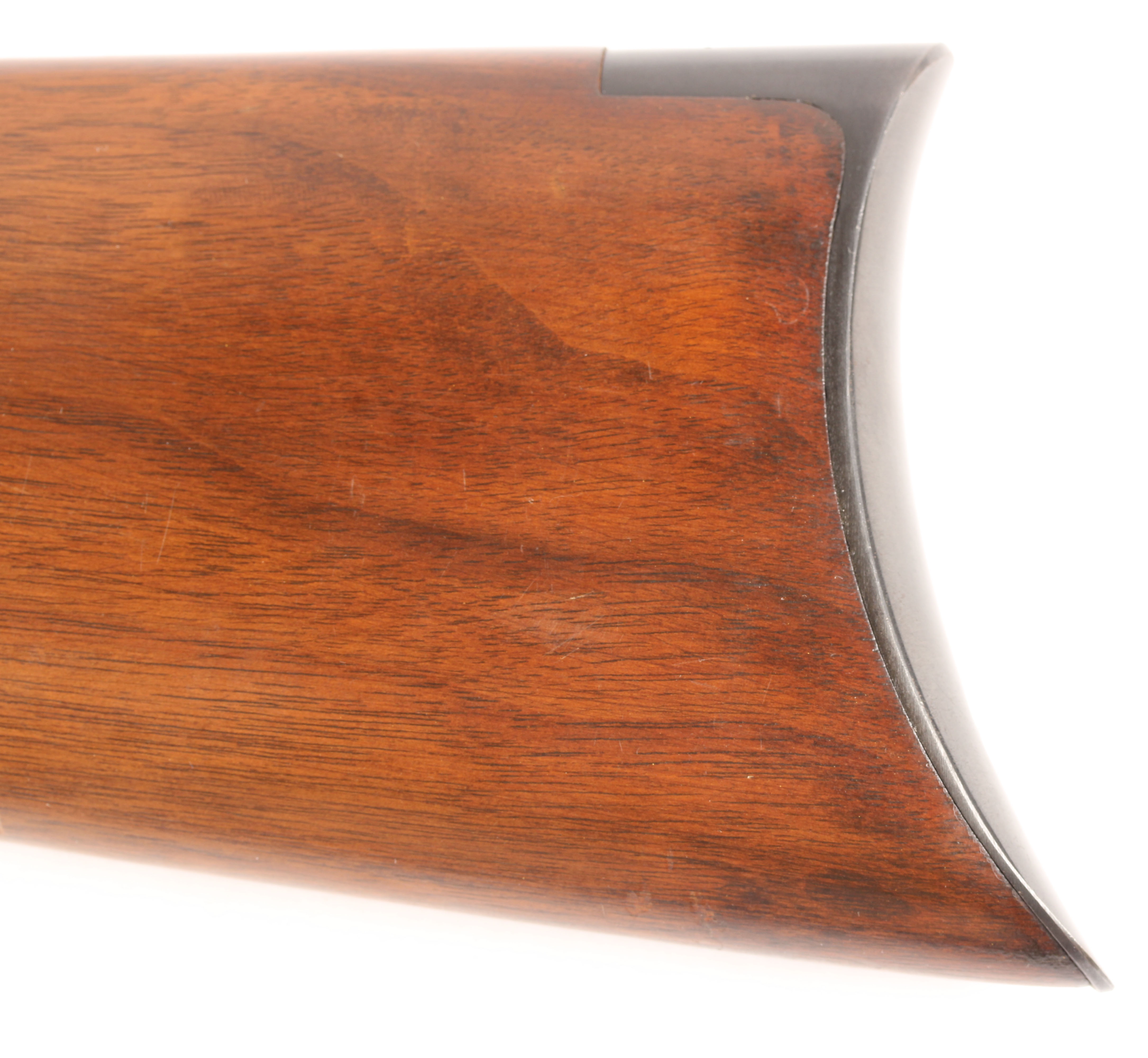

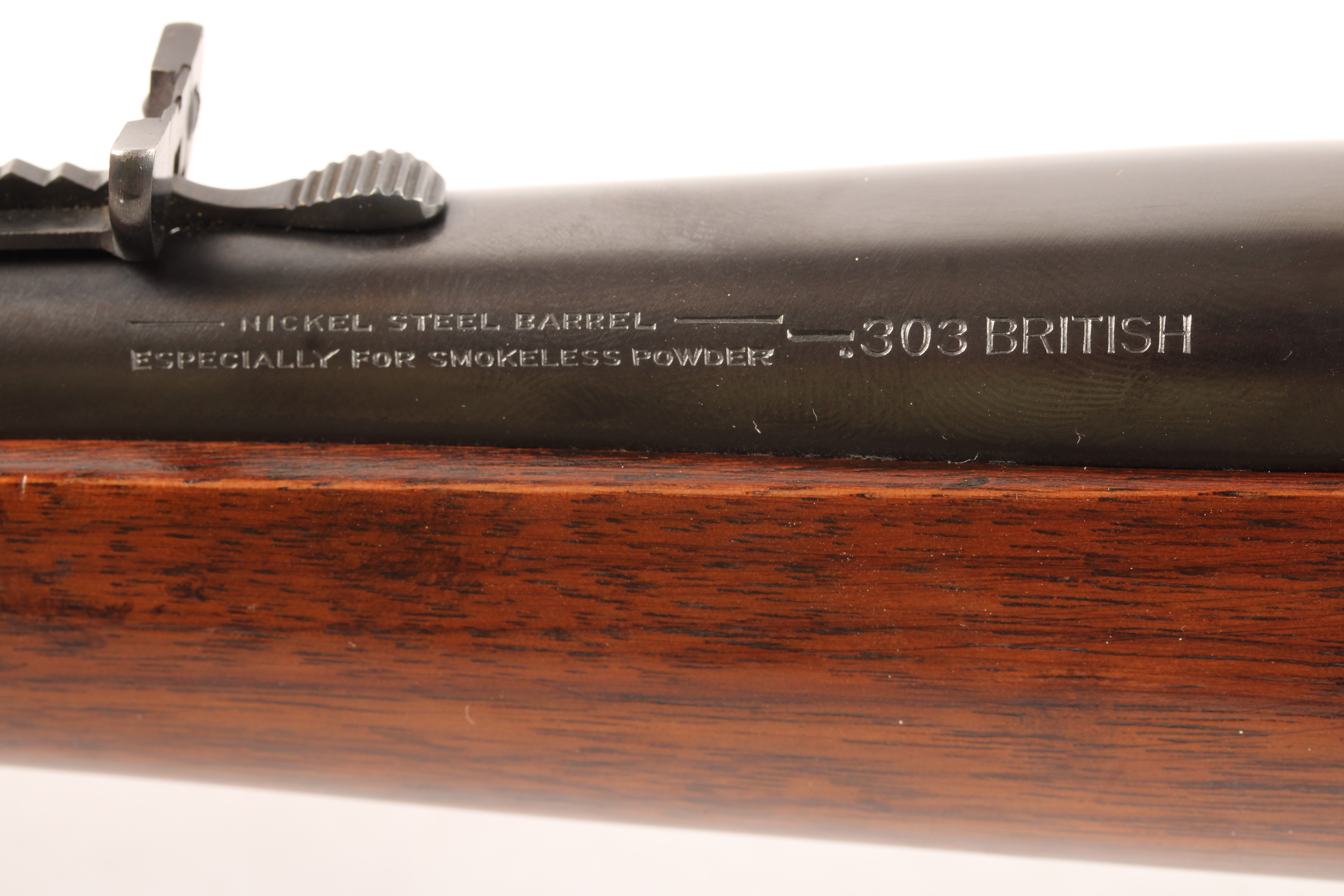

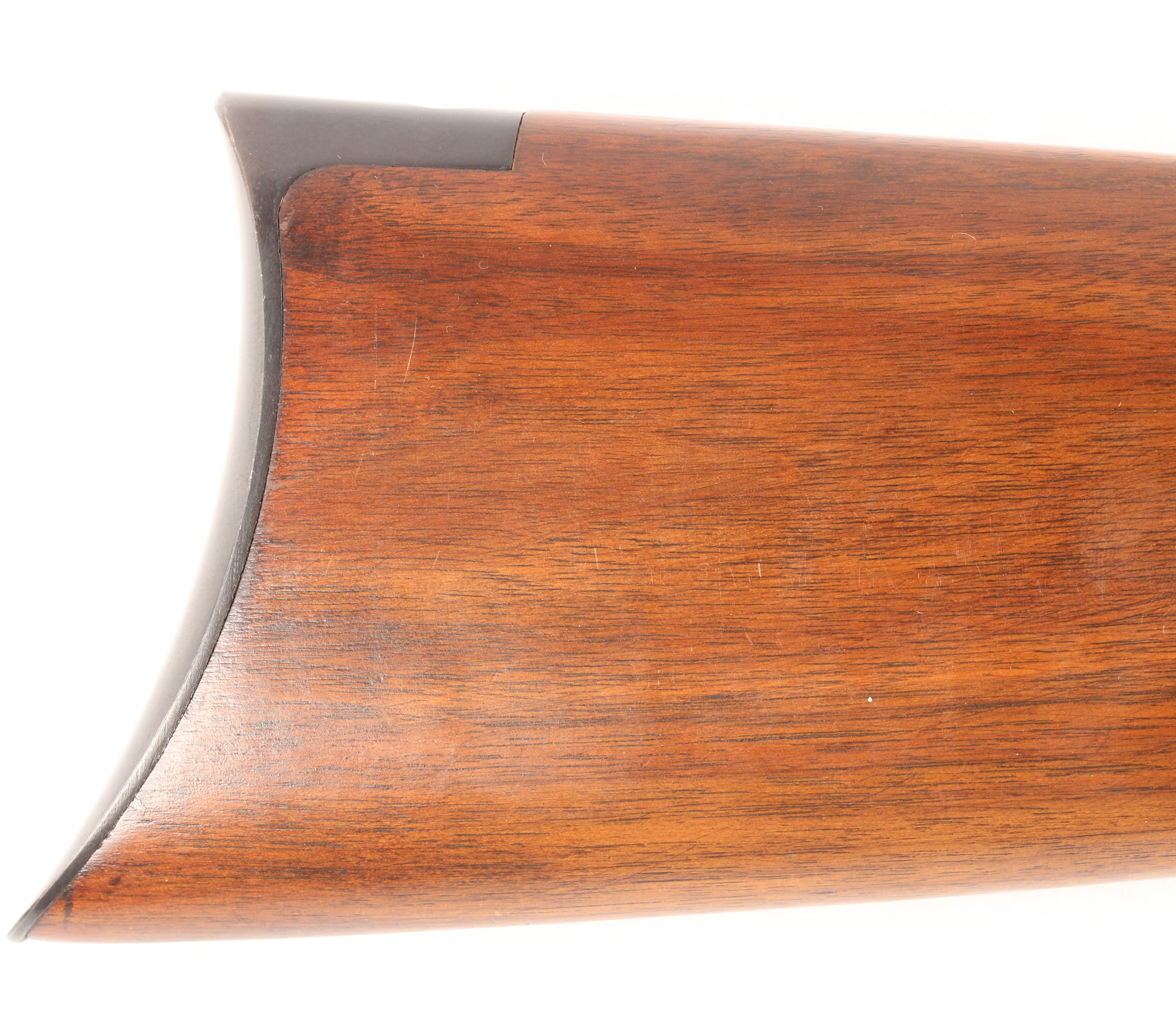

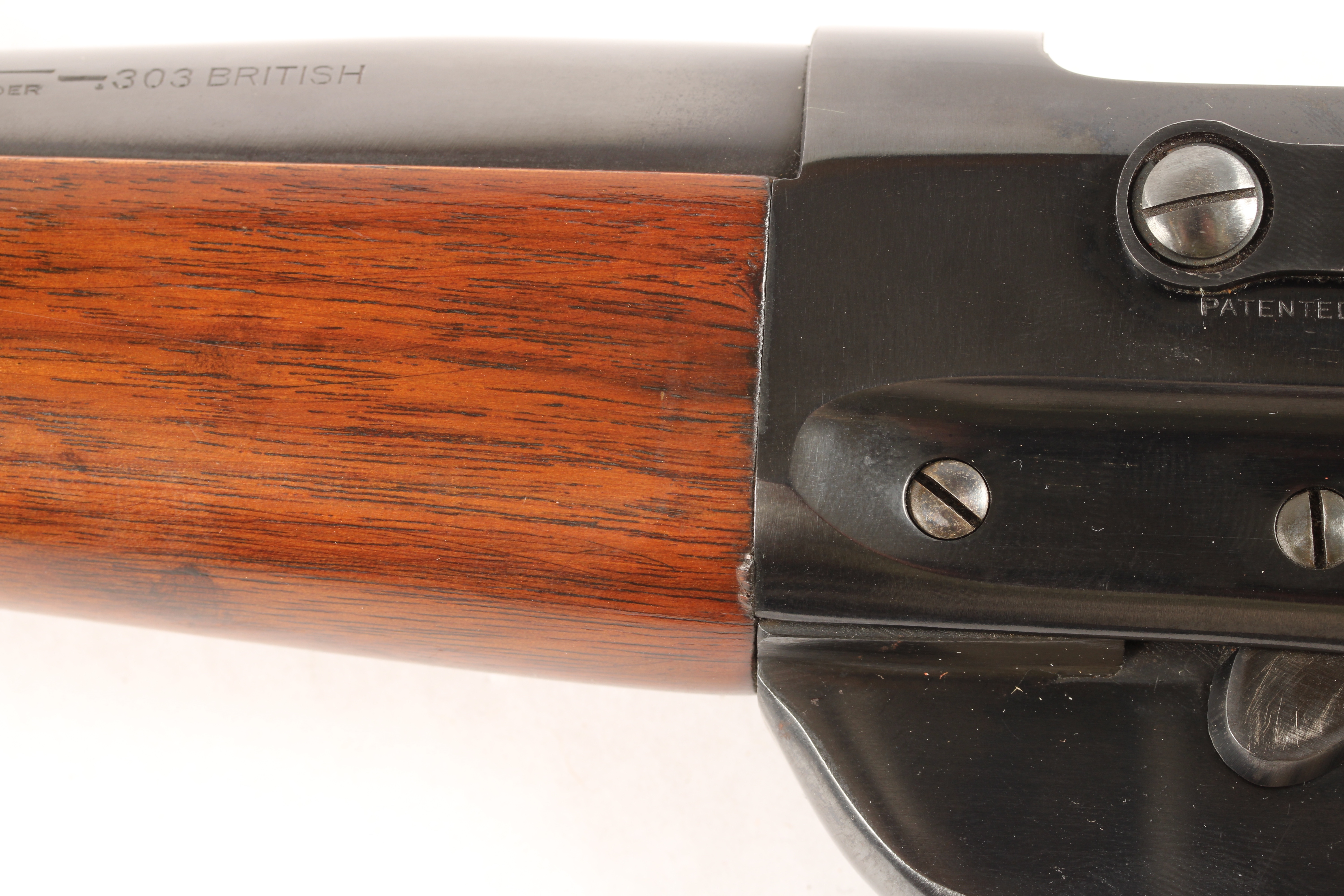

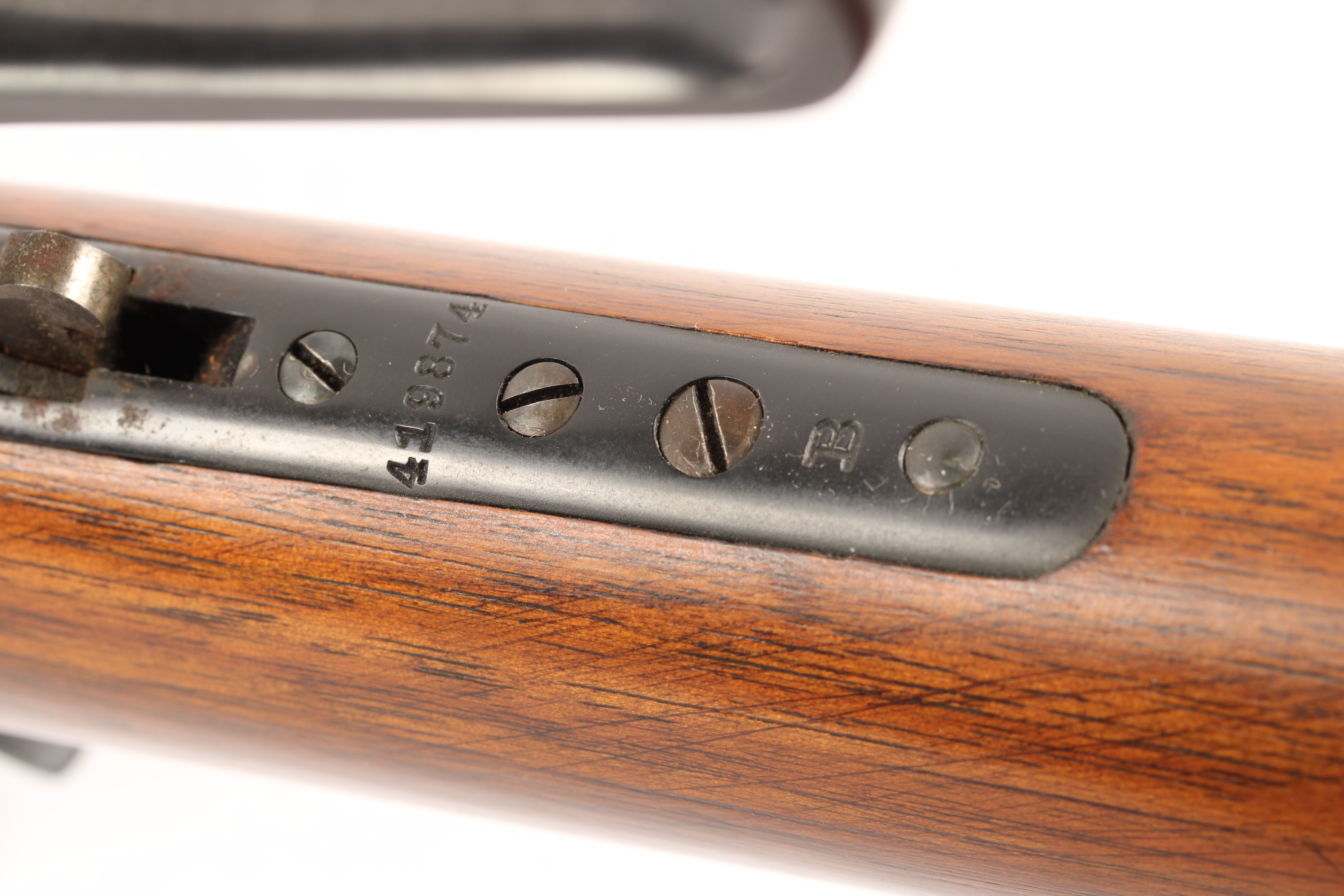

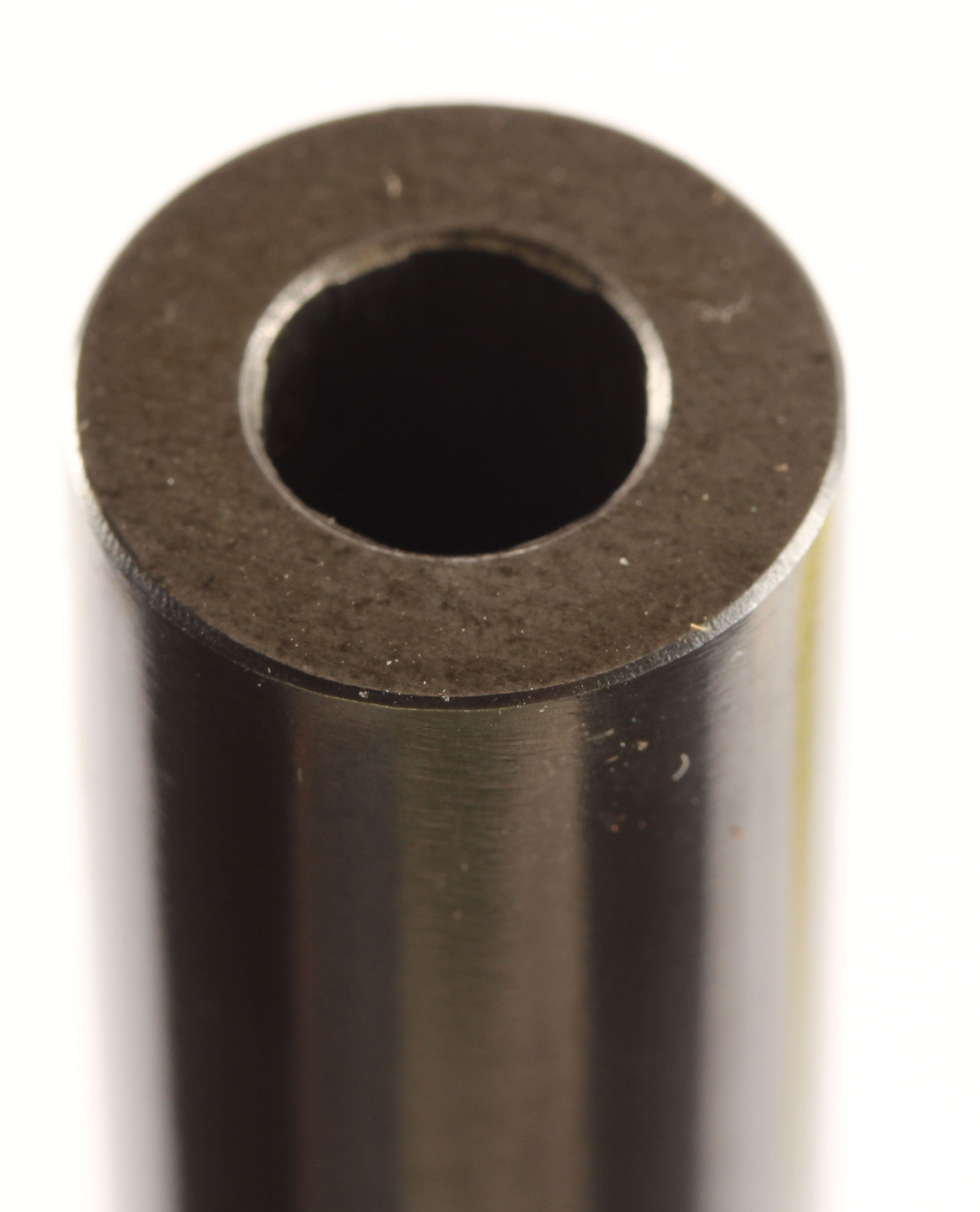

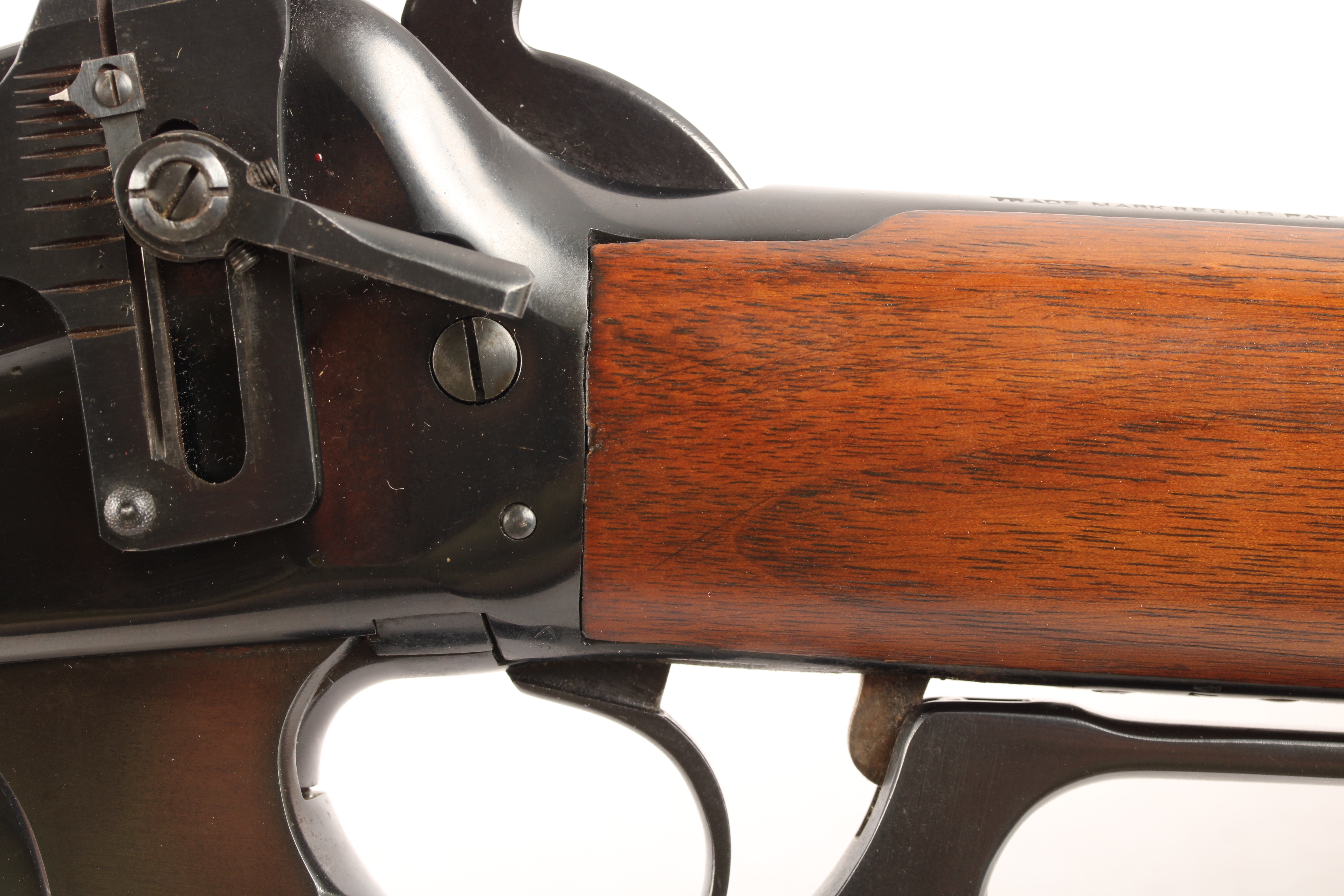

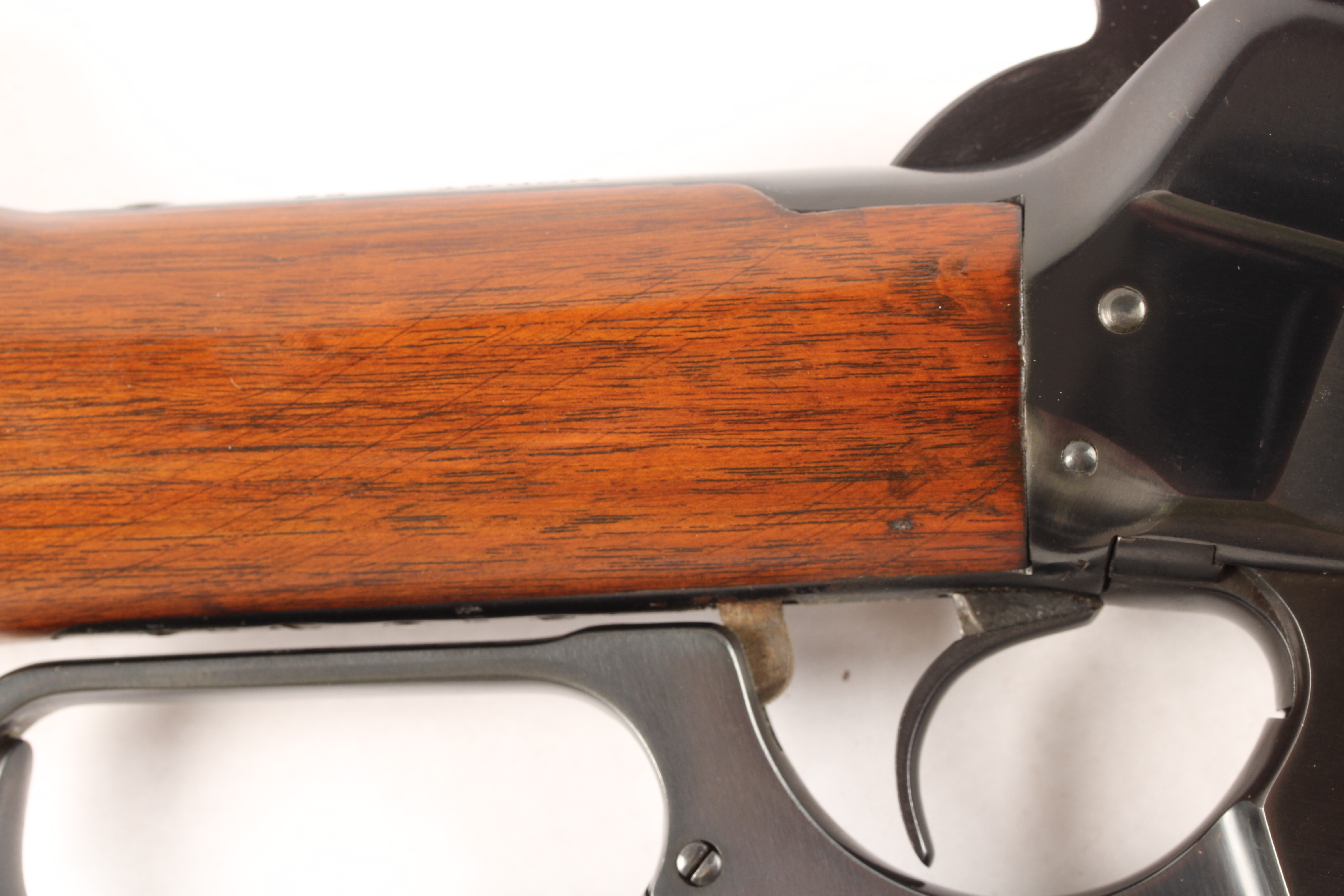

IMG_4220.jpegIMG_4222.jpegIMG_4225.jpegIMG_4227.jpegIMG_4228.jpegIMG_4230.jpegIMG_4233.jpegIMG_4234.jpegIMG_4235.jpegIMG_4236.jpegIMG_4237.jpegIMG_4238.jpegIMG_4239.jpegSo, what’s the verdict on this mid 1920s Winchester Model 1895 rifle?  I think both metal and wood are refinished.

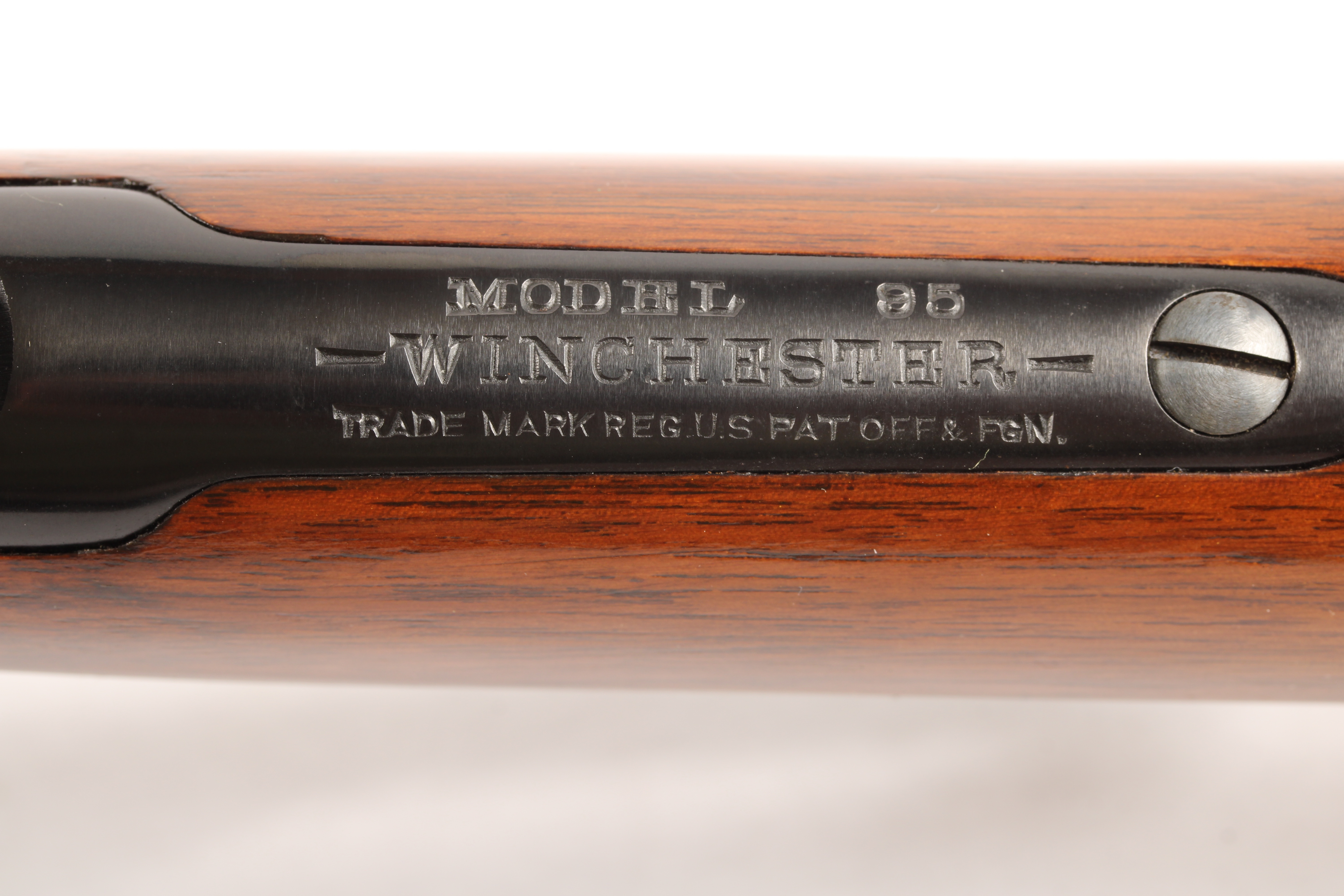

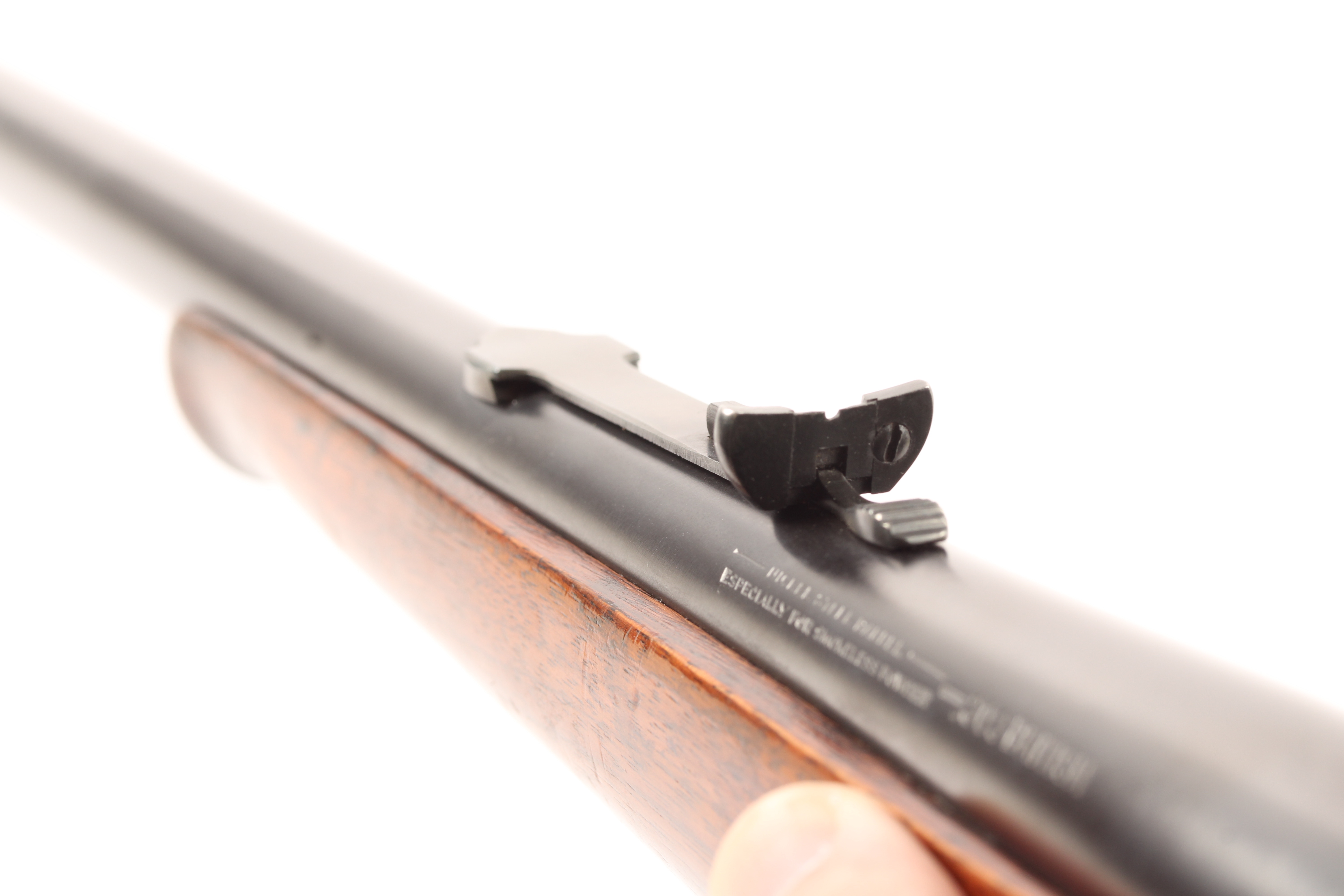

1.  The barrel proofmarks appears buffed and blued.  Proofmarks were applied after the surfaces were blued so they should be “in the white”.
2.  Some lettering in various places is weak.  Not markedly so, but enough to make me suspect polishing and rebluing.
3.  An enlarged photograph shows polishing marks on the barrel.

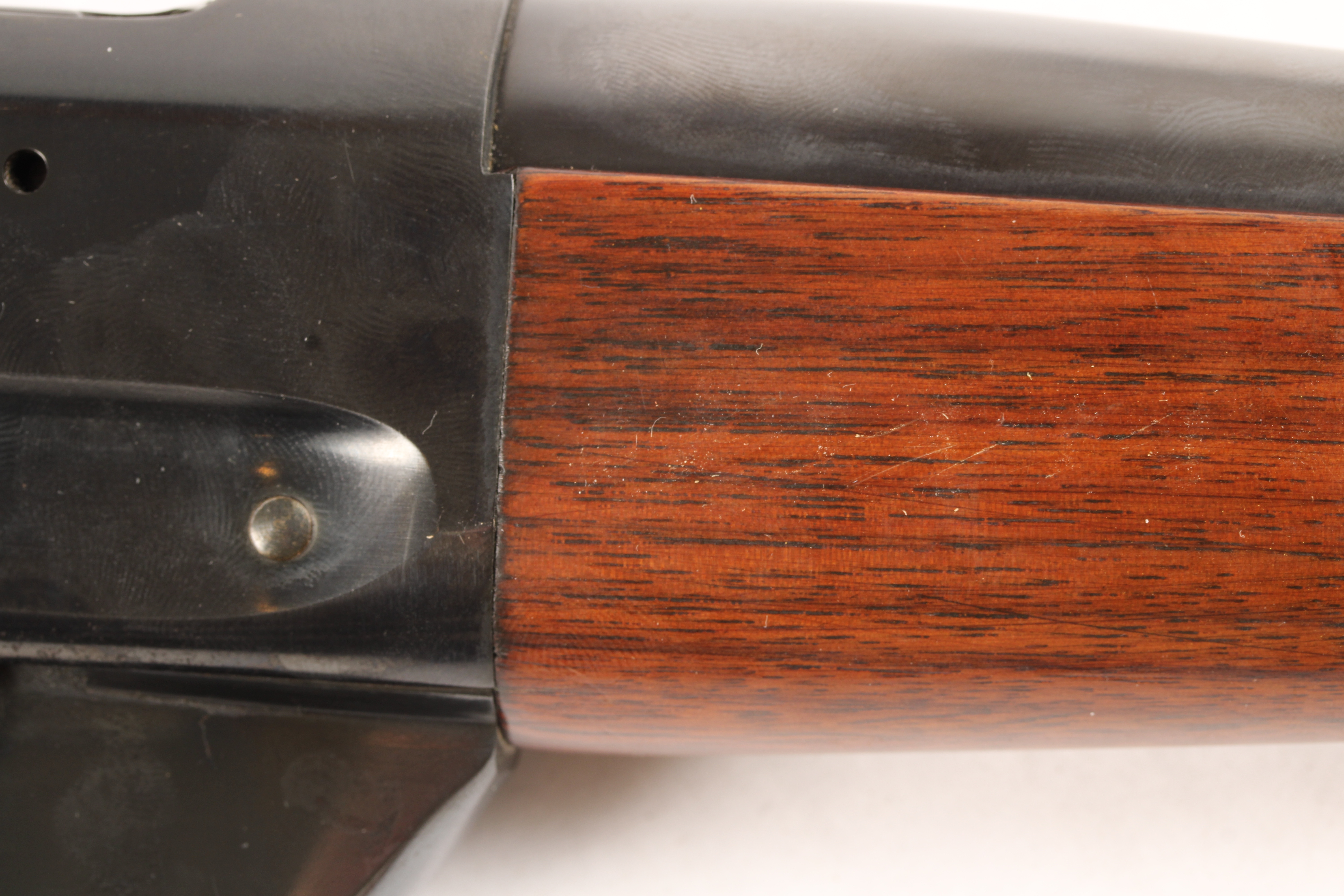

4.  The stock is more flush with the buttplate than I would expect.  Also, when enlarged, the wood finish looks sanded and refinished.
5.  For a rifle this “nice”, how do you explain the loss of small slivers of wood at the corners of the buttstock near the tang?
6.  The tone of the bluing looks muted and reblued, not the desirable polished blue finish one would expect.
7.  The hue of the magazine and frame is inconsistent enough to suggest non factory work.
8.  Possibly some dishing around screws.

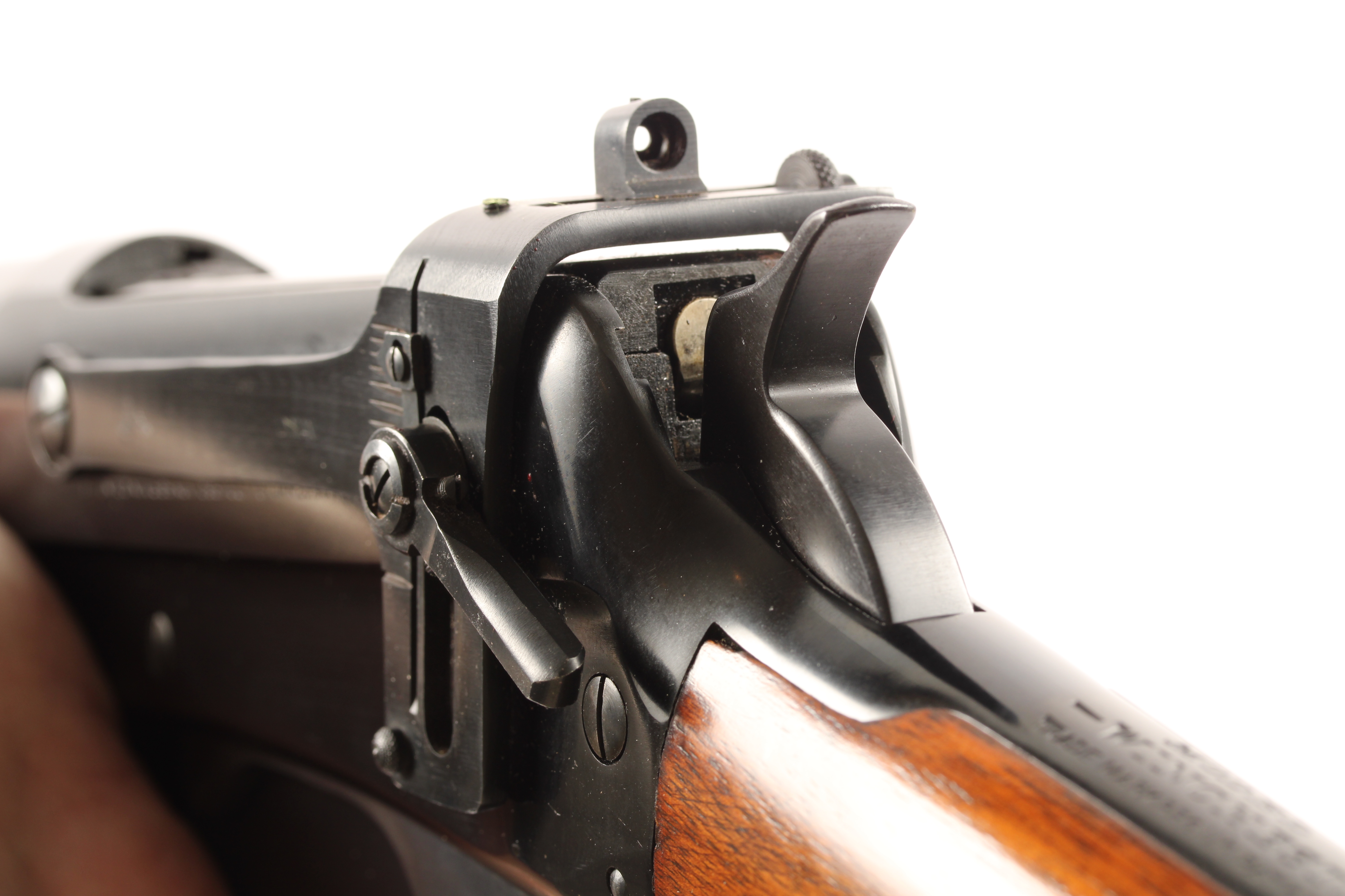

9.  The hammer edges look soft, as if buffed.
10.  Edges of the lever are soft.

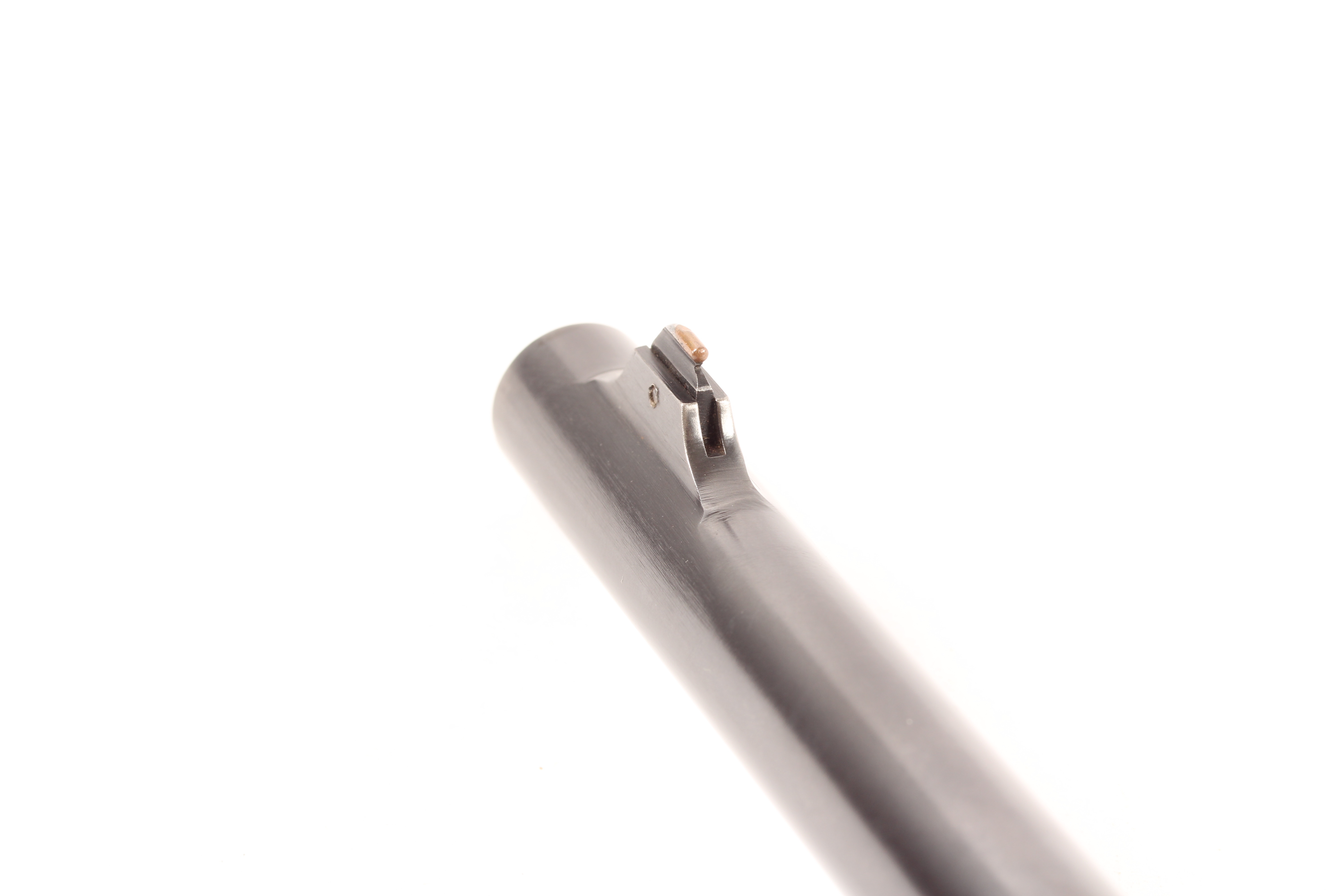

11.  And, the front sight is most definitely replaced.
What do y’all think?

The wood has positively been lightly sanded and refinished.  I am on the fence for the steel.
Forum Posts: 2553
August 12, 2026 - 1:36 am
The lever and hammer contain edges that should definitely not be that rounded, wouldn’t you agree?  That alone makes one question “what else is wrong?”

I’m no 1895 expert but to me, that “monochrome” look is always the dead giveaway. The hammer in that one rear view also looks almost painted or cerakoted, not blued.

It’s obvious the rifle was taken apart and cleaned up a long time ago, as no old grease or accumulated grime is in any of the cracks, or crevices.
Many of us are aware of the late Don Grove’s collection and what he was selling. This one was definitely re worked years ago, and as the members pointed out, the wood is pretty obvious with it’s more than just handling marks on it, as the wood being sanded and rounded corners in places that shouldn’t be rounded being very obvious. The angled marks/scratches in the wrist that we’re finished over are always disturbing and a tell tale sign to me. The wood to metal fit at the rear of the receiver, at the wrist is one of the first places we seem to notice, as the lack of fit is very obvious. Looking at the lower tang, and the three different colored screws, as that alone doesn’t really signify a lot for us as collectors, mainly because screws can be repaired and touched up, giving a false sense of appearance to the rifle, in our minds upon evaluation. A couple members have said and commented on the metal, as it can be hard to determine, from the pics.  A few different angles and pictures sure makes it suspecting. IMO!
It would require handling to make an honest evaluation! IMO!
So to answer you’re original question, my answer is, YES!
Caveat Emperor!!!
August 12, 2026 - 3:08 pm
Wood and metal redone.

For any in the know, is that caliber stamp of the correct font/location/style for these?
As far as I can tell for the “Nickle steel Barrel’, and with that serial number verifying it’s year and mfg. time period of 1924.

For me it’s what I’m NOT seeing. With the handling marks on the wood and the wear on the Lyman receiver sight I expect to see some wear on the high spots and edges of the receiver and I’m not seeing them. As pointed out above the gun has been apart and the wood finish freshened up a bit. Somebody did a good job refinishing the metal but for me it doesn’t pass the “does it match?” test. Screws are a bit too nice with none of the gunk we like to see on an honest gun. Nice work. Nice pics. I’m wondering why we’re not seeing the top of the receiver.

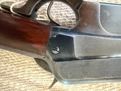

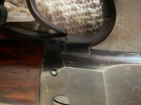

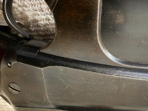

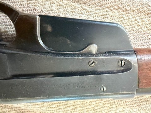

Just snapped these photos a couple minutes ago for comparison.  Why they ended up flipped is beyond me.

Steve,
I think maybe the size of the picture flips them, as I’ve been told to use a smaller size picture, hence less bytes! I still struggle with it.
You’re 95, which is in nice shape, shows how the sharp corners wear first.

Tony –
Exactly.  The rifle Ian posted – it was used to the point the wood needed to be refinished – and it still looks kind of distressed.  Yet there would be no sharp corner wear on the metal?
