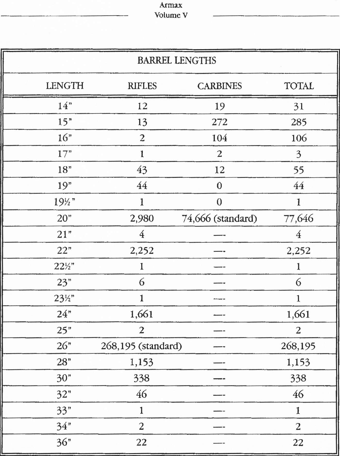

Does anyone have a reference to the number of short barreled model 1894’s were made (within the available records of course)? I am wondering how many 20″, 1/2 octagon rifles were made.

I would say that would be in the “ARMAX” THE JOURNAL OF THE CODY FIREARMS MUSEUM, Volume V, published in 1995 that has the survey of the 94 records but its at home.

The ARMAX survey lists how many in each barrel length, but no mention is made of the specific number for each barrel contour, or the caliber of the Short Rifles. Somewhere in a older topic I posted the chart show in the ARMAX survey numbers.

Here is the ARMAX Survey barrel length chart…
 With 2,980 that are in the letterable range, and at least that many more in the 354000 – 1150000 serial number range, my best guess is that at least 300 20-inch 1/2 octagon barreled Short Rifles exist.  As I mentioned, I have surveyed (5) thus far.
