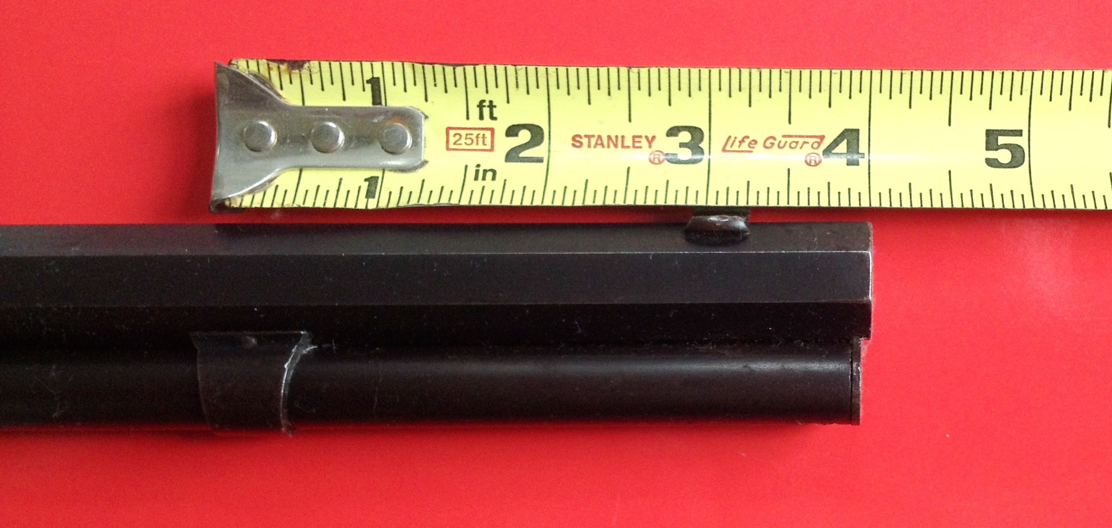

I’m assuming this one has been cut, but thought I’d post pics here to get opinions.
The round barrel measure 23” (the odd number length was my first red flag).
http://i.imgur.com/XxRmNAH.jpg http://i.imgur.com/OhnSU0V.jpg  http://i.imgur.com/fIh0DnV.jpg http://i.imgur.com/7zGnvAM.jpg http://i.imgur.com/BfHaRB7.jpg

Judging by the placement of the mag holder and front site I would say it’s been shortened and the barrel has been re-dovetailed for the front site. Is your last picture of the gun in question? I would say not with the matted barrel and forend wood.

Absolutely cut down!  Regardless of the barrel length, or style, the front sight and magazine retaining band should be positioned as in the attached photos.

I can’t tell by the pics but that gun may not necessarily been shortened, even though the site and the magazine band seem to be misplaced I believe they made 6, 23″ rifles that letter, I had an engraved one, and who knows how many they made after. I would have to do all the measurements on it and check the machining to form an opinion. What ser# range and is it a short  8 3/8″ forestock, what cal. , does it have a tang site?
Michael, thank you for the clear pictures.
So is it safe to say that all sporting rifle configuration 1894s have a retaining band that is (3 5/8” ?) on center from the face of the muzzle, even in special order lengths?

That is correct.  I have 2 of those 6, 23 inch barreled 1894’s  but each has a shorter than full length magazine!!  I have a few 22 inch, full length magazine 1892’s and 1894’s and the magazine retaining ring is positioned as shown in the photos.
