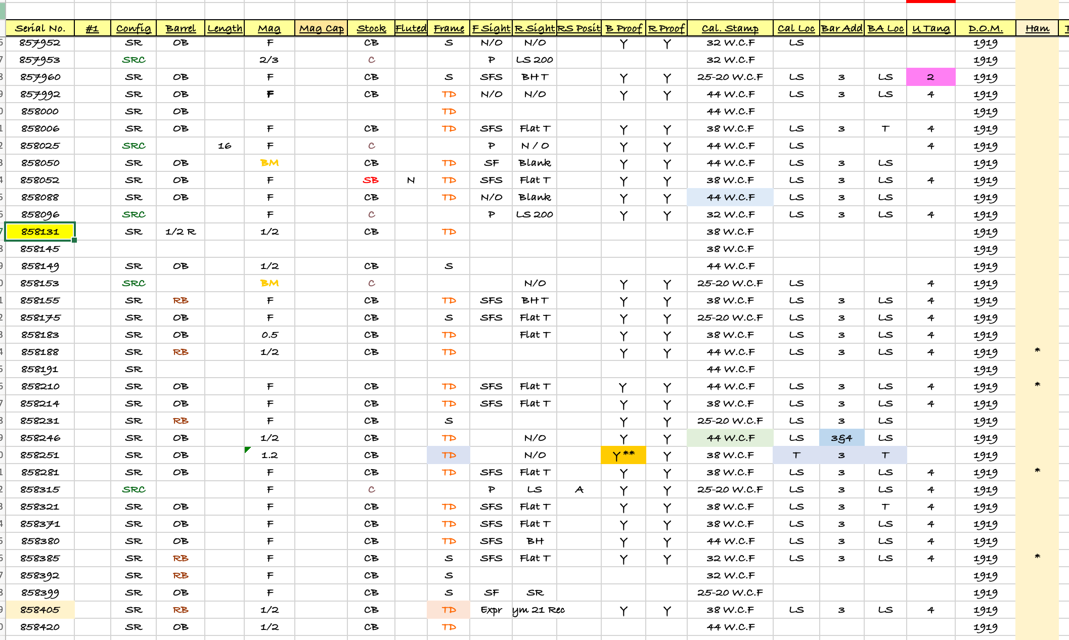

I did happen to have it listed already from an old auction catalog.  Sounds like a nice rifle for sure.  Winchester was making a lot of T/D’s in that SN range.

My mistake I think.  I had the rifle “listed” as being in Australia but as you can tell from my spreadsheet there is not information regarding the caliber stamp, proof marks, barrel address, upper tang or sights.  Nor did I have WACA or your name associated with it.  Years ago an AU collectors sent me some images of old AU auction listings so I assumed that was where I had gotten the info.

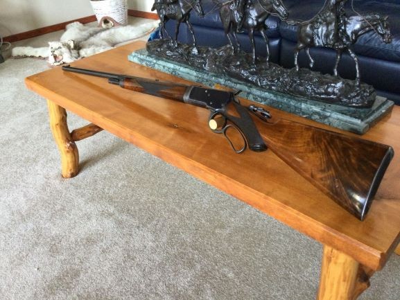

As those with a keen interest in the Model 1892 already know, a checkered variation which is original, correct, has condition and letters is a rare speciman. They are not as hard to find as a deluxe 53 or 55 but the good one’s have been tucked away in collections.
June 3, 2026 - 9:52 pm
PURE BEAUTY RIGHT THERE!
I don’t see how people can pay big dollars on art, such as paintings, when items like this exist.  As I said, pure beauty.
Burt – you collected some really find rifles over the years.  I always enjoy seeing them.  Always nearly unbearable eye candy.  There’s this sin out there called envy, and I am surely not free of it.
