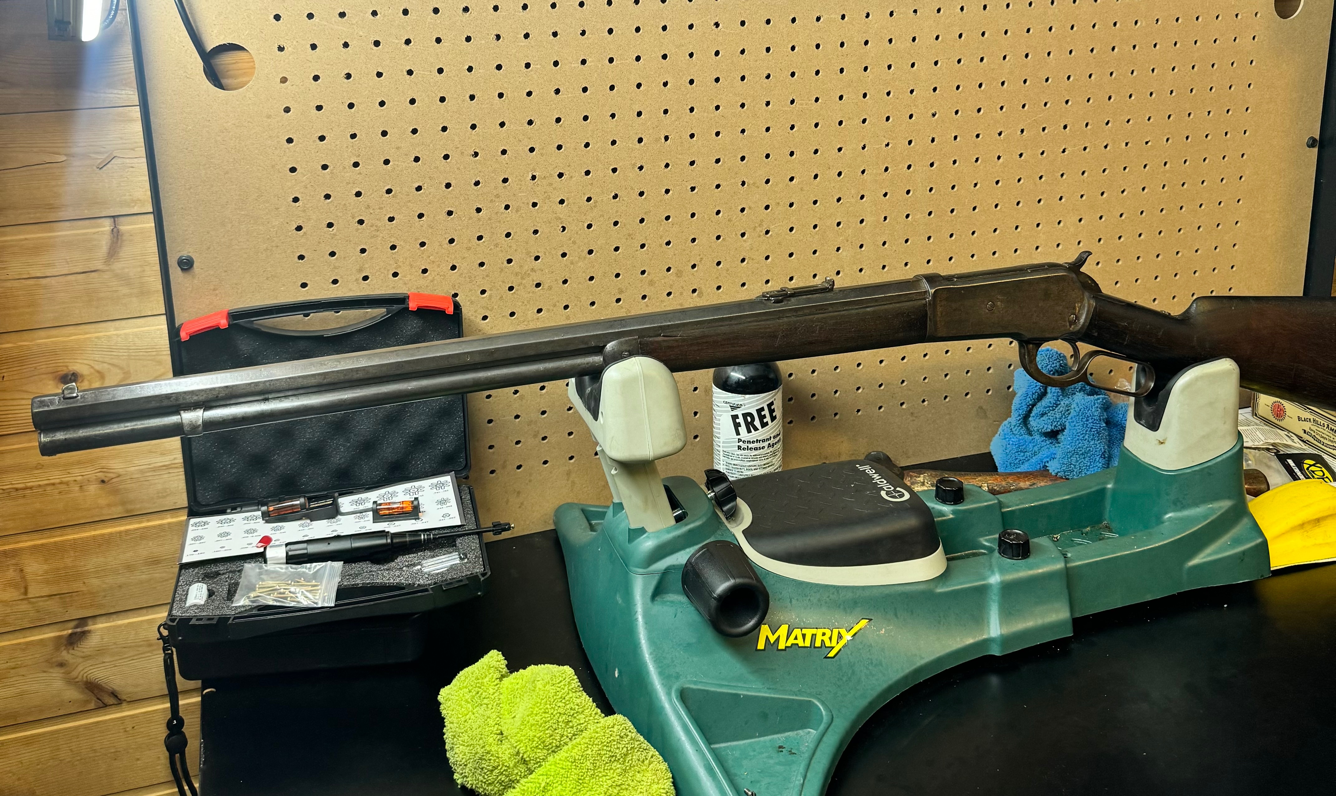

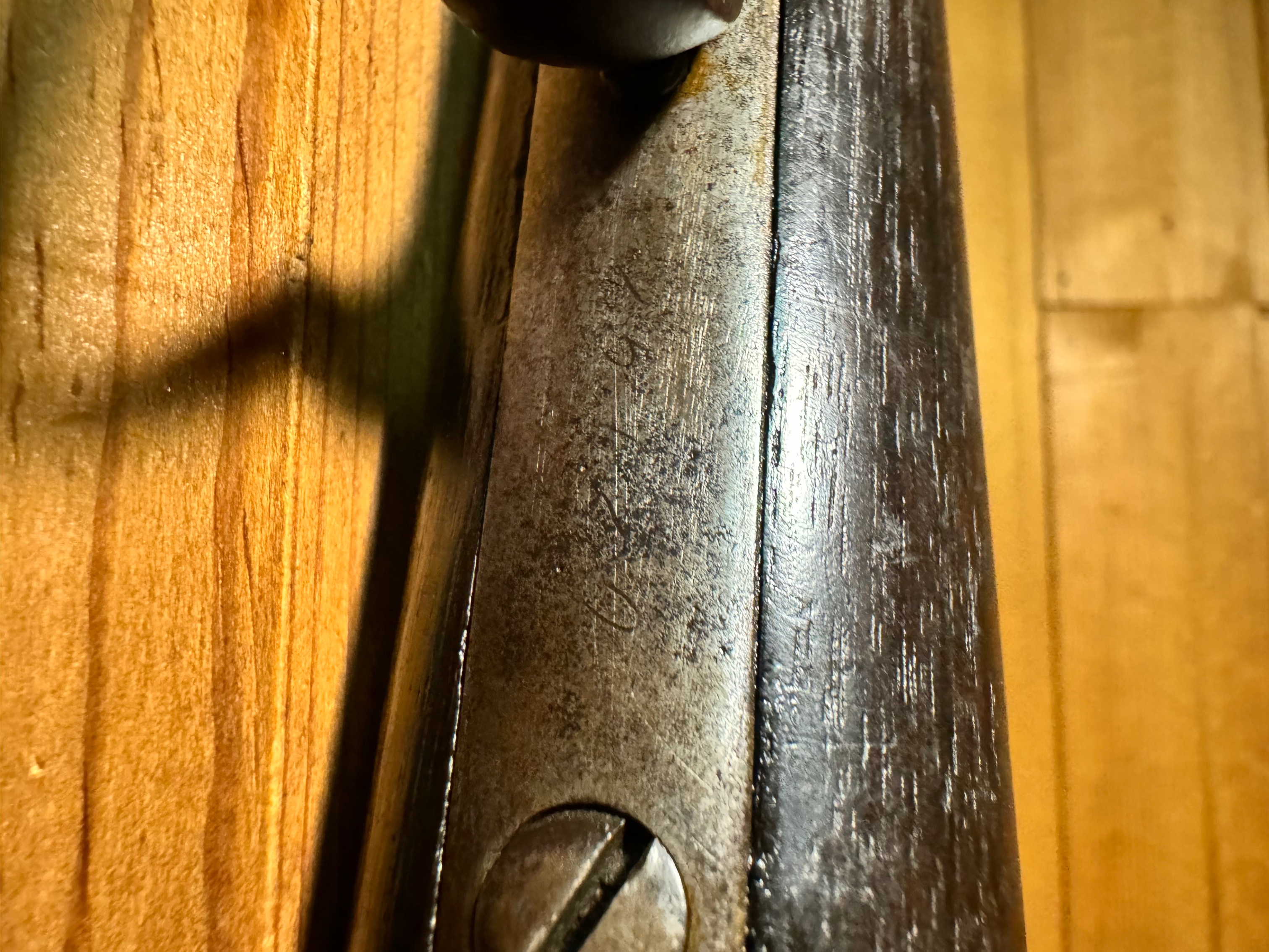

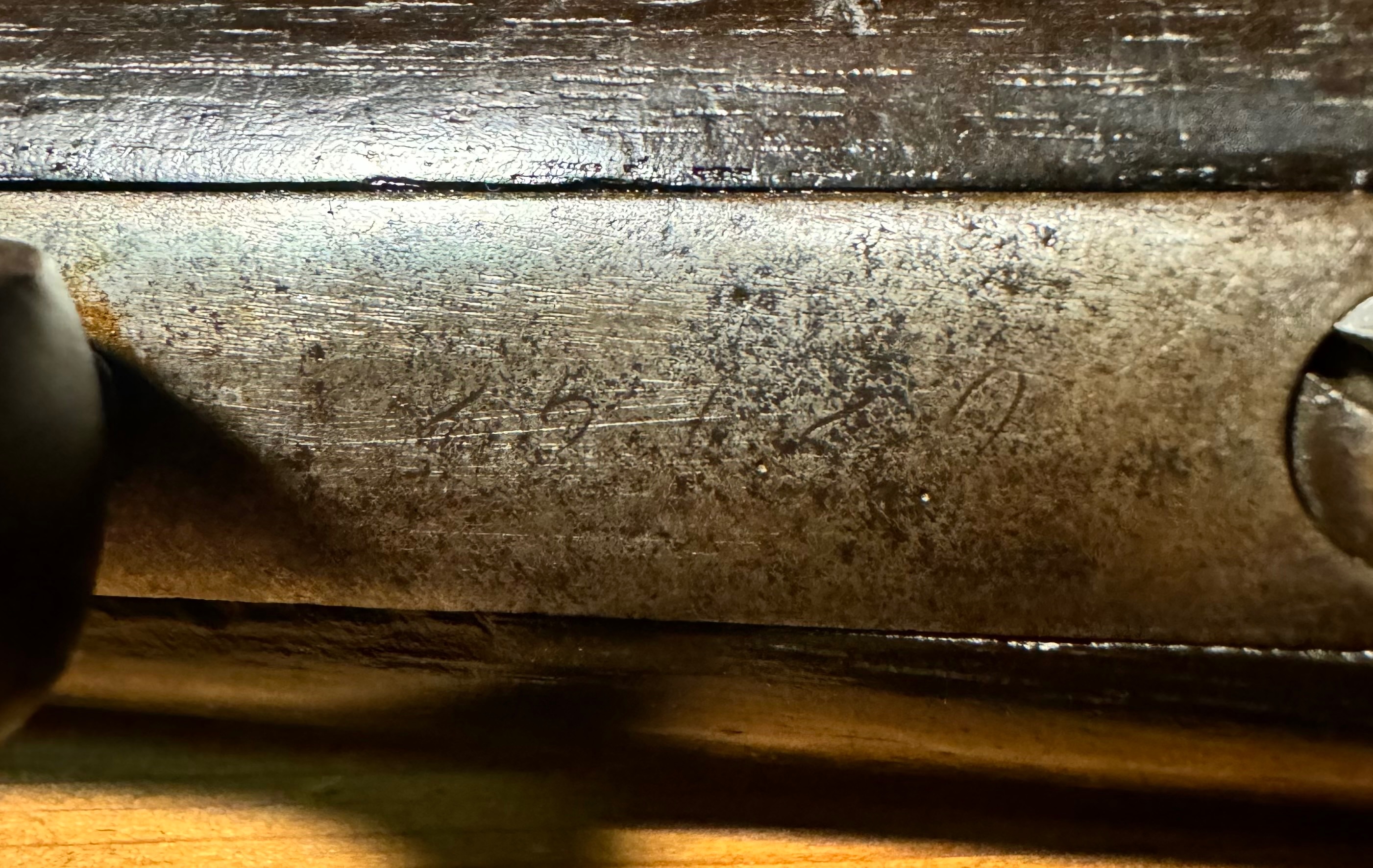

Bought a Winchester 1886 rifle a while back and it was in eh probably 4-5/10 condition. Shoots great and action is smooth. But the serial is rough to see, I think I can make it out as 25420 but does anyone have any tricks to “raise” rough to see serials?

Can you post a clear close-up picture of it?

IMG_1752.jpegHere you go

It appears to be 25120
The first thing I would do is have the CFM check serial numbers 25120, 25420, and 25720 to see which one of them matches the configuration of your rifle.

I gotcha I was curious if that was something I’d be able to do without ordering a letter for all 3 of the possible serials, only reason I thought it might be 4 instead of 1 is the space between 5 and 2

If you are a CFM member, you only need to request the research sheets.

Cowboy, My money is on 25420. I would call and give them the configuration of the gun you have and the three serials you think it is and if they have a match have them send you the sheet on it but if there is multiple hits then you going to have the serial number lifted by acid.

The chemical method I demonstrated in the video is for serial numbers that have been completely removed or that are missing due to corrosion.  In that case, it’s necessary to polish out the area which, of course, destroys any remaining finish. The area can be “aged back”, but it’s nearly impossible to exactly match old, pitted finishes.
However, I have had some success with serial numbers that are mostly intact but difficult to read, using a less destructive method.  In that case, I wouldn’t do any metal prep or polishing and just lightly brush on an etchant with a Q-Tip.  Many times, the numbers will clarify with minimal impact on a degraded finish like we see on the OP’s 1886.  The finish has already been etched by light corrosion and pitting from natural forces, so the impact of the chemical etchant usually isn’t very noticeable when done.
I would certainly suggest trying this method on marginally readable serial numbers before polishing them out and using the more invasive method for pulling missing serial numbers that I showed in the video.  Mark

Another low-impact method is to try different lighting and a good camera. Even a basic smart phone camera properly used with the right lighting (I have good luck with LED lamps) from several angles will “see” things the naked eye will miss. I have used this method to identify lightly etched or stamped numbers on machine parts many times.

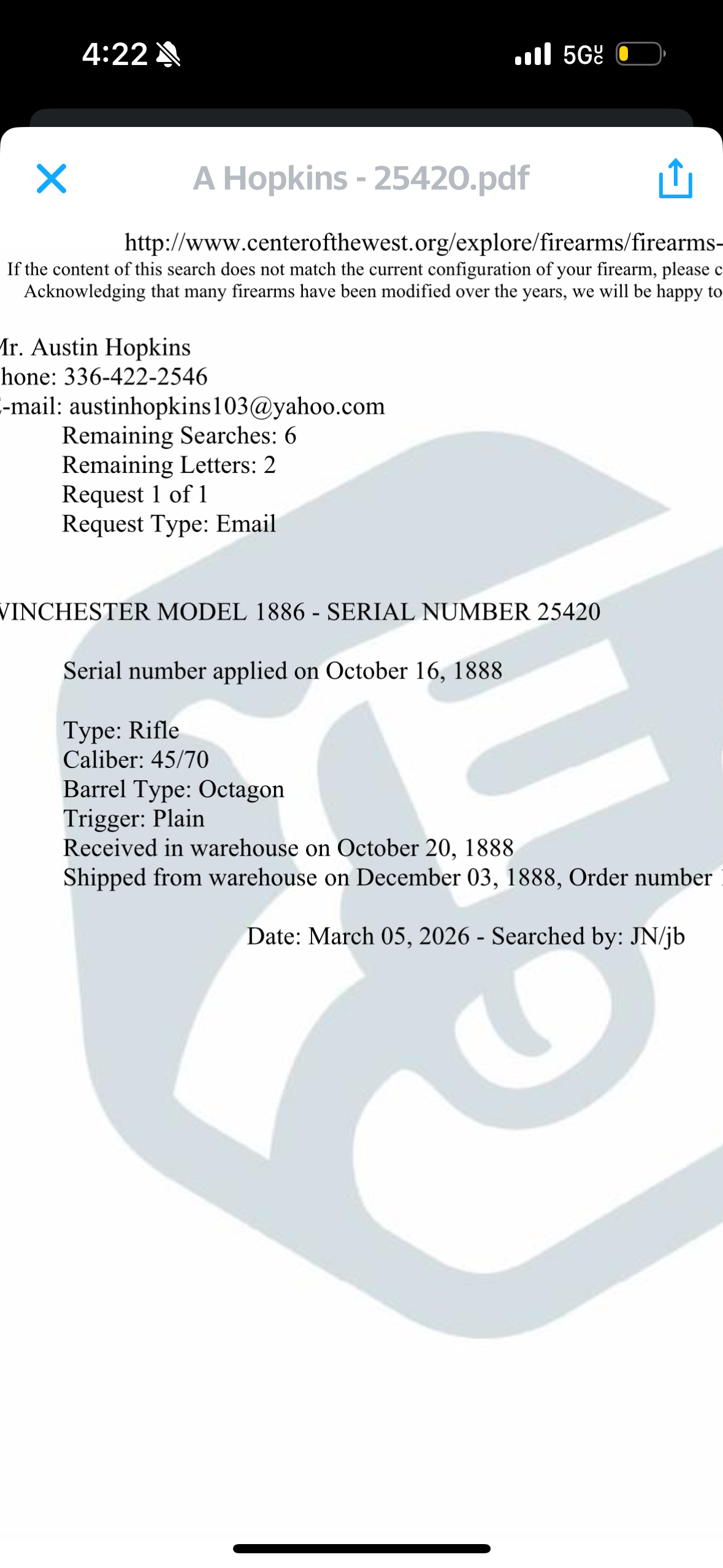

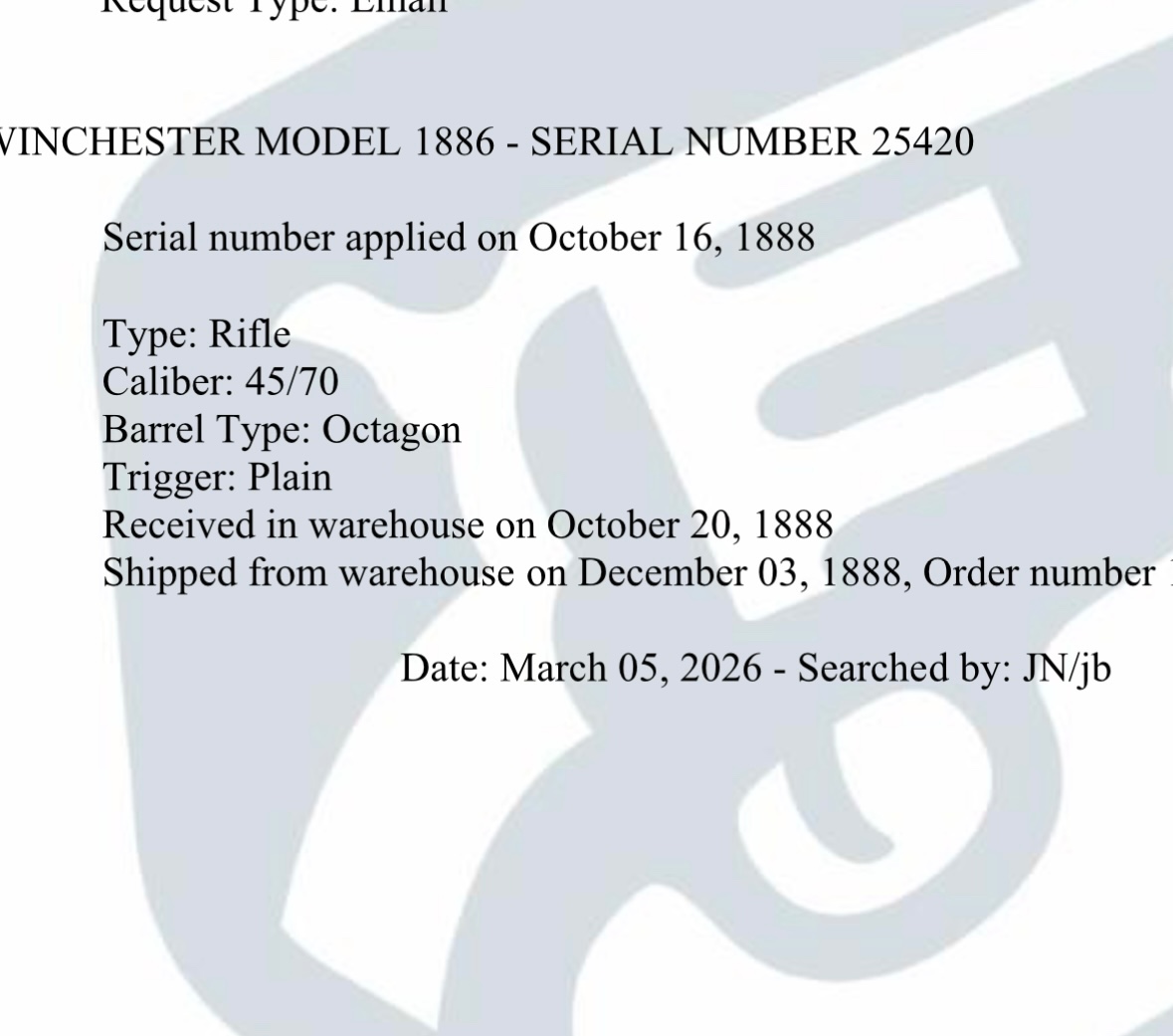

IMG_3712.jpegUpdate on the search, after trying 25720 which lettered as a 50/110 we tried 25120, it letters as a 40/65, so last one to try was looking like 25420 and I had my figures crossed and got the email back today and seems to be it!
