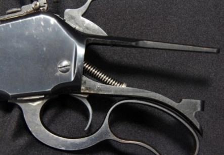

While the Model 1886 and Model 71 may appears to be the same externally, internally they were significantly different.  The first difference was the steel alloy used to make the receiver frame.  Winchester specifically stated in their early catalogs that the receiver frame on the Model 71 was improved and used Winchester Proof Steel.  The second notable change was the use of a coil-spring driven hammer versus the old style flat-spring used on the Model 1886.
I suspect that the rifle in question is a Model 1886 with a Model 71 barrel fitted to it…

Your Model 1886 has positively been rebarreled. Further, I would be very cautious about shooting it. The Model 1886 receiver frames were not made out of a suitable alloy steel for the 348 WCF cartridge. The Model 71 receiver frames were made using Winchester Proof Steel (chrome-moly).
