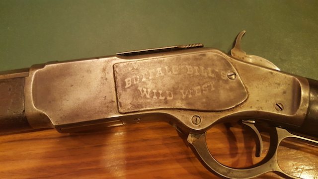

I looked at a 94 vintage 1873 today in 32 with a 30″ barrel that’s seen a good bit of use but still solid. On the left side plate it is inscribed ” Buffalo Bills Wild West”. It’s in an oval shape and looks just this one without the stars and name. Any ideas on being able to prove provenance?

The one on RIA is not engraved but acid etched. is this one acid etched?

It is. I have the pic now but can’t find the drag and drop feature.

That is a big fake. Look at the wood fit.

Your correct, the one on RIA has been redone but I haven’t seen mikec’s yet.

Here is the picture of Mikec gun. The gun has a old original look to it but the side plate looks a little worse that the rest. The problem with this type of etching or engraving just on the side plate that can be moved to any 73. First step is to letter the gun and see what it says.

Correct me if I am wrong, but I have not seen a reference or photos of Winchester using acid etching engraving. As I recall, Colt used acid etching on some pre 1900 pistols on the left side of the barrel for caliber markings. SSA, 1877, 1878 and others.
Walter
Forum Posts: 14956
July 14, 2016 - 2:25 am
I agree with Walter… I am unaware of Winchester ever using “acid” etching versus cut engraving.
Bert (still in Cody)
Forum Posts: 5002
July 14, 2016 - 2:45 am
Walter,
I have never seen Winchester itself use a acid etch either. I would imaging it was done by a outside party at a later date.
mikec
Forum Posts: 202
August 6, 2008
July 15, 2016 - 2:23 am
Walter,
I agree. If you look at the link I posted it even states that it was done later. I called Cody and it doesn’t address the acid etching. I’m guess I’m just trying to figure out if its period etched.
Forum Posts: 356
April 14, 2014
July 15, 2016 - 2:55 am
Hi,
 If Cody can’t answer your question, that is a tough question. Are Buffalo Bill fakes becoming the old Wells Fargo fakes?
Walter
Forum Posts: 5002
July 15, 2016 - 3:07 am
I take it you don’t own the gun yet from what you stated in the the first post so you can’t open it up and look inside to see if there are any special stampings linking the sideplates to the gun, my guess there isn’t going to be.  Just from looking at its condition it looks like the etching was done quite a while ago but you can’t tell how long ago. I did some searching on the Buffalo Bill Show and it says in 1893 they changed the name of the show to Buffalo Bill’s Wild West and Congress of Rough Riders of the World   and if this gun is a 1894 gun I would think they would of put the new name on it. It would take a lot of research into the Buffalo Bill show to find anything linking the gun to the him.
