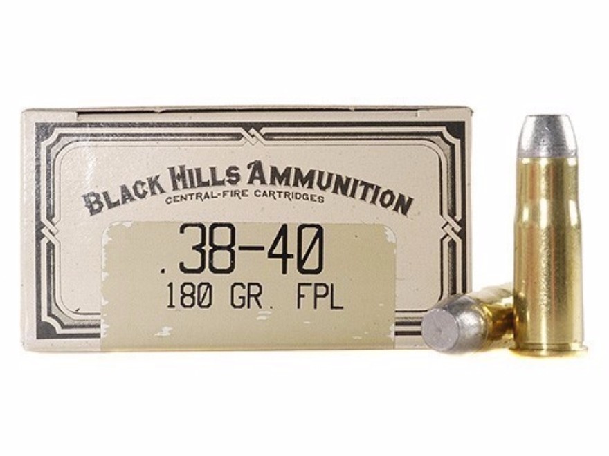

Hello David,
I shoot Remington, Winchester, and on the rare occasion Black Hills (lower velocity by about 25%) in my Model 1873 and Model 1892 rifles.  They work fine and I have never had a problem.

I use Starline brass, a 180 grain bullet I cast from wheel weights and a full case of FFFg black powder or a moderate charge of Unique to make ammo for my 38WCF rifles. Rifles like yours are a good reason to get into loading, maybe even casting.
