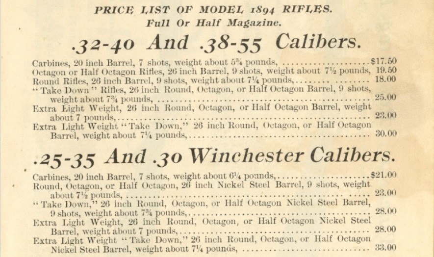

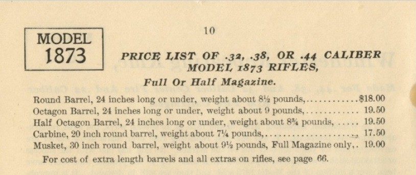

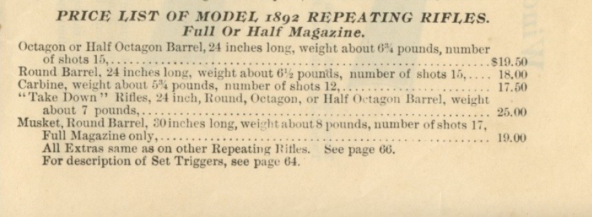

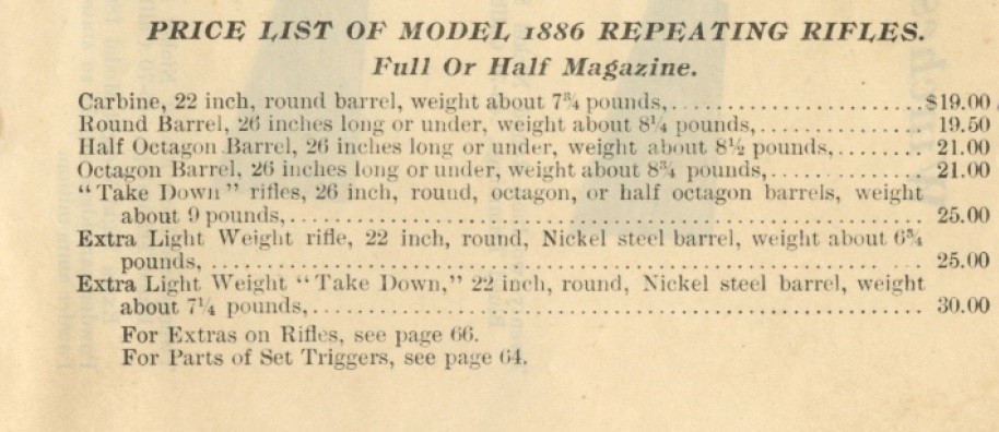

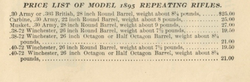

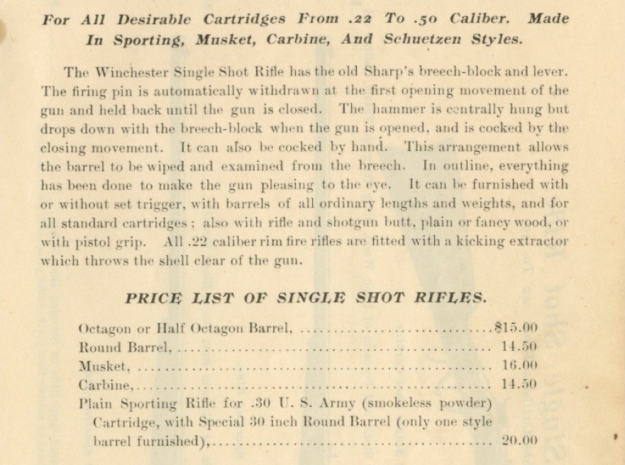

Nope… it was the opposite.  An octagon barrel always cost more than a round barrel. The attached pictures are scanned copies of an original Winchester catalog. The octagon (and half-octagon) barrel option was $1.50 extra for the lever-action models, and $.50 more for the Single Shot.
For the two models that I have studied & researched in great depth, the octagon barrels were much more common.  For the Single Shot model, octagon (including half-octagon) barrels comprised 85.35% of the total production through the year 1910.  For the Model 1894 Rifles, approximately 70% were manufactured with an octagon or half-octagon barrel.  I suspect that the ratios for the 1873, 1886, and 1892 were very similar to the Model 1894.
