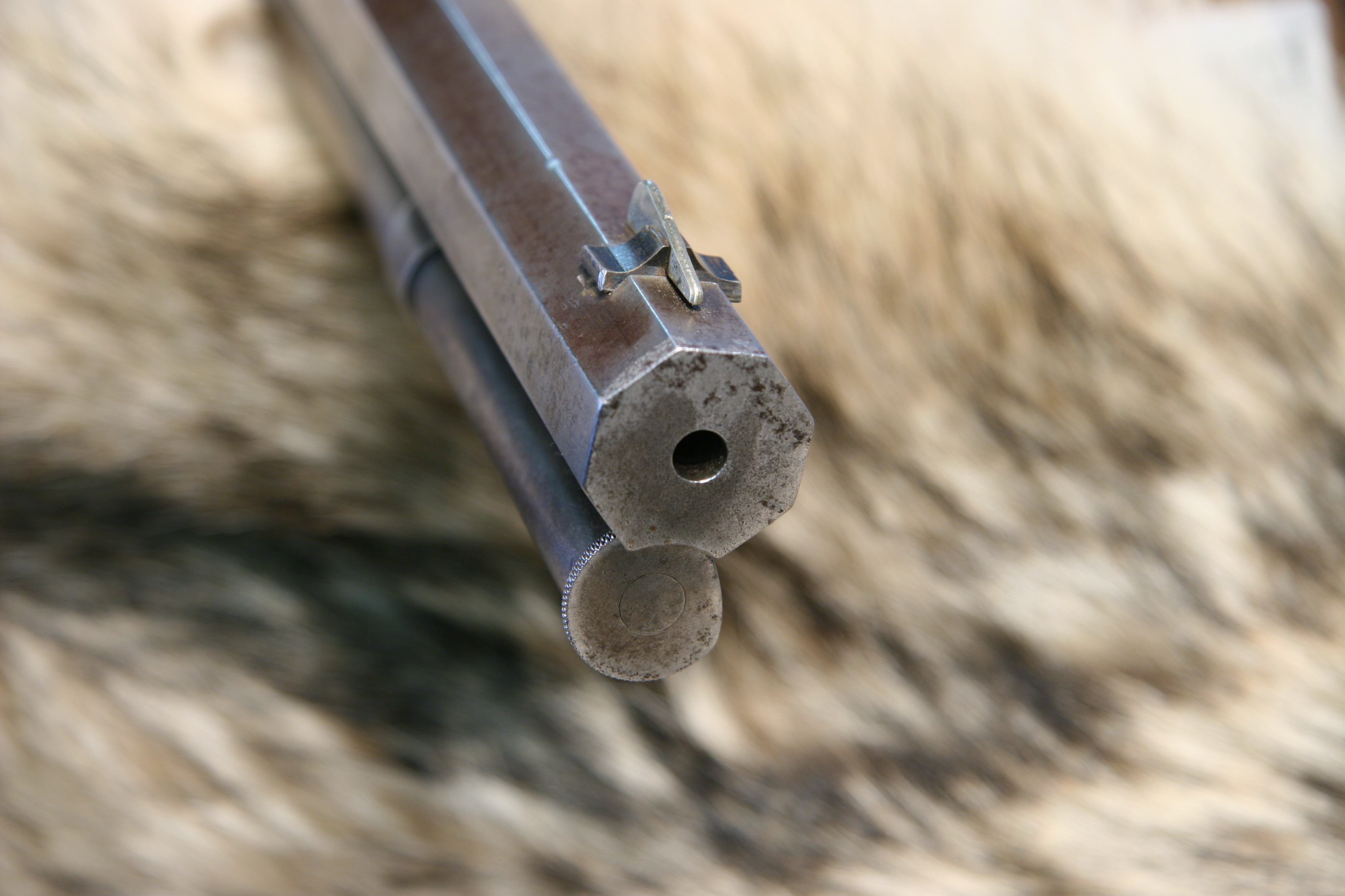

Forum Posts: 4995
July 14, 2017 - 2:32 am
This is the muzzle. Interestingly the gun lettered as 11 pound rather than Extra Heavy. With Nickel trim, set trigger and German silver knife blade sight
Forum Posts: 14830
July 14, 2017 - 2:38 am
Bob,
What is the barrel diameter across flats at the muzzle?

Forum Posts: 5862
July 14, 2017 - 12:18 pm
Bob and Bert – thank you for the posting of the photos.  I’ll stick to my assessment:  extraordinary.  My rough impression is that these two barrels are of the same muzzle diameter.  I will be interested to hear Bob’s measurement when he returns.

Forum Posts: 4995
July 16, 2017 - 1:04 am
Its 1.040″ at the breech and .988″ at the muzzle
Forum Posts: 14830
July 16, 2017 - 6:22 am
Bob,
Hmmm… that makes it nearly identical in size to a No. 3 barrel for the Model 1885 high-wall.
Forum Posts: 5862
July 16, 2017 - 12:26 pm
Same barrel blank used?  It would make sense that they would use what they had on hand.
Forum Posts: 4995
July 16, 2017 - 2:45 pm
When you get home measure yours at the 24″ mark. It might be real close. It just that yours is a 30″ it continues the taper farther. I’ve seen this with 30″, 32″ and 36″ 73’s when we did a barrel measurement survey, their muzzles have smaller diameters than standard length.
