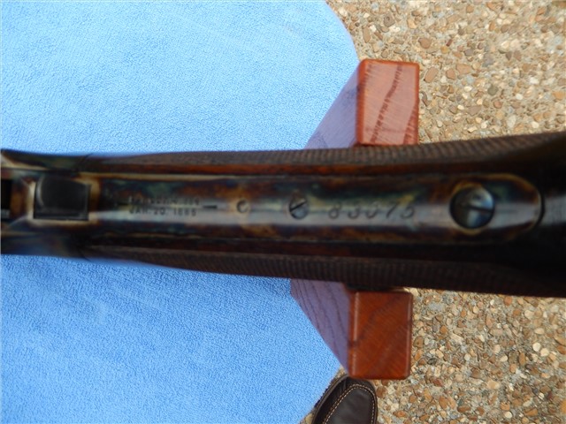

Here’s a beautiful 1886 deluxe that should have sold more a lot more $$$ (if truly original).
http://www.gunbroker.com/item/591083107
Kevin Jones
Forum Posts: 482
March 21, 2016
October 24, 2016 - 7:49 pm
Yes, a LOT more. States never fired.
Any opinions on if original or restoration?

The rifle does come with a letter of authenticity from David Bichrest (I believe is a WACA member).  If the letter is authentic, he must have had his hands on it and gave his seal of approval regarding its originality.  Odd that a rifle of this caliber ended up on Gunbroker instead of one of the major auction houses. Surprised nobody bothered to get a Cody letter either.  Maybe it came from an estate and nobody knew any better.
Forum Posts: 14956
October 24, 2016 - 9:08 pm
This is purely my opinion… that Model 1886 has been restored.
Forum Posts: 2548
October 24, 2016 - 9:47 pm
That one looks like a restoration to me, as well.  Finishes don’t look quite right to me, wood to metal fit, while respectable, looks like it is not as “proud” to the metal as might be expected, although still considerably “proud”.  Case colouring does not “quite” look like original 19th Century case colouring, finish on stock not quite as a “piano finish” might be, checkering appears recut.  Even if in pristine condition, this one just looks too pristine.  And, a Cody letter  has not been provided.  Again, my opinion, but seems suspicious to me…

Seems strange that the seller went through the effort of providing an authentication letter yet not a Cody letter……
Original or not; beautiful rifle!
Forum Posts: 5002
October 24, 2016 - 11:38 pm
Read the letter and see what it says and what it doesn’t say.
Forum Posts: 7745
October 25, 2016 - 1:38 am
I was thinking that as well. Same could be said of a restoration. Pretty sure the absence of a Cody letter is not an accident.
Forum Posts: 1179
October 25, 2016 - 1:59 am
Cody letter or not, the authenticity letter only attests to the configuration for the most part, does not state that it in “original” antique condition.  The rifle has been restored.  The color case hardening doesnt have the right mixture of colors, too many browns, blue, and greys, not enough of the yellow, green, or the right tone of red.  The barrel also looks to be refinished and an the barrel address was partially obscured but then the first line was overstamped as it is much deeper than the adjacent lettering.  The checking on the wood looks to be re-run and the finish on the wood is not the typical “piano” finish you would normally see on a gun like this as mrcvs pointed out.  That being said, for some folks it doesnt matter whether it has been redone or not just so long as its a decent job of looking like its new.
Forum Posts: 7745
October 25, 2016 - 2:25 am
I see what you’re talking about with the lettering, Chris. Wood just doesn’t look right to me, not sure it isn’t new. Receiver looks like it has spent some serious time on a buffing wheel so I guess that lettering has been redone as well. Very nice-looking rifle in my opinion, just doesn’t add up.

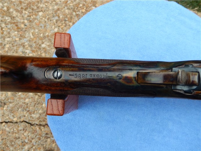

Another inconsistency for a “looks unfired” gun is the upper tang area.  There is a scratch above the peep sight screw that is consistent with having had a tang peep sight mounted.  Add the fact that the tang peep sight filler screw is not an original Winchester screw and the tang screw itself shows screwdriver marks and the finish on top of it is worn while none of the other screws have a worn surface.
