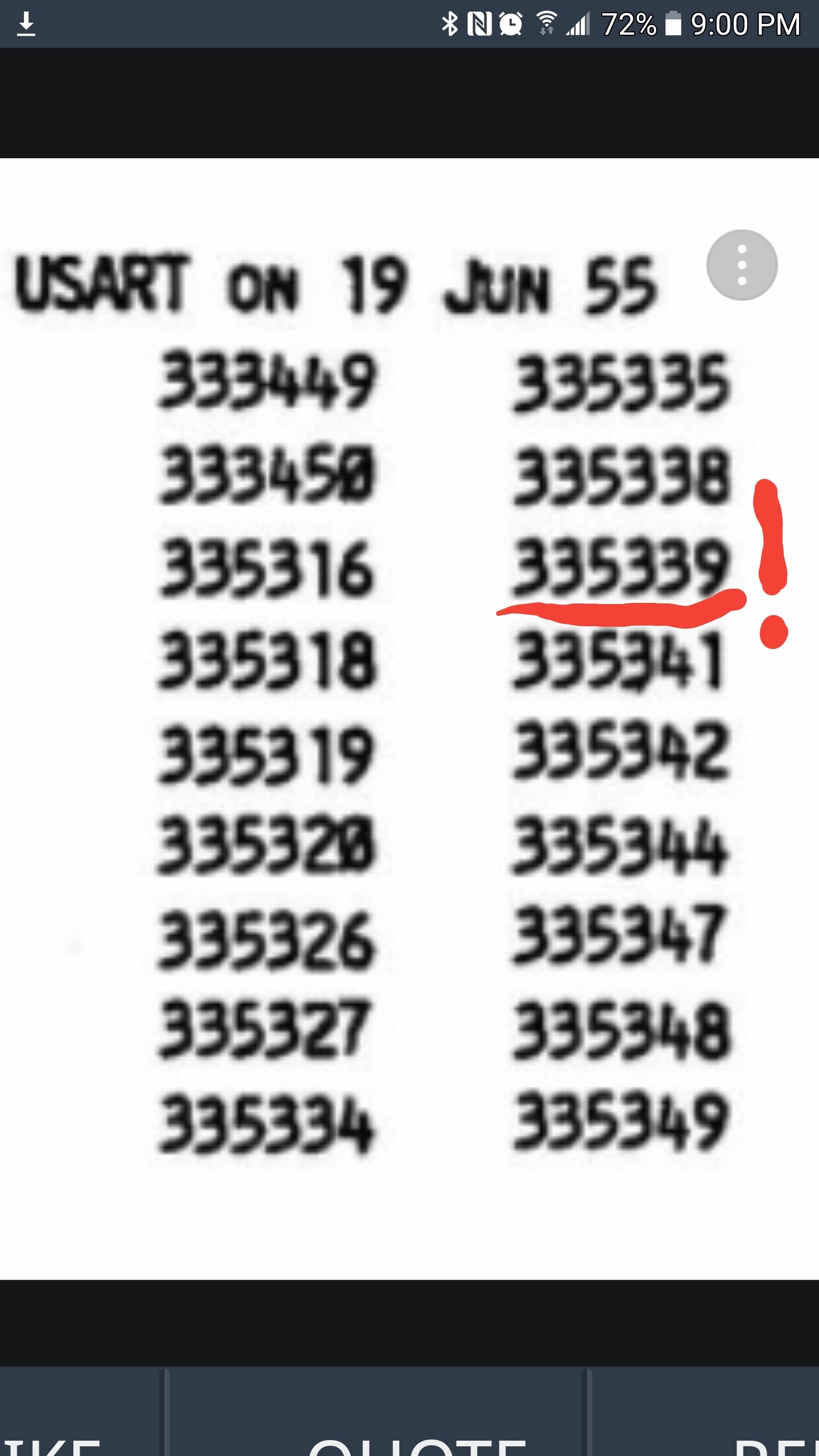

Sealed the deal on this rifle last week. It is listed in Chandlers DFA as having shipped to the US Army Rifle Team on 19 Jun 1955.

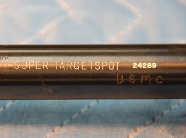

Interestingly enough, it has a USMC marked Lyman STS mounted and was (as the story goes), used by a Marine shooter as his comp rifle. I am still trying to get as much info as I can from said individual.

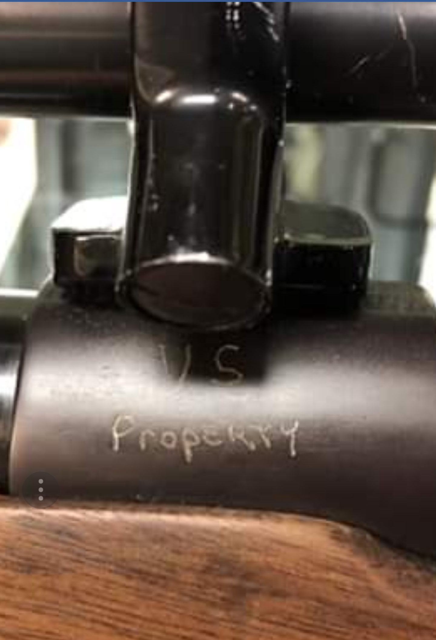

These are the only pictures I have so far. When I get it in hand, I will document it from one end to the other. Still wears the factory barrel and nothing has been changed best of my knowledge. 20181031_102527.png20181031_102502.png20181031_102430.png20181031_102400.png20181110_175204.pngScreenshot_20181105-210115.jpg

Beware of USMC marked RTE. 99% of it is fake. Big Larry

The rifle is not USMC marked, only the Lyman. Scope markings and serial number range are consistent with 2 that belonged to Mr. Chandler and another that was shown in inventory.

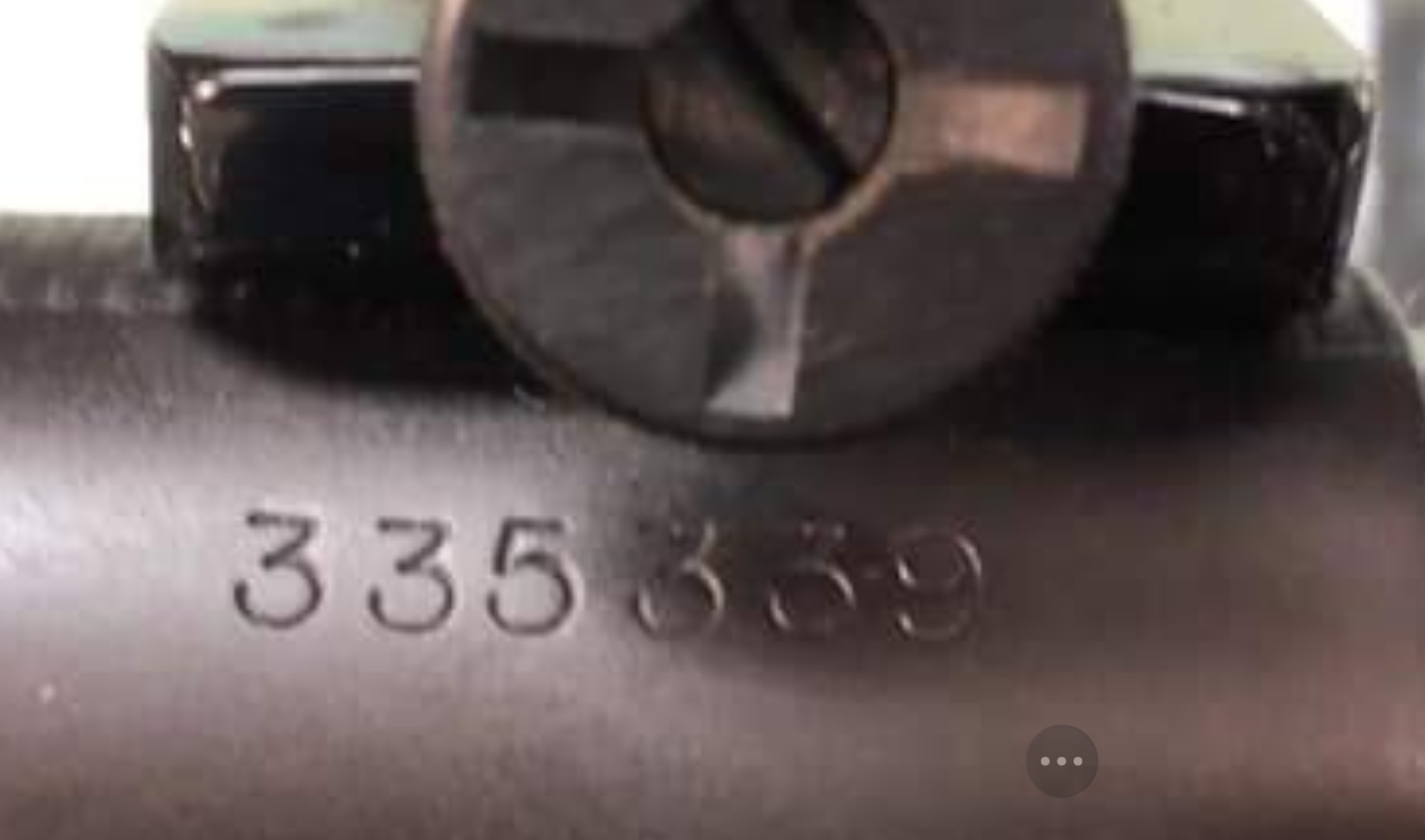

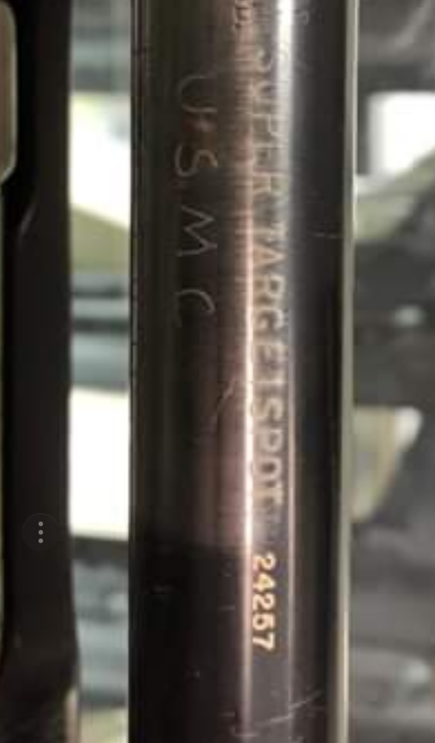

Your Lyman STS was originally shipped to the USMC in 1967, it is not a fake. That info come’s directly from the Lyman journals. Actually yours and the other you show in a later picture were shipped to USMC  on same day in 1967. Both began life as 12X with standard crosshair reticle.

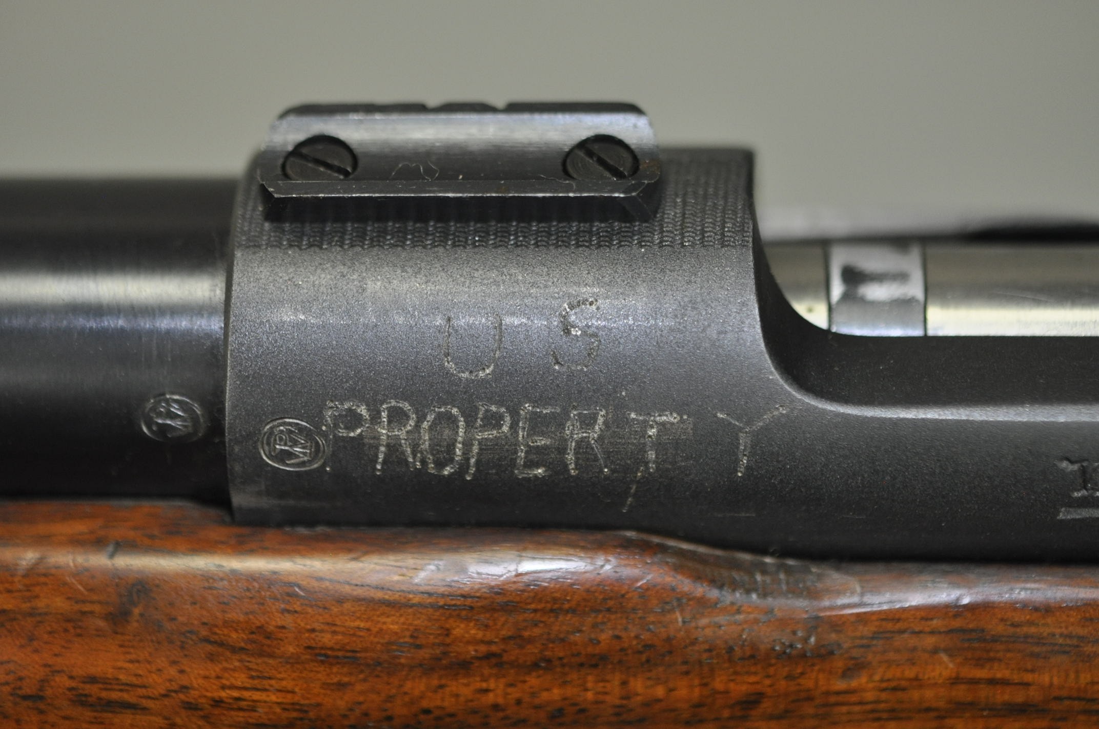

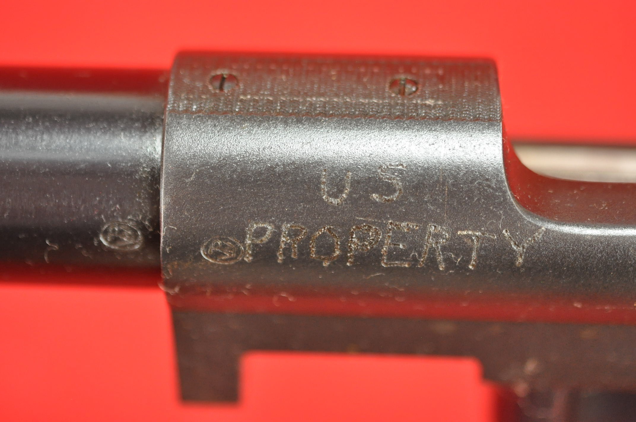

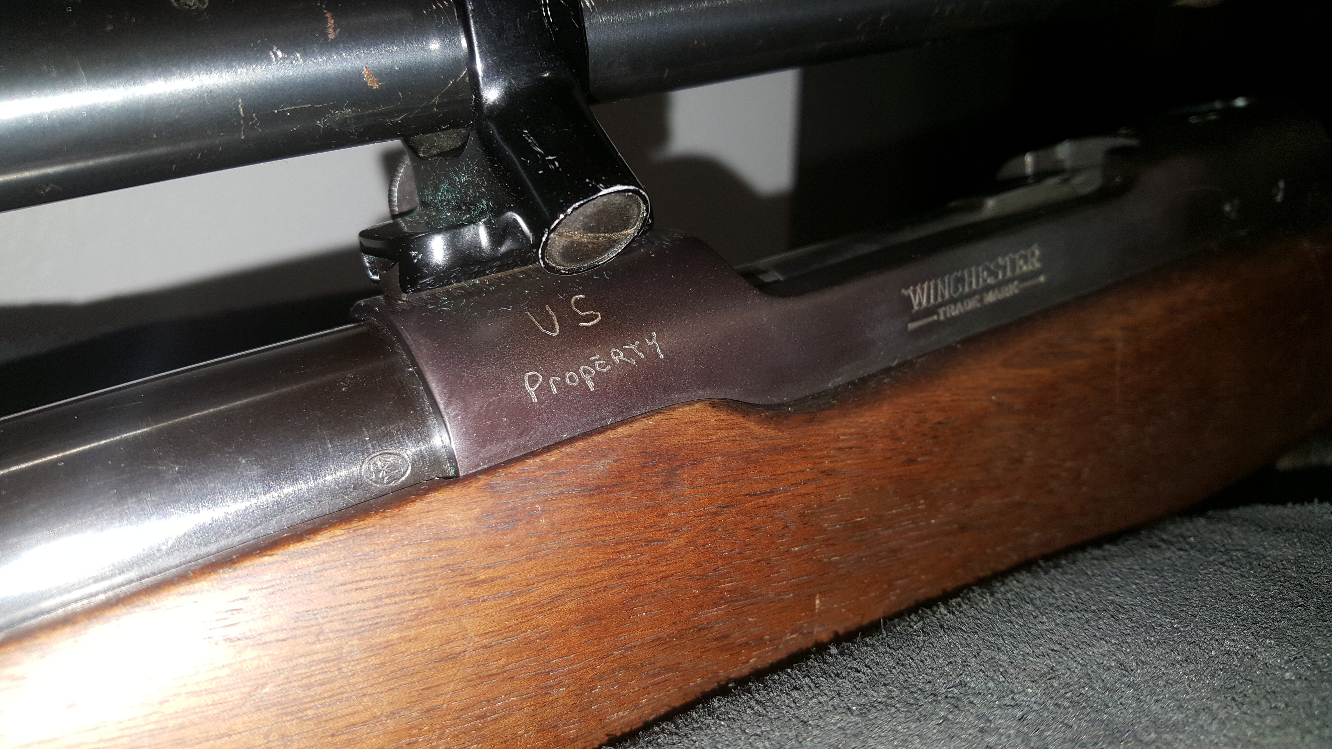

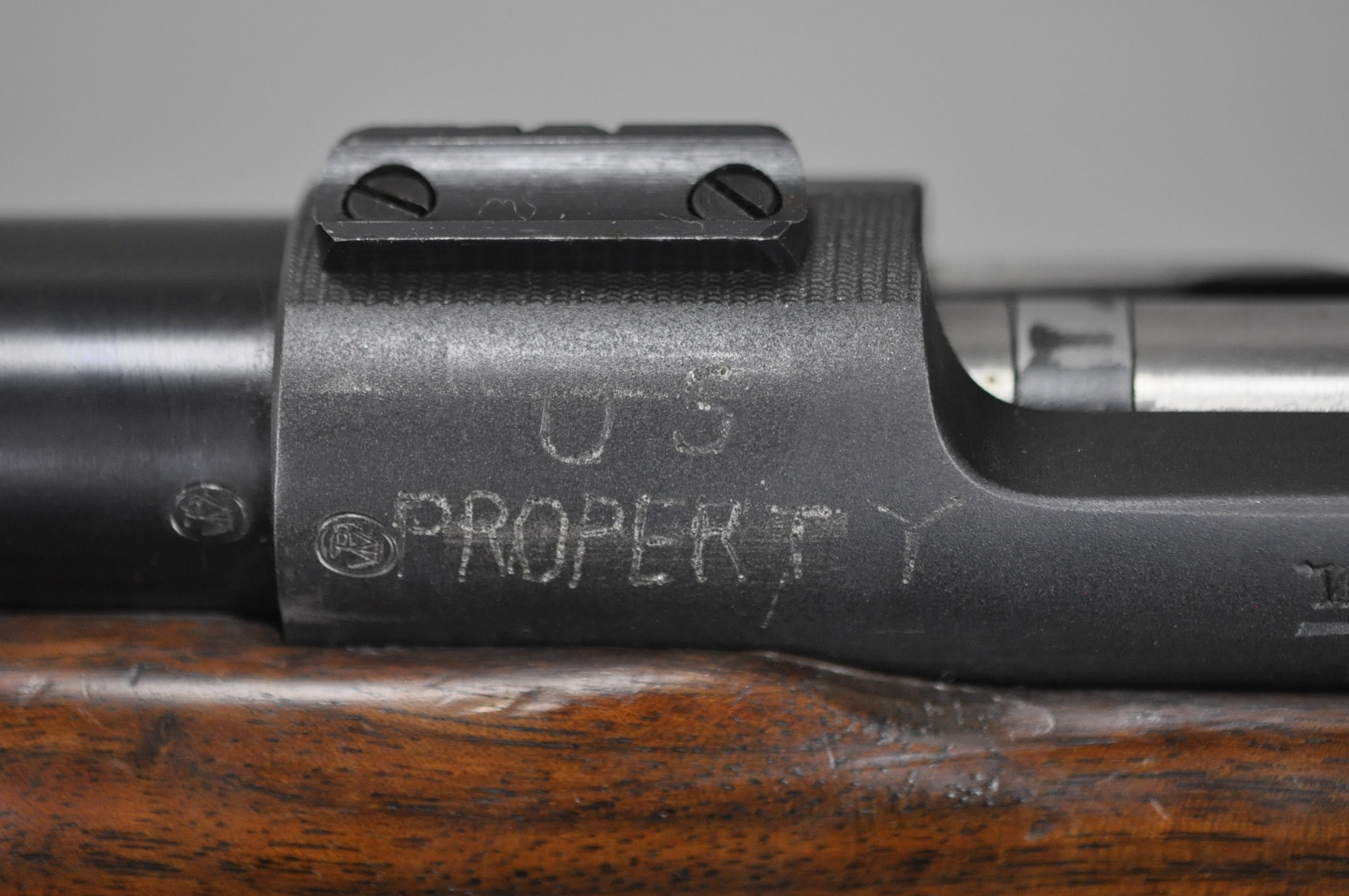

I have never seen a “U.S. Property” marking on a 70 like the one shown in your picture. All of them that I have owned and seen have the marking done with an electric marking pen and are horizontal on front ring. Cannot tell for sure from picture, but yours look’s more like a vibrator pencil marking. I am relatively certain that model 70’s earmarked for Government contract were marked at Winchester at Government’s request. The 52’s I have seen with same marking are done exactly the same way and even look’s like the same person marked them all based on the style of lettering. The 52’s were marked at factory right before packing. Most likely yours was done either at Evaluators Ltd, or at the base which received rifle.  See picture attached, for 2 different rifles. By the way my Van Orden is not marked with any such markings at all. It was shipped to a Government base in Philadelphia.

It is my understanding (albeit limited compared to some of you), that the Army marked their own rifles.

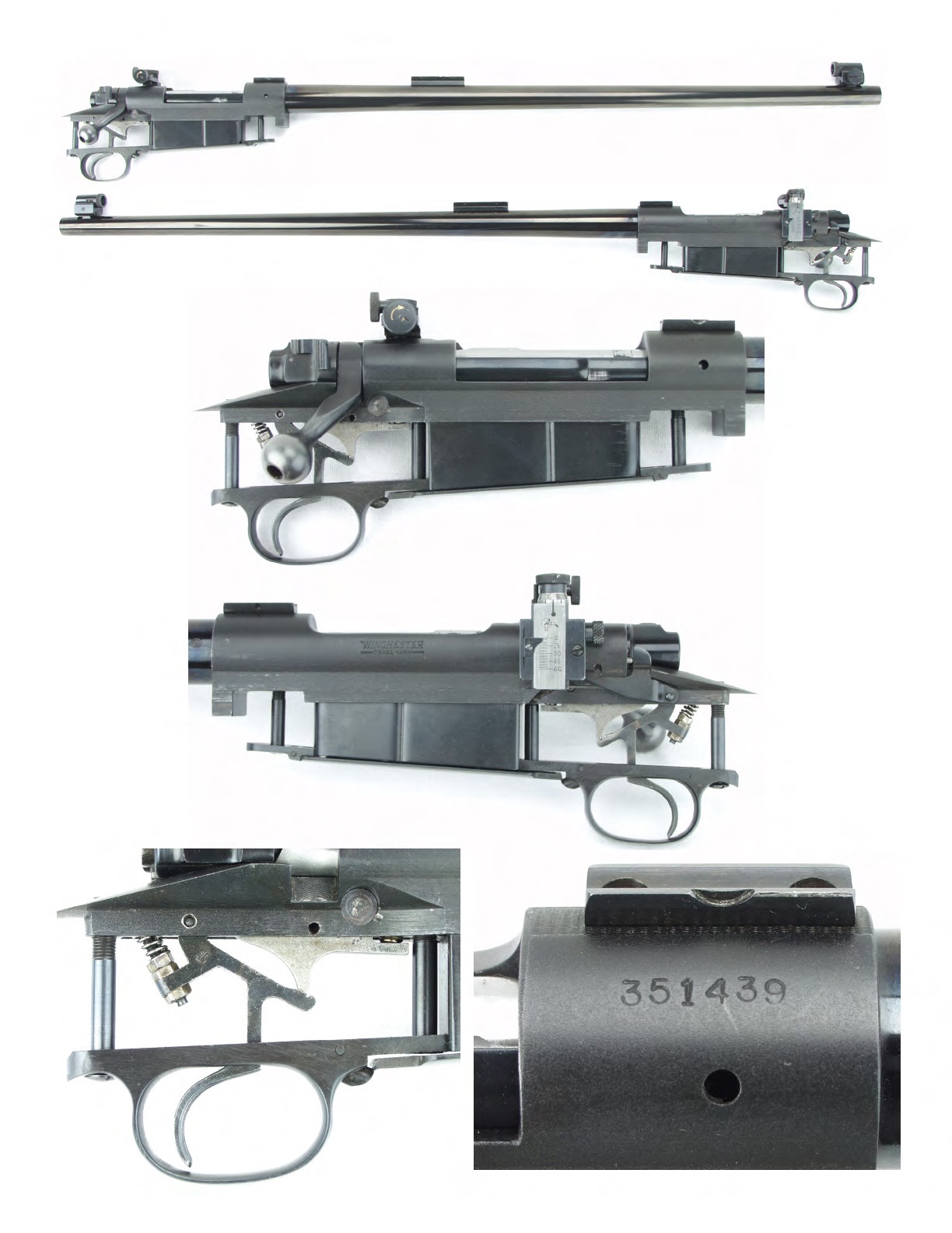

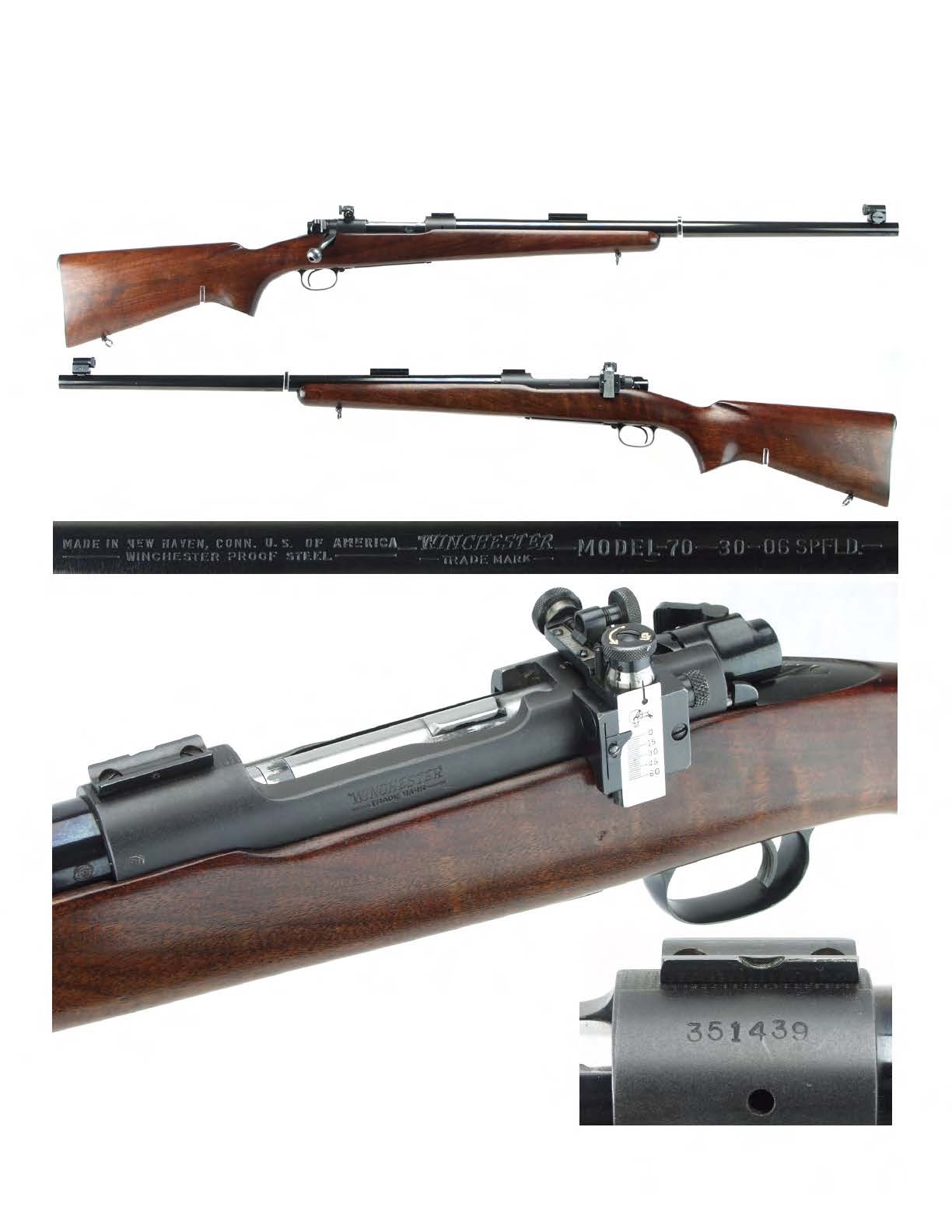

I cannot comment on the military property markings.  Mine (S/N 351439 shown above) was one of the civilian sold Van Orden Snipers that was never US Property.  But the stock on your looks good.  If you get the chance when the gun is in-hand, consider providing the butt stock dimensions (LOP, drop, and pitch).  These Van Orden sniper stocks had unique special ordered butt stock dimensions matching the Springfield ’03 National Match rifles (and different from the standard M70 stock).

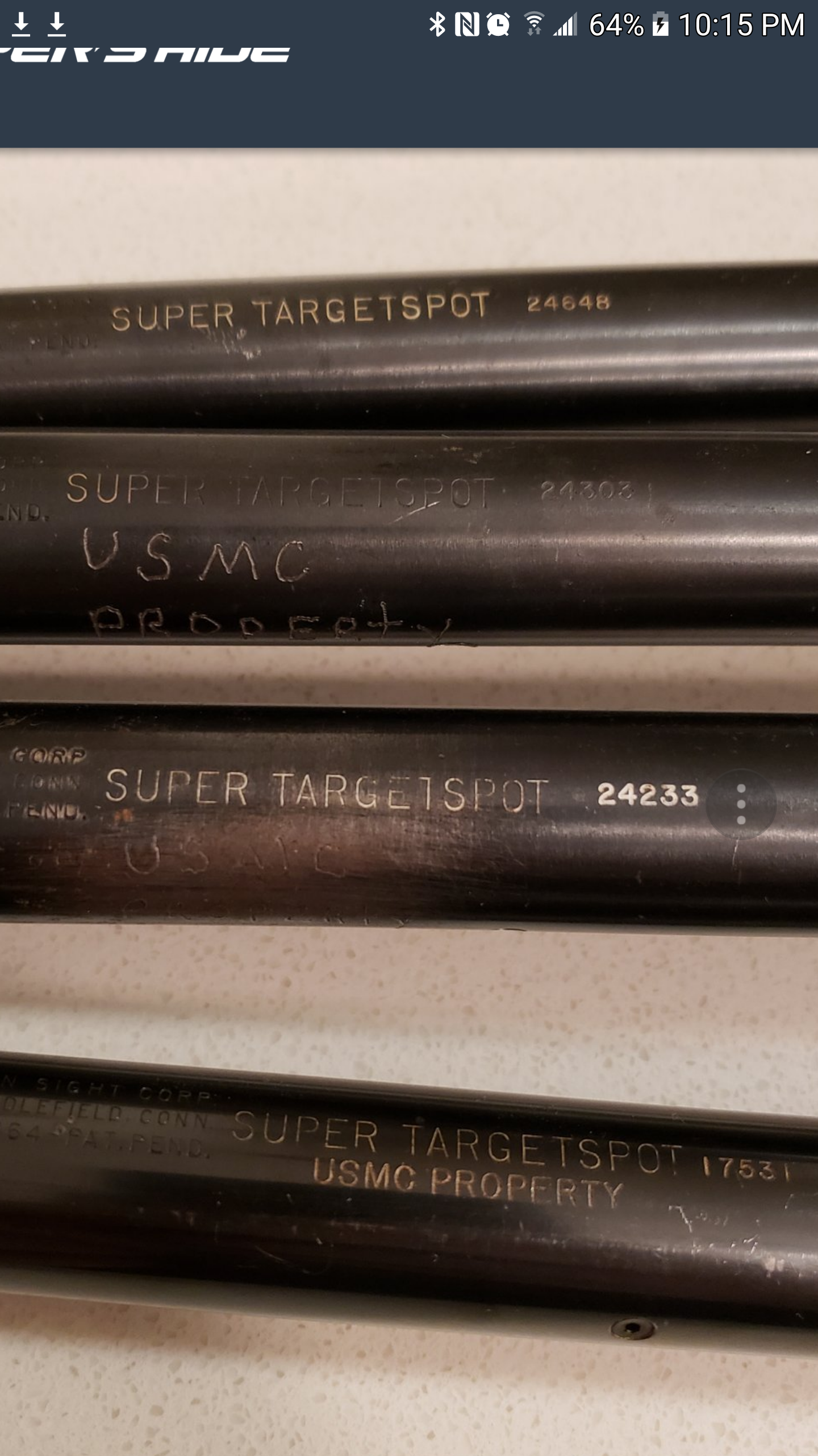

This is the first time I have heard of this existing, are there set serial ranges of the scopes?  Or how many are there?  I would love to hear more detail about this.
I have the Lyman purchase documents with the Marine teams pre WWII, and also during WWII.  I also do have WRA purhcase documents of rifles for the teams pre WWII.  What is also interesting is I have the counts as well from 1954 when all the team equipment was moved from the Philly Depot to Albany, and they only detail they only have 12 total of the 12X Lyman SuperTargetspot scopes.   They detail that the Supertargetspots were for the .300 Win Mag Model 70’s they had.   All the 30 Cal Model 70’s just detail they have the lyman receiver sights.   This was their total inventory as it was being transferred to Albany.
Is there something you would consider a trade over?  I have about 10,000 documents at least on the Marines and Army.   If there is something you research on that, I might have something that would help your research.
I know people say the 17,000 range is heavy in them.  But I’m like Big Larry, I get nervous when I see a USMC Property electropenciled on one of these, and you see tons of them out there.
I have one of the electric etchers, exactly like the ones the Marines purchased in 1938 from Ideal.  I know several people who do and they are also the same people who always seem to just magically come up with a new USMC property scope from time to time.  🙁

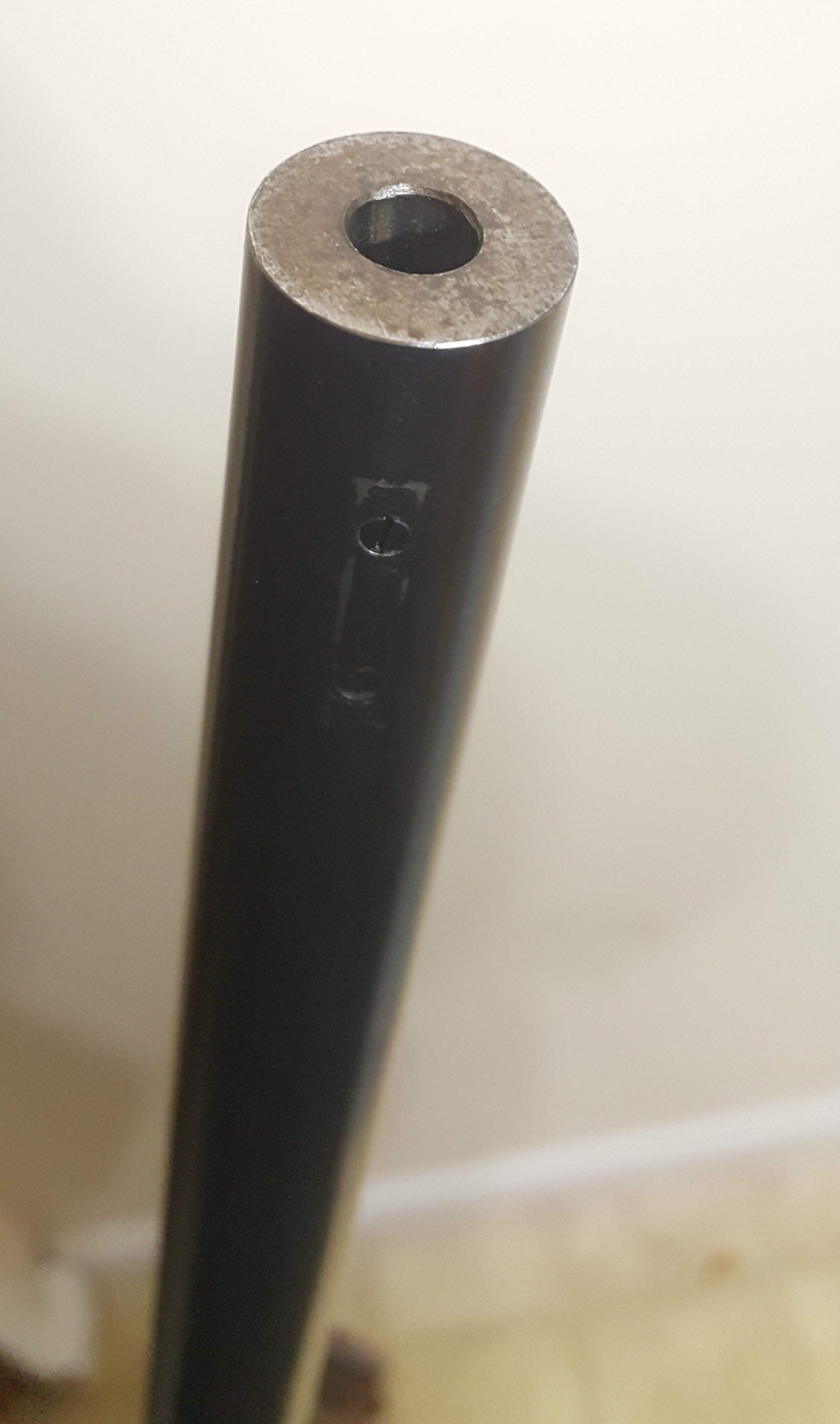

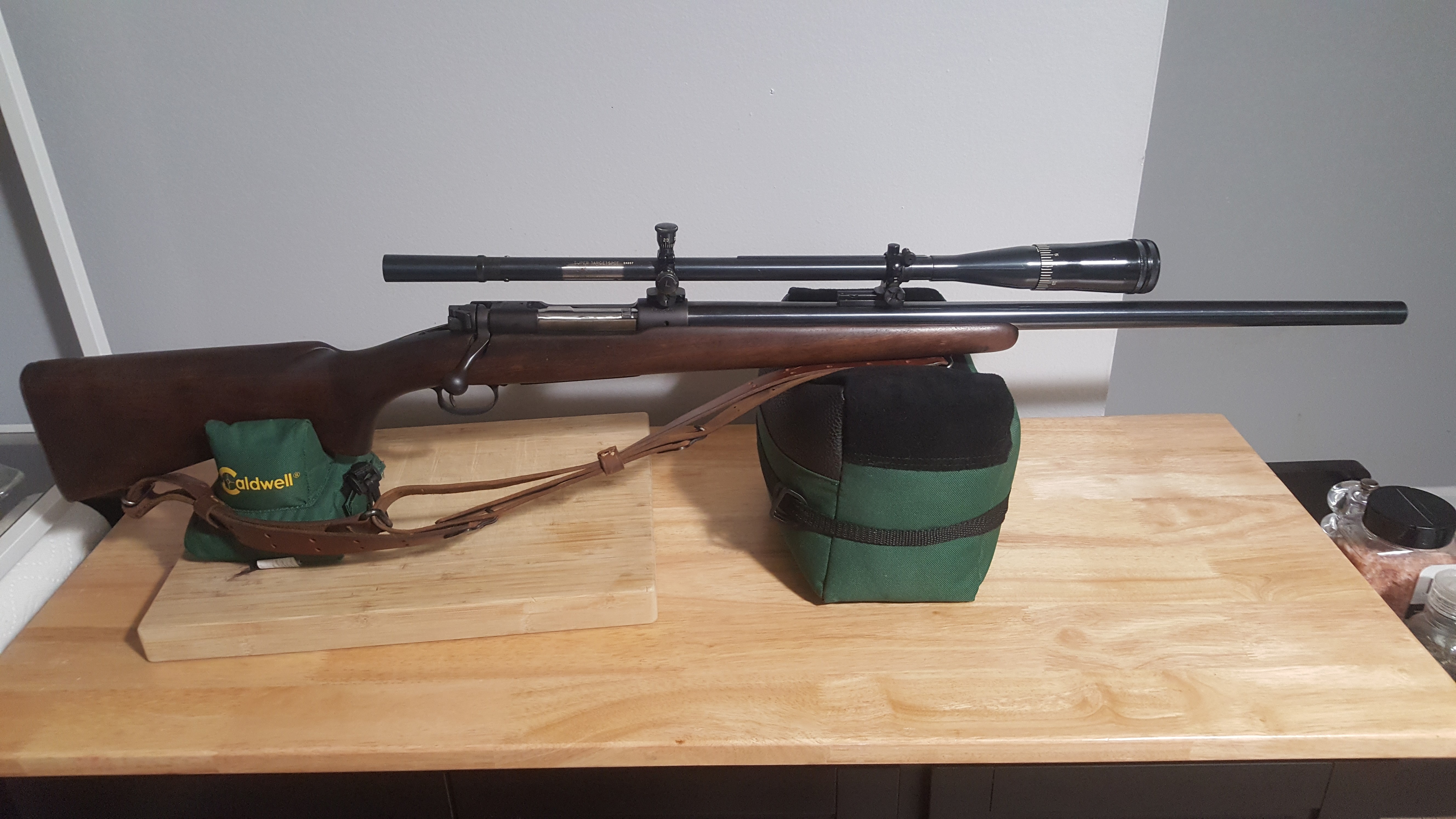

Picked up today20181117_165751.jpg20181117_170108.jpg20181117_165936.jpg20181117_170241.jpg20181117_214626.jpg

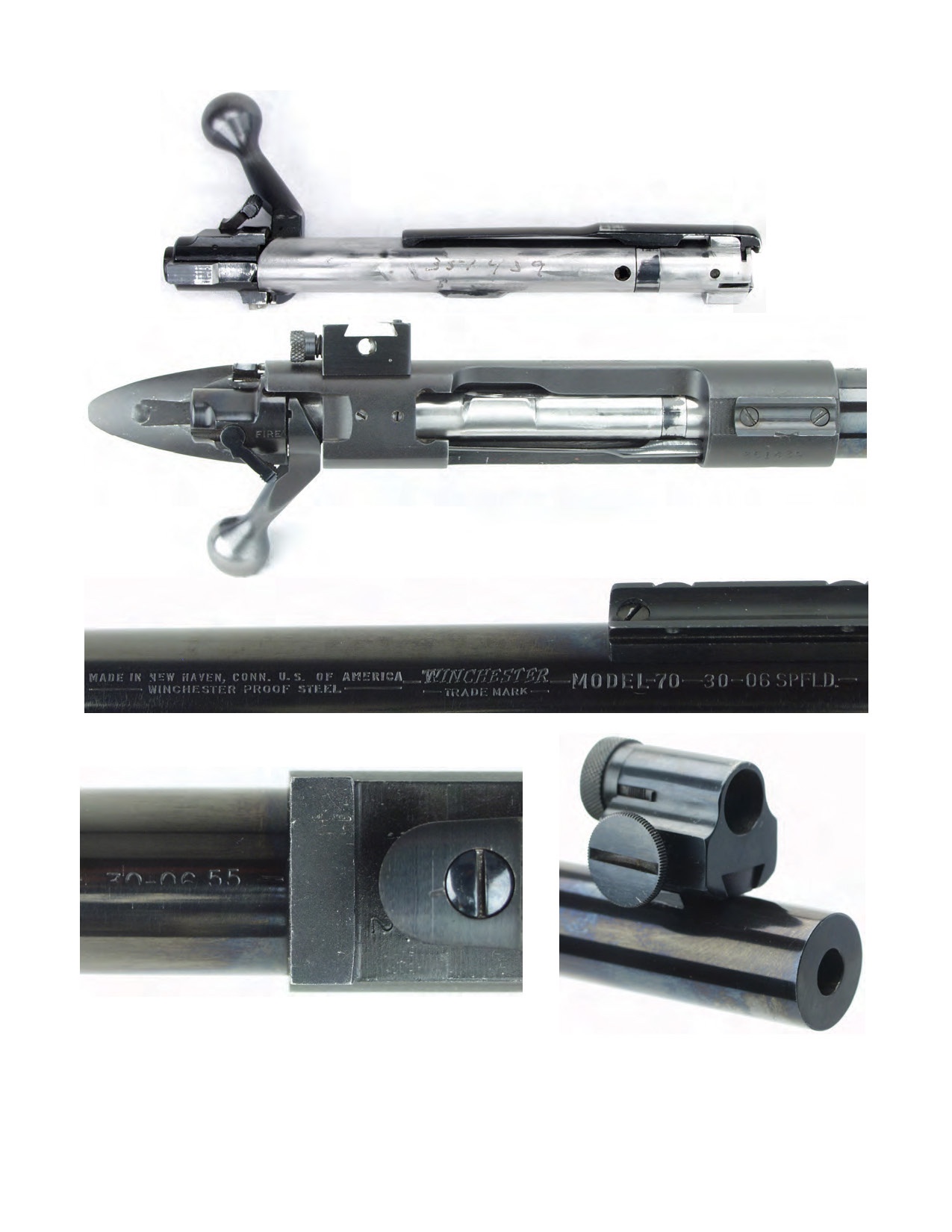

If it is of use to you, I’m attaching some composite photos of mine (S/N 351439) out of the stock.  I don’t think mine was “worked on” much after it left Evaluators Ltd, but I’m curious about any differences you might see between the two rifles:
M70-Van-Orden-Sniper-composite-A1.jpgM70-Van-OrdernSniper-composite-B.jpgM70-Van-Orden-Sniper-composite-C.jpgM70-Van-Order-Sniper-composite-D.jpg
Per the Van Orden literature, these rifles were shipped with a Lyman 48WH receiver sight and Lyman 77R globe front sight in AK block (as in the pictures), in case you want to put metallic sights onto your rifle. It’s clear yours once carried the AK block at the muzzle.
I’d be curious about the barrel date, whether there is any bedding compound around the action/recoil lug, and whether the barrel is “free floated” enough that you can slide a piece of paper between the barrel and the barrel channel.  Mine has no bedding (maybe traces of some Bisonite on the receiver bedding flat but no wood removed for bedding purposes), and the barrel is slightly free floated (compared to other M70 target rifles).  Enough that a sheet of paper will move pretty freely up and down the barrel channel, but not much more than that.

There is no bedding compound to be found. Barrel is free floated and wears a 56 date (so assuming a re-barrel at some point).
Looks to be identical to yours. As a side note- your photo skills are enviable!
