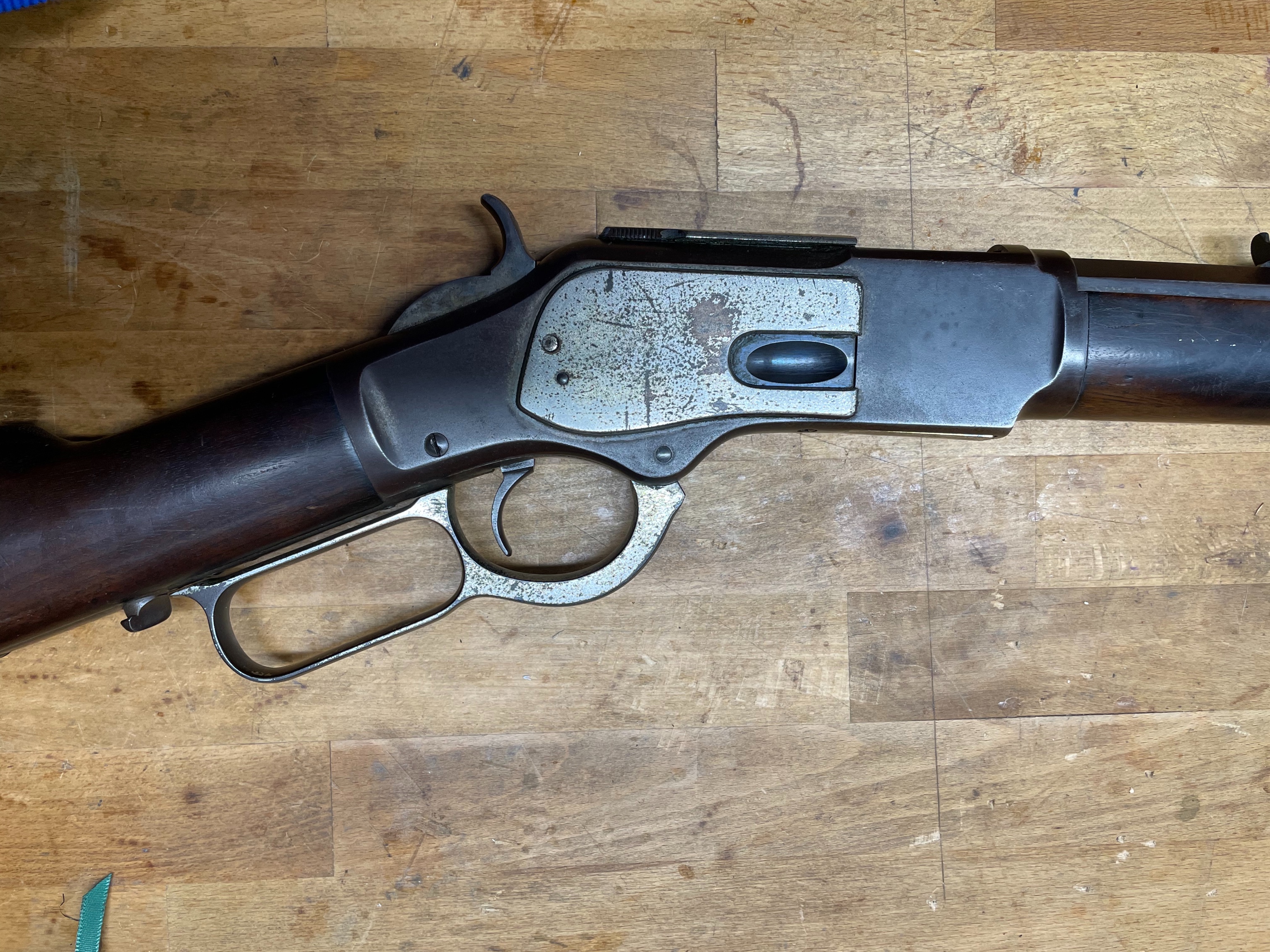

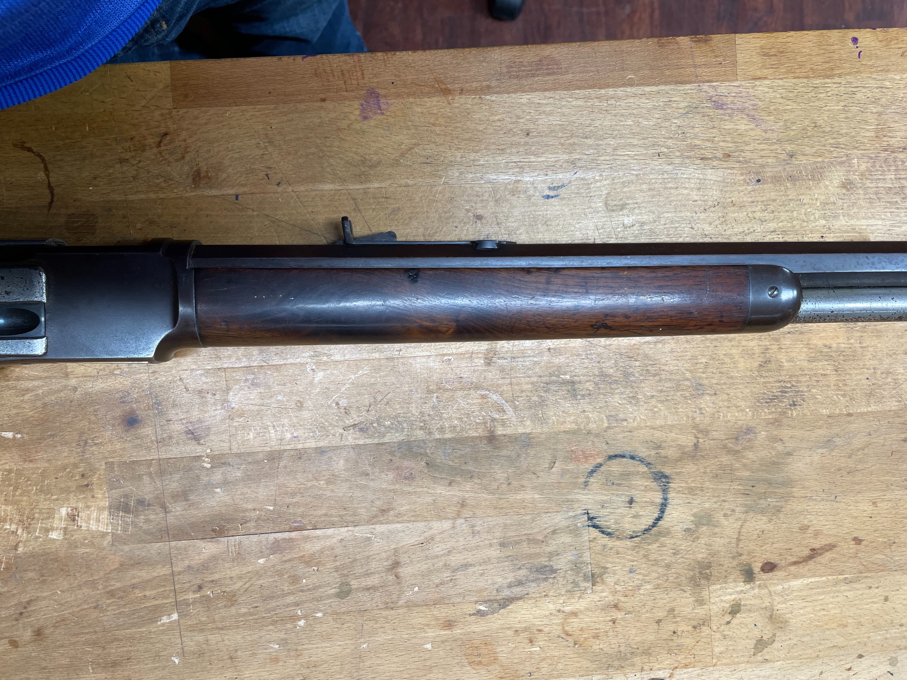

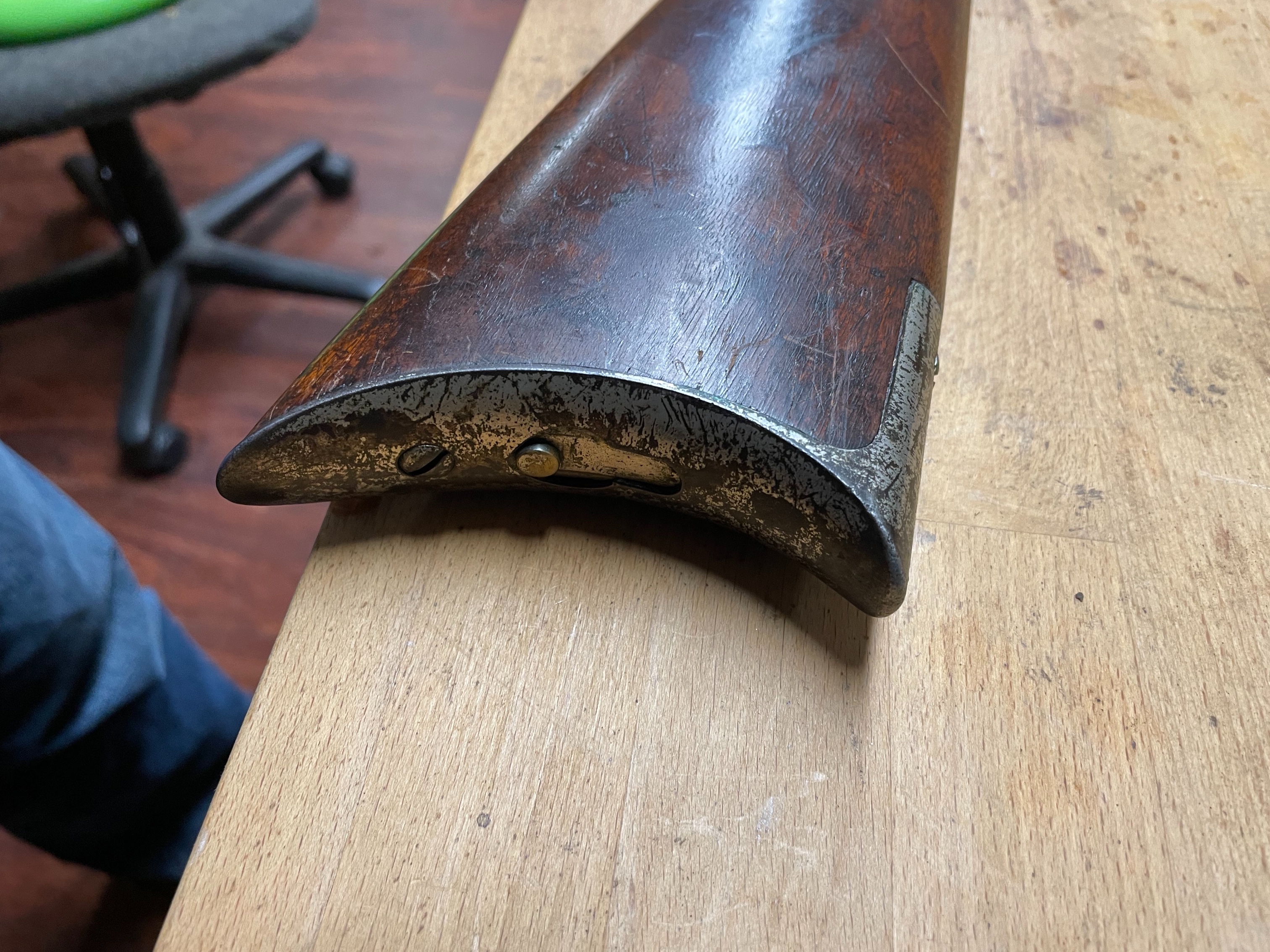

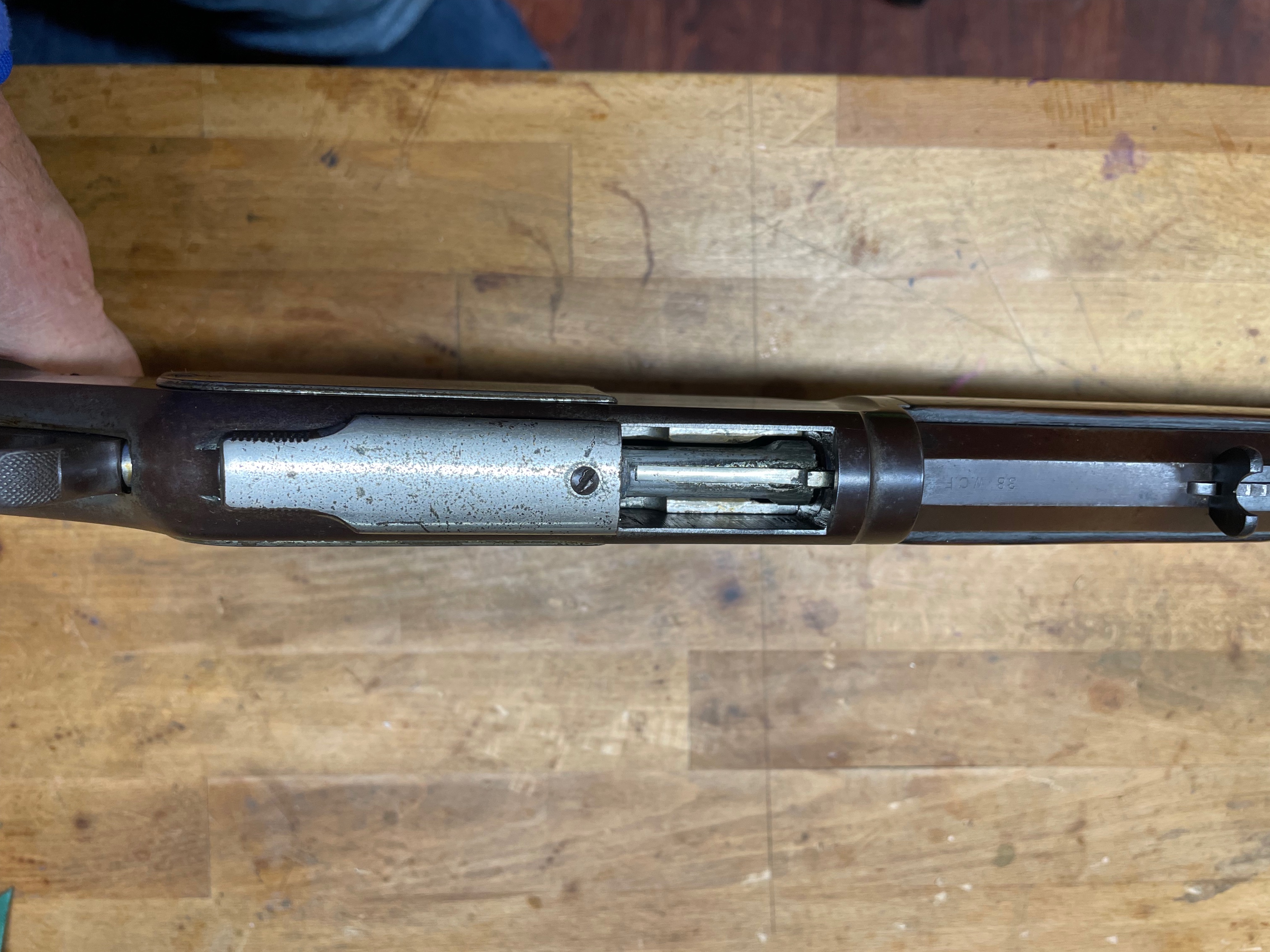

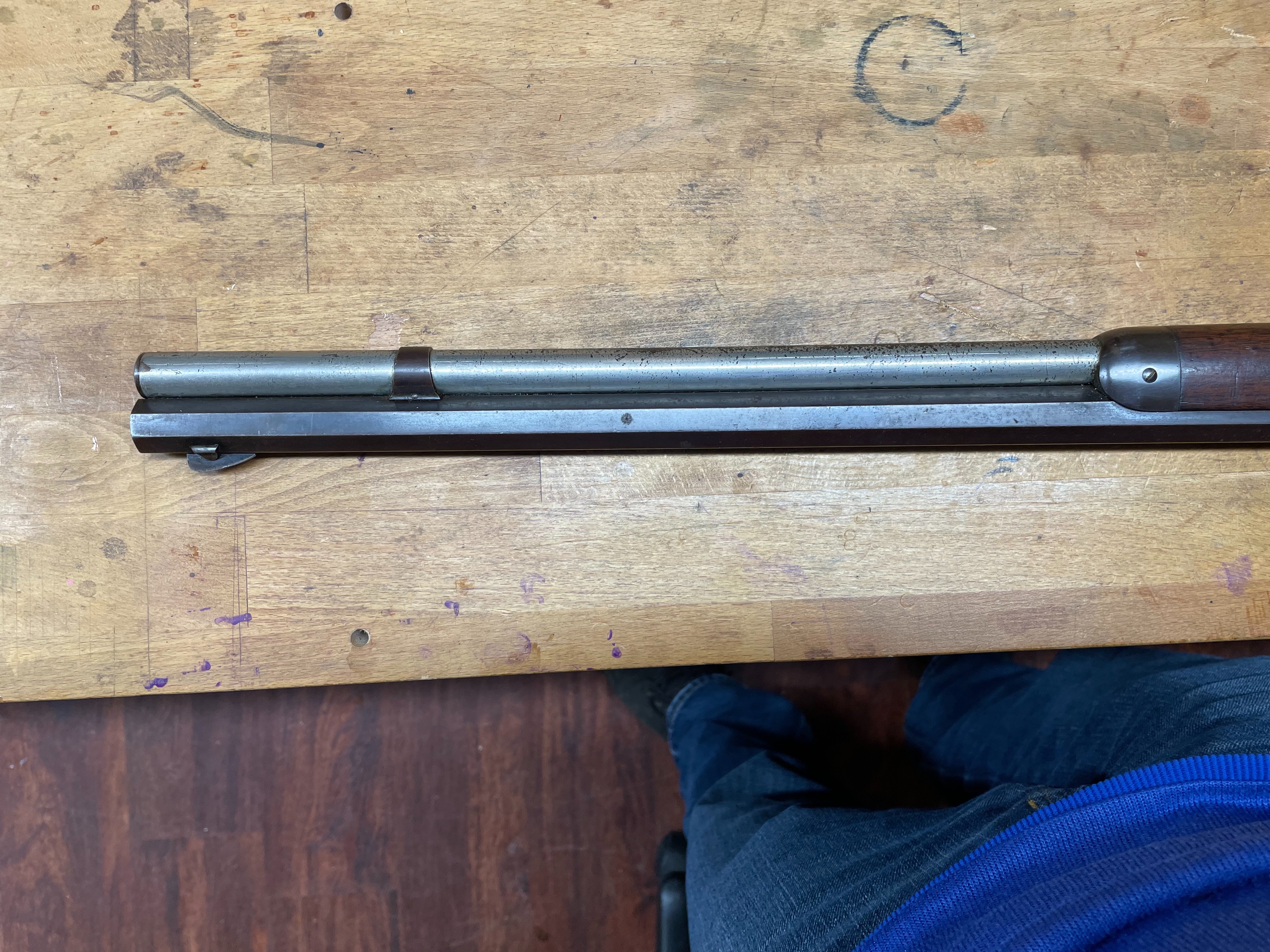

So wad y’all think?
I haven’t got a Cody letter yet. Serial number 250363B. 38WCF.

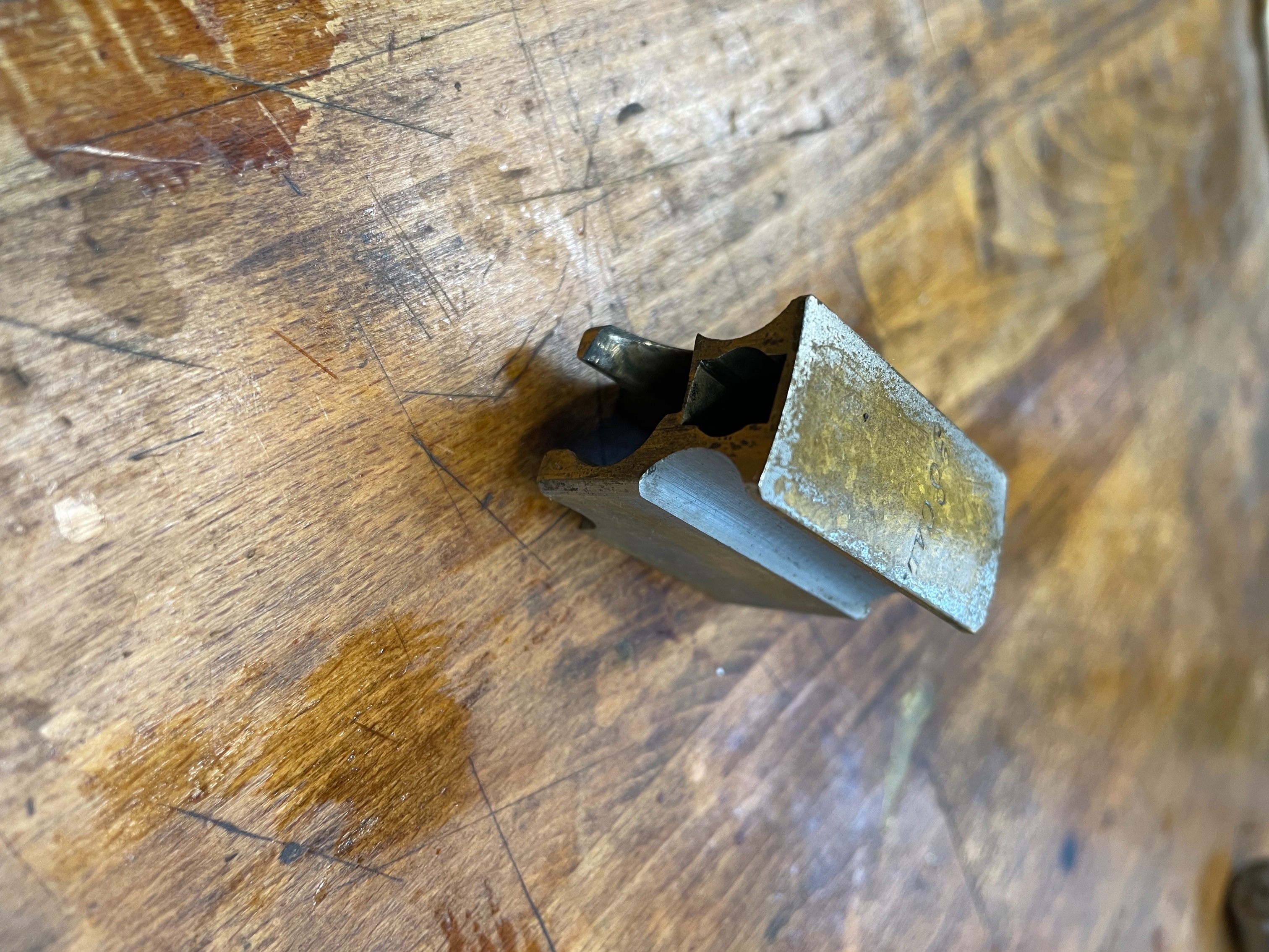

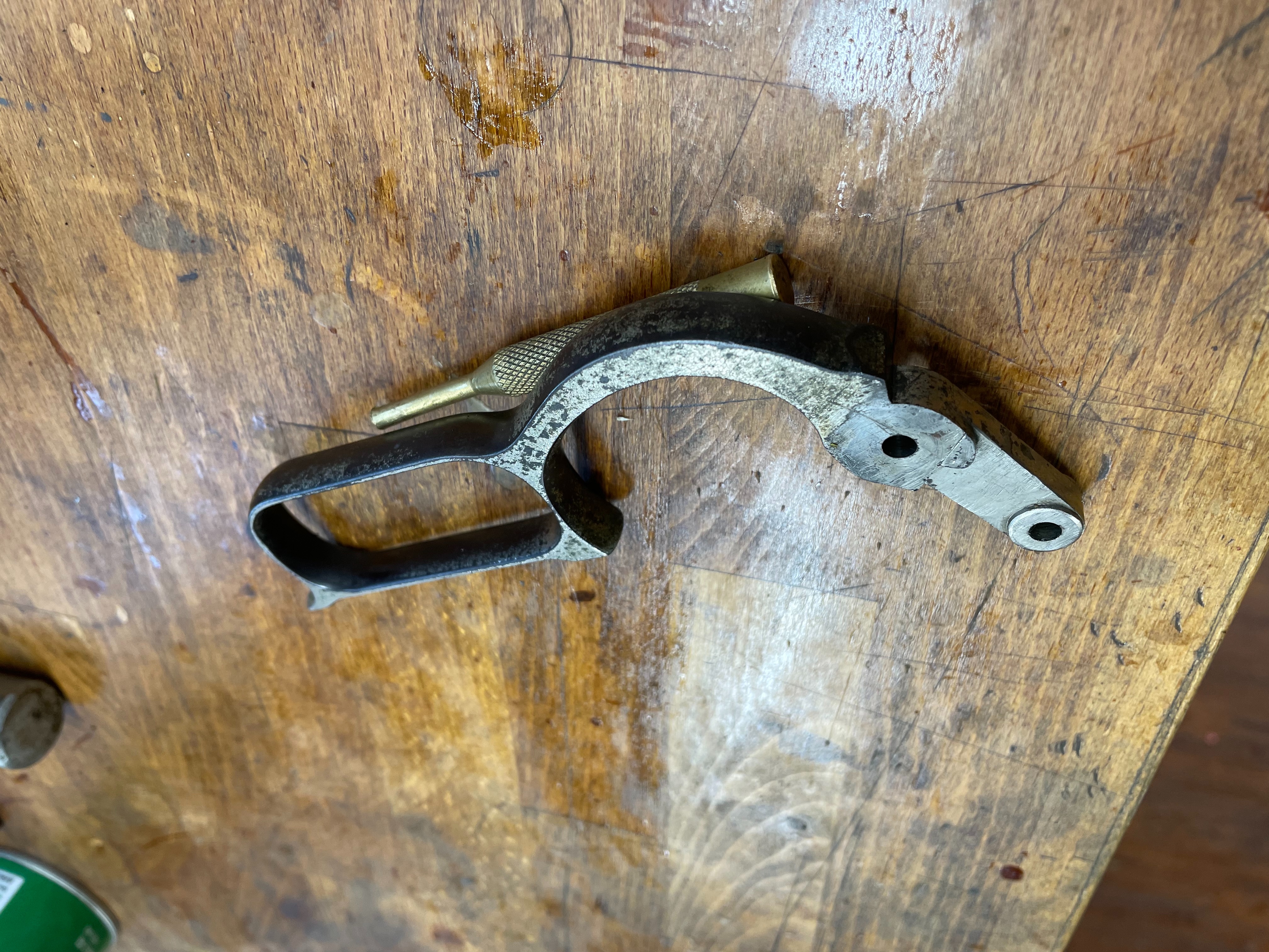

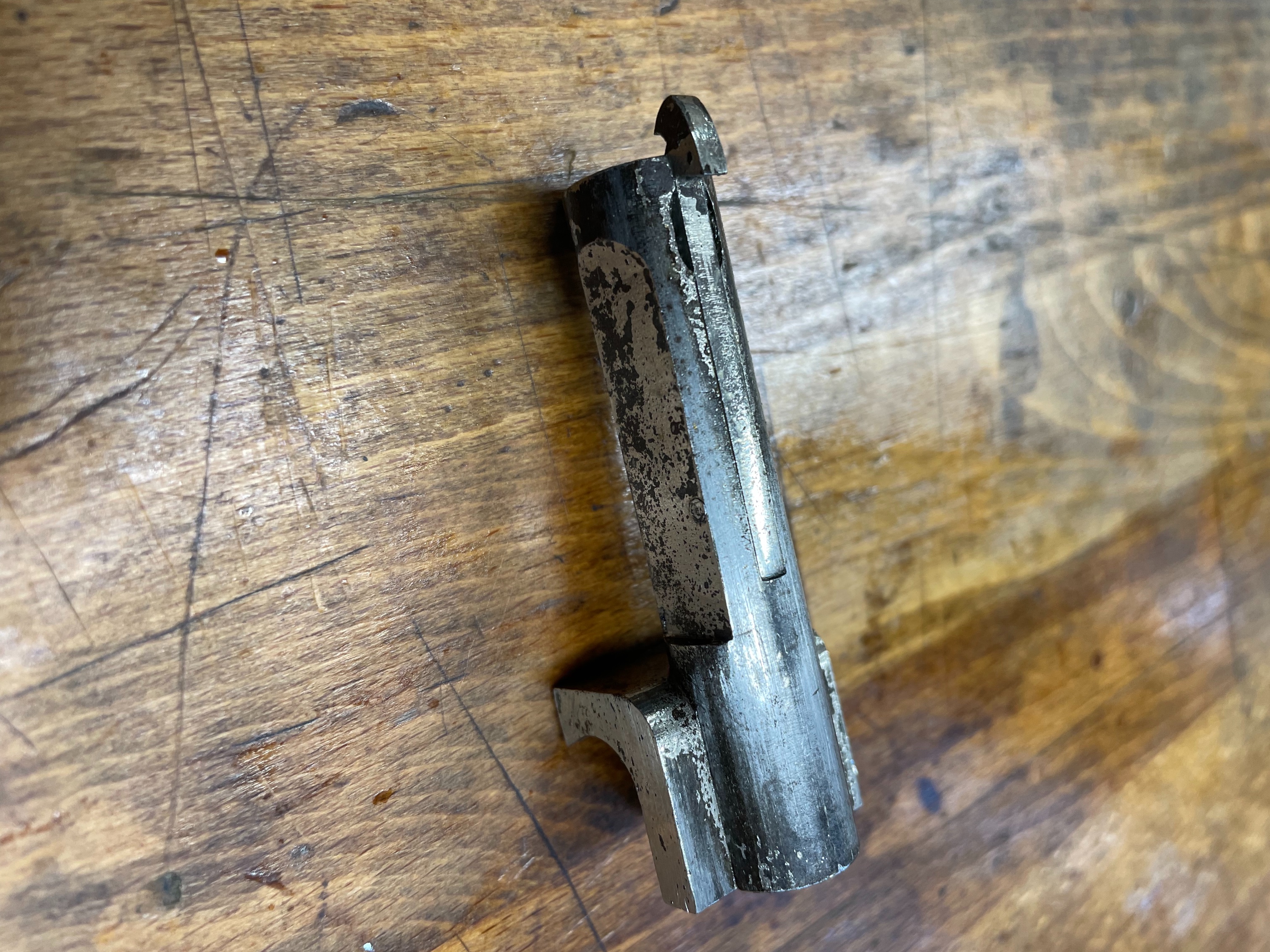

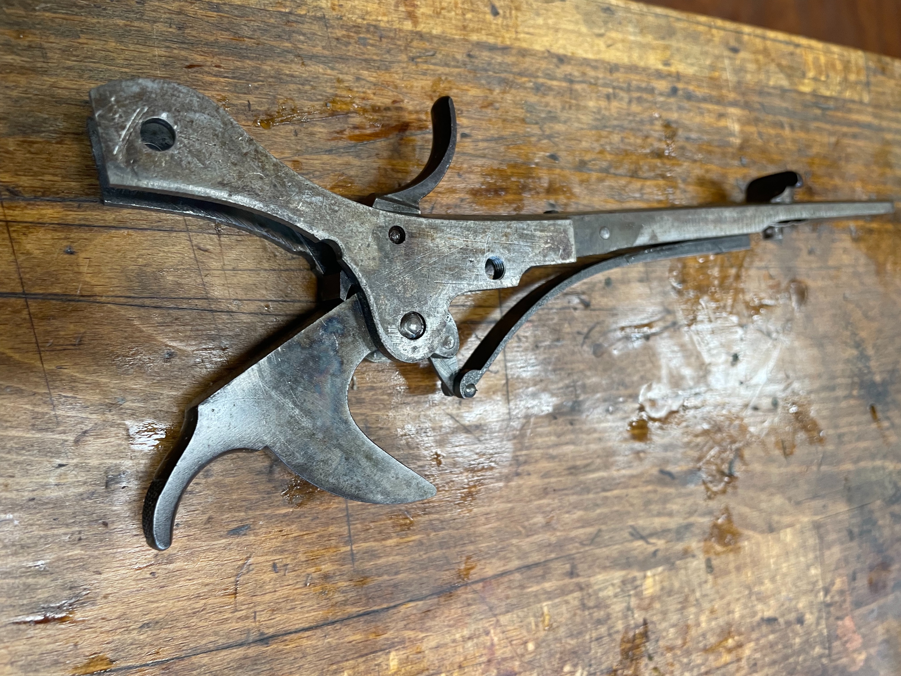

It sure looks factory but I’m no expert. Finger lever, butt plate, elevator, bolt, side plates and magazine are all nickel plated. It even had the cleaning rods in the stock. Bore is very lightly pitted and has a shine.

The nickel is definitely old original nickel. Have you removed the stock and checked for assemble numbers? If you have numbers there then go looking under the sideplates. On special order guns they sometimes numbered the parts so they can be tracked and put back together after finishing.

I agree.  The old nickel plating looks authentic to me.

The last two digits of the serial number are on the side plates. I haven’t taken it apart to clean yet. I’ll check the rest when I do.
I got a ridiculously good price cause the shop thought it looked ugly and that  someone had nickel plated it afterwards ruining the collector value.
In my business we call it “patina”.

It sounds like you got a original gun there. You might even see numbers on the lever and elevator. Just hope your letter spells it out.

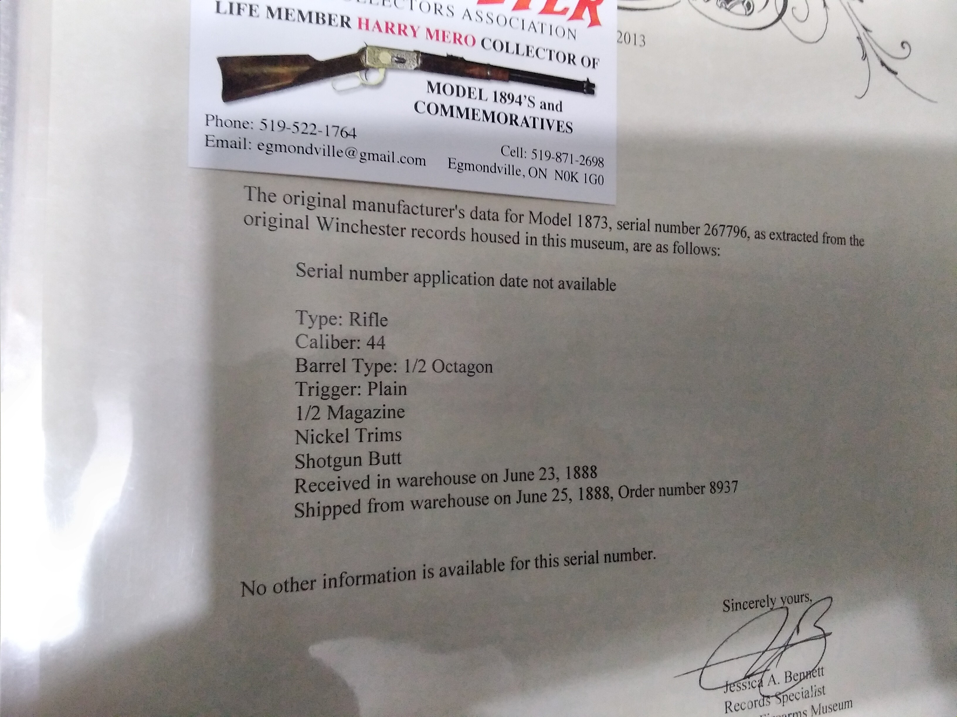

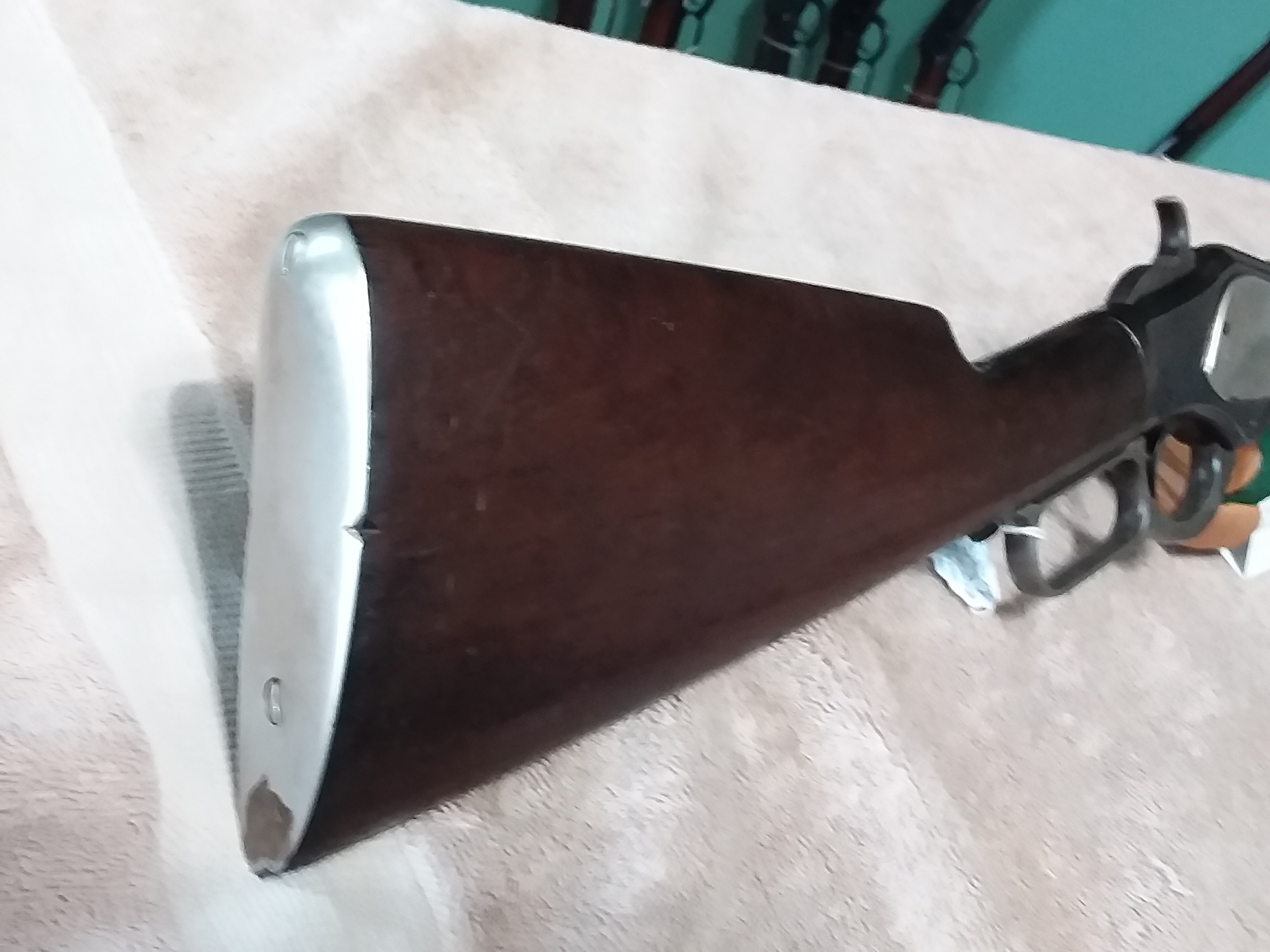

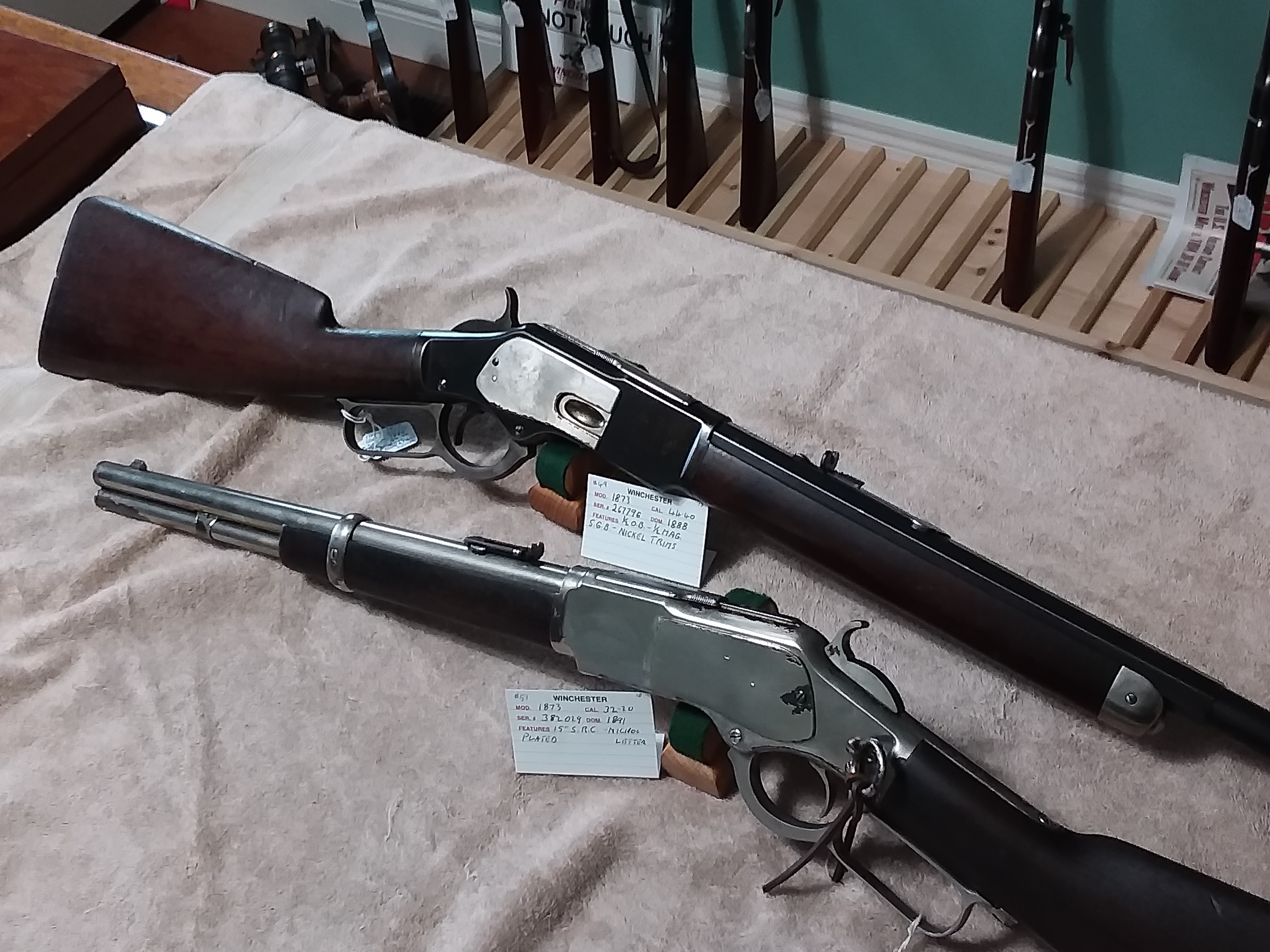

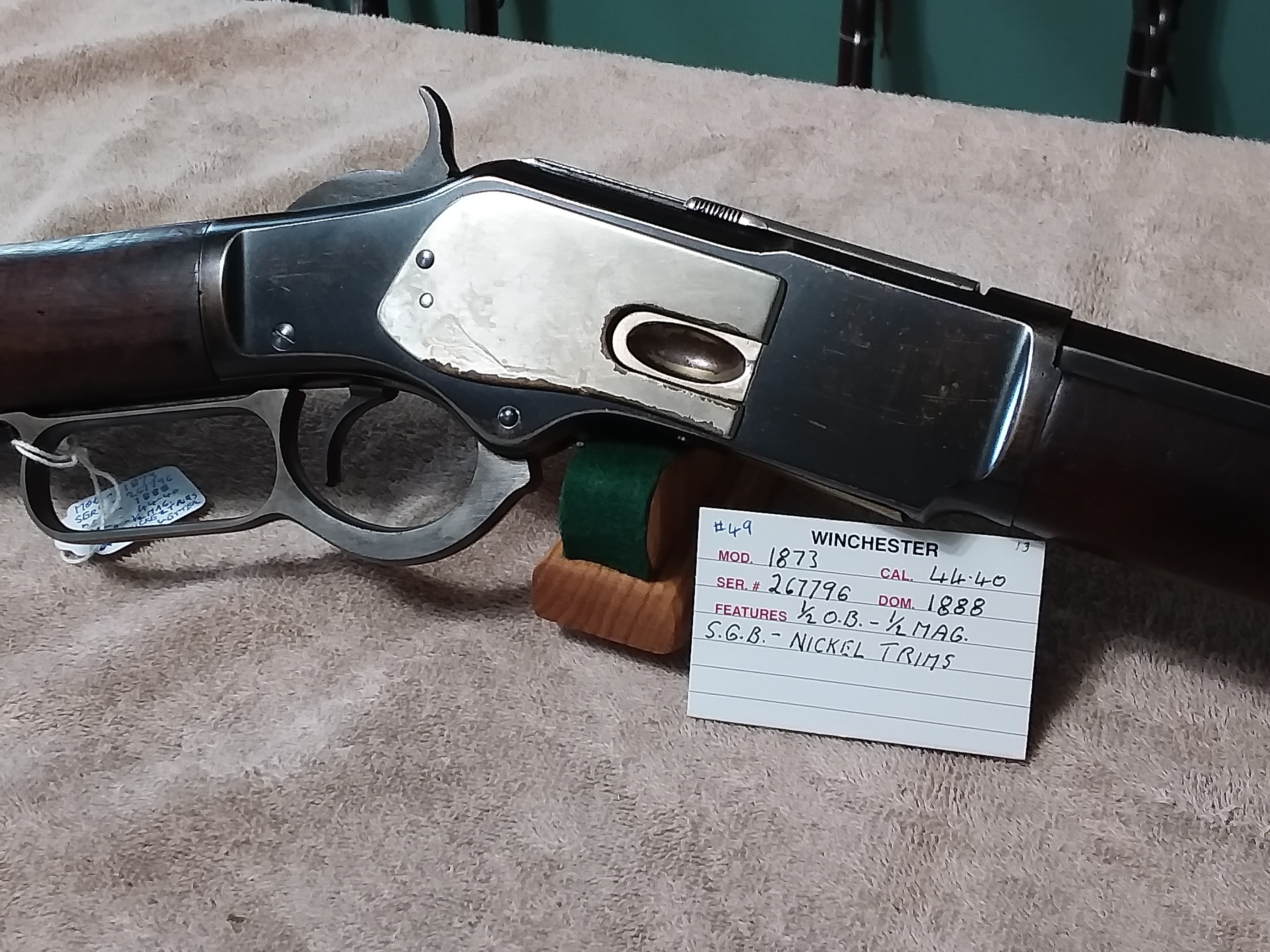

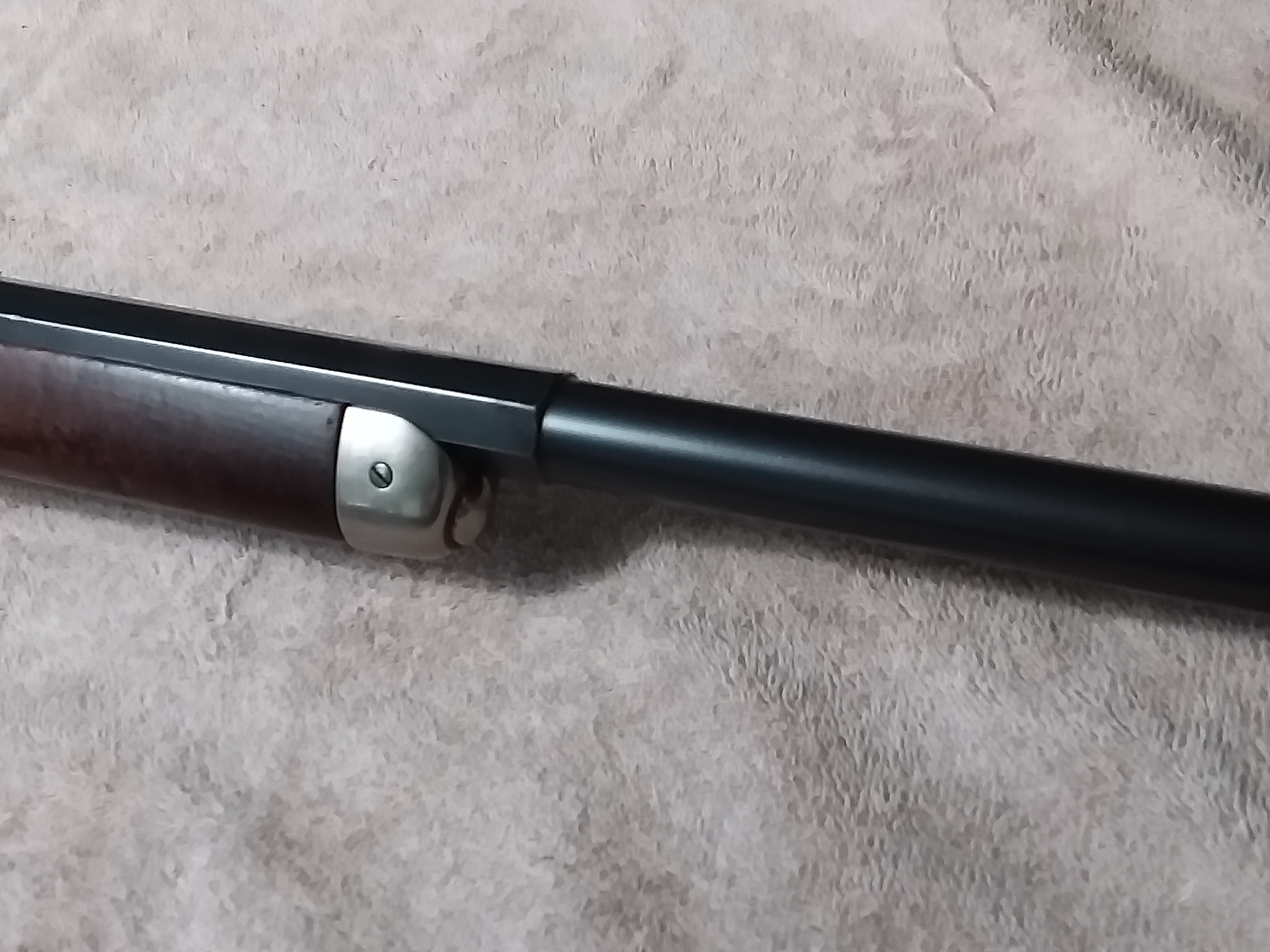

Very interesting piece. I sure would like to know what the letter states, whether it is “partly Nickel”, “1/2 Nickel,” “nickel trim,” or “nickel trims”.  Please let Us know. The one I have is ser#267796  and the letter says “nickel trims” almost identical nickel work as Yours. Nice find.

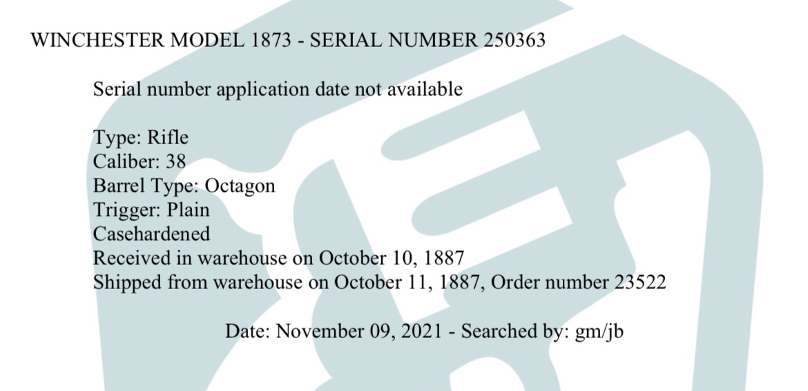

I got the email letter yesterday and it doesn’t say anything about nickel trim.
It’s possible it was sent back for a trim job. Who knows, but it wasn’t delivered with the trim.

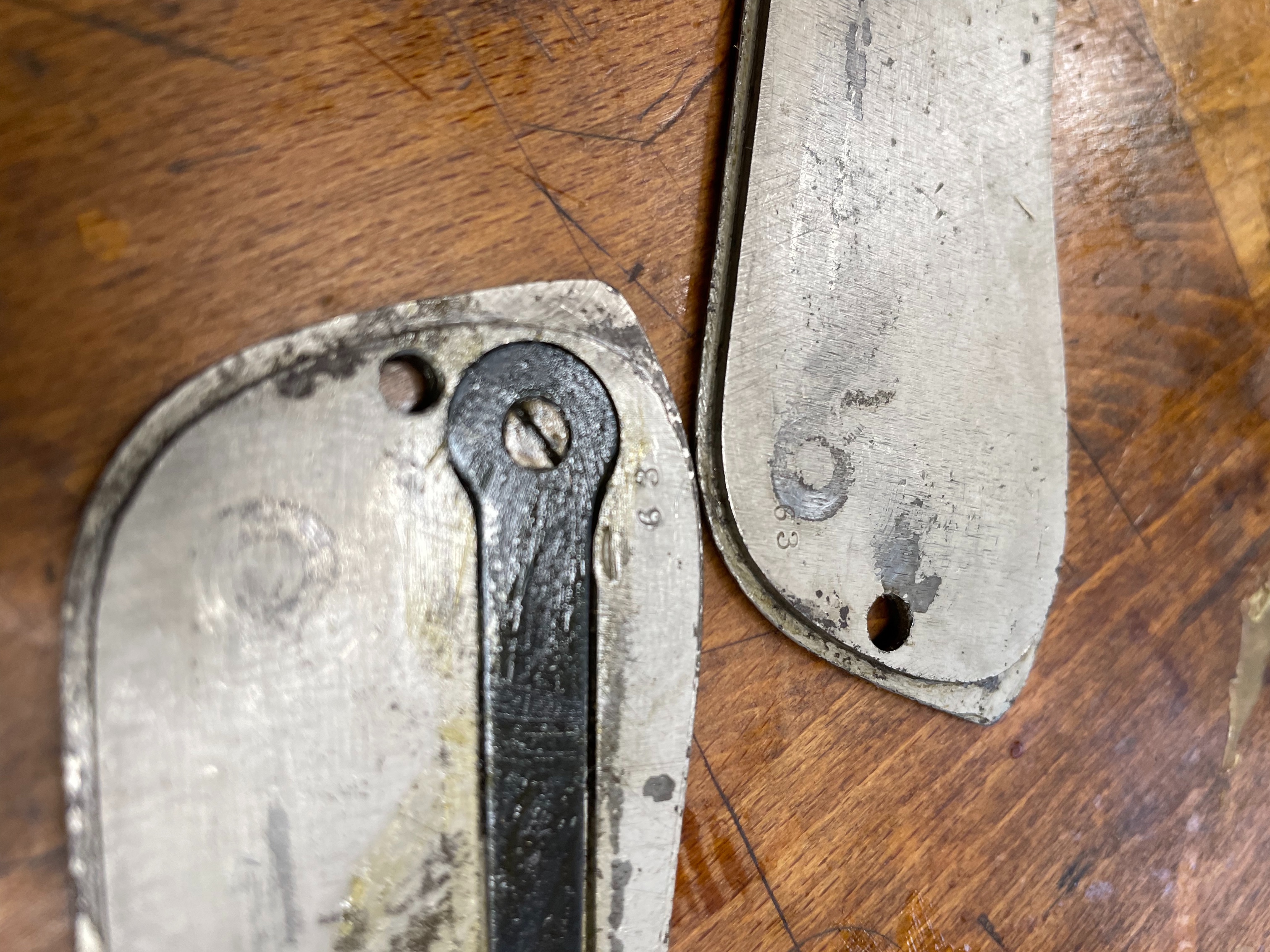

With it having the last two digits of the serial number on the sideplates, it was made that way. They don’t put those on plain guns. How does it letter?

I just looked up the one at collectors firearms (W7848) and it doesn’t letter either.
I talked to Jessica and she thought they would have recorded it.
I’d be curious to know if any of you with nickel trim guns have letters to verify.

I have two that letter nickel trim.
Forum Posts: 5020
November 12, 2021 - 4:21 am

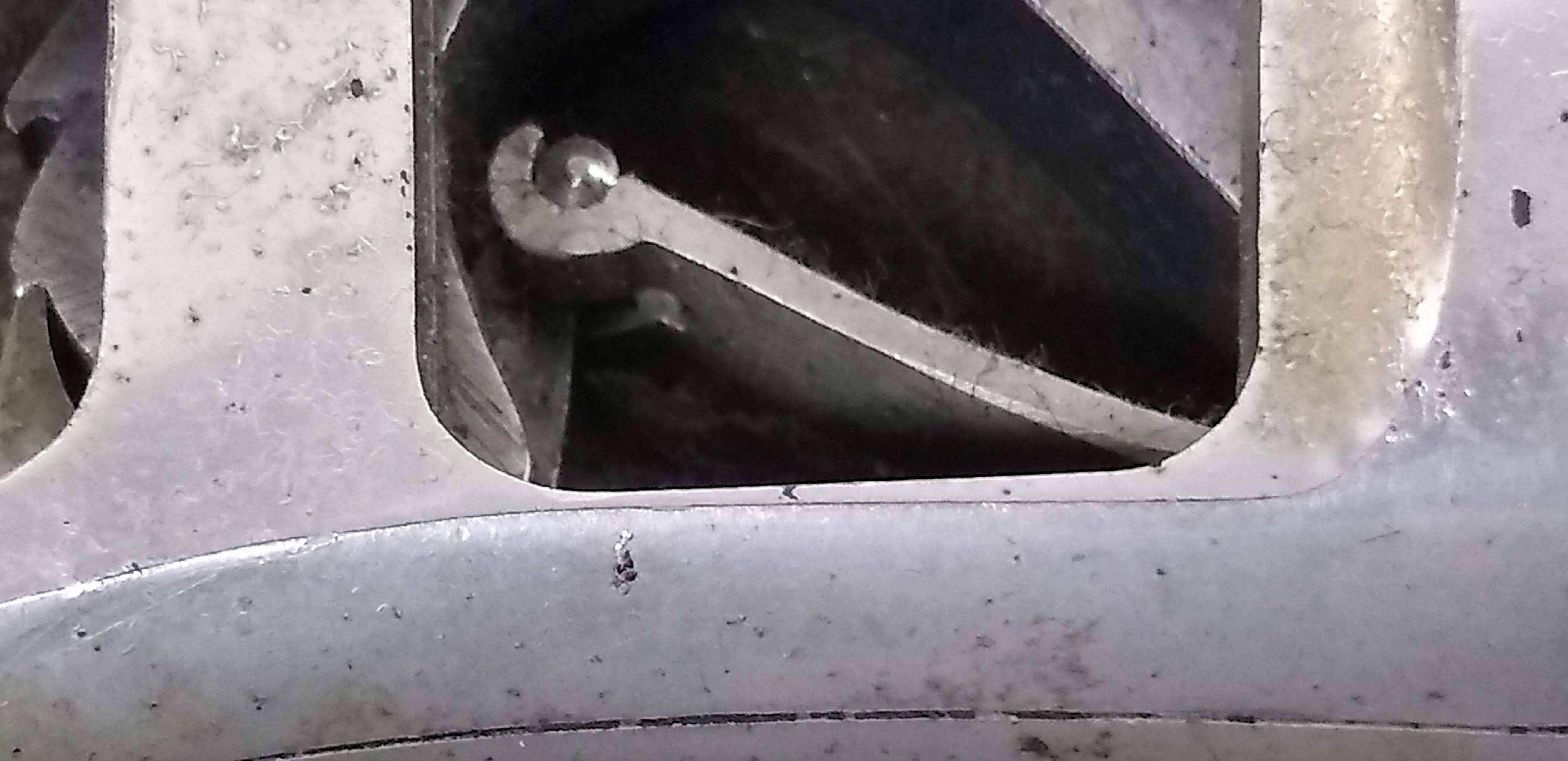

And don’t clean on the nickel finish. Nickel finish is just like a brass guns, it has a patina that has developed over many years. Original nickel is dull and can be flaky. When nickel is put on its put on over bare steel not like todays plating where its copper flashed first and it sticks real good. The nickel over steel will crack with age and moisture gets under it loosening the nickel and you will get a flaky look. If you rub it a lot the flaky nickel will get removed and you end up with less nickel and you loose the aged look. Here is a closeup of my cutaway and you can see the nickel that is loose from the surface. It looks like wrinkles, now if I get to aggressive while cleaning it, I will loose nickel and I will loose the original look and unlike a brass gun time will not bring it back.

Here’s the Cody letter for mine:

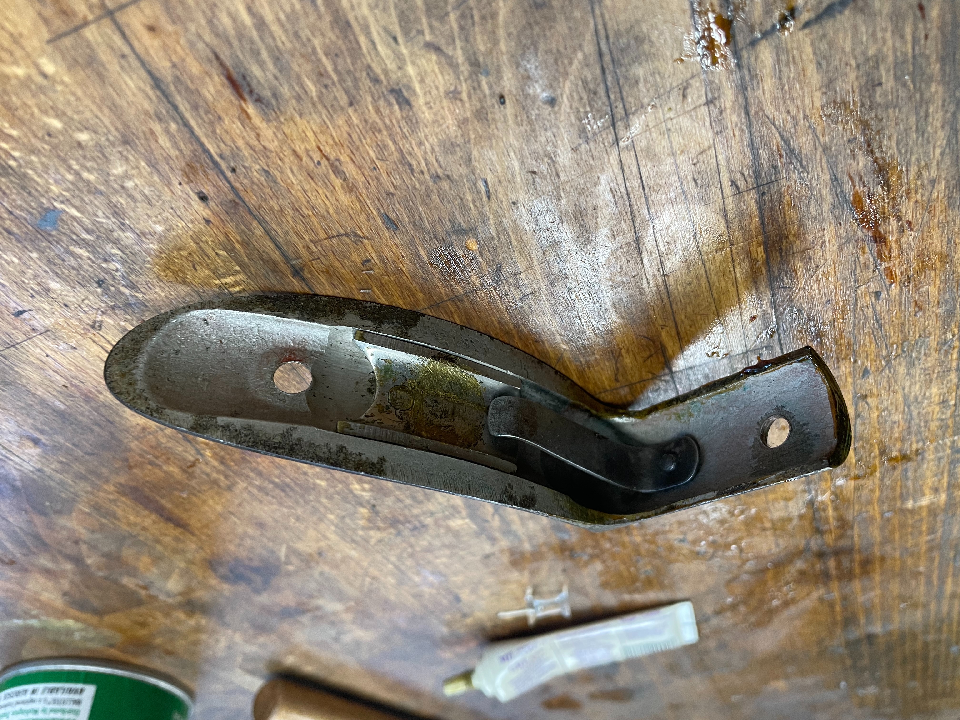

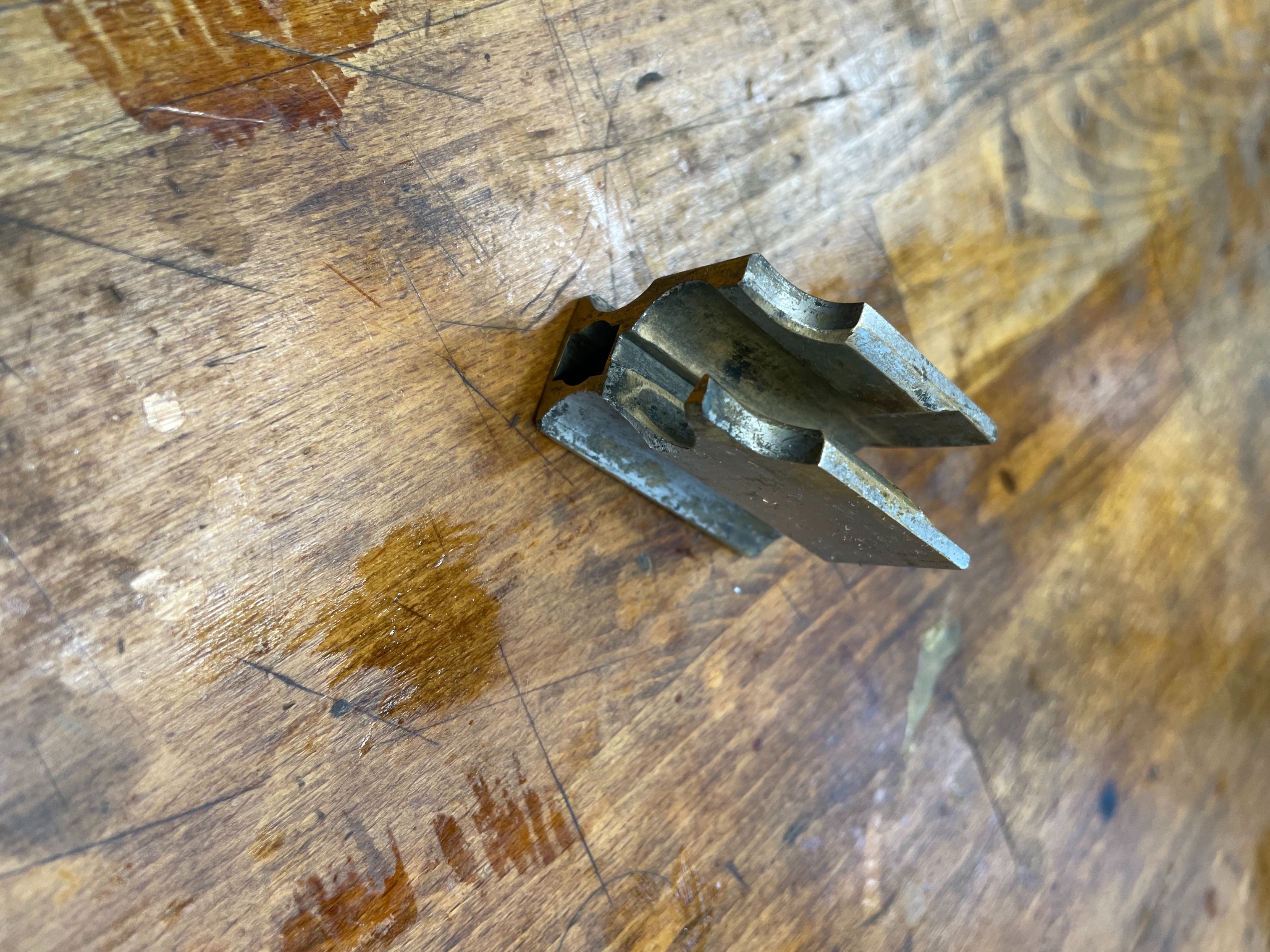

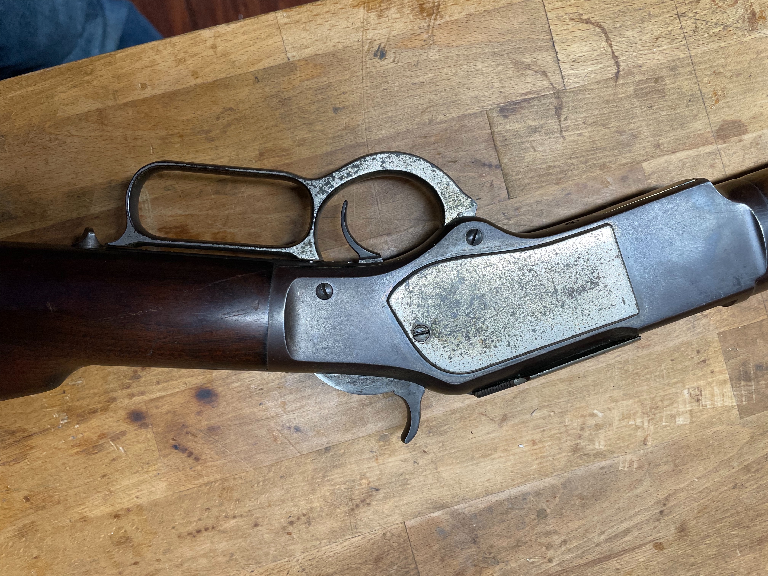

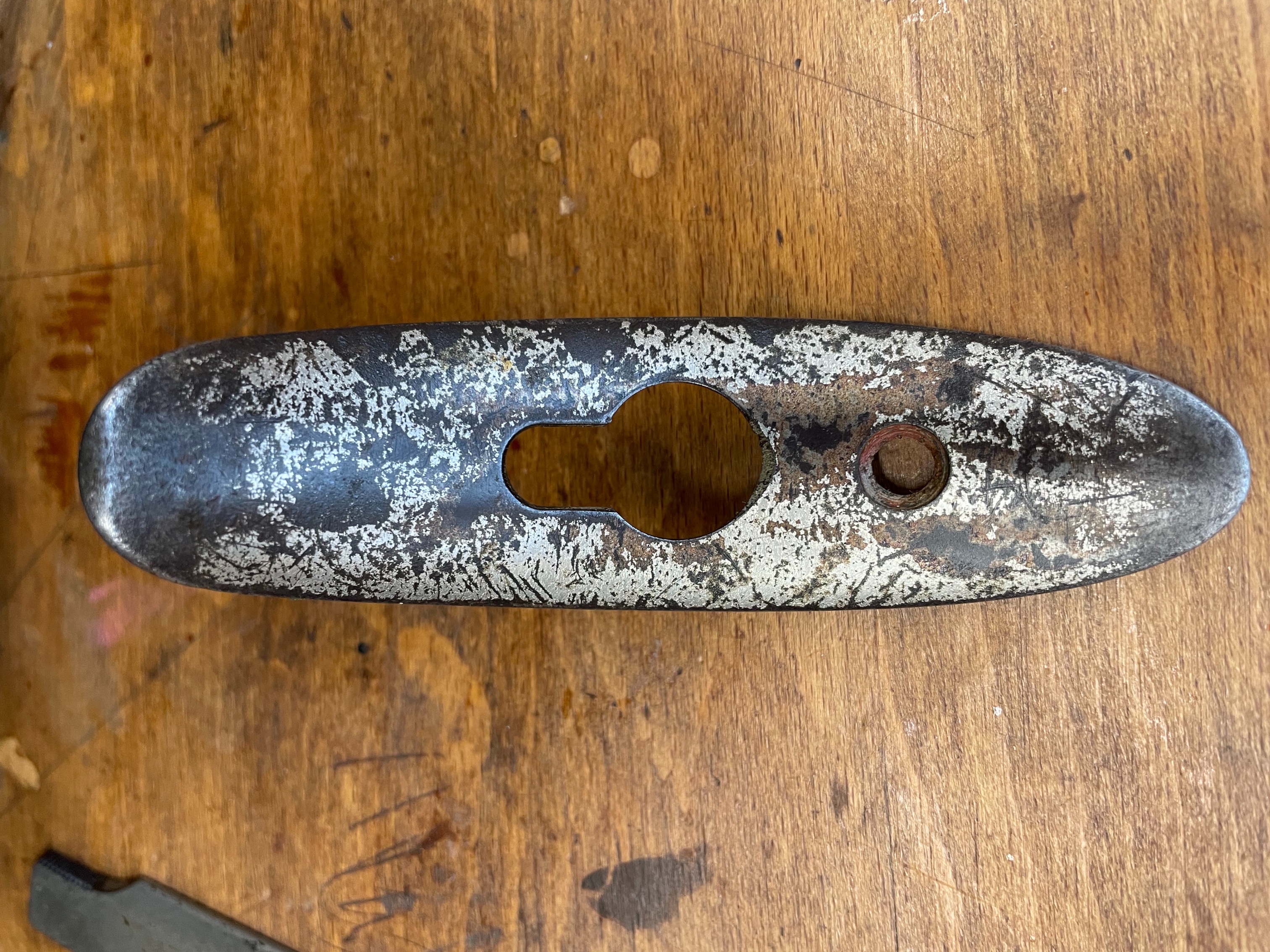

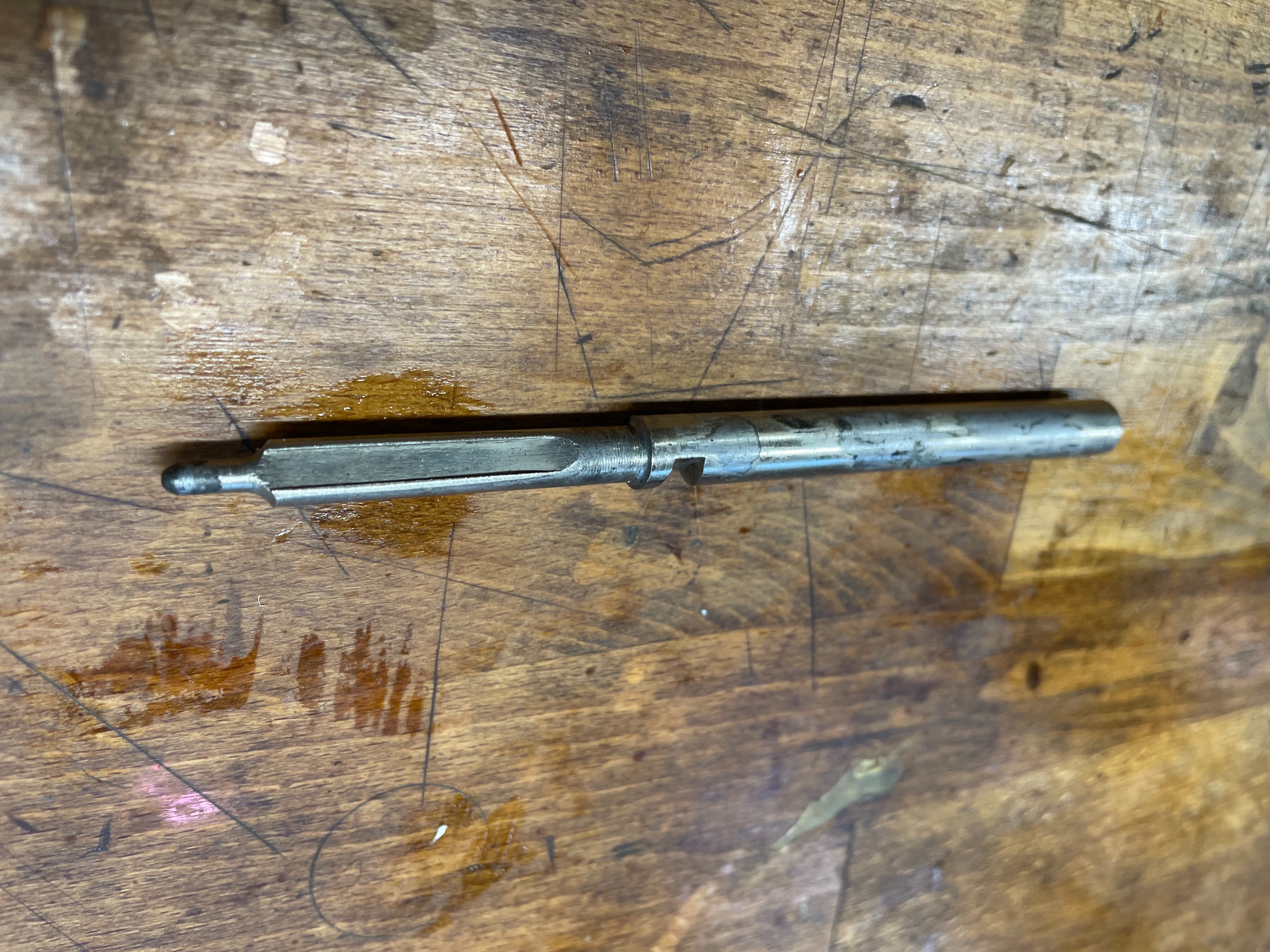

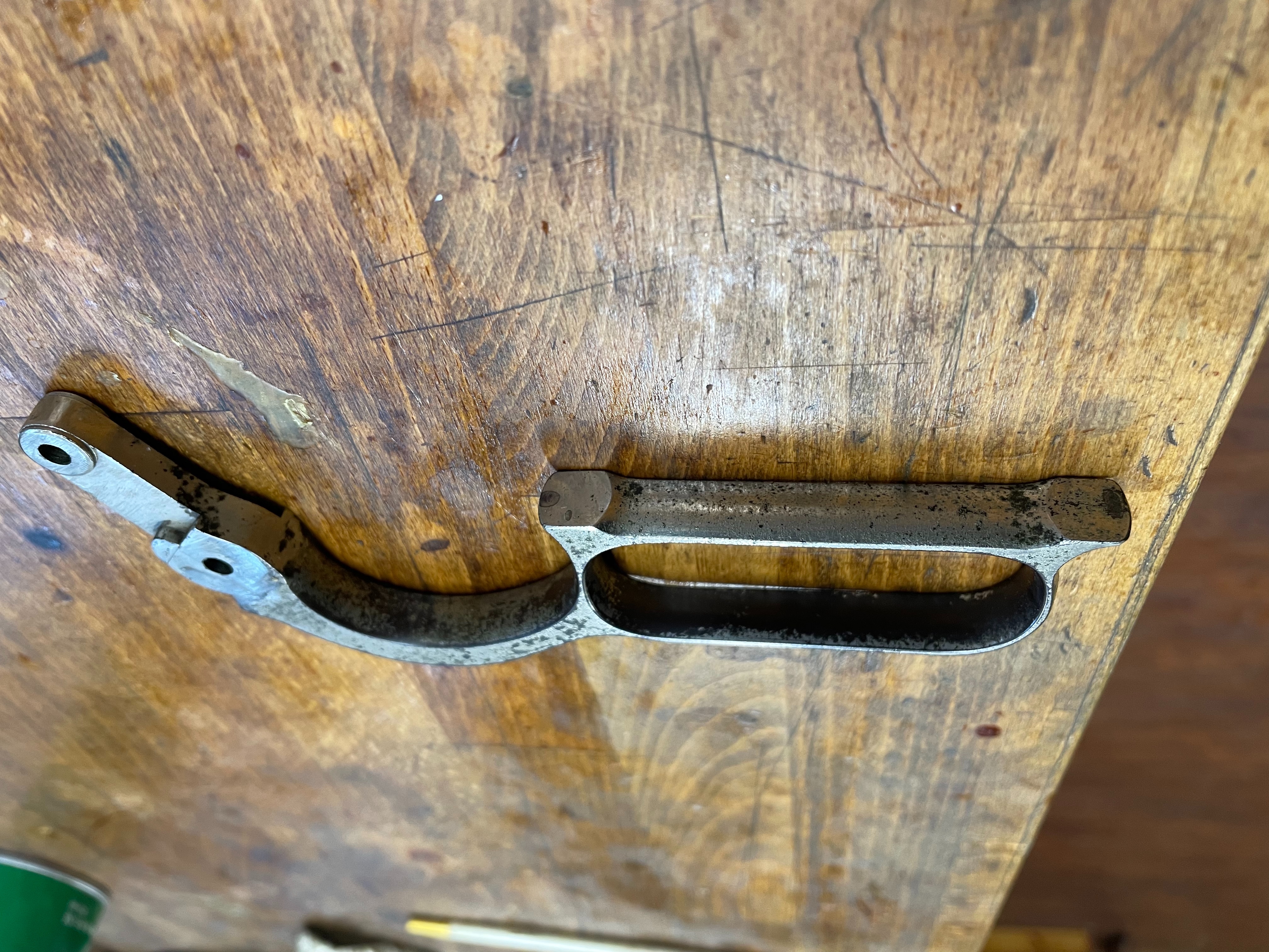

7A30A2B4-AD96-4390-B993-1B7E462B2DC7-1.jpeg38EAB9AD-2F59-4769-A200-9E1AE1638F41.jpeg3874BD52-301B-481B-8A35-D6078D33BEDF.jpeg341A6D70-5653-40A1-82D8-7FC237B800FD.jpeg28FD5064-7809-43C5-A6D7-DEF68947BDFD.jpegThanks for the heads up about the cleaning. I had to use some degreaser with a toothbrush to get all the old grease off. It was so gummed up I could barely cycle the action. That’s all I did. Less is more.
I took pictures of the nickel parts. It looks like some have a copper wash underneath.236A3EEF-4584-4642-B808-A9E1679E6F8E.jpegD139AF2D-A3FF-4D37-B923-1BC86A95F01D.jpegAD293498-2364-4775-A93C-DD6247AA03A0.jpeg
8C50B37F-2B92-42A8-A95F-1BB4645A64FD.jpegFD7CE56D-5F91-469C-9466-0716FA1221BB.jpeg23CD2F20-F0B6-494F-99D4-466EEE8BFC05.jpeg

I see what looks like copper on the outside of the butt plate. Is it anywhere else?
What are the assemble numbers on the left side of the tang?

Left side plate, and butt plate show copper underneath. I don’t see evidence of copper under any other parts.
