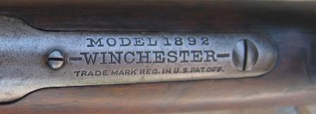

The first 10,874 Model 53 rifles were serialized in their own serial number sequence beginning with serial “1”. Later in production the serial number were in the Model 92 range. Many of the early Model 53 rifles were Take Downs. The pistol grip is the only odd part of your description, as that would have been a special order.
Which caliber was it? Take a look at the factory marking on the upper tang. If the rear half of the rifle is a Model 1892, it will be marked accordingly on the upper tang along with the patent date. If it does not have the model number and patent date, it is more than likely a correct Model 53. Pictures would be nice.

A Model 1892 with a serial number in the 1900 range would have been manufactured during the first year of production, 1892.  The takedown feature was not patented until 1893 which is why the lever on these rifles has that date stamped on it.  Therefore the gun almost has to be a Model 53 as Bert pointed out which was serialized in its own unique SN sequence and manufactured during late 1924.  The Model 53 would have a Type 6 tang stamp on it when they were first produced as in the first attached photo.  The Model 1892’s at that time (1924) would have a Type 3 or 4 tang stamp as in the second and third images.  Please do take and post the photos of the rifle and include all the stamped writing on it.

 I have a very low numbered M53 and it has the #6 marked tang. Plane Jane rifle, but it is a 44-40. The values of these rifles differ considerably with the caliber. This rifle may be quite rare. Again, what caliber is it?  Big LarryM53-507.jpg

I went back over there today and took another look.  The reason I was mixed up is the tag says “WINCHESTER MODEL 53 DELUXE” but it’s clearly not a deluxe rifle.  It IS a takedown, and it is a correct 53 with the type 6 tang stamp mentioned above, as it has Winchester Trademark on it.

You are correct. The checkering is not factory original, but much better quality than most added checkering. The pattern is very similar to factory checkering.

I just saw this thread this morning. It looks like everything has been properly sorted out; the low serial number coupled with the type-6 tang is proper for the early production Model 53’s. Too bad about the after-factory checkering; that reduces the value substantially below the dealer’s asking price. I am the person mentioned above, building a survey of Model 53’s. Each rifle is recorded by serial number and I would be grateful if you could let me know the serial number of this rifle so that I can add it to my survey.

Just for a bit more information on early Model 53’s … from June 18th, 1924 to September 21, 1927, Model 53’s were serial numbered in their own range, from 1 to 10874. After that date, the same receivers and Model 92 serial numbers were used to build both Model 92’s and Model 53’s. If anyone ever finds a Model 92 with a serial number lower than 10895 AND with a Type 6 or Type 7 upper tang stamp, that is a Model 53 receiver that was used to build a Model 92. Two such have surfaced and are included in my survey. The OP’s, however, is a legit Model 53, serial numbered in the early Model 53 range, and with a Type 6 upper tang stamp.

What exactly is marked on the upper tang behind the hammer ? I suspect that what you have is an aftermarket reworked Model 53 that is now a “Frankenchester”.

Just on the heels of my last Model 53 post some minutes ago, bit of further Googling coming up with – still confusing to me – this Thread, that of my moments ago post & above photos. My 53 tang exactly as in the number “6”, upper left location. Looking even a twin for condition; it could be mine! IF I now interpret matters correctly. Simply the standard-correct tang nomenclature within Model 53 numbers under 11K serial range.
