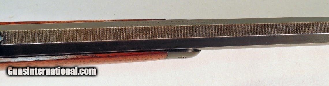

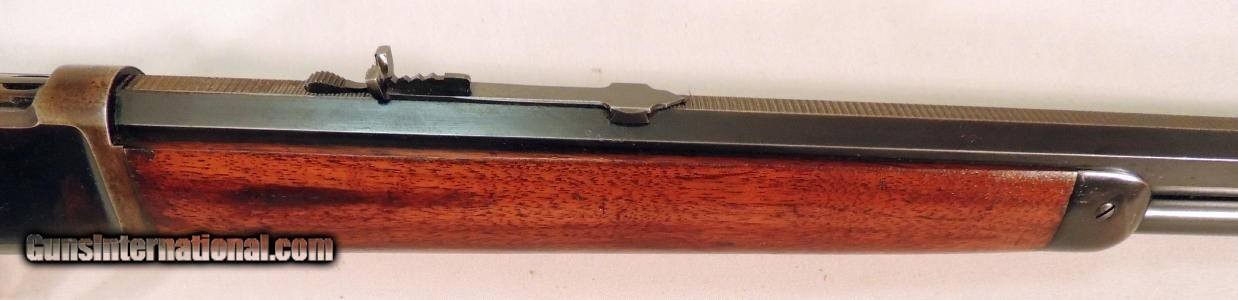

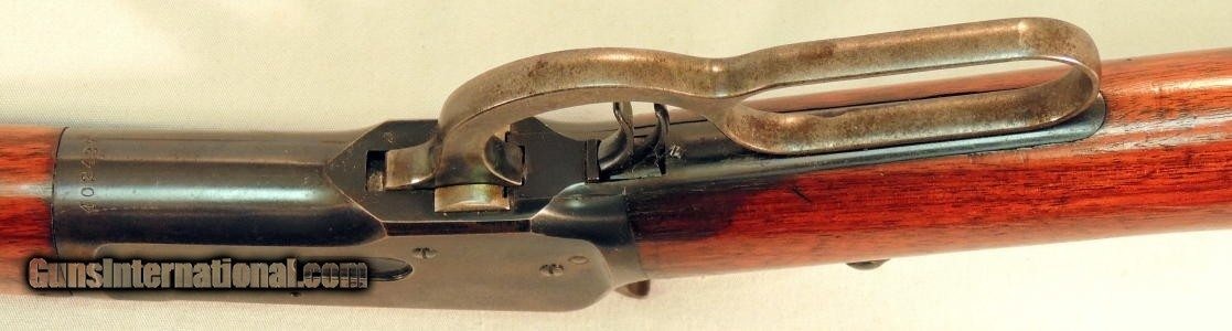

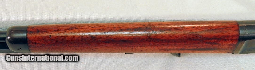

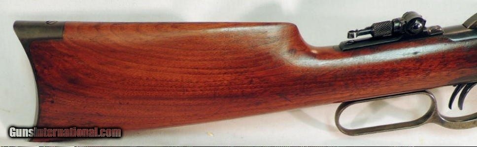

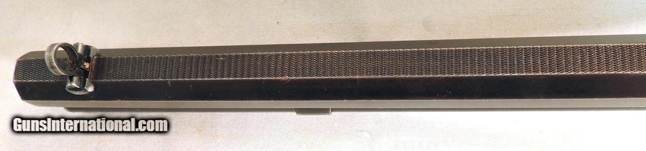

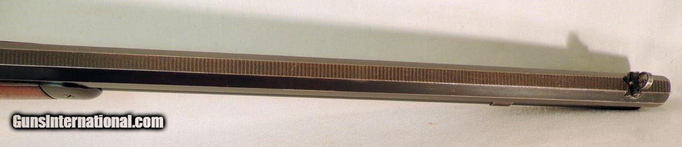

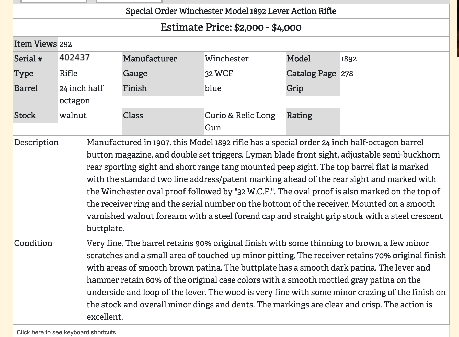

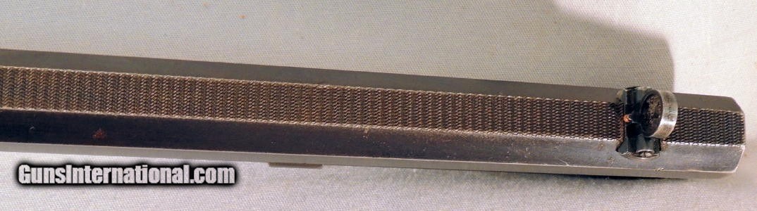

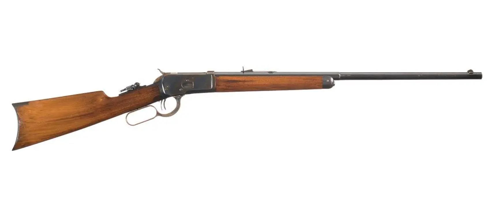

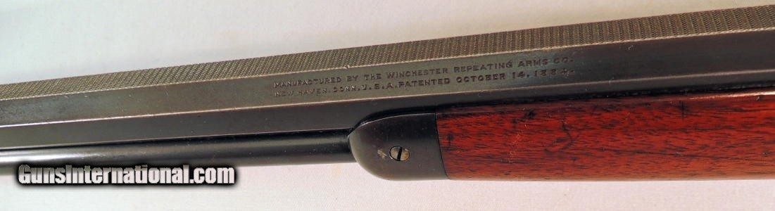

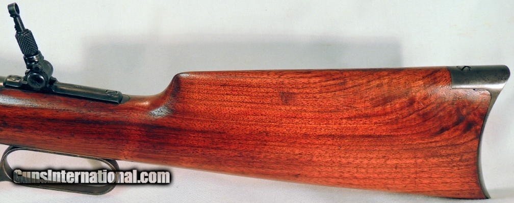

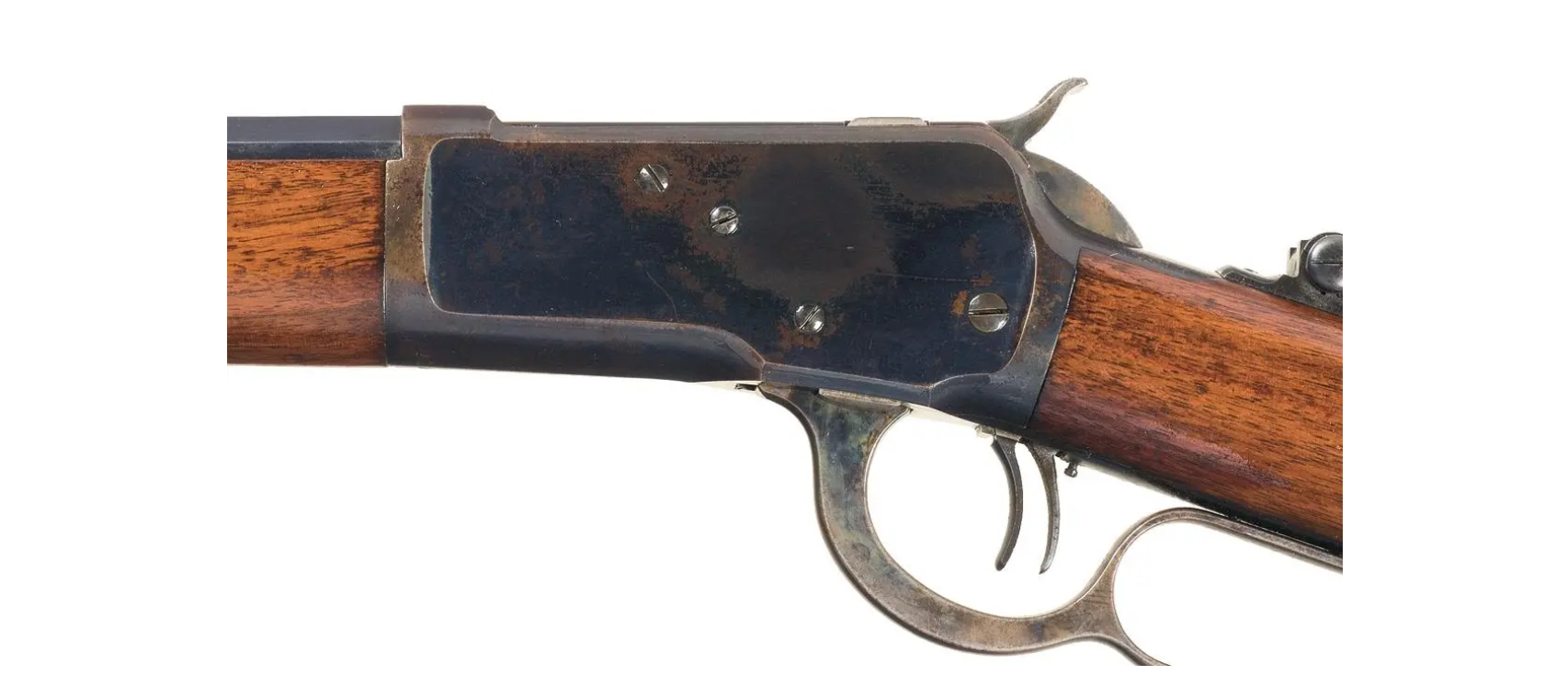

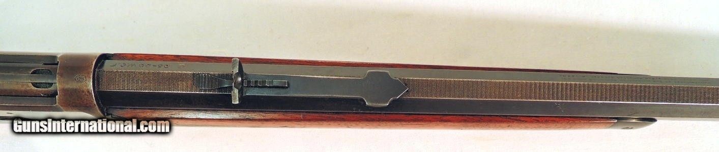

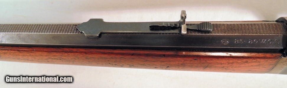

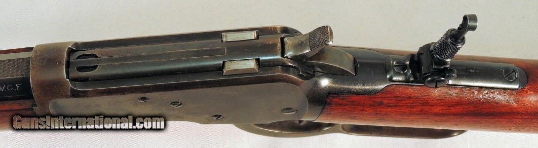

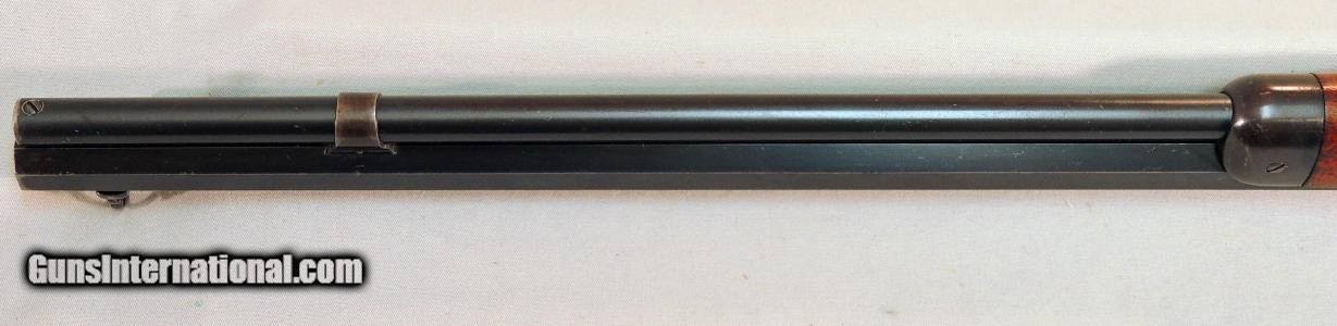

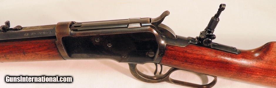

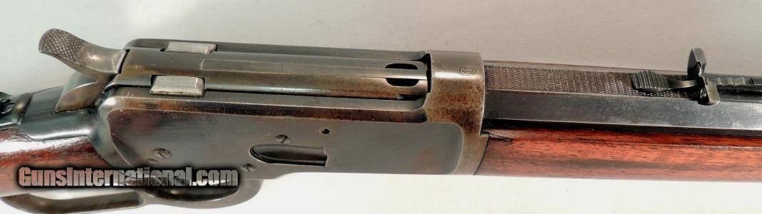

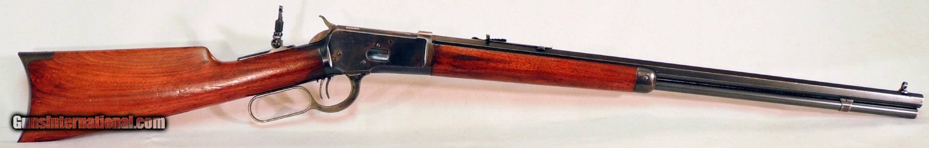

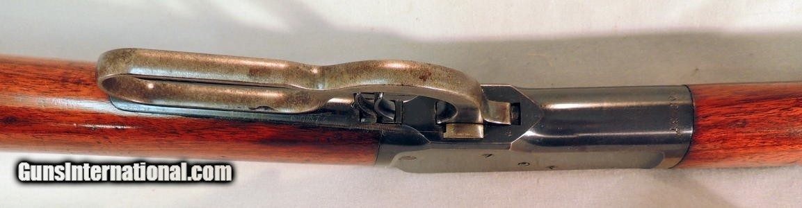

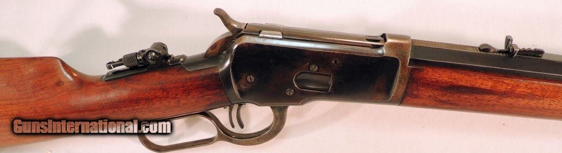

This rifle popped up on Guns International and is being sold by The Winchester Grove for $8500.  The only problem is that the gun was sold at RIA in Sept 2010 as Lot 1328 and at that time it had a 1/2 Round barrel, set triggers, a button mag and was chambered in 32 WCF.
But now the gun has a matted full octagon barrel, full length magazine, and the caliber is 25-20 WCF.  The wood is absolutely the same and the discoloration on the receiver is identical and the screw heads on the left side of the receiver have not been turned.

You guys might want to put your wallet away and pass on this one.

Don Grove just bought this gun from the August Ward’s Auction for $6,703.00 plus 15% commission.  They are both located in Dallas, Oregon.  If it were me, I’d be packing that one up and returning it.

Thanks so much!  I missed it at Wards.  It sold for $4600 at the RIA auction in 2010.

I talked to Don yesterday and he had just purchased the rifle from Ward’s and has pulled the item from his website.  He does a lot of business both buying and selling via Ward’s and will be returning the rifle.
