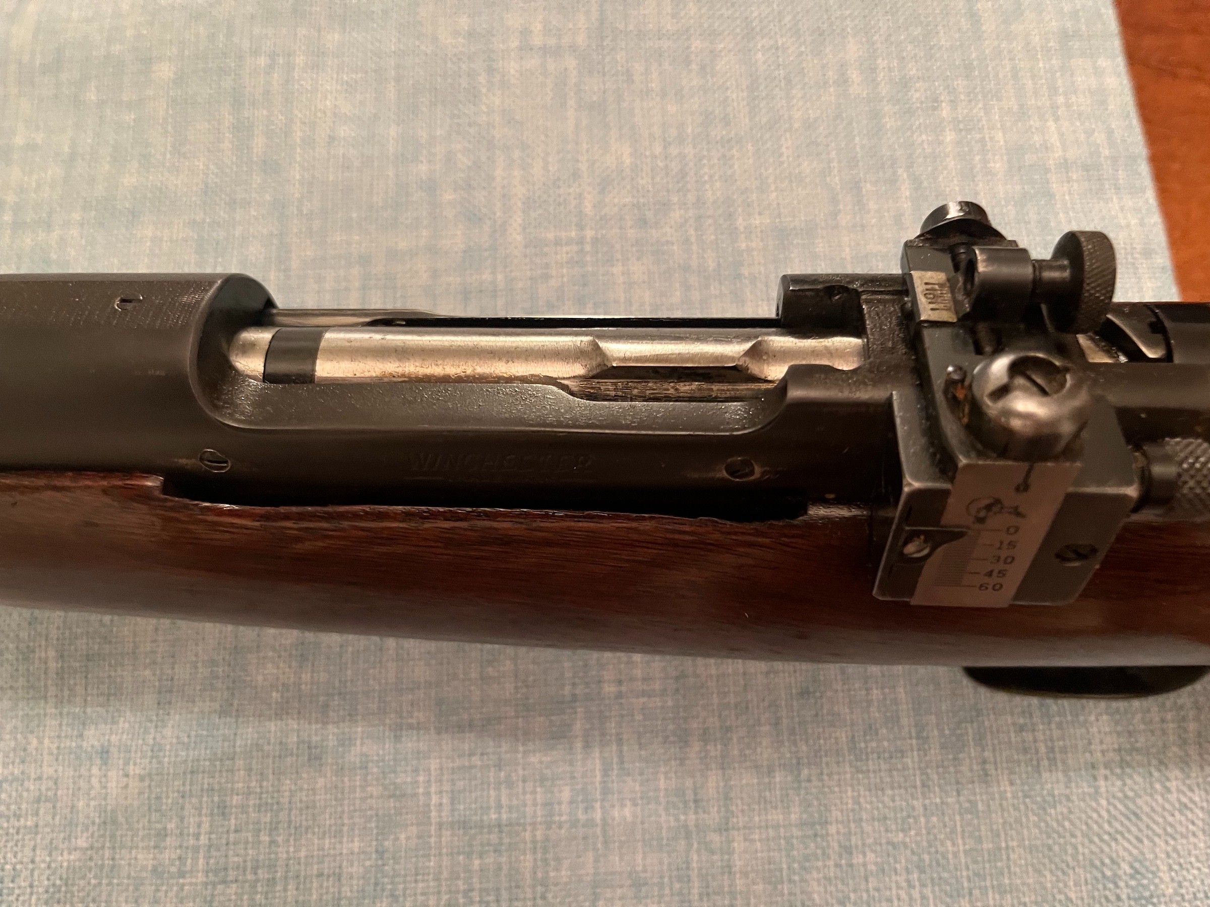

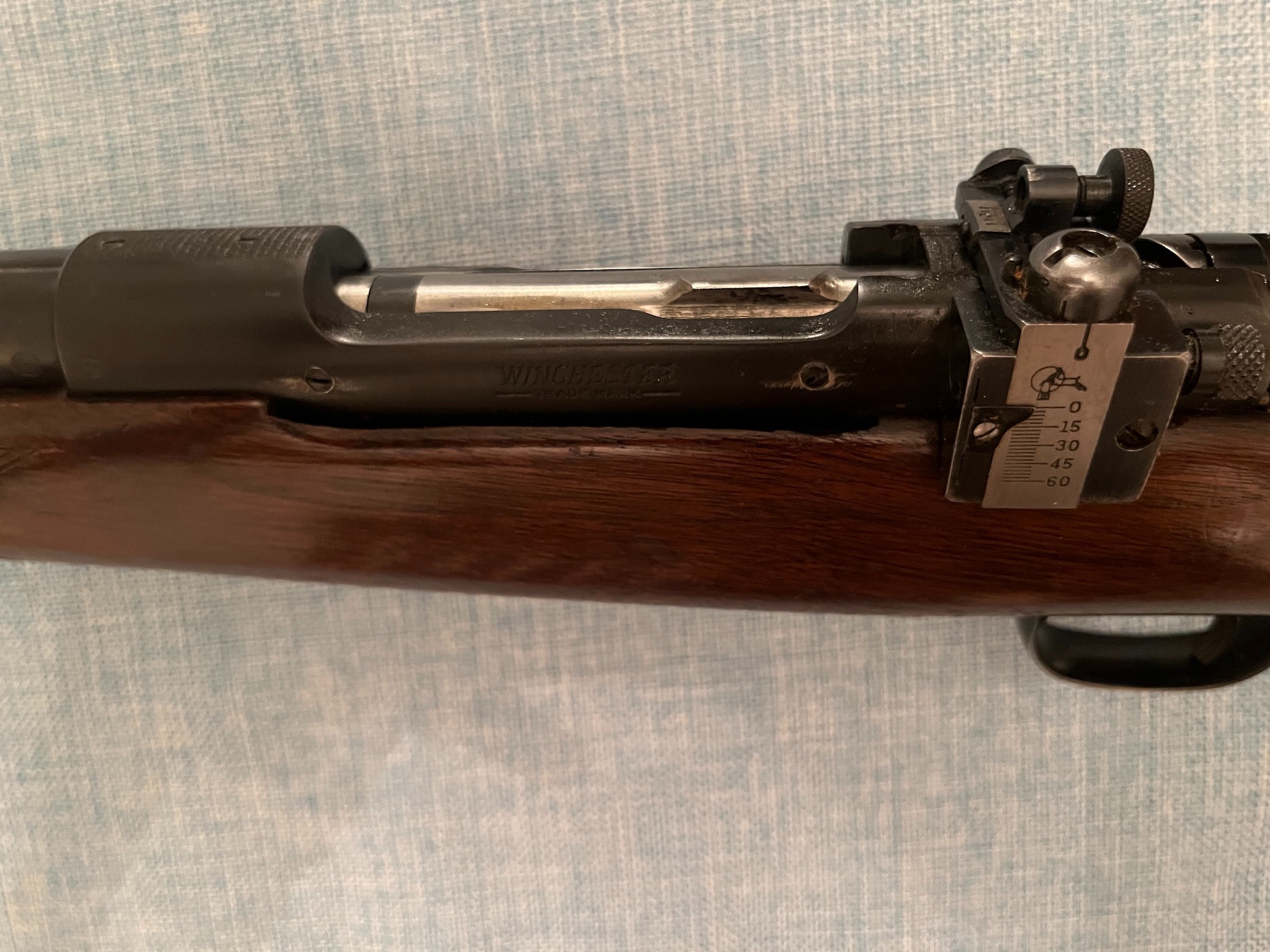

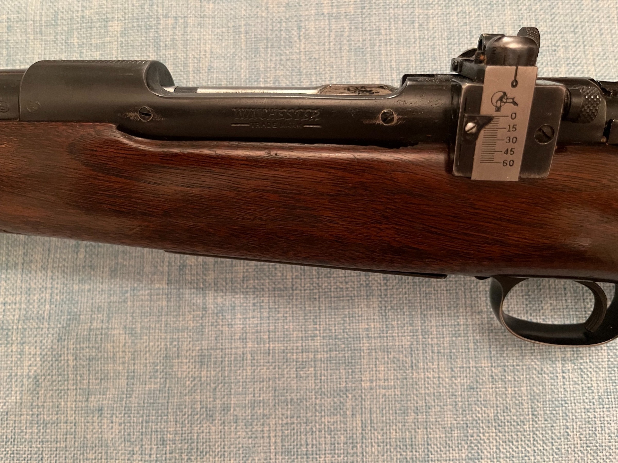

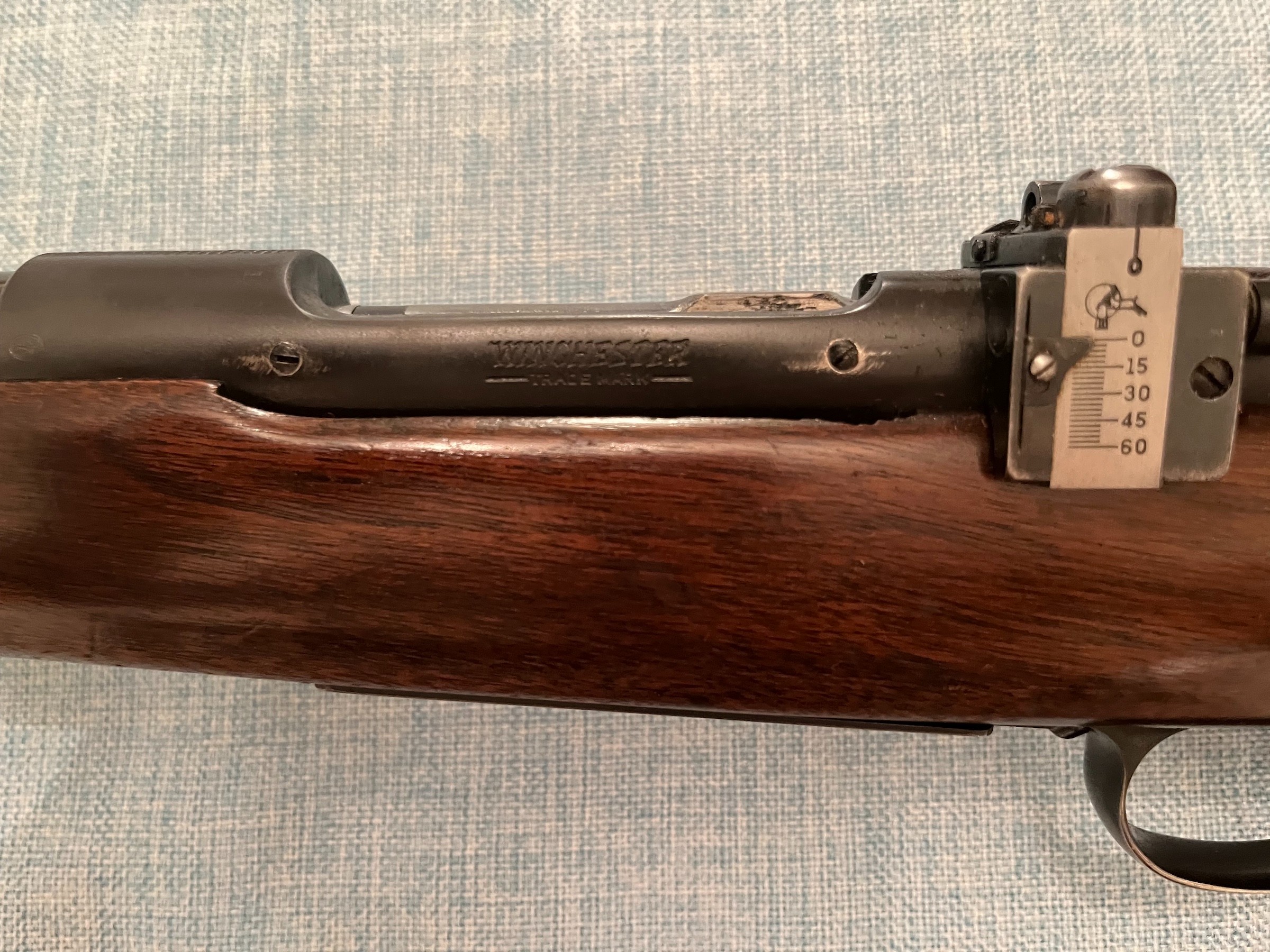

Pictures below from Kevin.  Does anyone recognize the pattern of holes?  It certainly isn’t G&H…
Forum Posts: 2869
October 12, 2026 - 2:28 pm
Based on a rough estimate of the hole spacing it looks like it could have been an E. C. Herkner “Echo” Mount.  The Echo mount had a plate that was screwed to the left side of the receiver (requiring a little relief of the stock) and had a removable base and rings that attached to it.  It came with 3 mounting holes for the Model 70 but due to the receiver surface hardness MANY people gave up on the third (middle) hole.

I am learning quite a bit from this! To answer some questions from above: (1) The holes are spaced 2 7/8″ apart. (2) There are actually *four* holes. Two are visible in the pictures and two are spaced, at the same distance apart, below the two visible ones in the ‘groove’ that appears to have been carved out of the stock (this groove is most apparent in the last picture).
