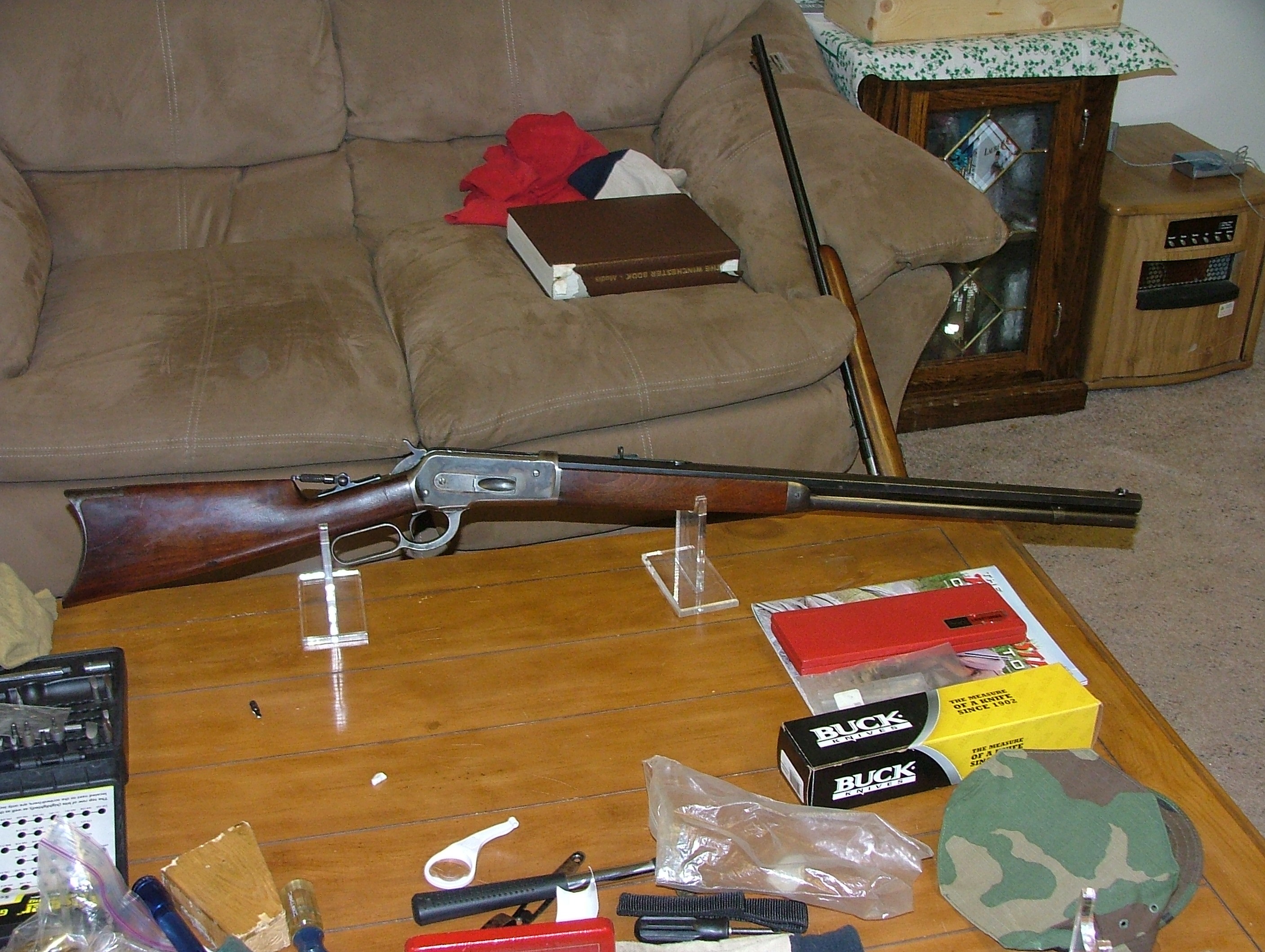

A little more advice. If possible, buy one with an octagon bbl. They are the best looking of the M1886’s, and all the rest.  Big Larry
 I 2nd that motion, the original buyers preferred octagon in the day and collectors do today. I like the look of a 86 with a octagon barrel, full magazine, and a crescent butt. Nice gun Big Larry! T/R
Big Larry,
That is a sweet looking ’86.
You have good tastes.
Jolly
October 27, 2018 - 3:31 pm
jolly bill said
Big Larry,
Jolly
Unfortunately, my tastes outrun my pocketbook. I traded two very nice Winchesters for this rifle as I doubt I could have afforded to buy it.
It is an antique # 43324, shipped 11-07-1890, and a 40-65. Bore is OK with one small rough spot. Lots of color left and that is what attracted me to the rifle. A good friend brought it to my house and we made a deal. It may well be my favorite Winchester. Yes, I may even shoot it some day. It is very heavy and I may need training wheels on it. Thanks Jolly.   Big LarrySmileSmileSmile
