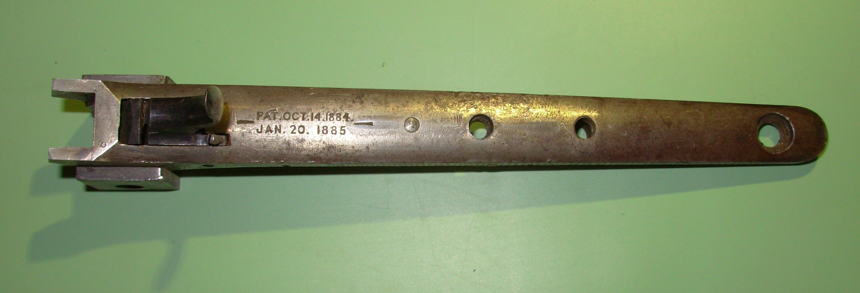

Here’s an interesting Model 1886 listing from GI.  The seller states that “the serial number was removed when the rifle was sent back to the factory for the addition of the set trigger”.  It has always been my understanding that the lower tangs without serial numbers in this model were the result of a change made by a gunsmith.  Winchester made replacement lower tangs available to gunsmiths for repair or addition/deletion of set triggers.  It seems that if an owner sent a rifle back to the factory for the addition of a set trigger, Winchester would simple mill the slot for the set screw in the existing lower tang and replace the necessary parts instead of inserting a serial numberless tang.
Also, the 29″ barrel length seems odd.
(Complete single set trigger lower tang without serial number.)

If Winchester did the work, the rifle would have left the factory with a serial number on it.  In my research of the Model 1885 Single Shot, when a rifle was returned for a set trigger (lower tang), it was returned to the owner with a new serial number on it.  The ledger entry (in the Remarks column) “New serial number xxxxx”.  Winchester did not rework the existing tang, choosing instead to simply replace it with a newly serial numbered set trigger tang.

Winchester made an entry in the remarks column for both the original serial number and the new serial number. For the new serial number it was often simply noted “Tang only” and sometimes “old # xxxx”.

I found so far 3708 set triggers out of 15956. I did find in the Madis book in the 73 section that when set triggers had a problem they replaced the whole tang and it didn’t have a serial number. It didn’t say if that was in the field or factory.
