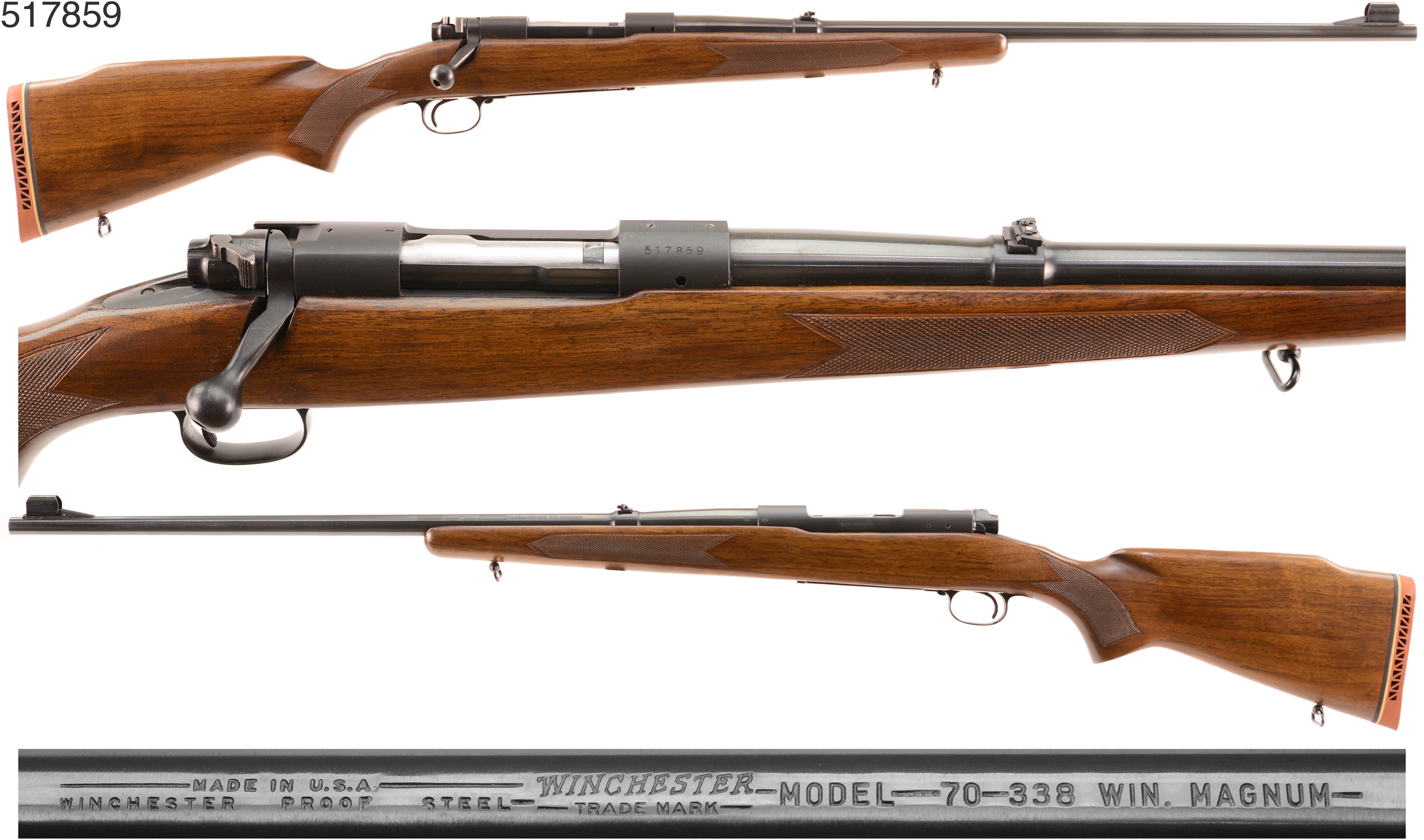

I sometimes have trouble with the early machine checkered stocks that were “cleaned up” by hand.  The hand checkering panels got much smaller (more in length than width) by the late 1950s, but the machine checkered panels (IMHO) are far narrower than those laid out by hand.  Also the fore end cross section was made more “square” and the grip radius adjusted slightly to accommodate the checkering machine, but those differences are often hard to see in pictures…
This one (an Alaskan) is machine checkered, and very close in serial number to the subject rifle…

If you’re specifically looking for a 300 H&H Magnum, one thing to be aware of is that they did NOT come with a recoil pad and the bridge was NOT factory D&T until around s/n 170,000. The gun I pictured above is a n Alaskan (338 WIN MAGNUM) and those did have pads… An added pad or D&T bridge on a 300 H&H Magnum is a 50% reduction in value (IMHO), so paying the kind of prices I’m talking about above for an altered one is a bad move…  So get to know what an unaltered one looks like…

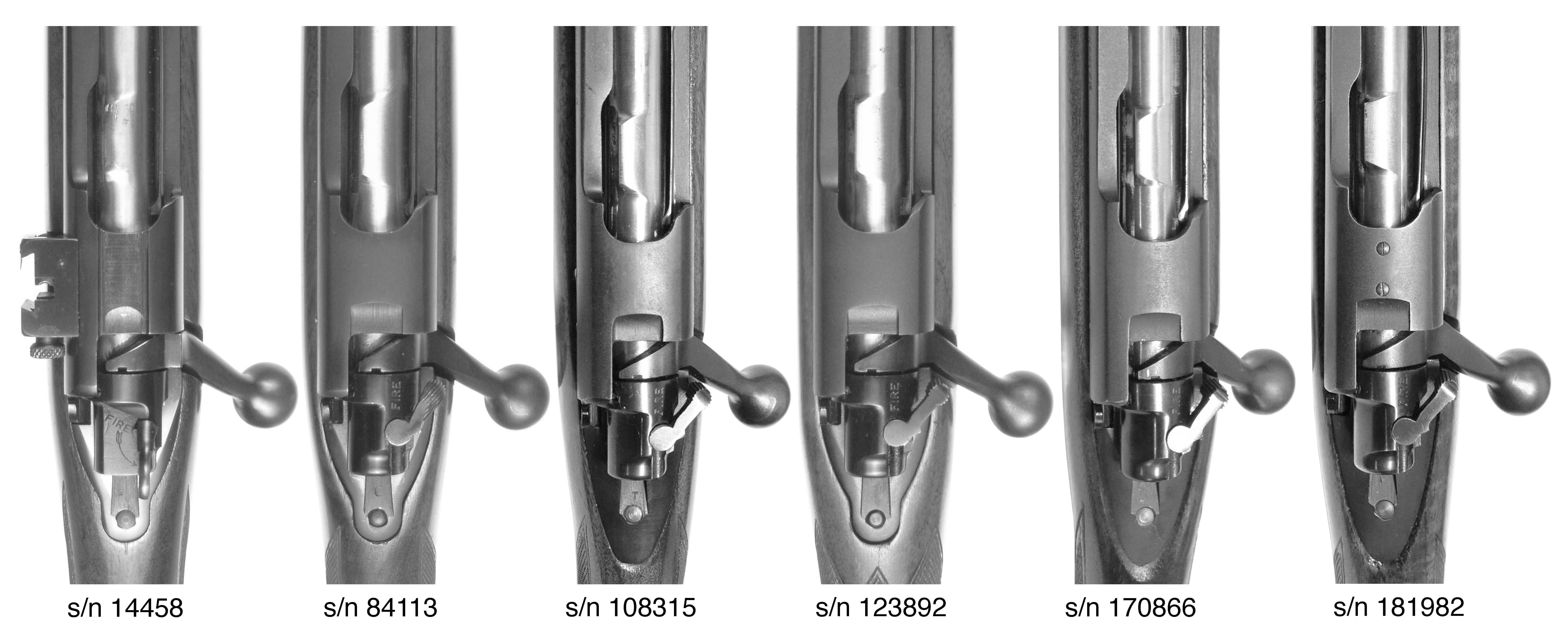

When it comes to H&H actions on M70s, the revision to the blueprint that added the two D&T holes to the receiver bridge was dated 11-28-50.
H&H receivers were typically NOT D&T until around s/n 170,000, which is well into the Type III oval tang receivers.  This pic I put together is kinda interesting (to me) b/c it shows H&H receivers from pre-war through type III.  Note that the last of the transition receivers were finished and serialized well after the first of the oval tang receivers, and that none of them were factory D&T before s/n 170,000.
