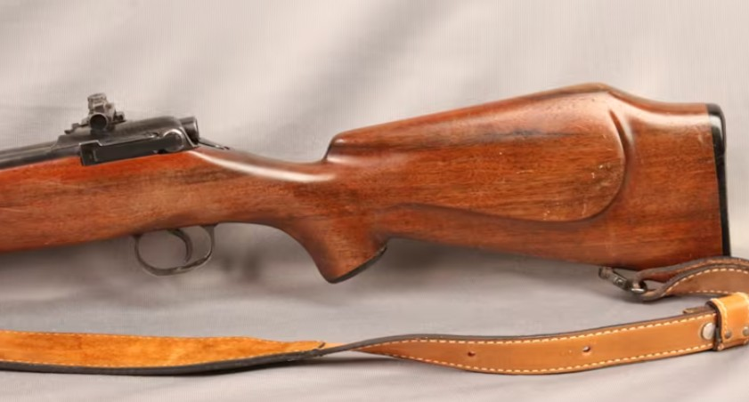

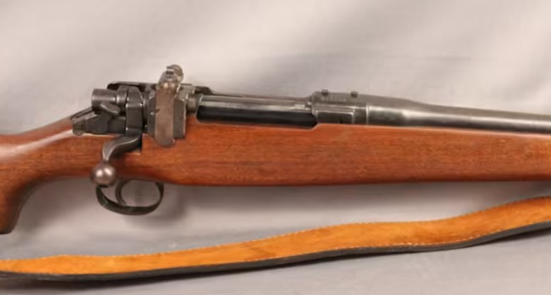

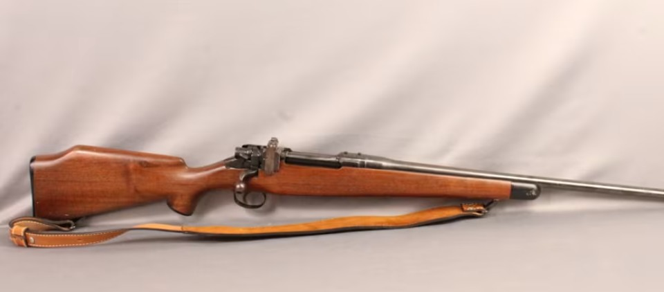

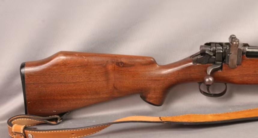

I’m not sure if I did something wrong when I first posted this question but when I try to view it , I don’ int see the question or pictures ? I’ll try again , curious why this rifle has no caliber stamp  , just says it’s a model 17 with a 24″ barrel ?

It’s a sporterized (restocked) infantry rifle with the “ears” ground off of the receiver, a US Model of 1917. Since all the M-1917 rifles were chambered in 30 Government 1906, the army felt no need to mark that information on the rifle.

The barrel contour looks like the original military barrel which started life as .30-06.  The caliber was not marked on the original 1917 barrels so maybe that is why it is advertised as unknown.  It could still be that original caliber but it also could have been reamed to .30-06 Ackley Improved (.30-06 AI) or even something more obscure such as .338-06 A-Square.  You will need the rifle in hand and likely a chamber cast to determine with certainty.

As memory serves me, the original barrel length on the US 1917 was 26 inches.  When these rifles were loosed upon the civilian market, reducing the weight was part and parcel of sporterizing them.  Toward that end, the barrels were often cut down. As JWA advises, it would be prudent to have a cast of the chamber made to see if it is still 30-06, or has been changed into something else.
