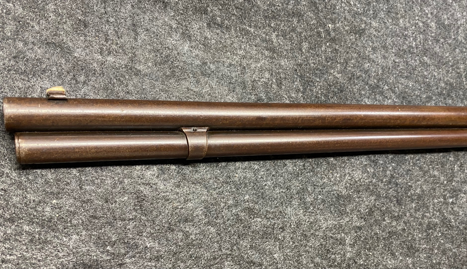

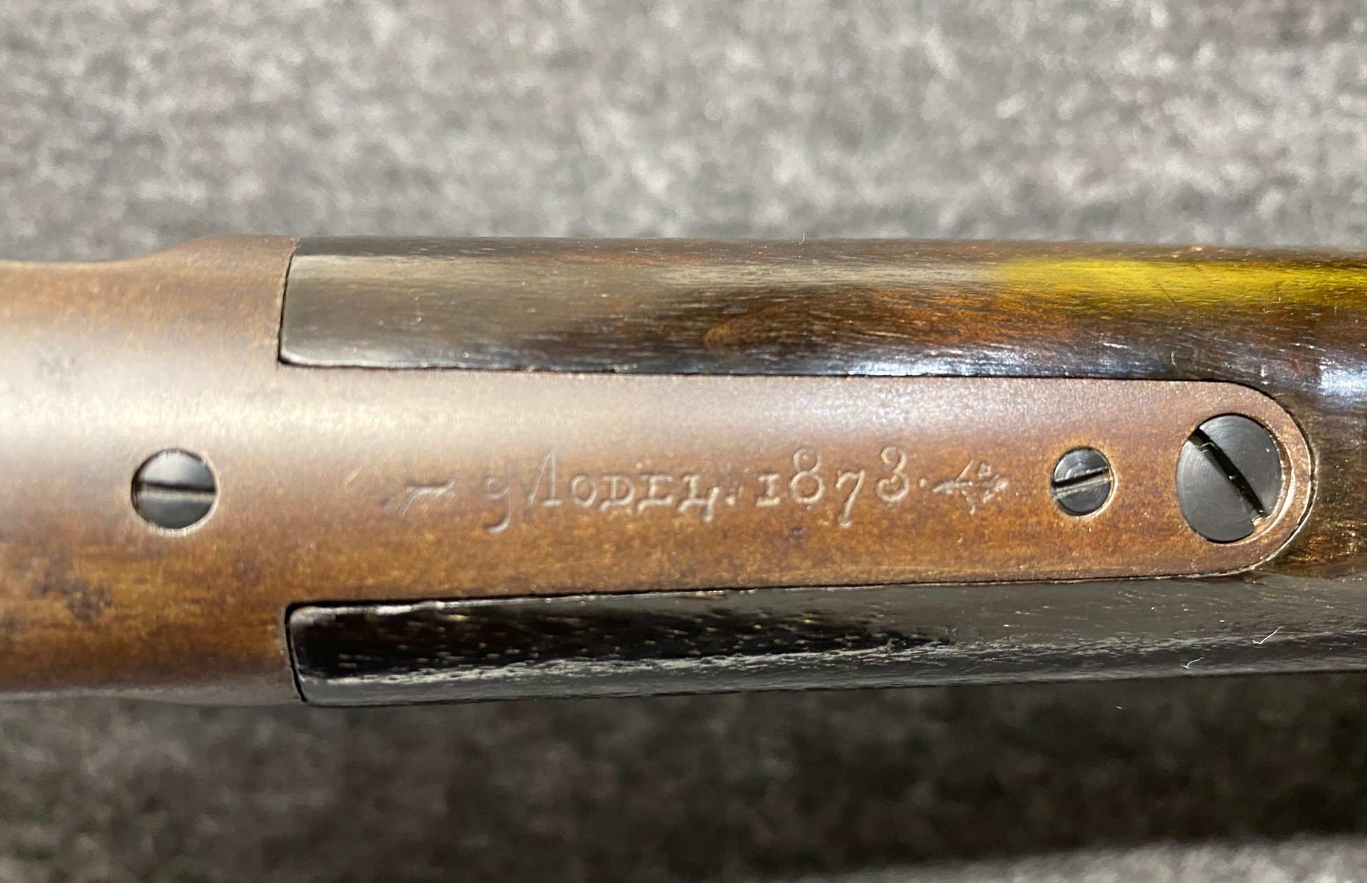

Just got my letter back on my 1873. The good news is that the set trigger is factory. The bad news is that is was originally 44 and is now 32 WCF. Is it possible this was rebarreled by the factory or should I assume it was done privately since it isn’t on the letter?
I also found it interesting that it was in the warehouse for 4 years after the serial number was applied. Is that normal? Thanks for any info.

In your place, I would contact the CFM records office and ask them to double check the ledger record for your serial number. All visual indications point towards it being an original 32 WCF rifle. I suspect a mistake was made listing it as a 44 WCF. Bob (1873man) most likely can add some useful information.

Hi,  I would suspect that the bottom tang, with the set trigger, is the only original part.  The rest of the rifle was added later.   Eric

If you can post some good clear pictures of the lower tang and how it fits into the receiver and several of the receiver. What is the serial number? You can’t post directly to the forum, you need to host the pictures on another site and link to them or email them to me at the below address.

The OP included (5) pictures with his opening post… are you not seeing them?  The receiver frame is the step-down type used on the smaller caliber Model 1873s, and the lower tang appears to fit up to the receiver frame correctly.

Here are the pictures. As far as I can tell the lower tang fits and matches the receiver given the condition of the gun. I would have Cody do a double check of the records.

They are now after Bob posted them.  This receiver was not meant for a 44 cal.

No, what we are looking at is the step down at the muzzle end of the receiver.  This was done on the smaller caliber guns.  Not on a 44.

So if I understand correctly, the only 2 possible explanations are that they made a mistake on the letter, or the lower tang is not original and was taken from another gun and placed on this one?
Forum Posts: 4964
January 2, 2021 - 1:05 am
Three possibilities, It can also be the ledger entry for the gun is wrong.

Stepped receivers were used on some late model 73’s in .44 caliber.  These are most often very high serial numbers.  It could be done, but there would be a lot of work involved in changing a small caliber reciever to a large caliber or large to small.  My guess is the letter is wrong.
