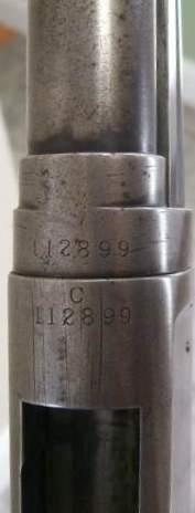

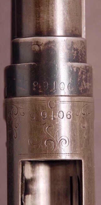

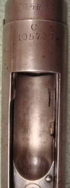

Here are a bunch of Model 1897 “C” series guns…
Serial-C99106.jpgSerial-C103219.jpgSerial-C103872.jpgSerial-C105737.jpgSerial-C110020.jpgSerial-C111802.jpgSerial-C112899.jpgSerial-C123875-16-GA.jpgSerial-C129392.jpgSerial-C130825.jpgSerial-C137010.jpg

Interesting replies.  There must be an even more interesting story behind why a company that paid so much attention to detail as Winchester did stamped so many serial numbers with a symbol that is neither a “1” nor an “L”.  The symbol looks like it might be a 1 with the left side of the number broken off the stamping die.dsc06509_1024x576.jpg

I am not of the opinion or belief that it was a “broken” die as some people have theorized.  The fact that I have found serial numbers with as many as four sequential “L” digits (each slightly different) is very solid proof that the dies were intentionally cut in that shape. The person working in the tool & die shop at that time simply cut them in an “L” shape.  Slightly later serial numbers have an inverted “T” in place of the “1” or “L”.
