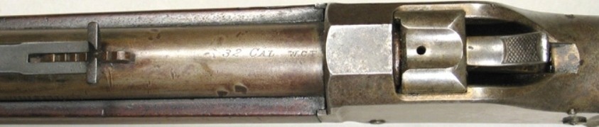

I am curious about just what the chambering is.  The rifle is stamped 32 CAL and after that RF.
My first question is how do we know which 32 rimfire? I know there was 32 Short, 32 Long and 32 EX Long.  Did they not have a stamp specific to each of these?  How do we know which cartridge is correct for this rifle?  Sally shows photos of each of the three cartridges but makes no mention which one fits.  Or do they all fit?
My next question is the caliber marking itself.  The 32 CAL stamping is quite the different stamping from the RF stamping.  The RF marking almost looks like an afterthought or not even done at the same time. Perhaps a larger lot of 32 caliber barrels were made up and stamped and then later chambered to a specific cartridge and that’s when the RF was added?

Steve,
The “32 CAL. R.F.” cartridge marking is the early style used for the 32 Short rim fire.  Later production barrels were marked “32 SHORT” or “32 LONG”.
Winchester manufactured a large number of low-wall rifles in the 32 caliber rim fire cartridges, a total of 3,905 in Short, 3,264 in Long, and 28 in Ex Long.

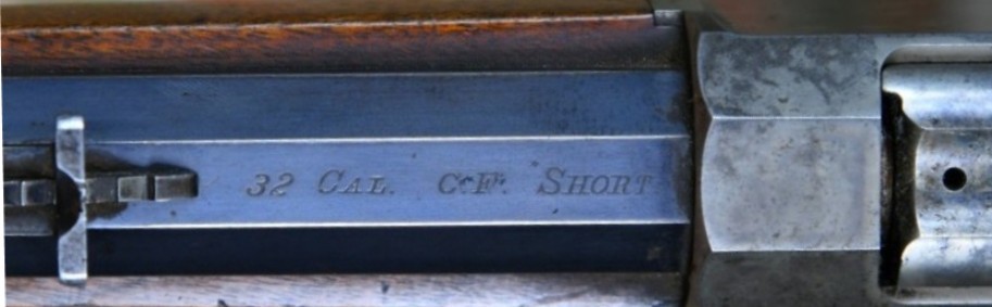

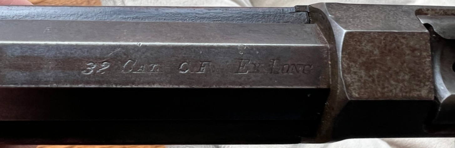

The “R.F.” is a separate stamped marking.  Winchester manufactured “32 CAL” barrels, and then when they were chambered for a specific cartridge they added the “R.F.” or “C.F.”, or “W.C.F.” marking.
Here are some examples;
