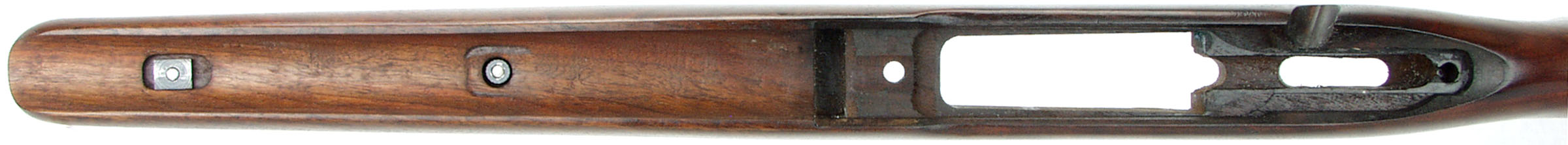

That said, I have a 1955 manufacture M70 “Van Orden Sniper” rifle (see pics on the link below and/or my earlier thread on the subject), that has exactly the feature you are describing (dummy barrel bedding screw filling the hole in the fore end of the stock and a target weight barrel not dovetailed underneath to accept the screw escutcheon).  See if the treatment of the screw on your rifle looks like the 1955 Van Orden.
http://s1382.photobucket.com/user/luttrell4/media/M70VanOrdenSniperedit351439_Page_1_zpsd4940125.jpg.html?sort=3&o=0
Cheers

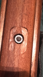

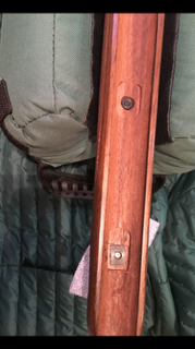

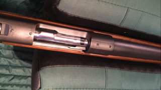

Sorry for the delay in posting a photo.  This is the Varmint stock I mentioned earlier.  The rifle is 1955 #358360.  Does this appear to be something that would have been produced by winchester or, in the opiniom of the forum, a standard stock someone has converted to fit the Varmint barrel?  Lou, to me it looks similar to your VanOrden rifle.  The stock has a steel butt plate, pre 1960 checkering, etc.
Fielding

Looks pretty similar, doesn’t it?  The ‘edges’ on the inletting are a bit cleaner/sharper than on my gun, but the backing nut looks the same, etc.  This picture below may show up a bit better than the Photobucket composite:
One ‘clue’ might be to look at whether there is stain/filler slopped over into the barrel channel at the juncture between the finished top edge of the stock and the inletting.  If this were a stock that had the barrel channel opened up after it was finished, such finish ‘over runs’ would be missing.  The Van Orden gun above doesn’t illustrate this, as it was ordered with a linseed oil finish, not the standard stain/filler/lacquer combo.
For what it’s worth, in all I have eight M70s with the combination of ‘standard’ stocks and medium heavy target weight barrels.  Five are pre-war rifles (two 375 Magnums and three in other chamberings), two are Varmint Rifles, and the last is the Van Orden gun.  Of the pre-war rifles, four have a dovetail cut under the barrel with escutcheon installed and a working barrel bedding screw.  The fifth does not have a dovetail cut under the barrel, and the stock (which has other ‘special dimension’ features) lacks the hole.  The two Varmint rifles are not dovetailed underneath and the fore end of the stock lacks the hole (which is how they’re ‘supposed to be’).  Only the Van Orden rifle picture above shares the features of your rifle.
Just to put into this post, the S/N of the Van Orden gun is 351439, which is pretty close to your 358360.
I can’t say for sure, but they look similar to me!!!

Thank you for the response. There is no dove tail cut on the underside of the barrel of my rifle.  Just the Varmint style Stainless Steel barrel.  There are some staining over runs into the barrel channel. Part of the pleasure collecting these rifles is the human aspect of their production.
