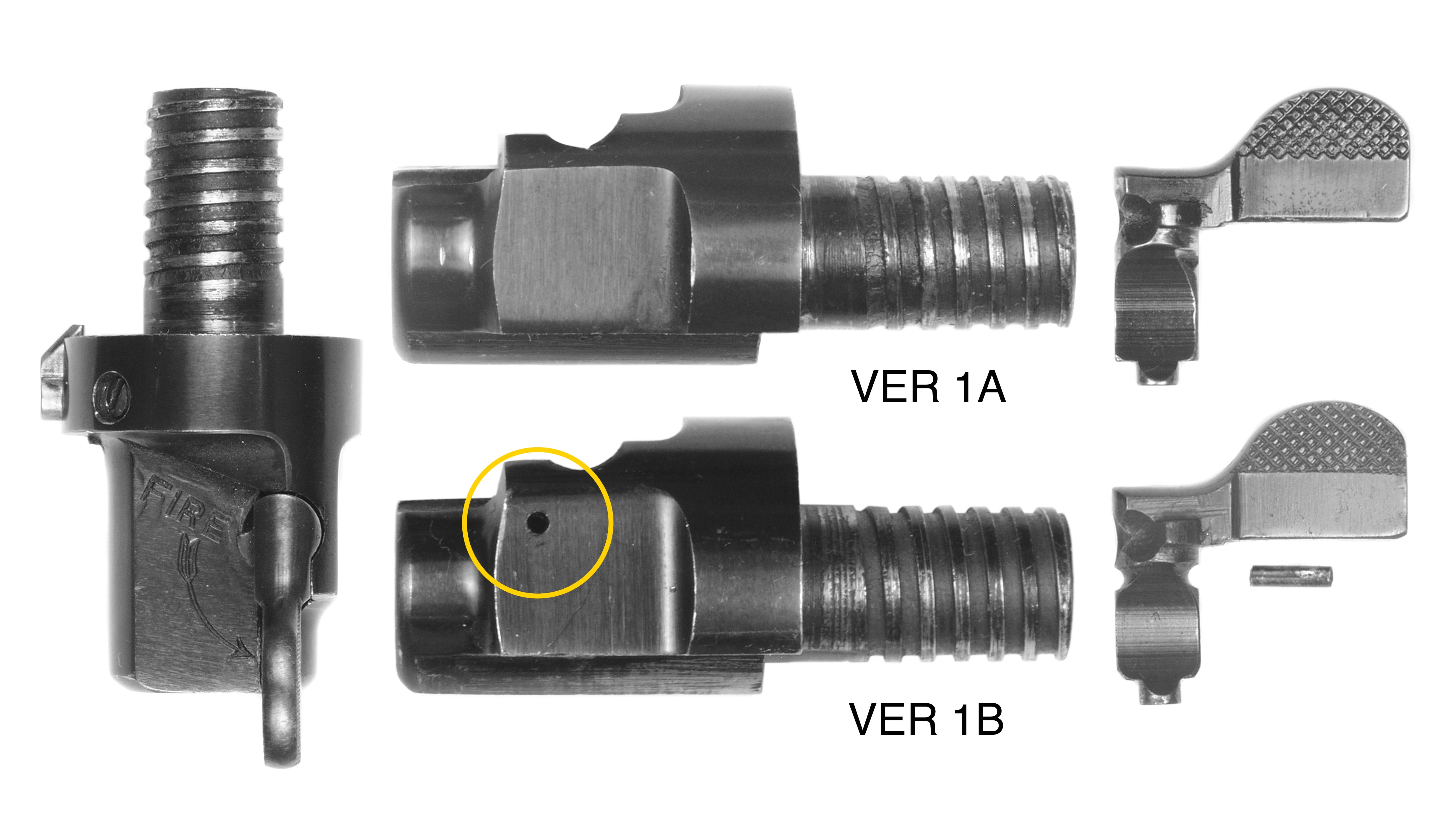

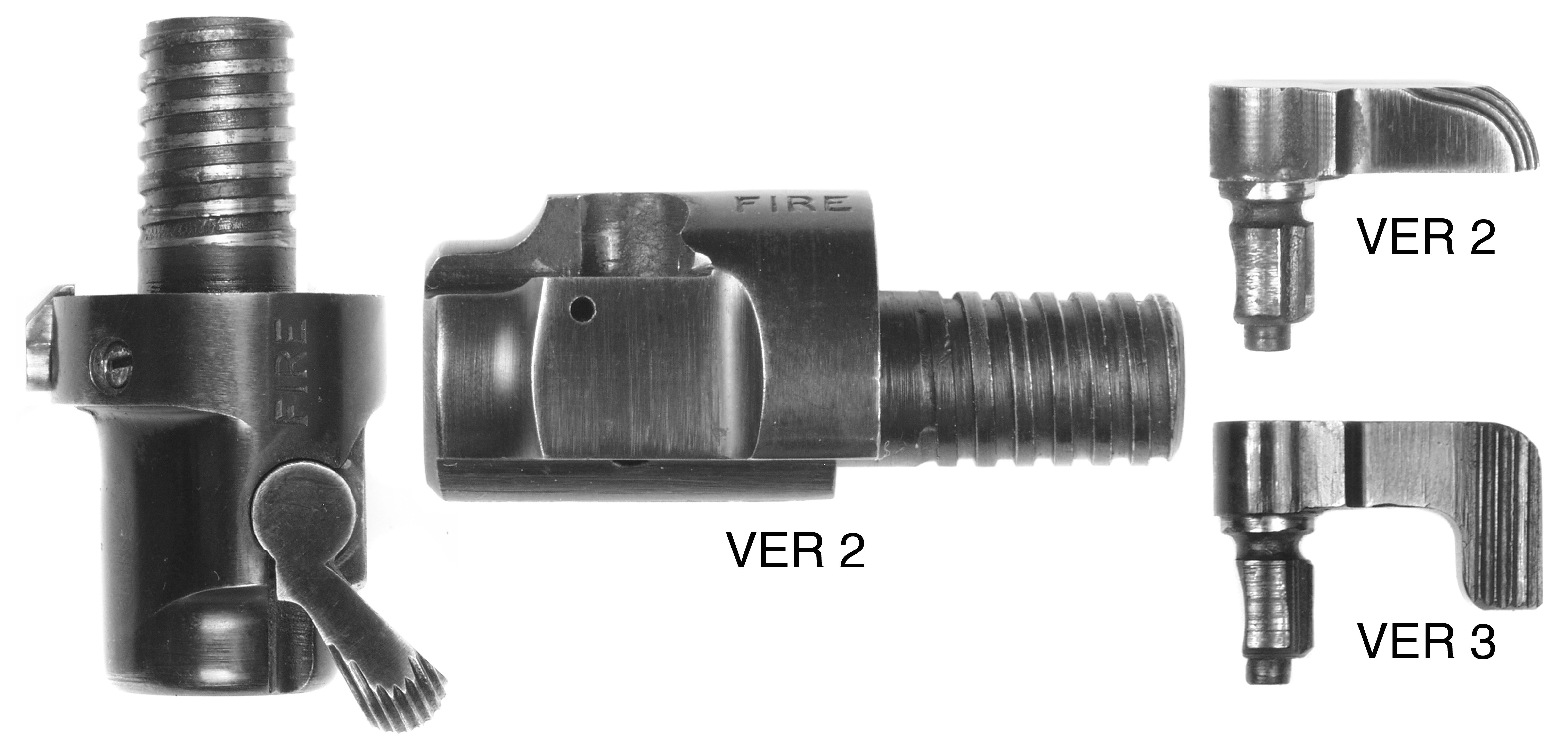

Hi Victorian-
Model 70 safeties were interchangeable between different bolt sleeves.  So you could have a pre-war (Version 1) bolt sleeve with a Version 3 (“dogleg”) safety OR the whole bolt sleeve/safety could have been replaced.  As Ben said, pictures would allow us to tell you exactly what yoou’ve got…
Please look at the pictures below…  First is the pre-war bolt sleeve (flat on top) that went with the original “flag” safety.
Next is the later style bolt sleeve (round on top) that was designed for use with the later style (side swing) safeties.
If you have a later style “dogleg” safety on your pre-war file, then it’s been replaced.  The question is whether the bolt sleeve was also replaced.  Late M70 safeties will work with all M70 bolt sleeves, and it was common when putting a scope on a pre-war gun to change out either the safety or the bolt/sleeve combination.

I am unaware of any formal program for returning pre-war Model 70s to have their bolt sleeve/safety exchanged.  Unless a side mount was used, the “conversion” of a pre-war action would also involve drilling at least one hole in the bridge for a scope mount.  Usually these modifications were done by the consumer, although I’m sure Winchester would let you send a gun back (for a fee)…
The Version 3 “dogleg” safety came along in 1948, so to have been factory converted before the initial sale would have required the rifle(s) to have sat in inventory for nearly a decade (1939-1948) and be pulled from the warehouse and sent back to assembly.  That is unlikely.

Yours has the expected bolt sleeve.  The hole in the side for a safety retaining pin (distinguishing Versions 1A and 1B) was added early in 1938 more or less around serial number 14,000.  That bolt sleeve was then used for the rest of Type I (pre-war) actions.
