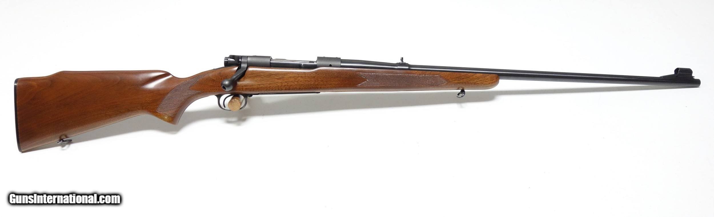

Perhaps restating… My ‘net’ understanding from the above information, “no actual barrel nomenclature terms “Westerner” or “Alaskan” on rifles themselves. My personal recollection also consistent with such conclusion in respect of my four ‘pre genre’: 264 Win Mags, two each Standard and two Featherweight; a couple of 338 Mags and single 300 Win Mag. (My ‘working’ photo files c. 2007-08 inconclusive.)
Also, ‘quickie’!  Any in-stock visually prominent indicator of “stainless” material .264 barrels? One of my standard models above, single-pix relevant “appearance” suggesting perhaps stainless. SN 491K = 1960, see below.

Just going off memory here…  According to the information in Rule’s book, the 264 WIN MAGNUM Westerner barrels were originally stainless steel but the specification was changed to CMS sometime in mid-1960.  The stainless barrels, at least originally, were easy to identify b/c they had the bead blasted matte finish applied to other stainless barrels (hopefully these photos will be clear enough to see the difference):
According to my survey so far (and with the caveat that my record of barrel finish is often based on my “best guess” from on-line photos), pretty much all the Westerners between 465,000 and 482,000 had this matte finish stainless barrel.  From 482,000 to 581,000 the vast majority of Westerners have a polished blued barrel that looks like CMS, although the occasional one will have the matte stainless barrel:
What I DO NOT know, is whether any of the 264 WIN MAGNUM barrels in stainless steel were finished using the directly applied “blackening” process that Winchester eventually went to for the 26″ medium heavy (target weight) stainless barrels used on 220 SWIFT and 243 WIN target/varmint rifles.  You probably recall that late in production, the factory adopted a process to directly blacken stainless barrels, thereby omitting the bead blasting process that produced the familiar matte finish.  The changeover is easy to pick out on the varmint rifles b/c the barrels were ALL stainless steel, and around the 480,000-485,000 they went from matte finish to something that looks like polished blued finish.
It’s more complicated with the 264 WIN MAGNUM, of course, b/c there was a change in barrel steel that happened just about the time that Winchester was changing the stainless finish from bead blasted to polished.  To me, your photo looks like it could be a polished stainless barrel, as opposed to polished CMS, and the 491XXX serial number would put it in the time frame were all these changes were happening.
MAYBE… If these late polished stainless barrels are still stamped “ST” under the chamber, you could tell by pulling the stock, but I’m not 100% sure they were still so-marked.  I’ll need to take a couple guns apart that I haven’t gotten to yet.  One thing that DOESN’T help is the muzzle face.  On the matte finish barrels the muzzle face is in the white b/c the crown was covered during the iron plating needed to make the regular blue take.  However once the direct bluing process was adopted the muzzle face on the polished stainless barrels got blackened just like on the CMS barrels.  So you can’t use the muzzle face to tell a CMS barrel from a polished stainless barrel.  Another possible way to tell is that the finish on the polished stainless barrels was slightly “off” in color/luster compared to the regular blued CMS barrels.  Rule described this as a “smoky” blue finish, and I can definitely tell the difference with a bunch of guns (of known barrel steel) in front of me.  But I’d never want to make the call based on a photo.

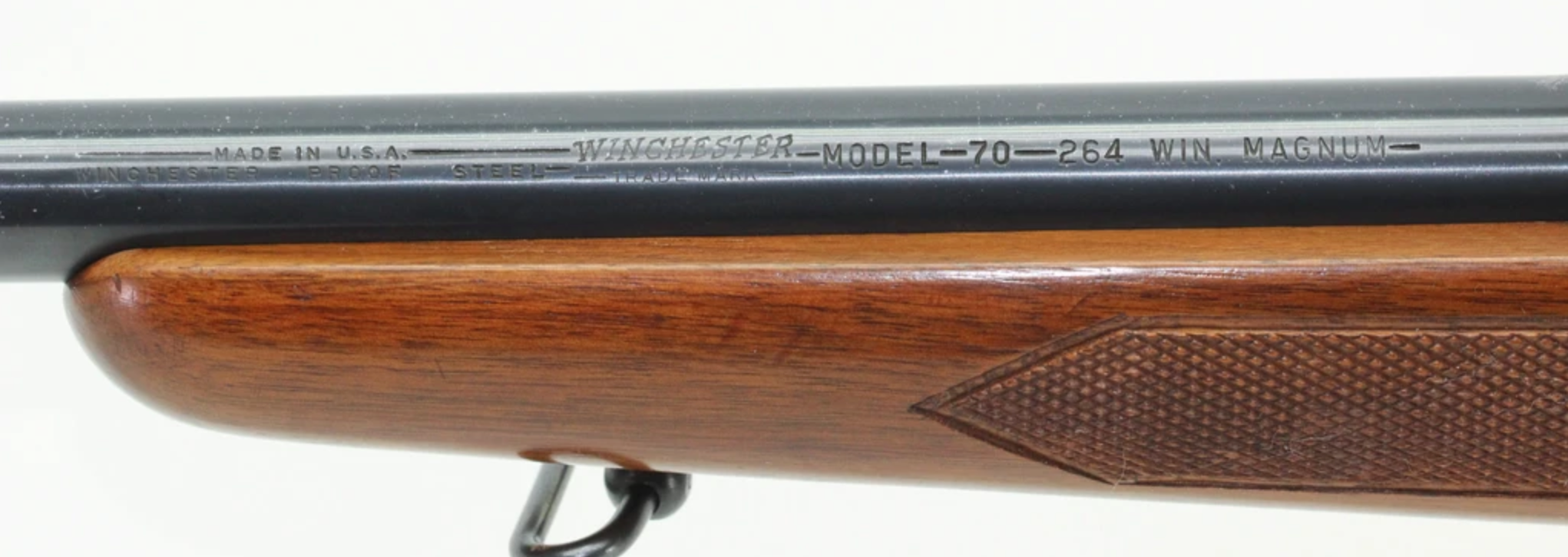

Following up on the barrel roll marking for the pre-64 M70 short magnum chamberings.  Neither the African, Alaskan, Westerner, nor 300 WIN MAGNUM “Westerner-Alaskan” had the marketing moniker impressed onto the barrel.  However, the “short magnum” marking did differ from the standard rifle barrel marking in small ways.  By way of illustration (pics below cobbled from various sources, mostly pre64win.com):

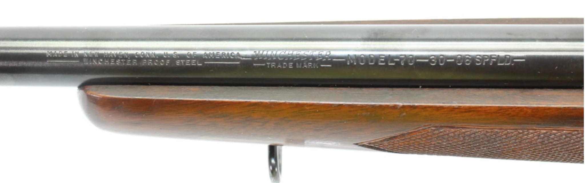

The “standard” style 3C barrel marking, used for example on this 1961 vintage 30-06 SPFLD standard rifle, reads in part “Made in New Haven Conn. U. S. of America”.
The African was the first to use what Roger Rule termed the “short magnum” roll mark, which differed only in the line “Made in U.S.A.”  The subsequent Alaskan and Westerner used the same marking.
1956 African:
1960 Alaskan:
1960 Westerner:
The 300 WIN. MAGNUM “Westerner-Alaskan” was a special case.  Only cataloged in 1963, it was not specifically denoted as either a Westerner or an Alaskan, while the others were so-named.
FWIW… The BOX LABELS only read “Super Grade Rifle” (for the African) and “Standard Grade Rifle” (for the Alaskan/Westerner series).
