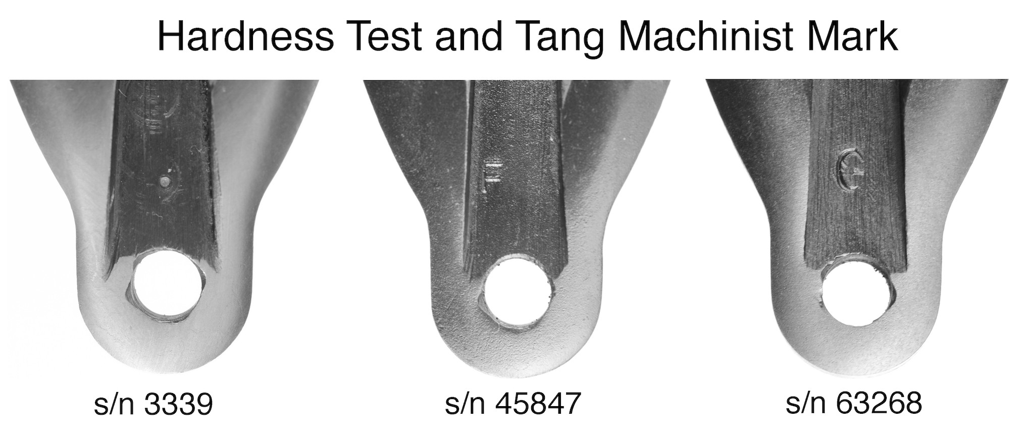

can anyone suggest what an uppercase letter “G” might mean, marked on the rear of the receiver of my pre-64 model 70 serial no. 717xx?
this “G” is not added to the serial number as a prefix, it is a clear marking on the flat bottom of the rear of the receiver where the bolt is inserted, and just forward of the rear action screw cap.

I’m assuming you are looking at a single capital “G” stamped into the striker slot in the top of the tang?  If so, it’s a machinist stamp.  These were commonplace (but not universal) from about S/N 8000 (1937) through the mid-1950s.
They are not all “G” and have nothing to do with the G-prefix serial numbers on post-1968 rifles.  Stamps include the single letters J, U, F, G, O, and the numeral 4.  Does it look like these?  The one on the left is a Rockwell Hardness test dot found in the same location on some pre-war receivers, mostly below s/n 5000.
