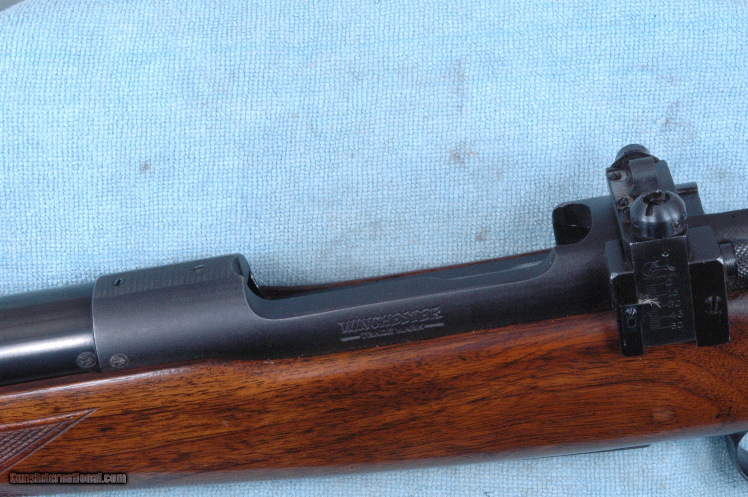

The run-of-the-mill oval tang receivers (comprising most of pre-64 M70 production) look like this (.300 WIN MAGNUM Westerner-Alaskan S/N 578367):

Finally, the relatively rare undrilled oval tang H&H Magnum and Target Models look like this (.375 MAGNUM Standard Rifle S/N 170827):
Sorry that the cross bar of the receiver sight is partly in the way in this scavenged photo, but of you compare to the hole spacing in the previous photo you can tell this one is not D&T.
Hope this helps… Laugh  Best I can do on short order…
