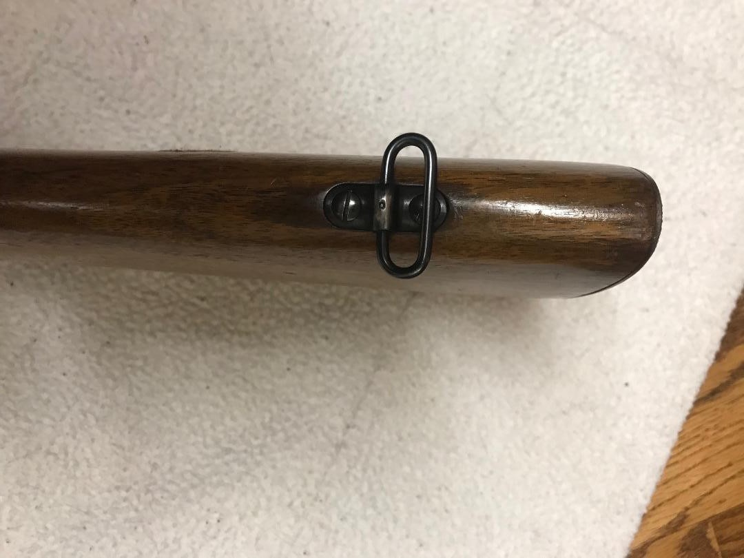

Here are the photos farlow sent me:
target-70-left1.jpgtarget-70-caliber.jpgtarget-70-fore-end.jpgtarget-70-front-swivel.jpgtarget-70-rear-swivel.jpgtarget-70-breech.jpgtarget-70-tang.jpgtarget-70-bolt.jpg

Thanks once again Louis! First for answering the question I was I was seeking concerning comparative configuration rarity factors particular to the .243 chambering in the 70. Second for the multi-pix. My belief, no iron sights standard on such Target models. Correct? (And “fungible”! Like the “fun” in that term! 🙂 )

The target rifle (1936-1952) was provided with metallic sights.  On the really early ones with a front sight ramp the sights were Lyman 17A front and Lyman 48WJS (not 48WH):
From about 1938 to 1952, the standard sights were Lyman 77 in AK (cross dovetail) block and Lyman 48WH:
From 1936 to 1946 the stock was regularly inlet for the Lyman 48 sight.  However, it should be noted that early, even pre-war, target rifles stocks that are not inlet are NOT rare.  The option of a “sightless” G7044C (30-06 target rifle) was specifically cataloged in the pre-war era, and those “clean” stocks show up on many other chamberings as well.  In 1947 the Lyman 48 sight block was redesigned such that inletting the stock was not required.
The target rifle was dropped from the catalog in 1953-54.   When it returned in 1955, the barrels had two D&T holes at the muzzle, replacing the earlier dovetail.  This could be used to affix a Lyman A block.  The 1955 to 1963 target rifles were cataloged only in 30-06 and 243 WIN, although 220 SWIFT target rifles from this period are not rare.  These rifles, including that of the OP, were NOT regularly supplied with sights (RIA photo):
Regardless of era, all target rifles came with Lyman type scope blocks, 0.360″ high on the barrel and 0.185″ high on the receiver ring.
