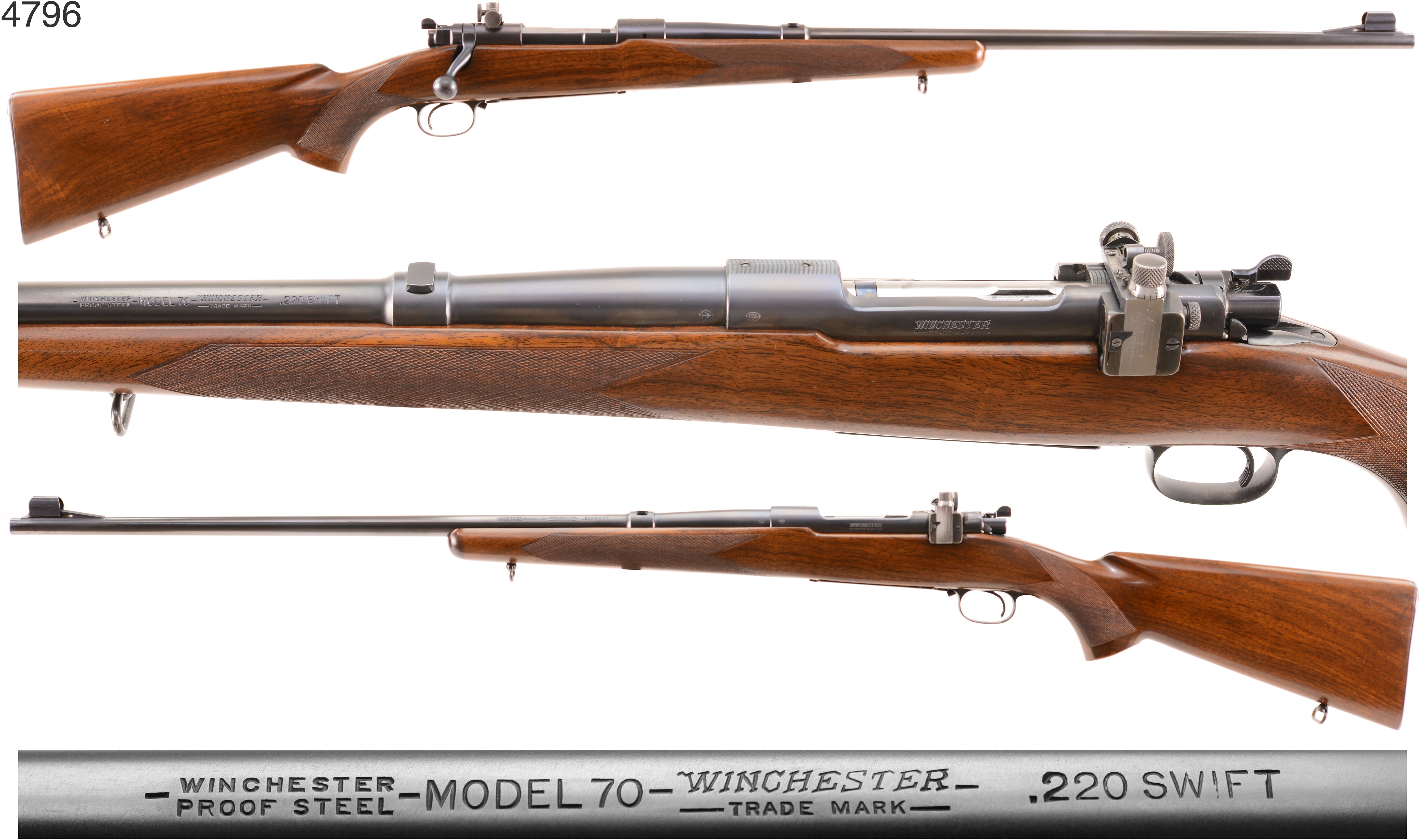

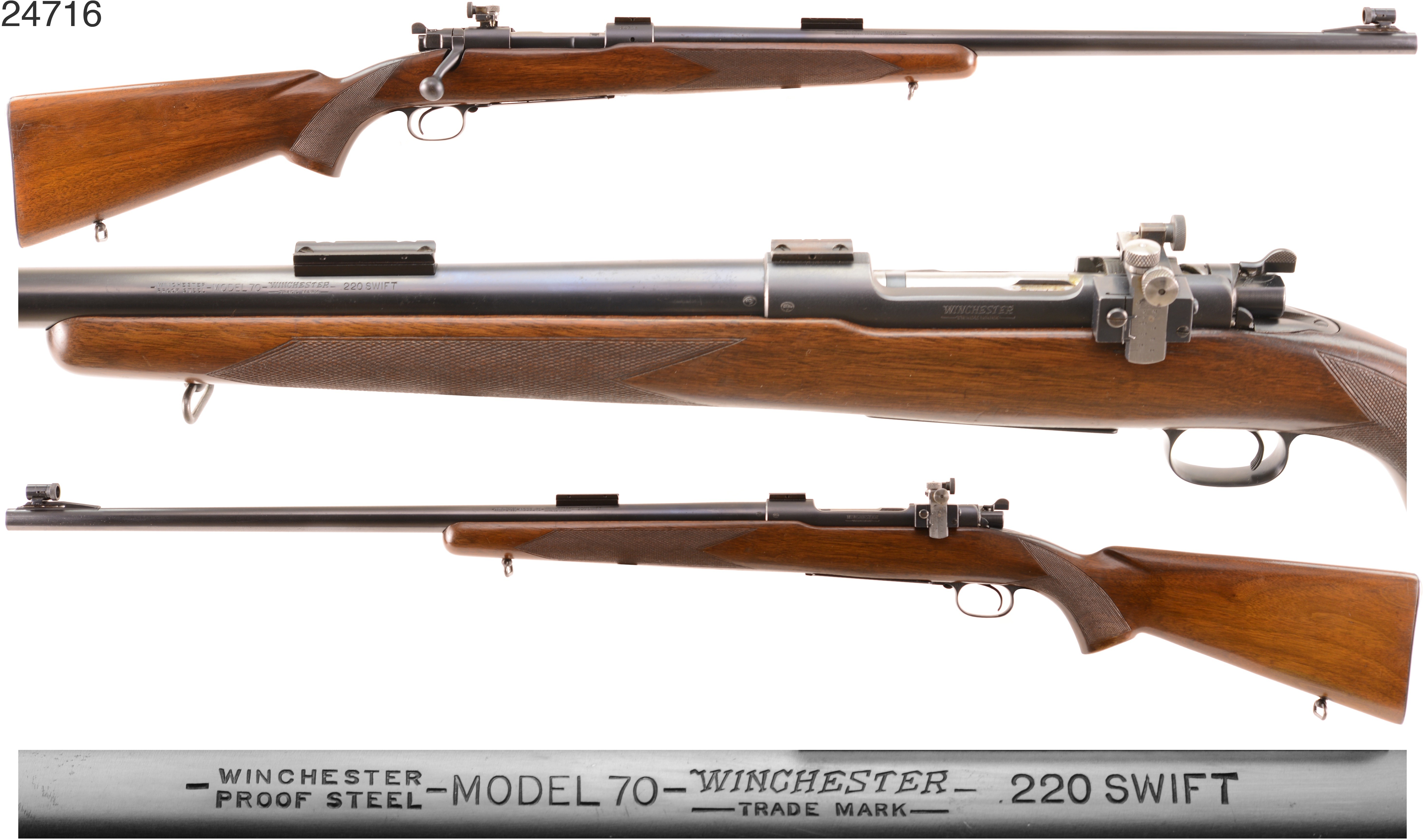

If you’d care to post a few of the pictures you’re reviewing I can probably tell you what it is.  In the meantime, here are some comparisons:

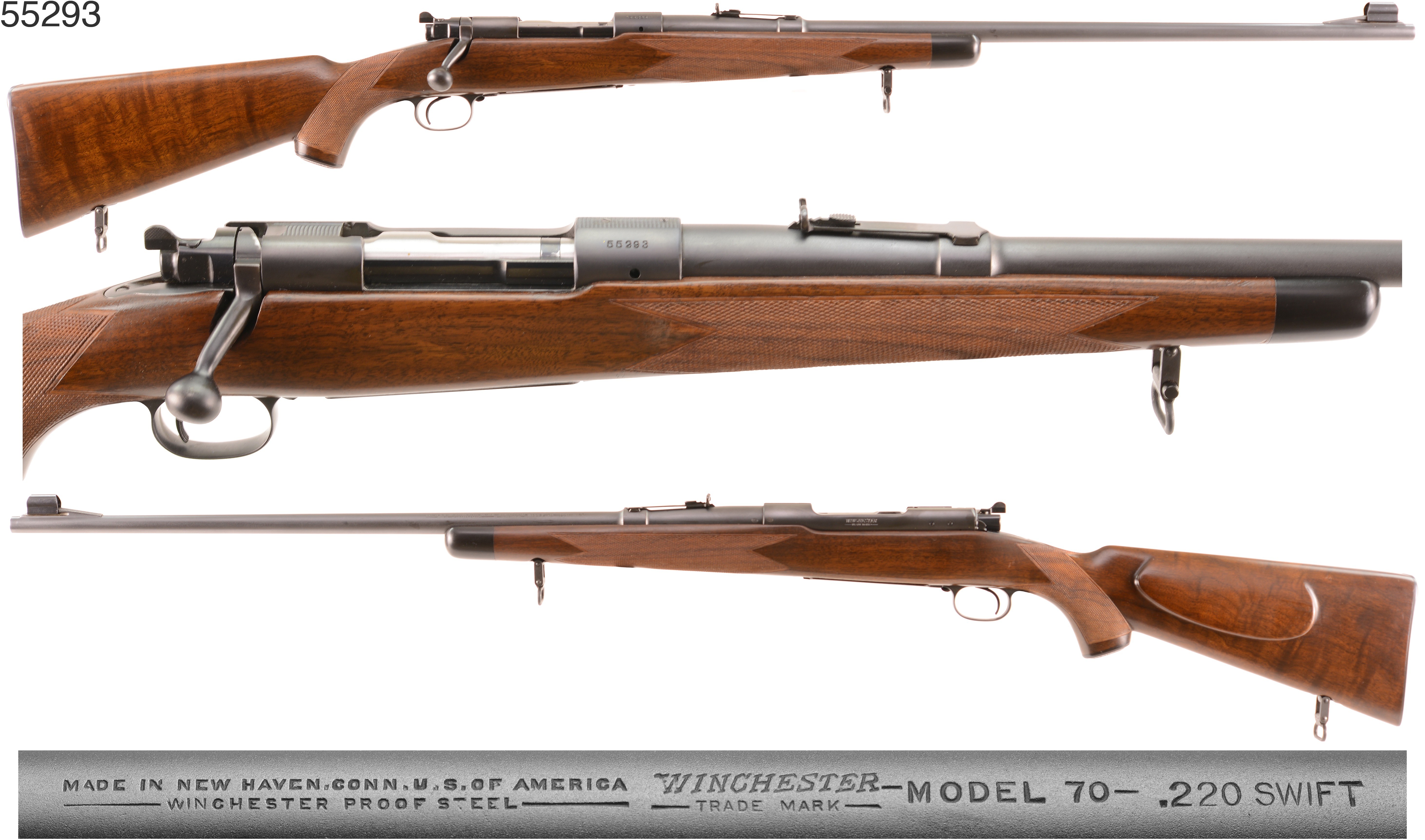

Pre-War 220 Swift Standard rifle:
Pre-War 220 Swift Super Grade:

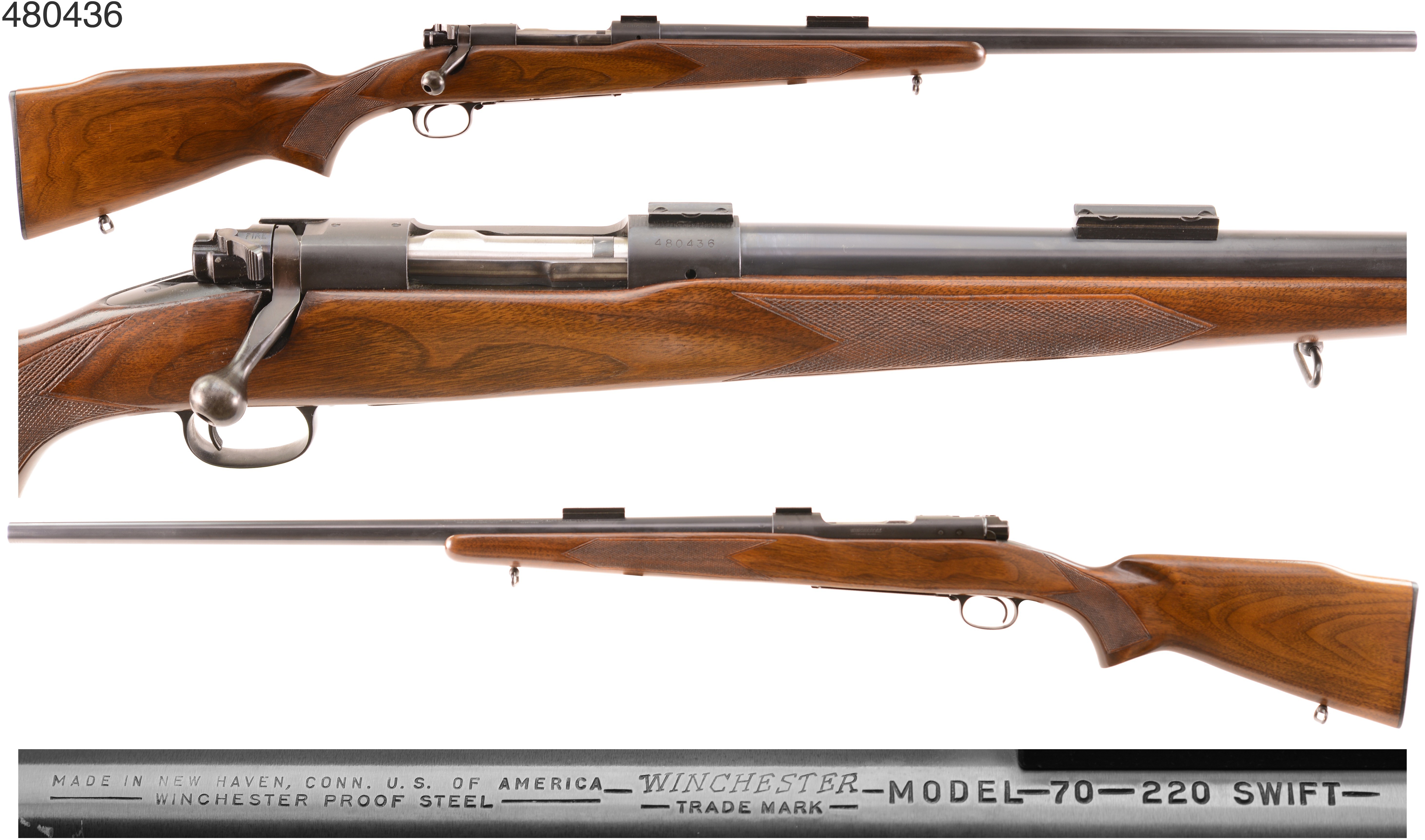

Transition 220 Swift Target model.  Note the heavier barrel and marksman stock. This is a 1946 gun, the only pre-war 220 Swift Target model that I have is the “1st variation” type with the same barrel contour but an integral front sight ramp:

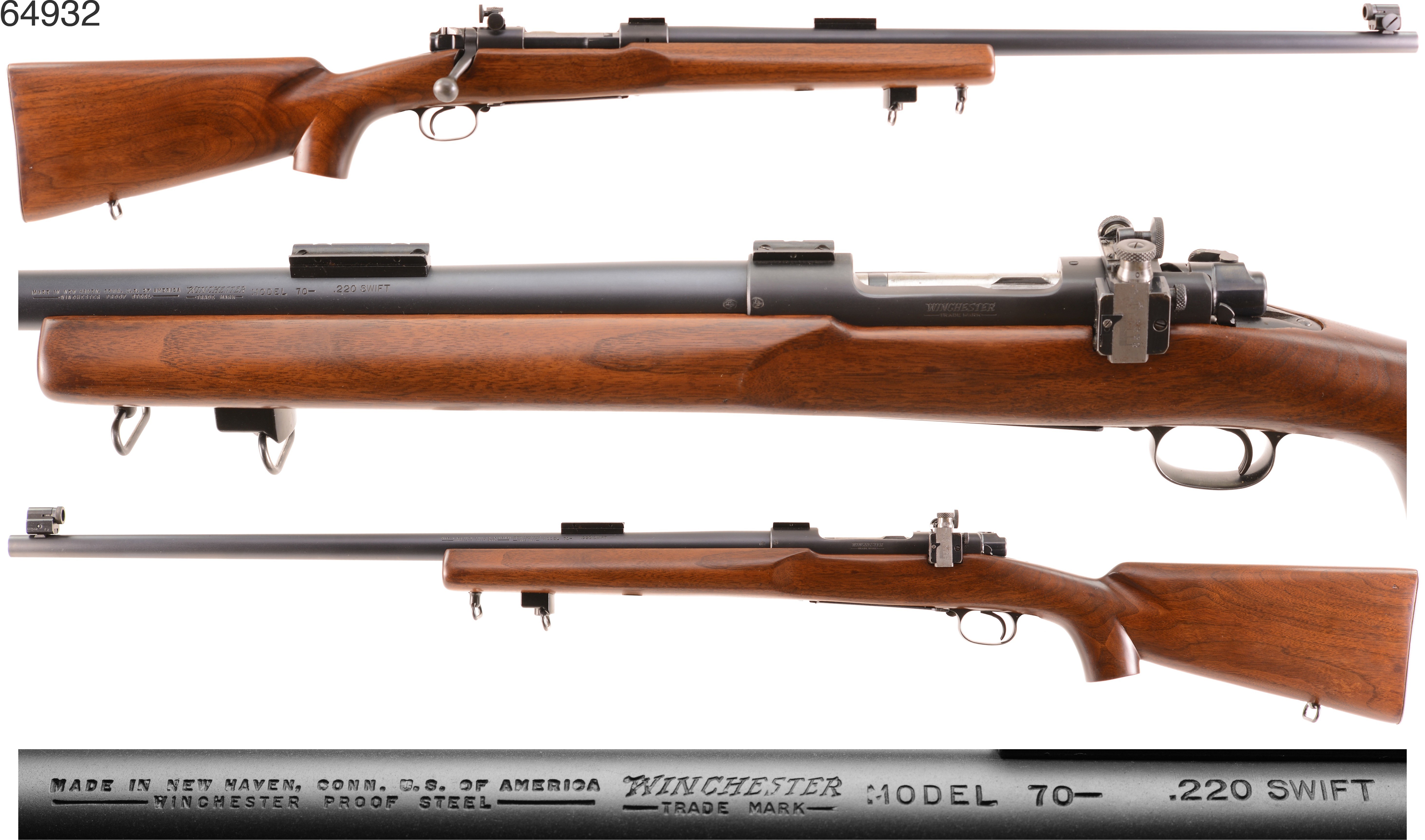

Pre-War 220 Swift Target model in NRA style stock.  This one has a ’36 date CMS barrel with front ramp, but the barrel contour is the same as above:
Does the gun you’re looking at resemble any of these?

Good afternoon, Lou:
Thanks very much for this information, particularly that the 220 Varmint version was not available until 1959.  The rifle I was considering seems to match your third example.

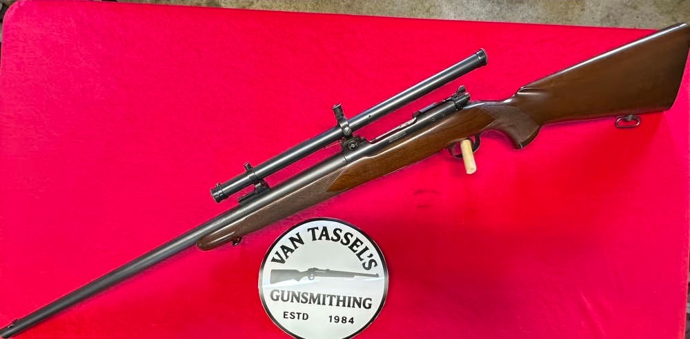

I remember looking “long and hard” for a swift with a good throat!
Took a good while, but I finally found one! (1950 Standard grade)
Seems some old time handloaders wanted to drive their bullets even faster than Winchester ballisticians!
My handload is a MOA with these 84 year old eyes!
