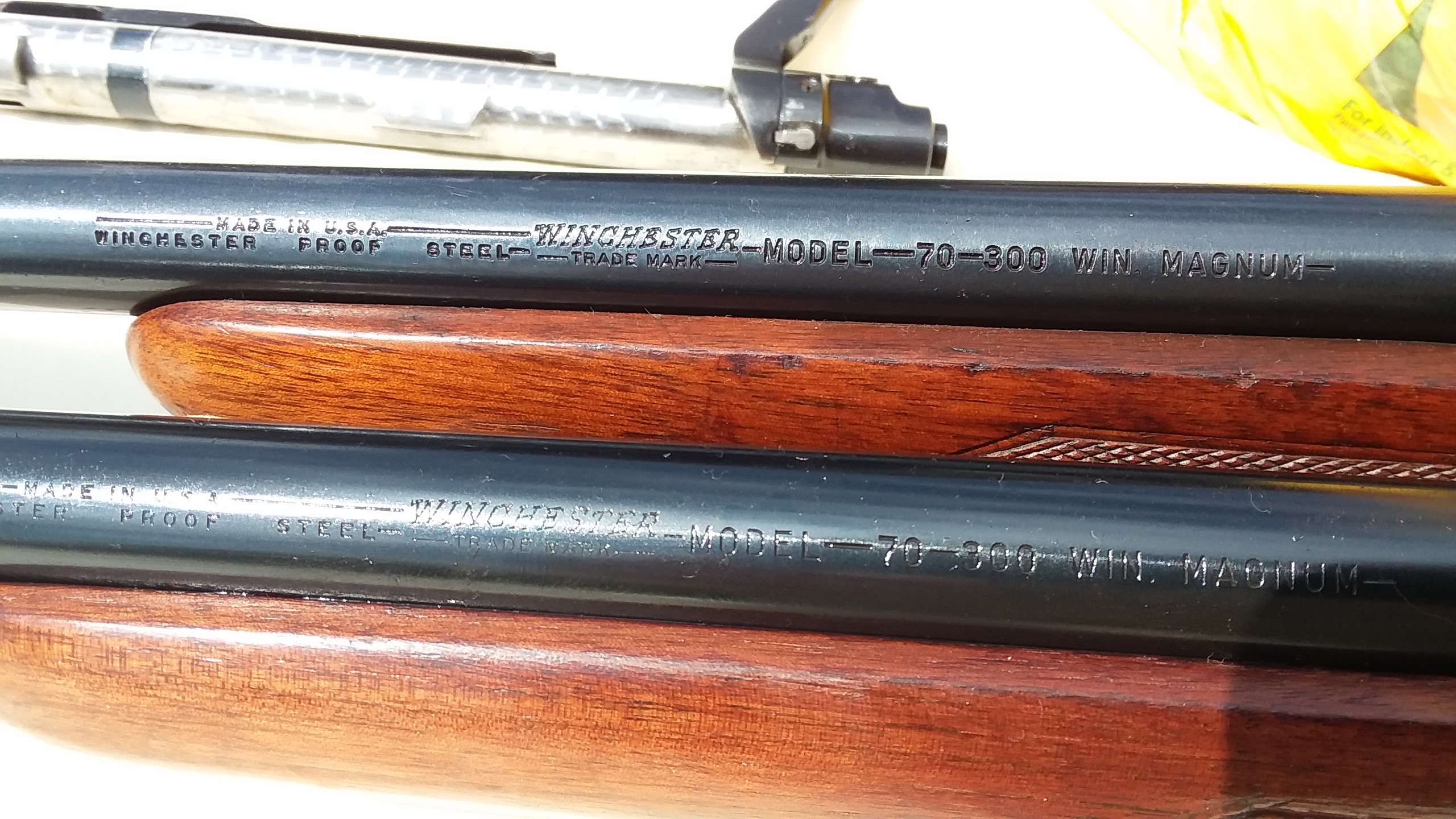

I’ve just had a quick look at my specimen file pix. Photo angles not perfect, but at least barrel proof perceptible in traditional ‘breach top’ positioning & receiver ring too, if seeing correctly, offset left. One possibility, if Winchester provided a replacement barrel to be fitted elsewhere beyond factory. Resulting lack of factory barrel proofs. Because the chambering adds particular value to the “pre 64” genre due to limited production period, conceivable the barrel genuine Winchester but “aftermarket”, purchase as replacement component. Of course, barrel discussion not providing explanation if receiver also without proofing mark.

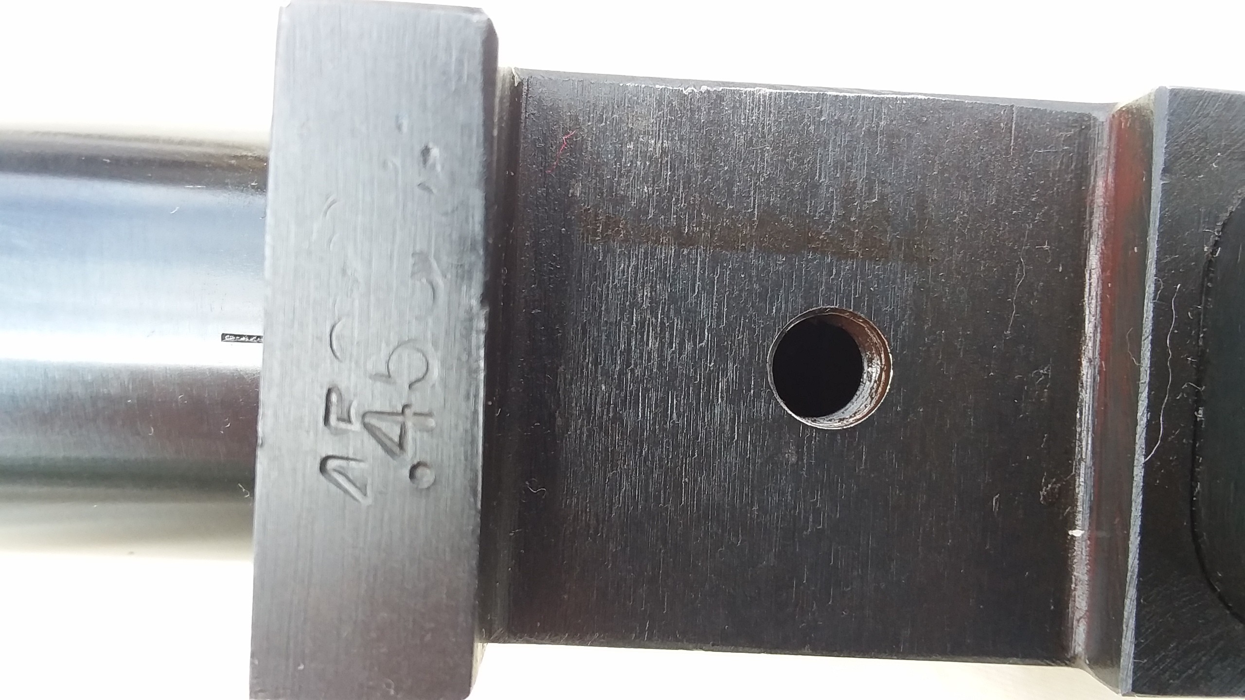

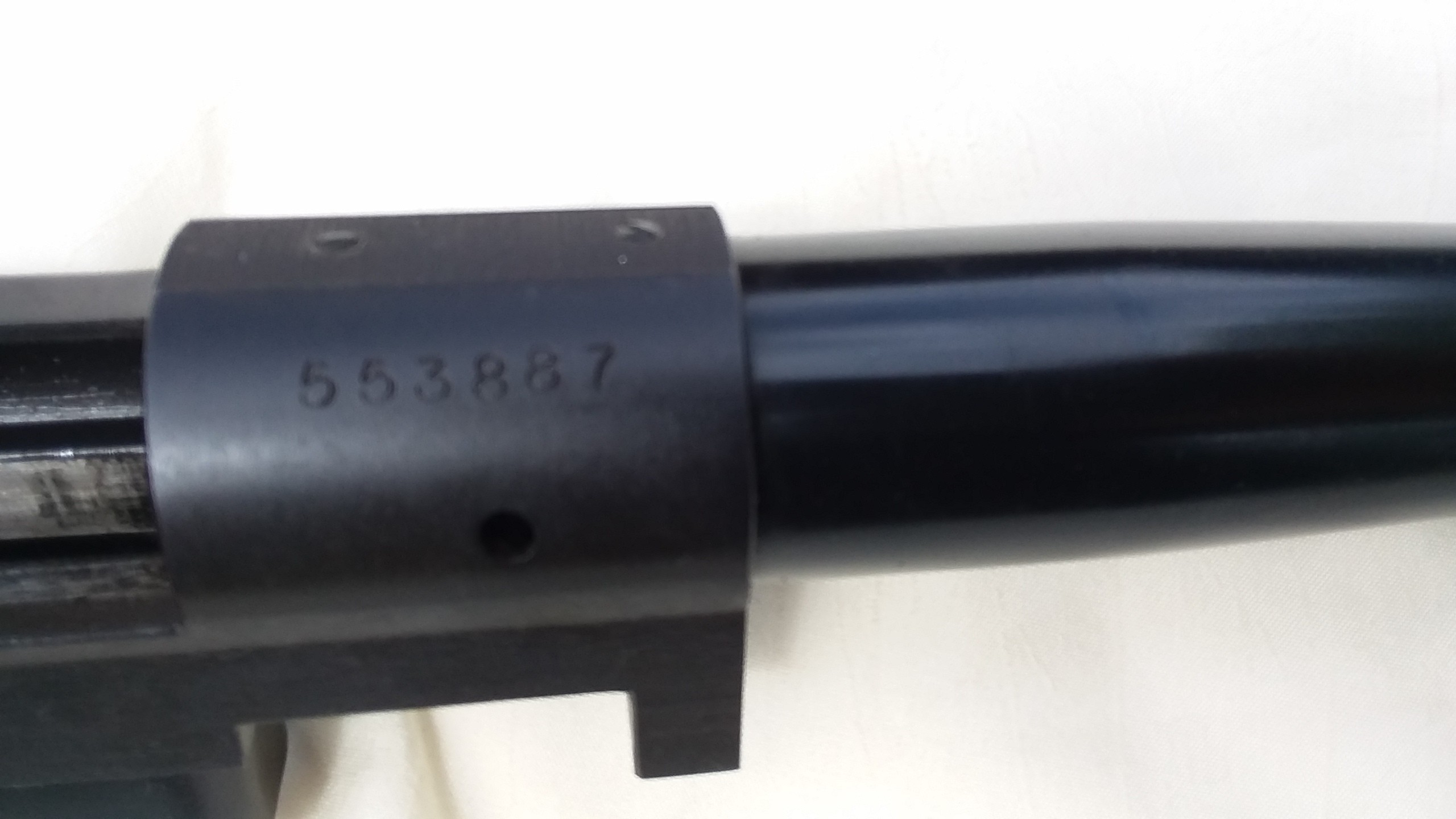

The serial number on the receiver is 553887 and has an incomplete double stamped .458  that only shows a clear .4  followed by a faint 58 stamped on the lug, this is on top of a faint stamped .458. The engine turned bolt does not show any signs of etching for a serial number. The barrel appears original. There are not any under barrel markings except for the center alignment mark.

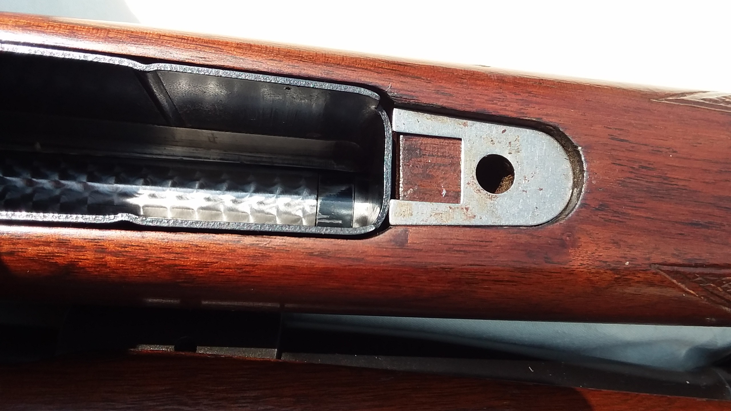

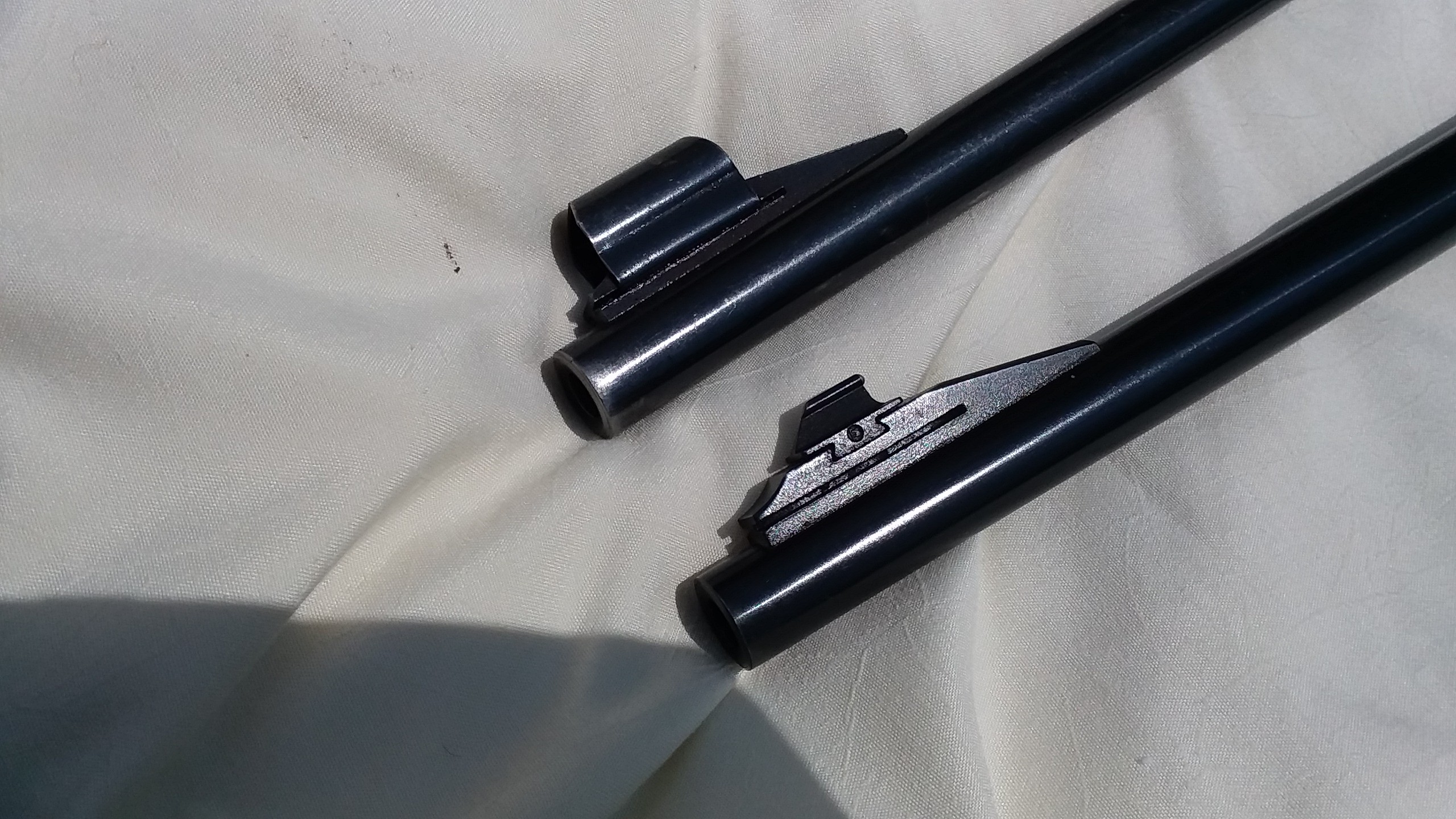

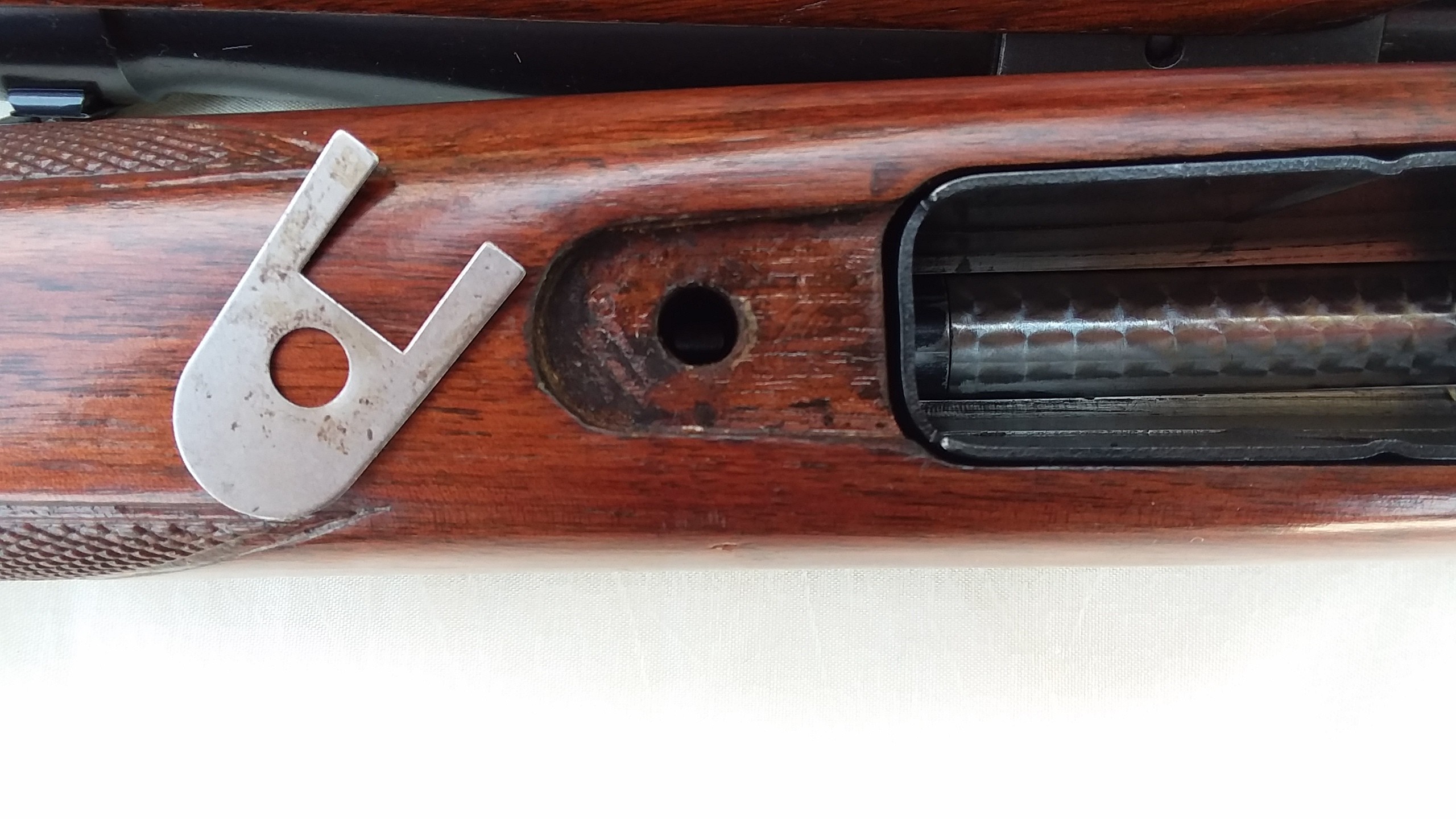

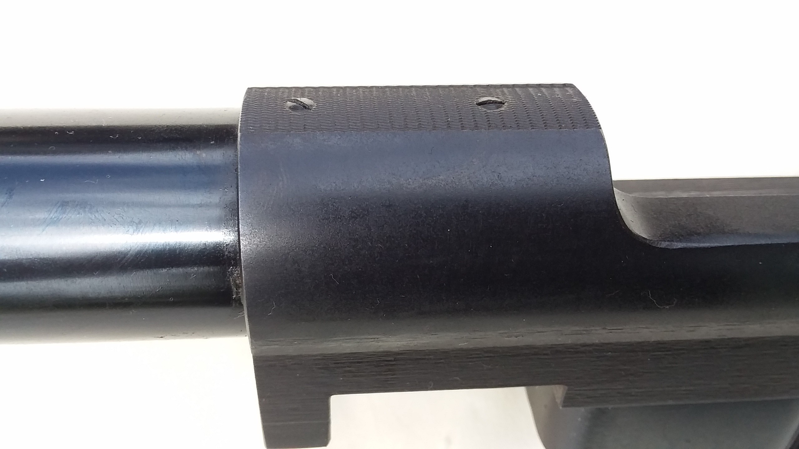

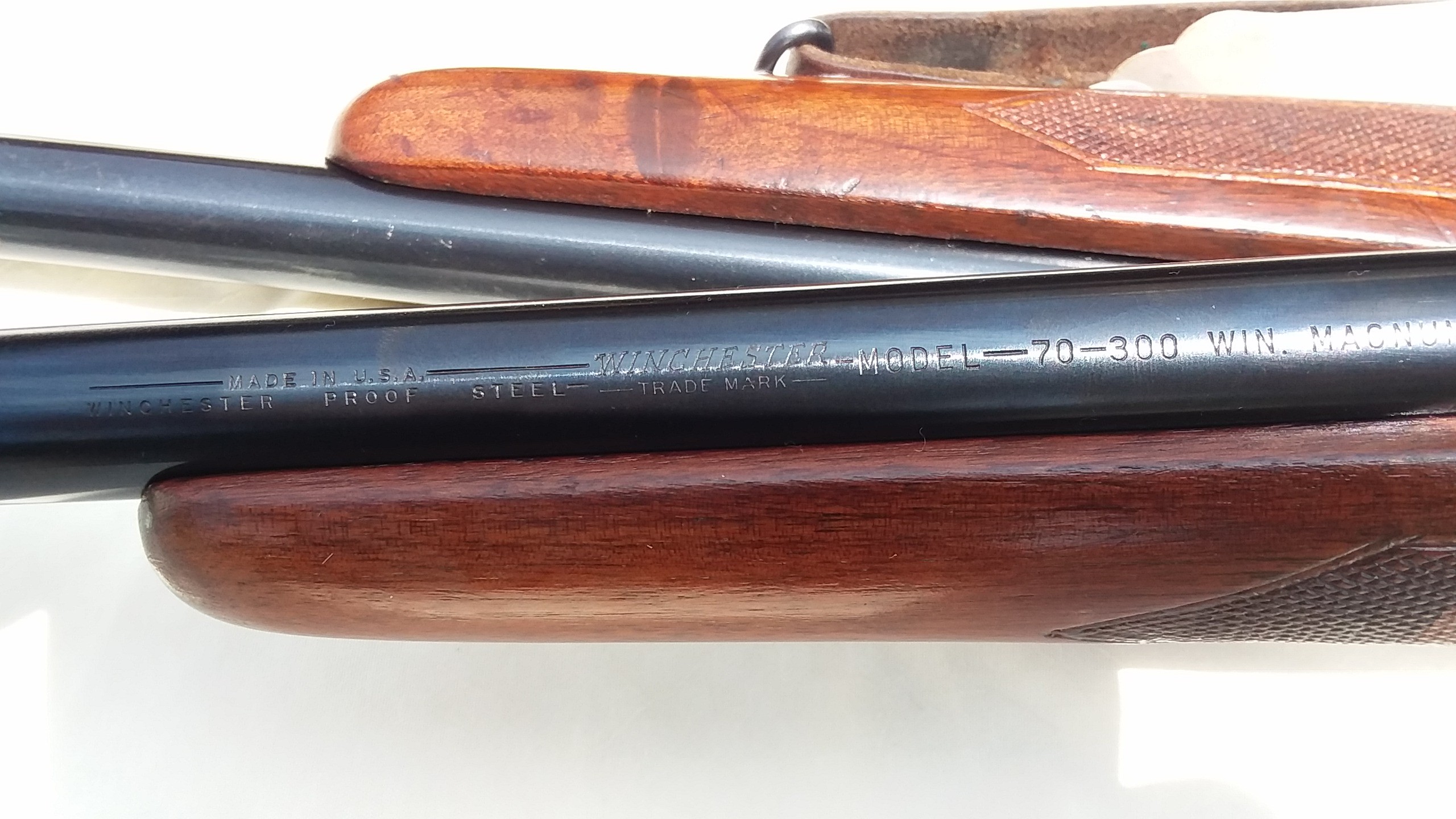

Some photos from Jerry for comment…
300-Win-mag-.458-marking-@-JR.jpg300-Win-Mag-no-proof-mark-@JR.jpg300-Win-Mag-no-proof-marks-@JR.jpg300-Win-Mag-bolt.jpg
Any help appreciated!!!Laugh
May 28, 2019 - 11:34 pm
Why would “.458” be stamped unless it was originally chambered for that cartridge?  Plenty of reasons why someone later decided he didn’t need an elephant rifle, & had it rebarreled into what it now is.
Forum Posts: 2837
May 29, 2019 - 12:06 am

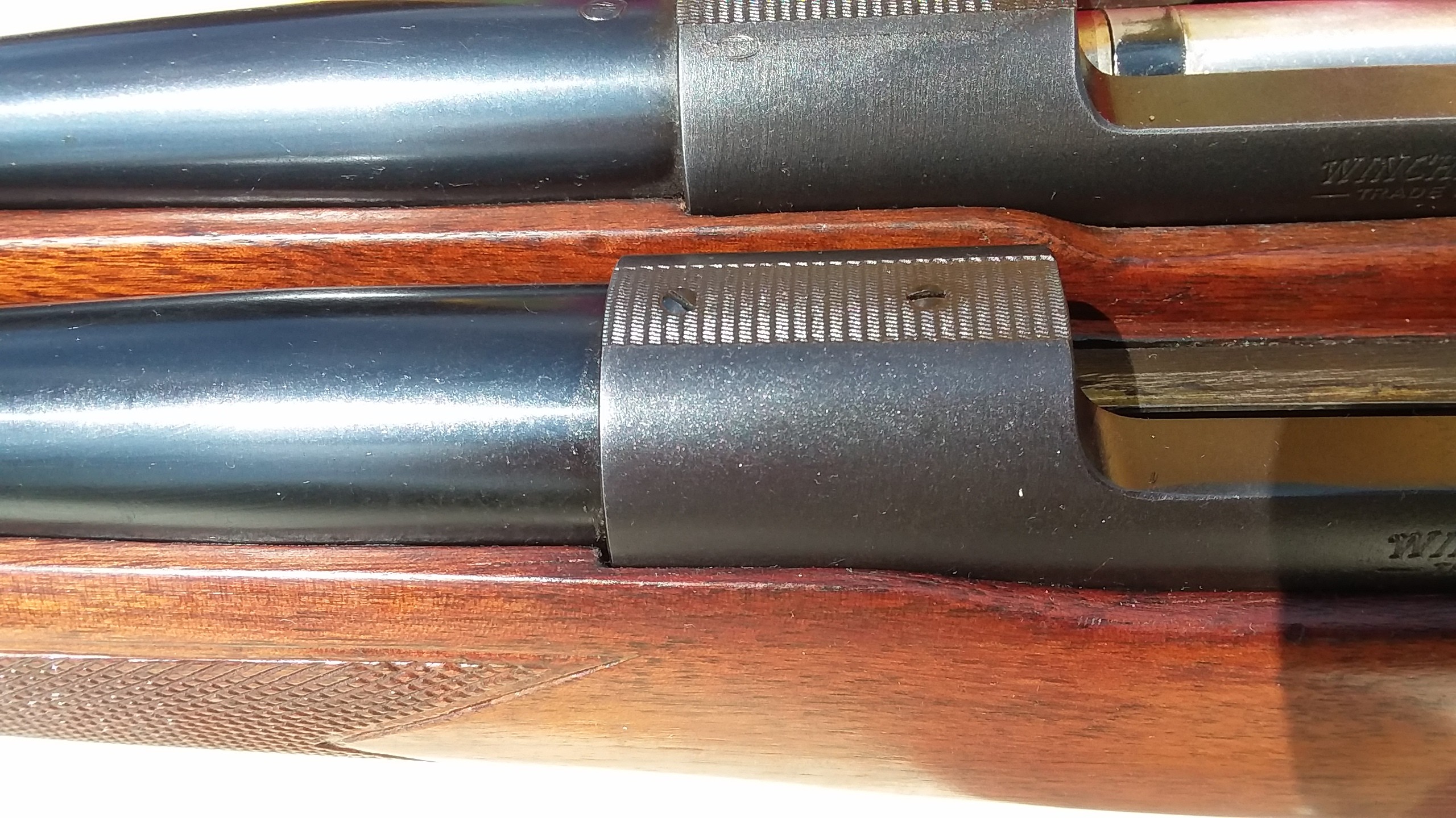

Judging from the photos the receiver does not look refinished to me.  Regardless if the barrel was changed the receiver should still have a proof mark.

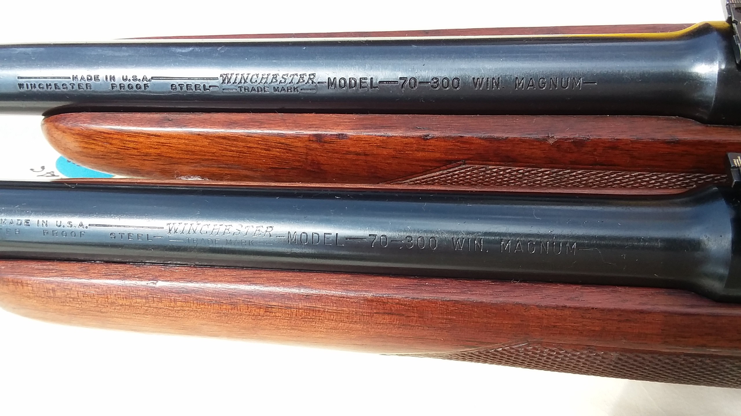

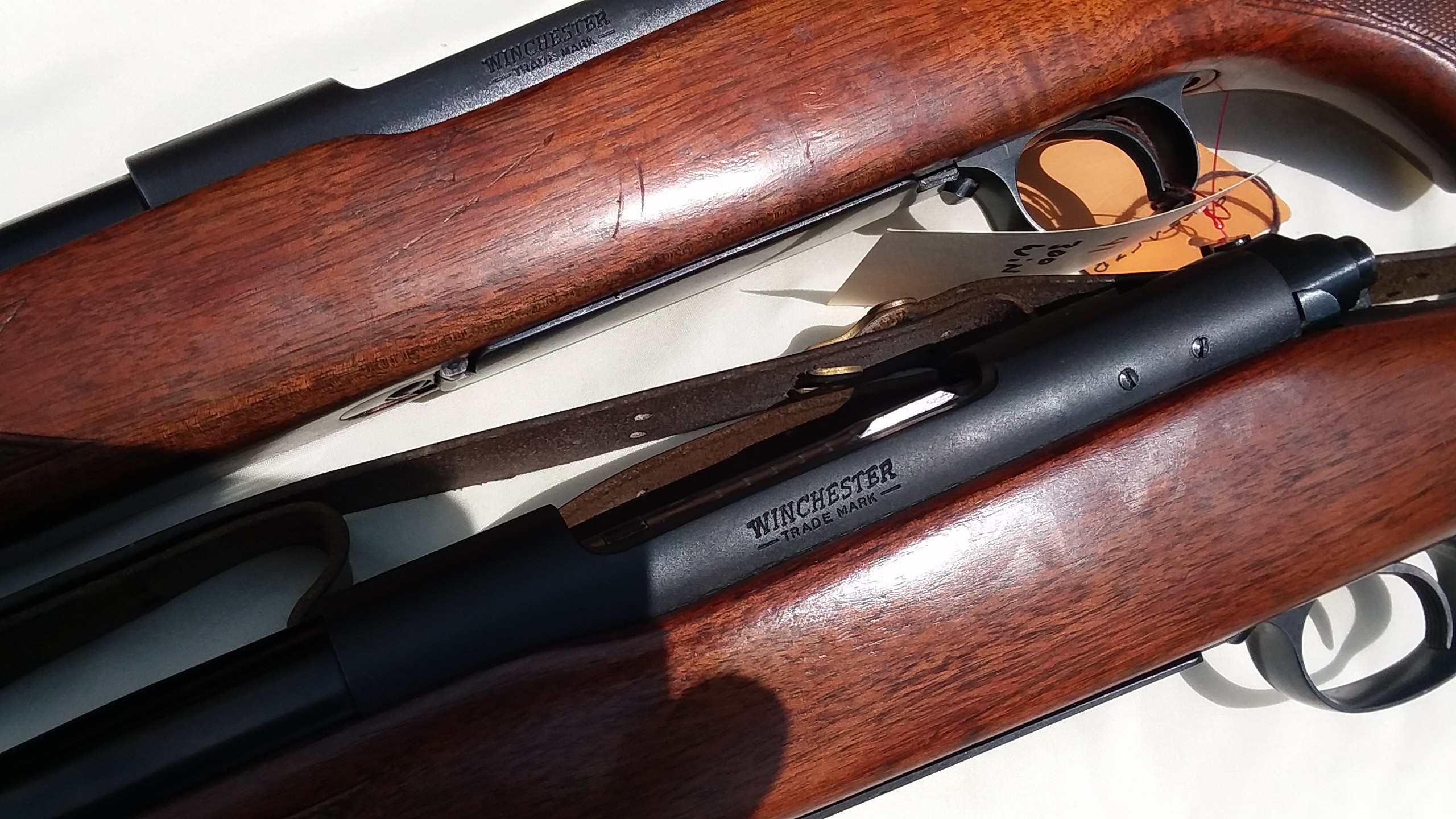

A few more photos from Jerry.  The second of his Westerner-Alaskans in the pics has correct for period proofs:
300-Win-Mag-proof-marks-3-@JR.jpg300-win-Mag-no-proof-marks-6-@-JR.jpg300-Win-Mag-no-proof-marks-5-@-JR.jpg300-Win-Mag-Proof-Marks-2-@jJR.jpg
Hi Clarence-
My understanding is that “458” was stamped on the recoil lug of ALL M70 short magnum receivers regardless of the barrel that was ultimately installed.  It just indicated a short magnum receiver.  So in-and-of-itself that stamp only indicates that the receiver is correct for a(ny) short magnum, so is not likely to have be a modified standard receiver.
All the pre 64 short magnum rifles including the 264 Win Mag, 300 Win Mag, and 338 Win Mag, and 458 Win Mag had the “458” stamped on bottom of recoil lug. I would assume it was a carry over since the 458 was the 1st short magnum cartridge that went into production, and they all used the same basic receiver.

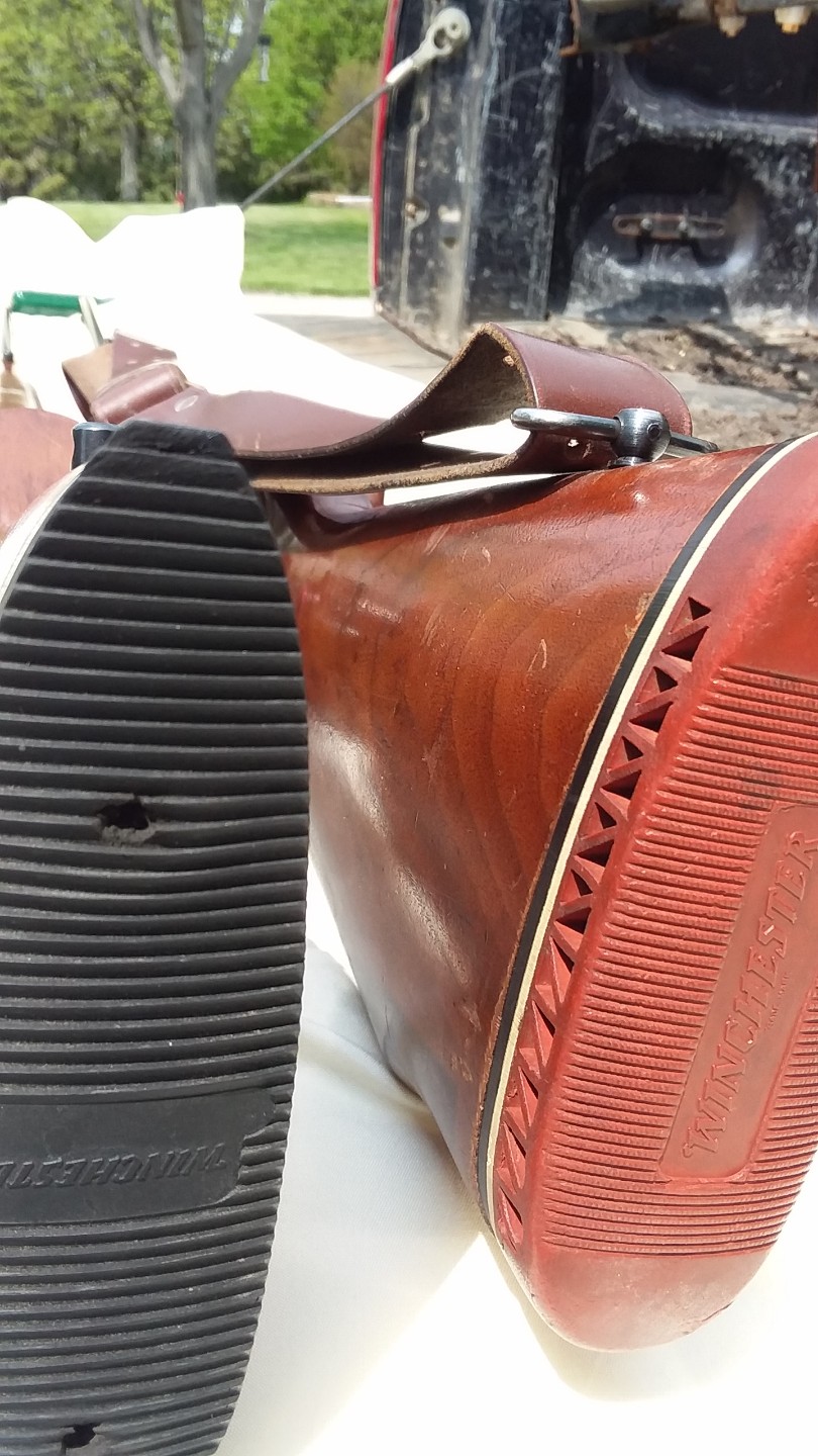

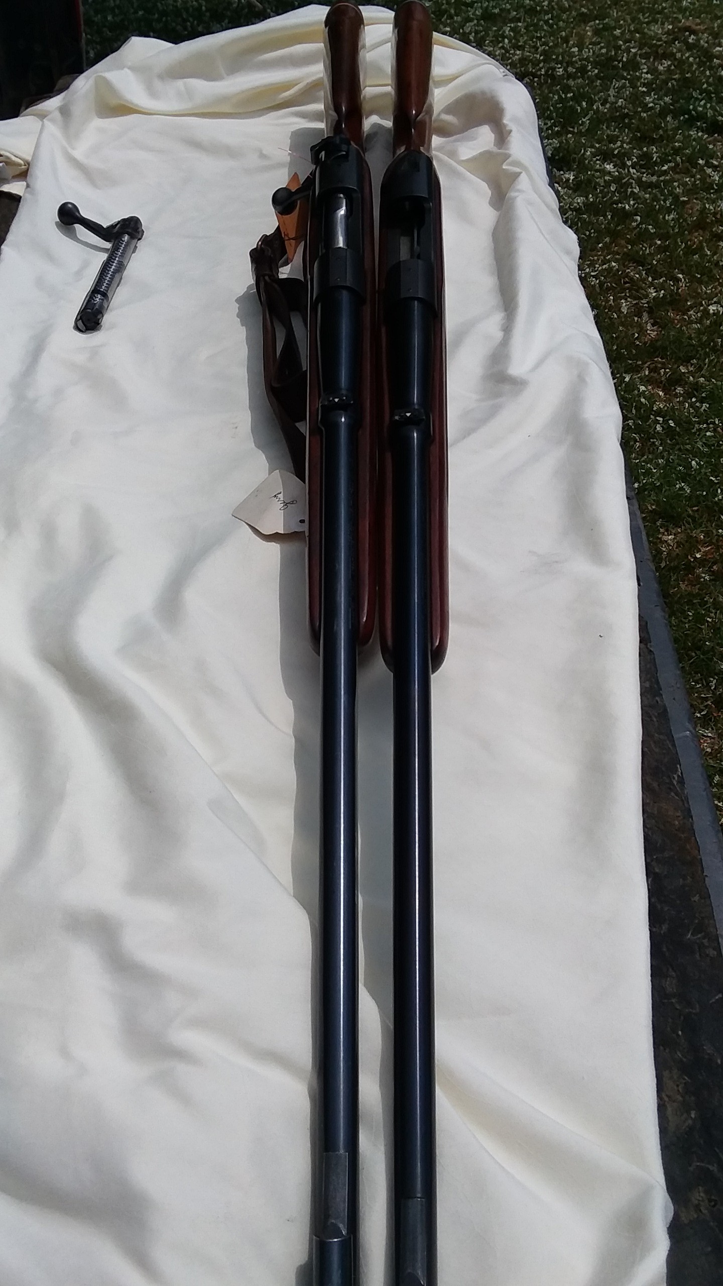

Last set of photos from Jerry with the unproofed gun next to another of his Westerner-Alaskans…
Bottom-one-no-proof-marks-@-JR.jpgBottom-one-is-not-proof-marked-@-JR.jpg20190529_121337_001.jpgleft-one-is-with-out-proof-marks-@-JR.jpgright-one-is-not-proof-marked-@-JR.jpgbottom-is-floor-plate-with-shim-@-JR.jpgfloor-plate-shim-9870-@-JR.jpg20190529_121511_001.jpgfloor-plate-shim-9870-@-JR-1.jpg
For those of you “sleuths” who want to weigh in, Jerry told me got this rifle off Amoskeag auction a while ago.  The link is:
https://www.proxibid.com/asp/LotDetail.asp?ahid=9943&aid=92960&lid=23899005#topleft
I’ve got my own theories, but I’d also like to know what all ya’ll think…  Apart from encouraging Jerry to pony up the modest fee to join WACA so he can continue to contribute our fun/research!!!

Thanks Jerry and Louis for accommodating the pix and the interesting Thread! And now perhaps my Jerry Lewis quality take! 🙂
Pix, most appearing of regularity, adding more and more to the conundrum. Only an apparent difference in barrel length between specimens? Is that correct?
My ‘take’, falling back on Occam’s Razor. More likely than not…
1. Rifle proofed or not. Less likely physical act of “proofing” and subsequent omission of relevant markings. Most likely never proofed.
2. Fact of rifle leaving factory with barrel & receiver as now viewed and unmarked, greater than marked and later altered to remove. Finish appears factory. (Such to me, perhaps experts to disagree) and considerably difficult to duplicate after marking removal. Further question of such alteration arising… Why? Believe most probable, departed factory unmarked.
3. Assuming the above propositions true, probability assumptions. That it left as barrel and receiver joined or alternatively, separated. (Duh… but relevant to ponder.)
4. If the components left factory unjoined, perhaps greatest likelihood, “lunchbox” rifle, before or after production ceased and quite possibly considerably after when production line no longer mobile. Removed as separate components – unauthorized. Later joined in buildout. Or…
5. Perhaps officially sanctioned factory departure for destination and or circumstance where complete rifle would not as such be lawful or importable. (Eg. “Firearm classification or parts classification.)
6. Perhaps informal ‘gift’ to factory official/other insider. Perhaps more than one extant.
An important point, that any likely ‘extra-procedural’ factory departure, well before GCA ’68 and presumably simply internal matter rather than any violation of US laws other than perhaps lunchbox context theft.
I believe this rifle, a unique specimen. One not probable of intent to create collector deceit. Residual questions of headspace/other hazards indicative of extra-factory assembly, particularly mismatch such as receiver rails incorrect for 300 Win Mag round = feeding problems.
If all ‘good to go’, it seems to me a $1600 bargain value.
Just my wordy, sleuthy take. 🙂 🙂 🙂

May 30, 2019 - 10:13 pm
Hi John and Jerry-
I think you’re on the right track…  Here’s my take:
1.  ‘458’ marked receiver is a correct short magnum action.  ‘458’ was the stamp applied to all short magnum receivers and is not related to which short magnum barrel was ultimately installed.  Barrel is stated in Amoskeag catalog as 24″ and the roll markings look correct to me, so I think it’s a legit .300 WIN MAGNUM barrel installed on a legit short magnum receiver.  The absence of a barrel date or caliber designation under the barrel is correct for a late manufacture (post-55) barrel.
2. Metal finishes look correct to me, as best one can tell from the photos.  Especially on the photo of the recoil lug, what one can see of the barrel polish looks OK.  So, my guess is original finish on original barrel and action.
3.  One KEY point that can’t be answered.  Proofs marks AND bolt serial number were applied at the same time (after test firing).  So…  If the barrel/receiver were not proof marked but the bolt had been correctly numbered to the gun, it would suggest a (rare) factory oversight.  In the case of the subject rifle, the bolt is described as not numbered.  This would indicate that the rifle never went through proof firing.  However, the jeweling presently on the bolt was not regular factory practice on Westerner-Alaskans and might have been done later, obscuring a serial number.  Late bolt serial numbers are often big, sloppy, shallow and misplaced, such that they could be obscured pretty easily.  So it would only help with the sleuthing if the bolt WAS visibly numbered.
4. The stock has nothing to do with a 1963 Westerner-Alaskan.  In Jerry’s comparison photos, one can tell that one of his 300 WIN MAGNUMs has the correct machine-cut, small panel, checkering that dominated after about ’60.  The subject rifle has late ’50’s hand cut checkering.  In ’63 there’s no way (IMHO) that hand checkered stock was installed on a production-line rifle.  Add to that, the recoil pad on the subject rifle (while marked ‘WINCHESTER’) is unlike what the factory was using on M70s with factory pads in 1963.
So… Putting this all together.  I agree…  The rifle (barreled action) is made up of original/original finish parts that most likely were never assembled into a complete gun and proofed.  Contemporary ‘lunchbox’ gun was my first guess, but later liberation of barrel and action (together or separately) is also a good explanation.  Either way, the barrel/action left the factory without being proofed and without a stock attached.  The jeweling seems to be 1/4″ diameter which is Winchester correct (I think) so could have been done before the parts wandered off or added later.
Given the high probability that the rifle was never proofed, I’ll repeat my suggestion that it be checked over before firing.
Just my take… (to borrow John’s phrase).  Divergent opinions VERY welcome (by me anyway)… LaughInteresting gun for sleuthing…
Best, Lou
