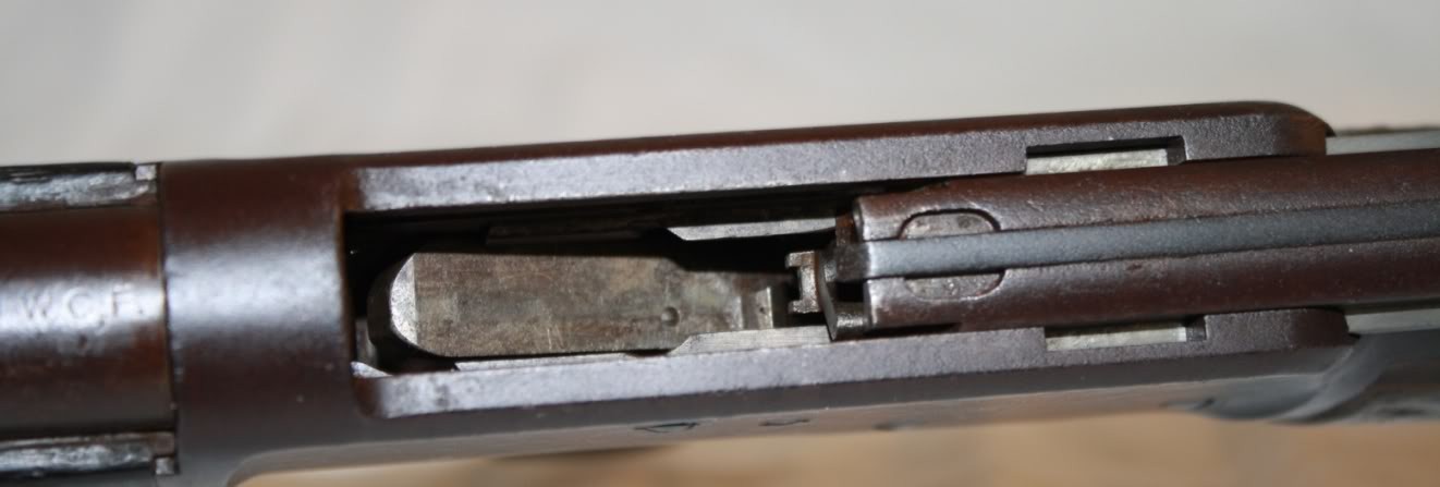

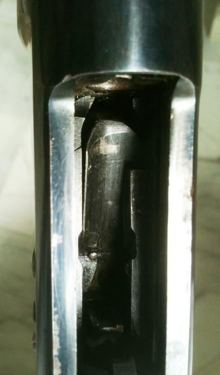

The lifter is different.  The 25-20 and 32 WCF lifter have a concave surface while the 38 and 44 WCF are flat surfaced.
