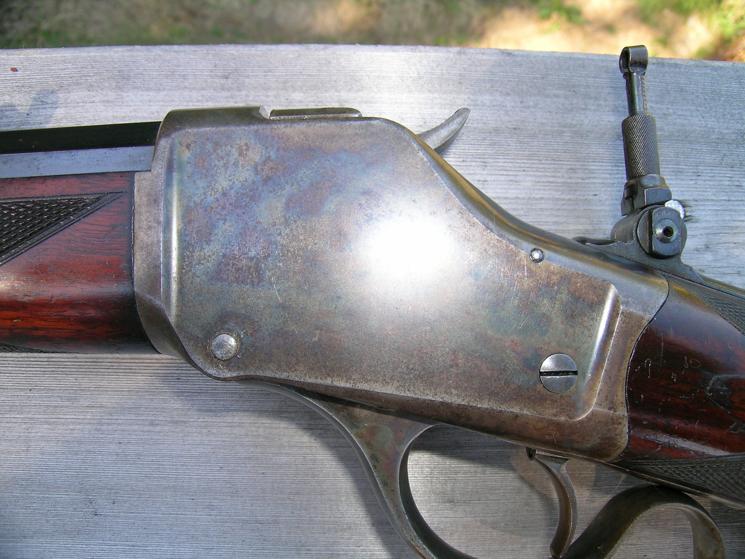

There is no “cut-off” date for the octagon top receiver frames.  They were manufactured (and used) for many years coincidently with the round frame ring receivers.  In fact, there were (4) unique types of high-wall receiver frames in use from day one of production;
1. Thick-side octagon top
2. Thick-side round top
3. Panel-side octagon top
4. Panel-side round top
Ultimately, the Panel-side round top receiver frame type was the most common type used for the Single Shot rifles.

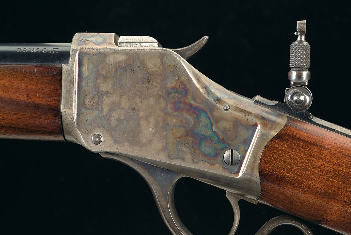

Thank you Bert.  the rifle I own has a round top panel side receiver.  I understand that this is the most common version of the 1885.  The condition of the case colors on my receiver is similar to the receiver in your third picture.  My 1885 also has a 30 in. #3 octagon barrel with all factory markings sharp.  The sights it came with appear the be a Lyman #5 front globe sight with ivory bead, and a semi-buckhorn rear sight.  The Lyman globe is in good condition, but the globe is out-of-round.

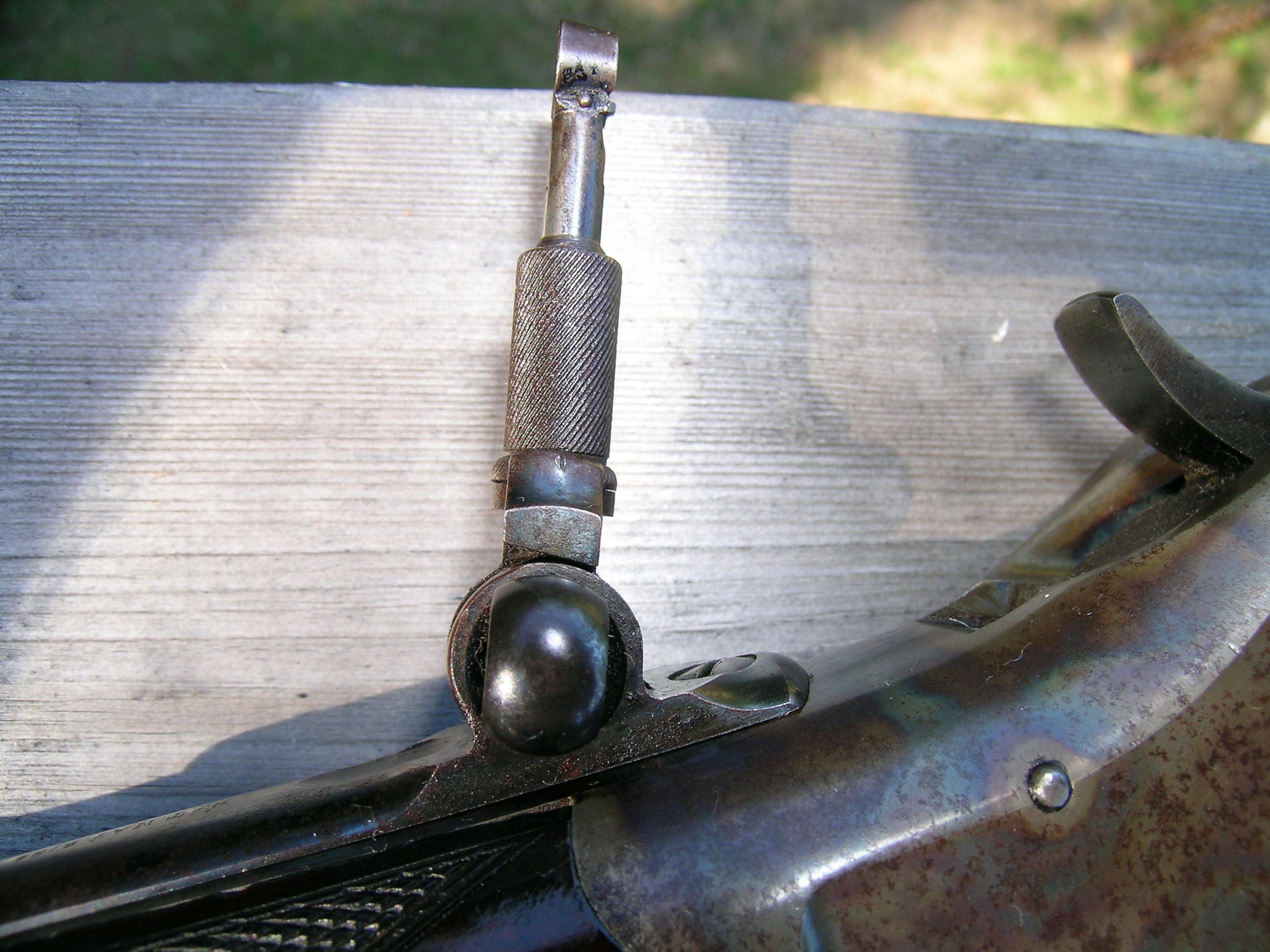

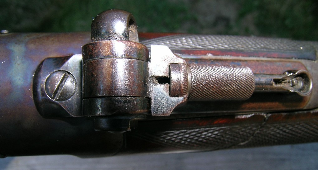

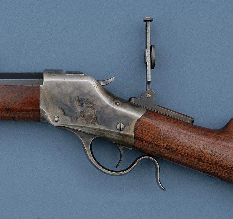

In addition, what is the make and model of the peep sight mounted on the rifle in the last picture in your thread above?
September 4, 2025 - 2:46 pm

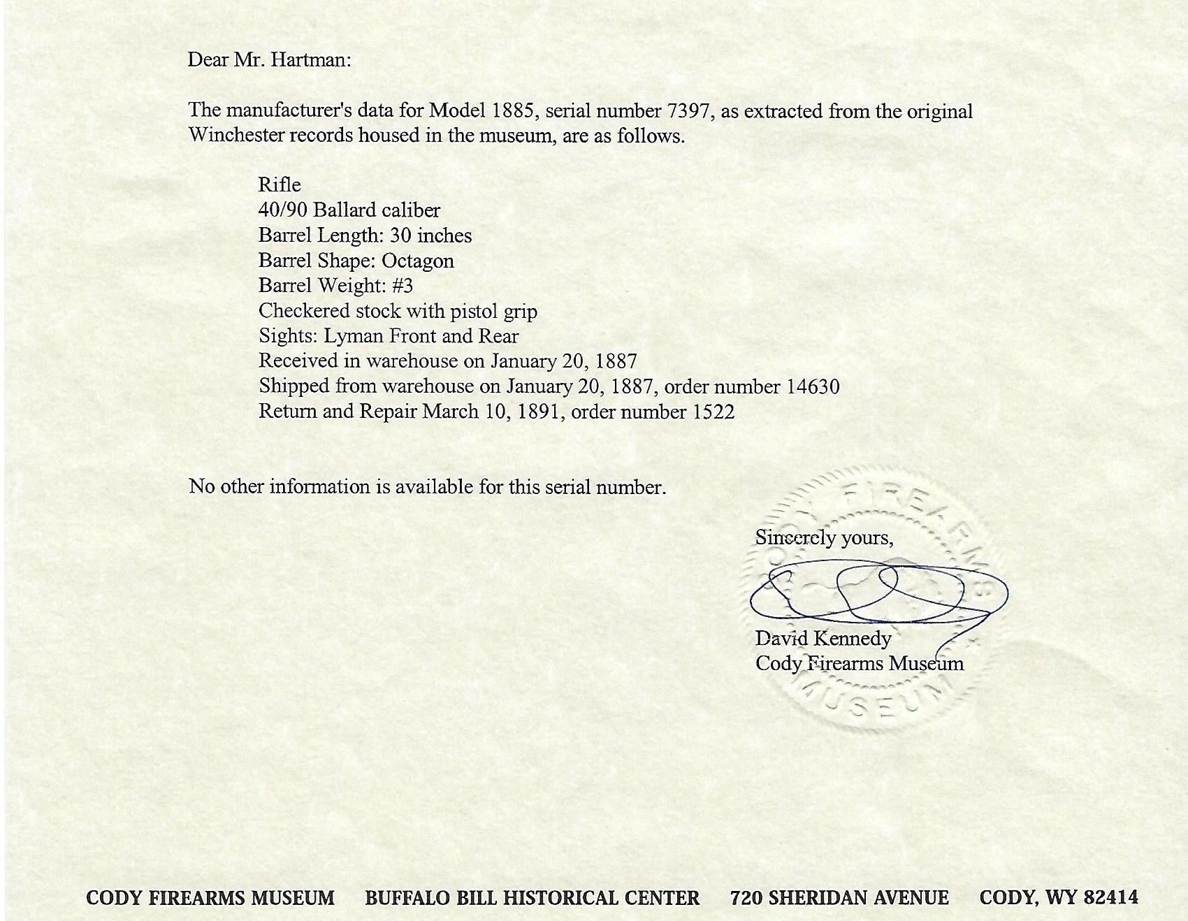

It is a very early 2nd variation Lyman No. 1.  The sight was factory installed on my January 1887 manufactured 40-90 Ballard Fancy Sporting Rifle.

I think for many of us collectors, when we see an early style tang sight, in many cases the fine knurling, on the adjustment thimble, is a very good indication, that it’s an early tang sight!
It’s a well known fact to most experienced collectors that the later style, particularly, “The Lyman Tang Sight”, has a courser style knurling, that was used on the adjustment thimble!
