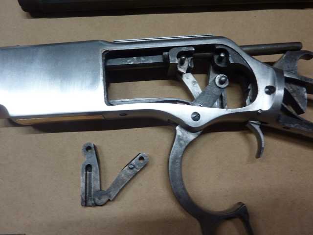

Kev18
Canada
Forum Posts: 83
April 7, 2020
April 17, 2020 - 8:41 pm
The inside is blued but there is nothing on the bottom tang.
https://i.imgur.com/wKA18WI.jpg
Forum Posts: 4990
April 17, 2020 - 10:29 pm
Winchester would sometime stamp a assemble number or other letters on the left side of the lower tang or if someone else did something to it they might mark the gun. Some gun shops also marked the gun out of view.
The only way they could of plated the outside of the gun with out touching the inside is with brush plating which on a large item would be very difficult to get it to look consistent. If it was brush plated, you would see nickel bleeding around the corners of the receiver into the inside. If you don’t see any of that, in other words there is nickel on one side and its not over the edge then I fall back on to my first reply that the gun is really not plated but polished to look like plating which I have seen done.
This is my opinion to what I see. If I had the gun in my hand it could change but I only have the pictures to go by.

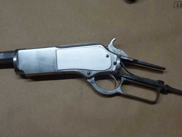

JustinG
Forum Posts: 62
March 30, 2020
April 17, 2020 - 11:08 pm
I tend to agree that it looks polished. Here is mine polished before CCH, while not as highly polished, they can be made to look like silver.
Plating is a process which could and would cover all parts exposed. So it’s unusual to have some the parts you show without plate.
