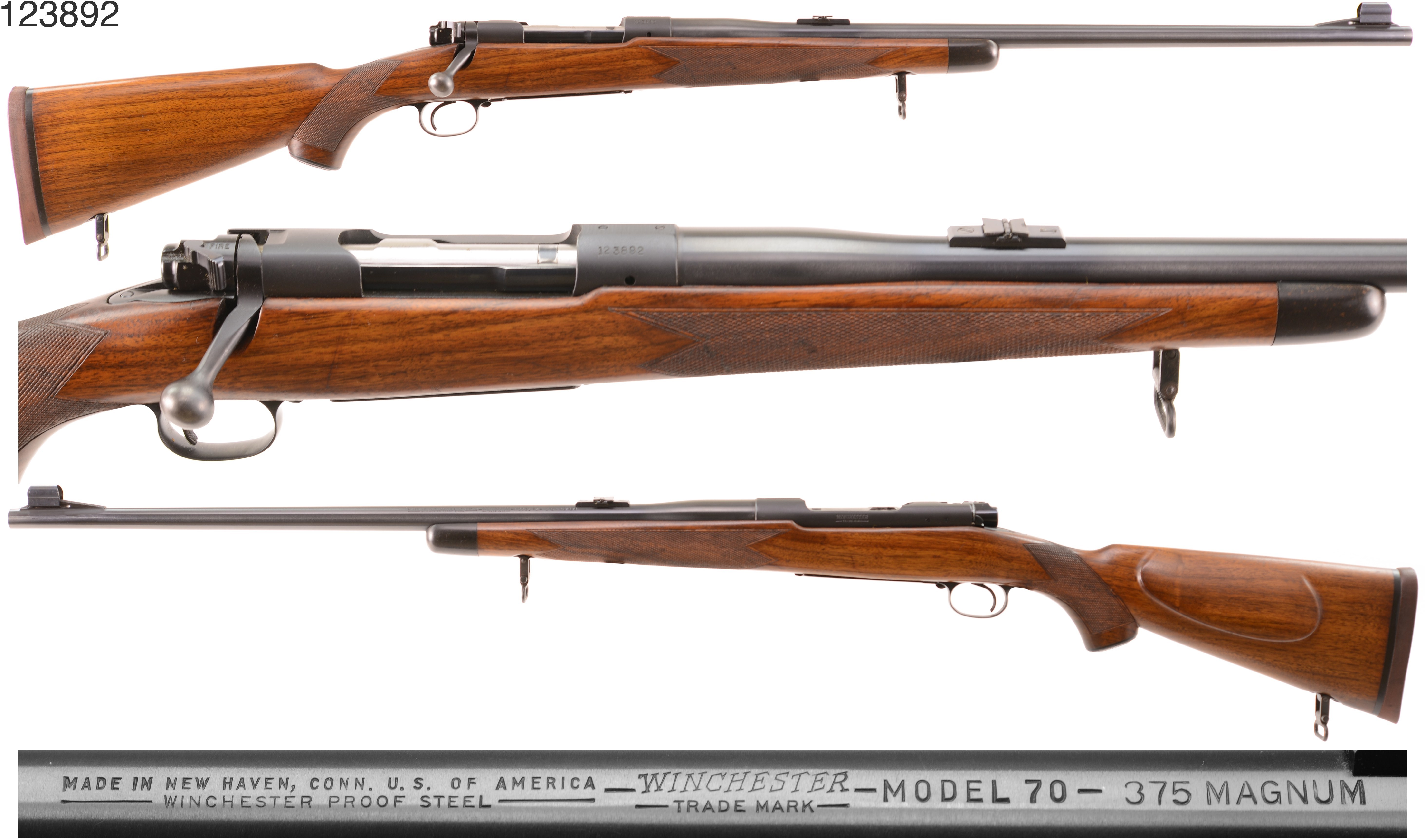

Next are pics of the closest to your rifle that I have handy…  This one, s/n 123892, is a little earlier (1949) and is a Super Grade.  So it still has the Type II-2 receiver (cloverleaf tang/late safety), and the caliber stamp is still “375 MAGNUM” in Style 3A.  But it does show the factory recoil pad, the undrilled bridge, C-1 contour barrel with forged integral front ramp, and Lyman 6W rear sight on dovetail base…
Hope this helps,
