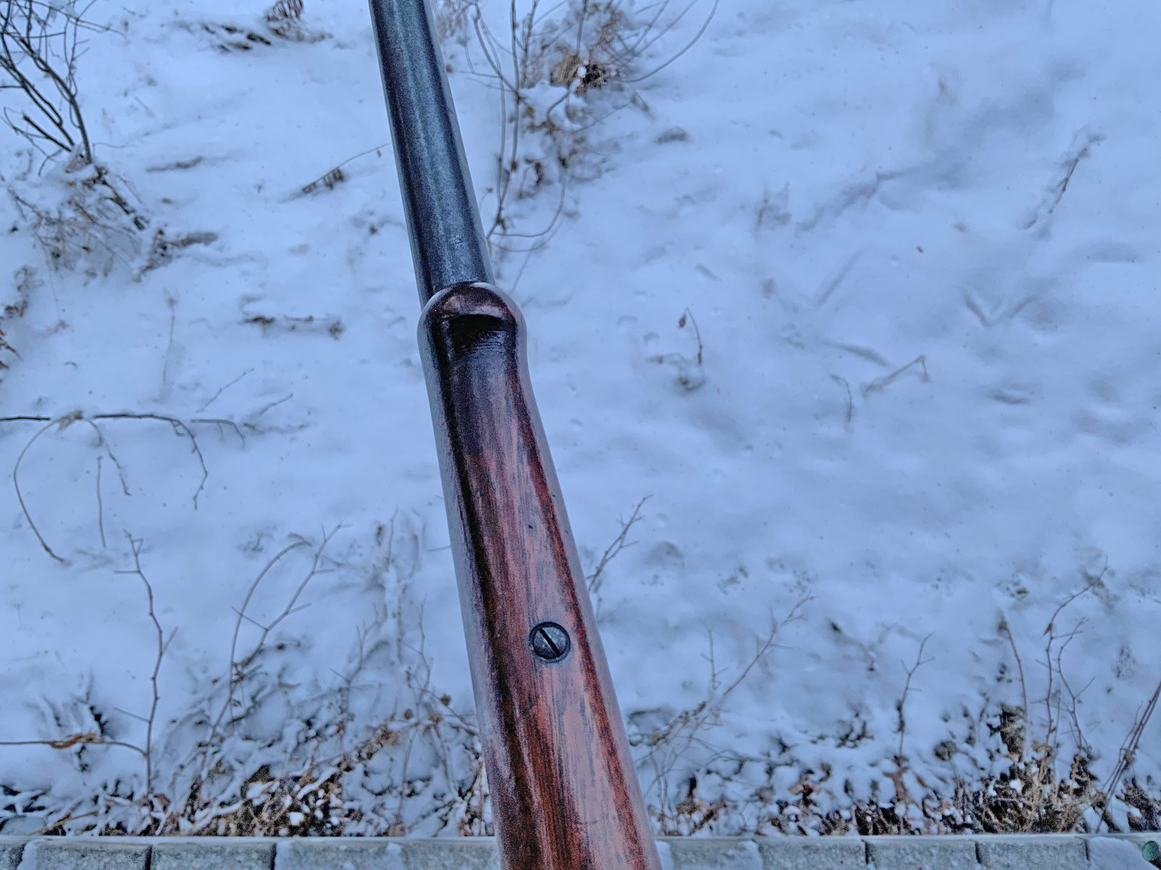

I have a late 1927 model 95 that has no ebony tip insert in the forend.  The forend sure seems original shaping internally and externally.  Were late model 95s made this way?

My gun, when it first arrived, I thought was for sure incorrect because of lacking the ebony tip. A knowledgeable collector friend thought different, so I started looking online for late guns and have so far seen these two.  By the way my forend and stock are not in great shape.  At some point they both received plastic and pearl inlays, plus a recoil pad! The metal is in 98 percent condition with a perfect mint bore though.  I plan to replace the butchered wood and have a nice set of stocks to fit from PGW which comes with the ebony tip.  There is a possibility of patching over the plastic inlay on the forend and it is nice otherwise.  I still wonder if no-ebony forends are legit for late guns or not.

It would be helpful to see pictures of your forend – particularly of the inletting.  The GunBroker rifle isn’t a particularly good example because, at least, the buttstock has been refinished so we can’t see if the finishes match between the forend and stock.  Additionally, the fit around the tangs looks suspect to me.  It may well be a replacement.  It’s very difficult to say with certainty without removing it.  Keep in mind, also, that your rifle was manufactured in 1924 and the GunBroker rifle in 1932.  Several thousand rifles were manufactured with ebony inserts between them in a span of eight years.
I’m not saying that no factory originals exist without ebony inserts, but it would help to be able to your question about yours and give an honest opinion without good quality close-ups.  Mark

I am having trouble loading pictures of my gun and forend, I’ll keep working on it.

Okay, I give up for now.  When I try to post a picture, I keep getting an error message, “file size too large”.
My gun I believe has original metal finishes.  It has 97 percent metal and a pristine bore.
The wood and inletting seem original to me.  I have taken apart and owned a few factory stocked guns and a couple custom stocked guns.  This forend strikes me as factory all the way regarding inletting.  Custom stocks are generally scrapped smooth and lack machining marks like my forend.
I intend to restock this gun and just want to be as accurate as possible, is why I was asking.

JC,  I don’t have a program in my computer to “play” with pictures so have to work with one as it is presented.  Being taken against the white of snow, your pictures are way too dark for me to see any details of the forearm.  Perhaps Mark can work with them to decide what they look like.  I am still interested where this all goes as I have looked at quite a few 1895’s in obtaining the modest number I have, and have yet to see a forearm that is factory for sure that does not have ebony inserts, but I also believe you are not the average joe in considering factory vs after market, etc.  Good luck with all this.  Tim

I reduced the size of the pictures so they would upload.  Evidently not enough to get them on the same page.  I also lightened them.
