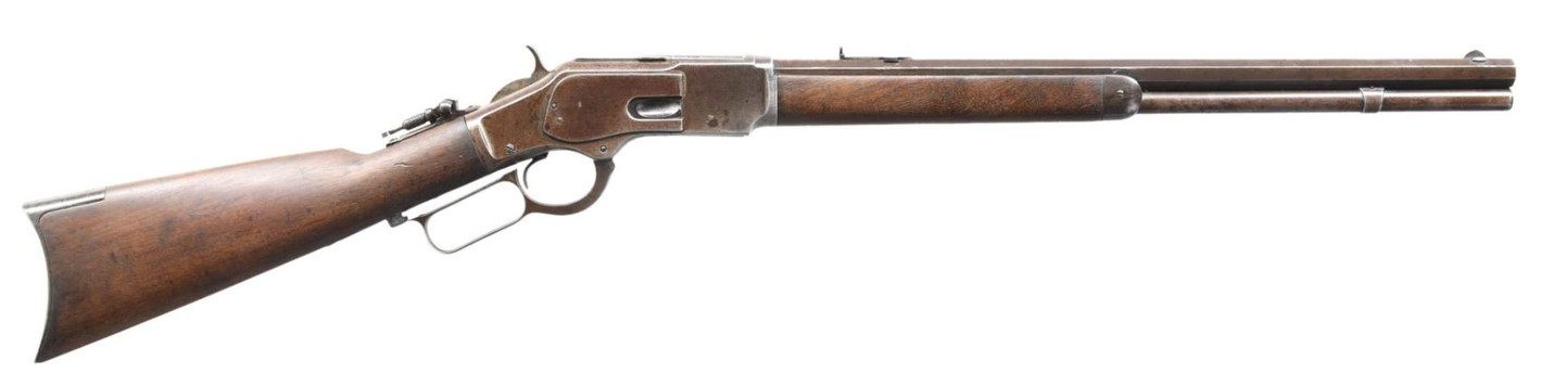

If you can’t post the pictures you can email them to me. Another thing you can check is measure the muzzle diameter with a dial calipers or a micrometer. Here is a picture of a 20″ short rifle.

The gun is a early 38 caliber rifle and when they first made them they came standard with a shotgun butt but some were ordered with rifle butt plates like yours. Later they switched the butt to a rifle butt like the rest of the rifles as standard. The gun has had the barrel cut short. The front sight is too close to the muzzle and there is no magazine band are the two items that gives it away and also the Cody letter tells us what the guns configuration was. The letter says its a rifle and does not say a barrel length so it is the standard length for a rifle which is 24″.  Here is your picture of the end of the barrel and I have posted another picture what it should look like.
The gun looks like nice honest gun except for the cut barrel. It is now a shooter grade gun.

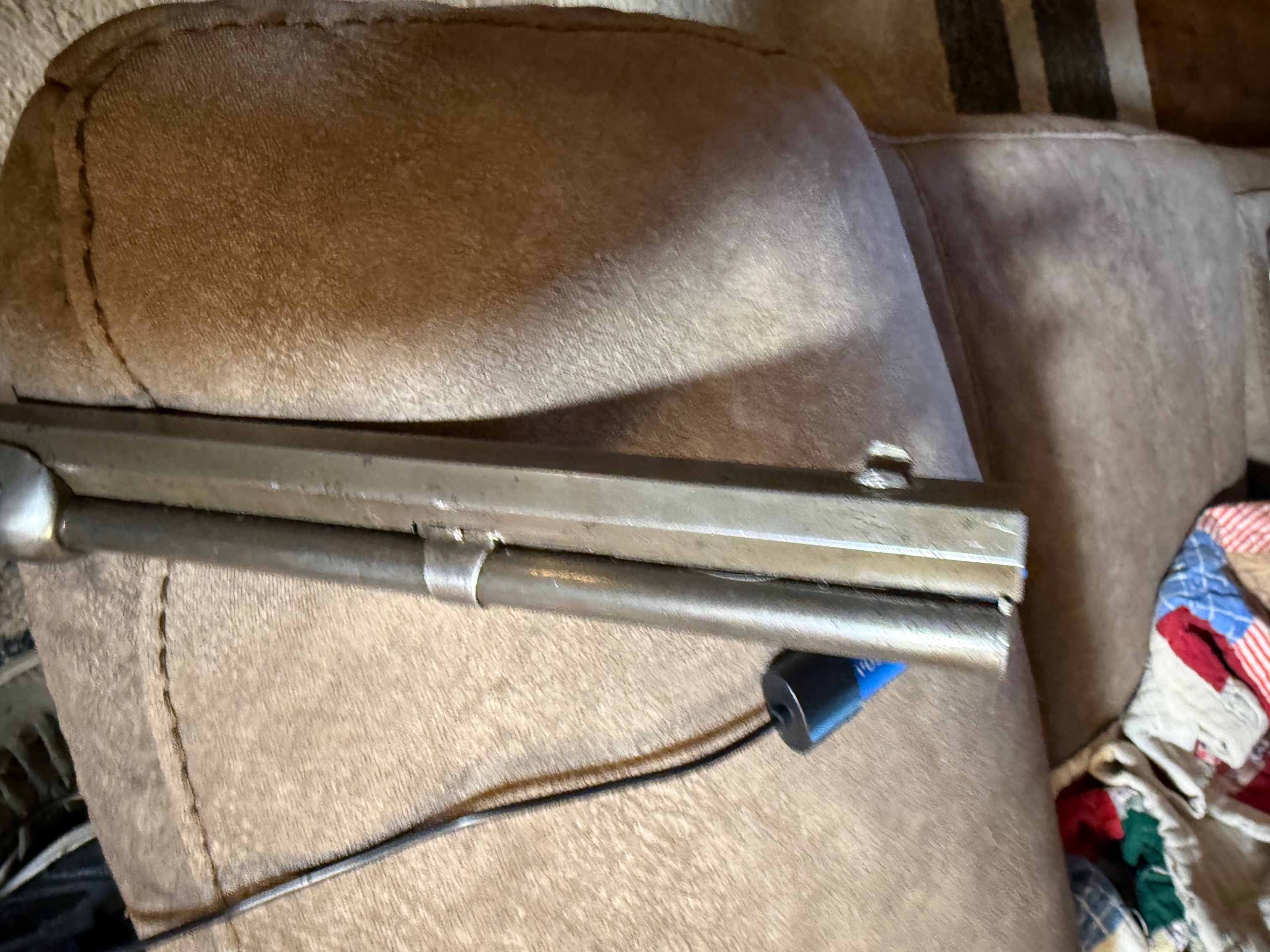

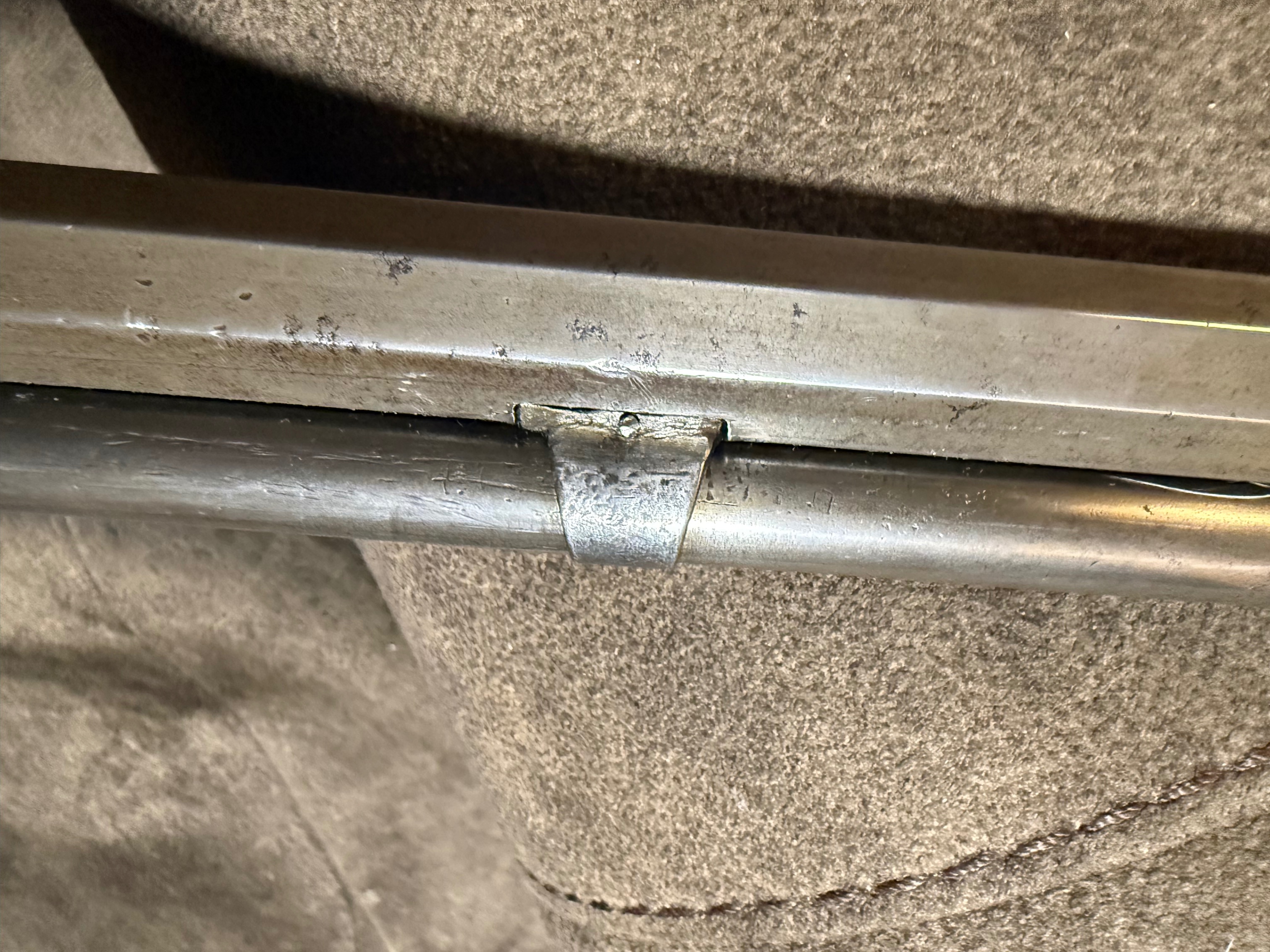

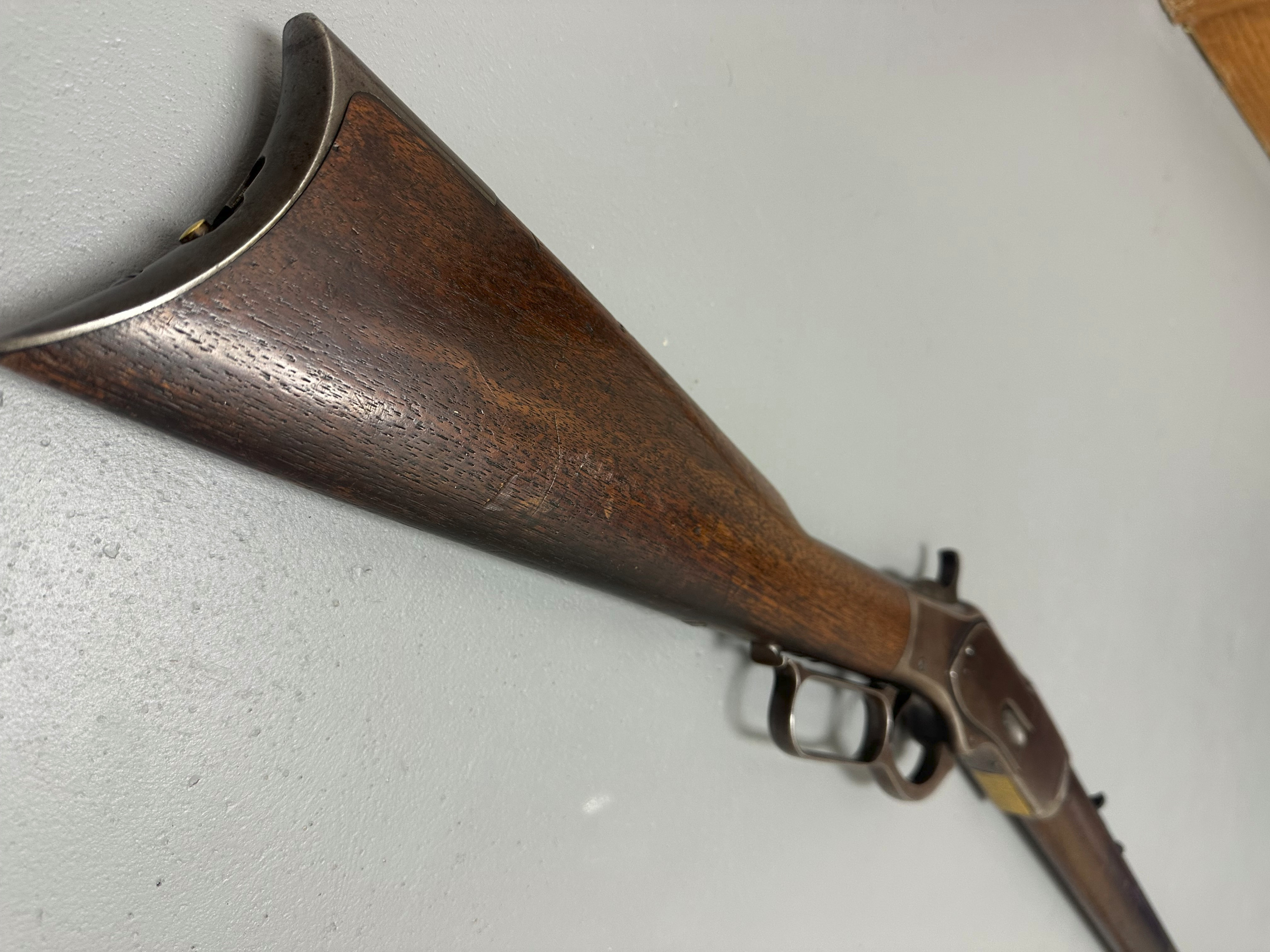

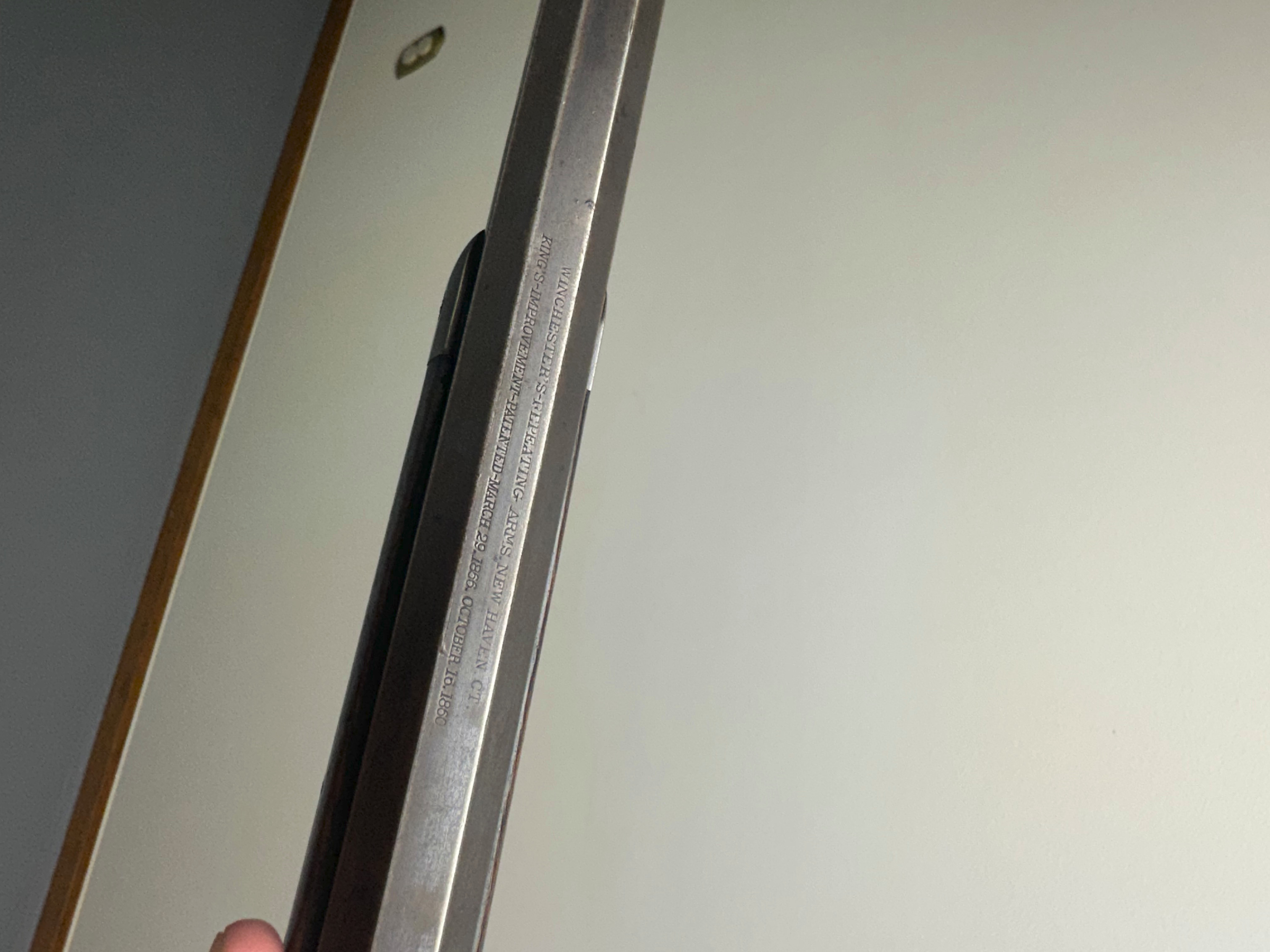

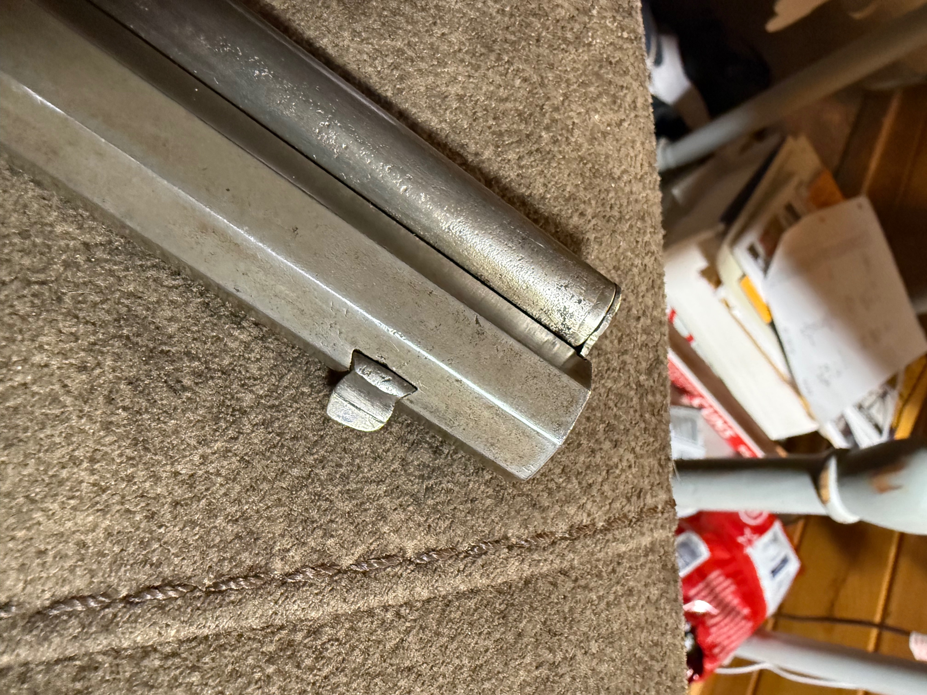

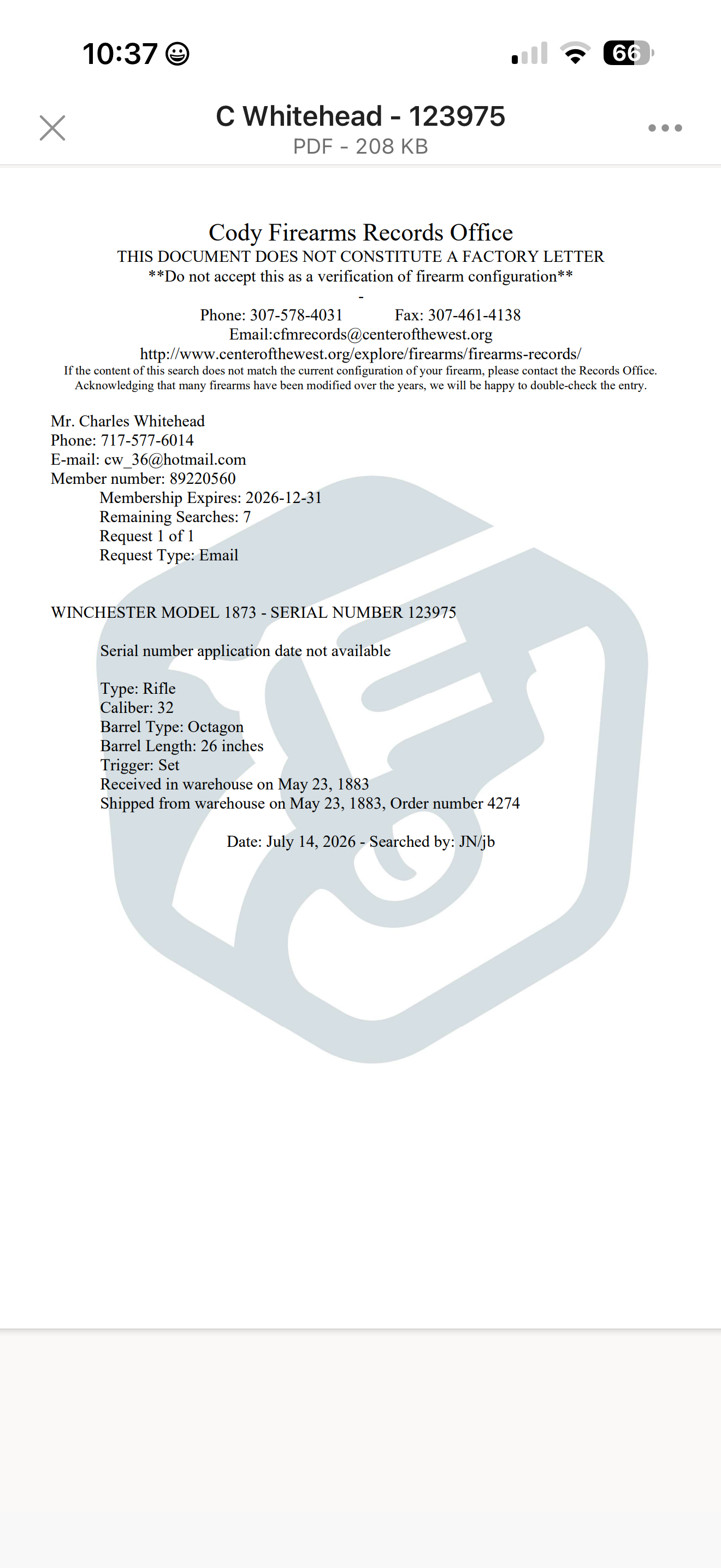

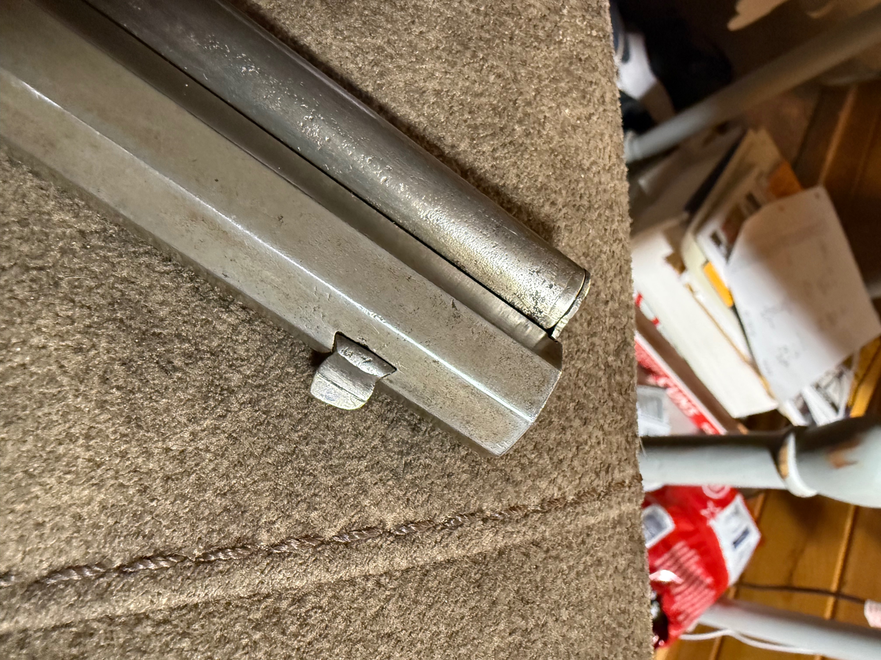

IMG_8381.jpegIMG_8380.jpegIMG_8380-1.jpegIMG_8381-1.jpeg1873man said
They do have a taper but the tolerances are fairly wide but its could be a outside chance it would show what happened. Just like the barrel diameter tolerance the front sight placement has a tolerance. I’ve been seeing .725″ to .790″ from the muzzle to the closest cut at the bottom of the dovetail for 2nd and 3rd models. I checked a few first models and a 66 and they are more, .8″ plus.  My email is below my picture.

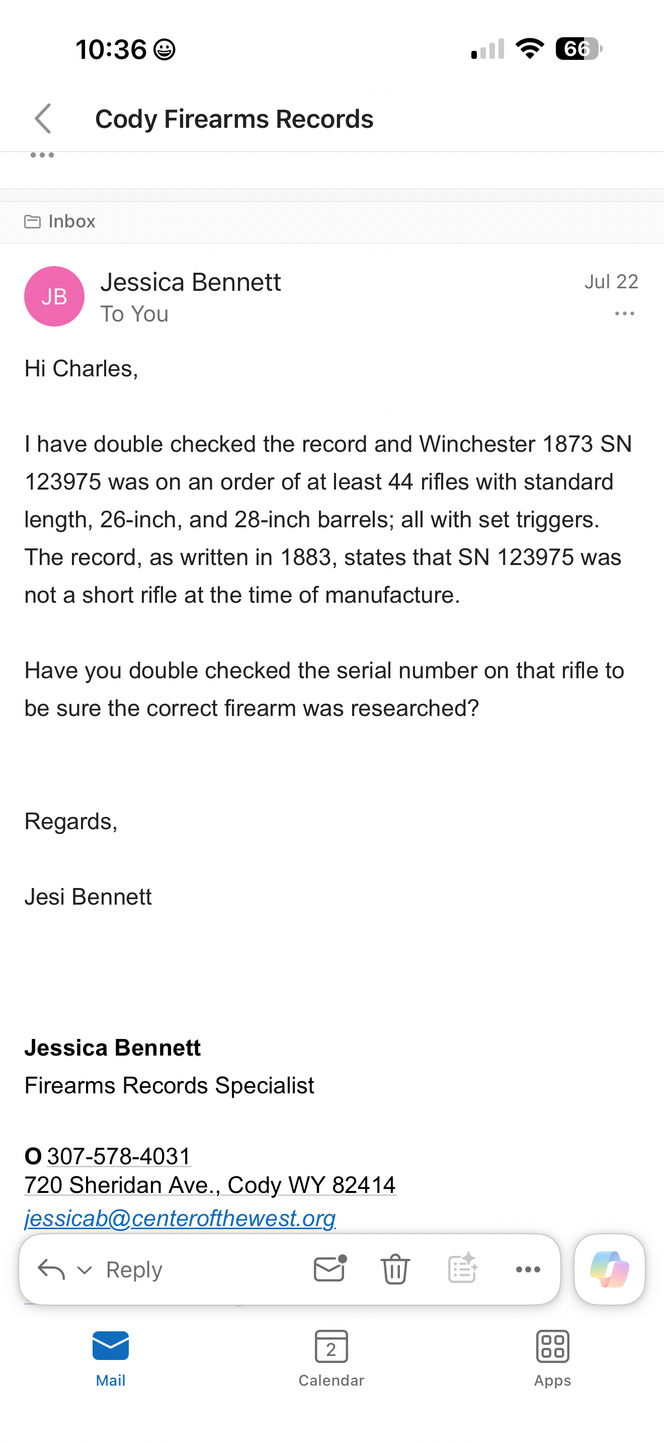

So I recieved the 1873 I had posted about before with the 18” barrel- Cody says it was shipped with 44 other rifles all having 26” barrels and set triggers – I posted pics in other post of trigger as it doesn’t look like set trigger to me – here’s measurements I have – length 18 1/8 – muzzle to sight – .76 – muzzle to magazine band 3.95- muzzle diameter octagon – .78- forearm 8 1/2” – second model rifle – could Cody be wrong ?

Post pictures of the complete barrel from all sides and what the letter says.

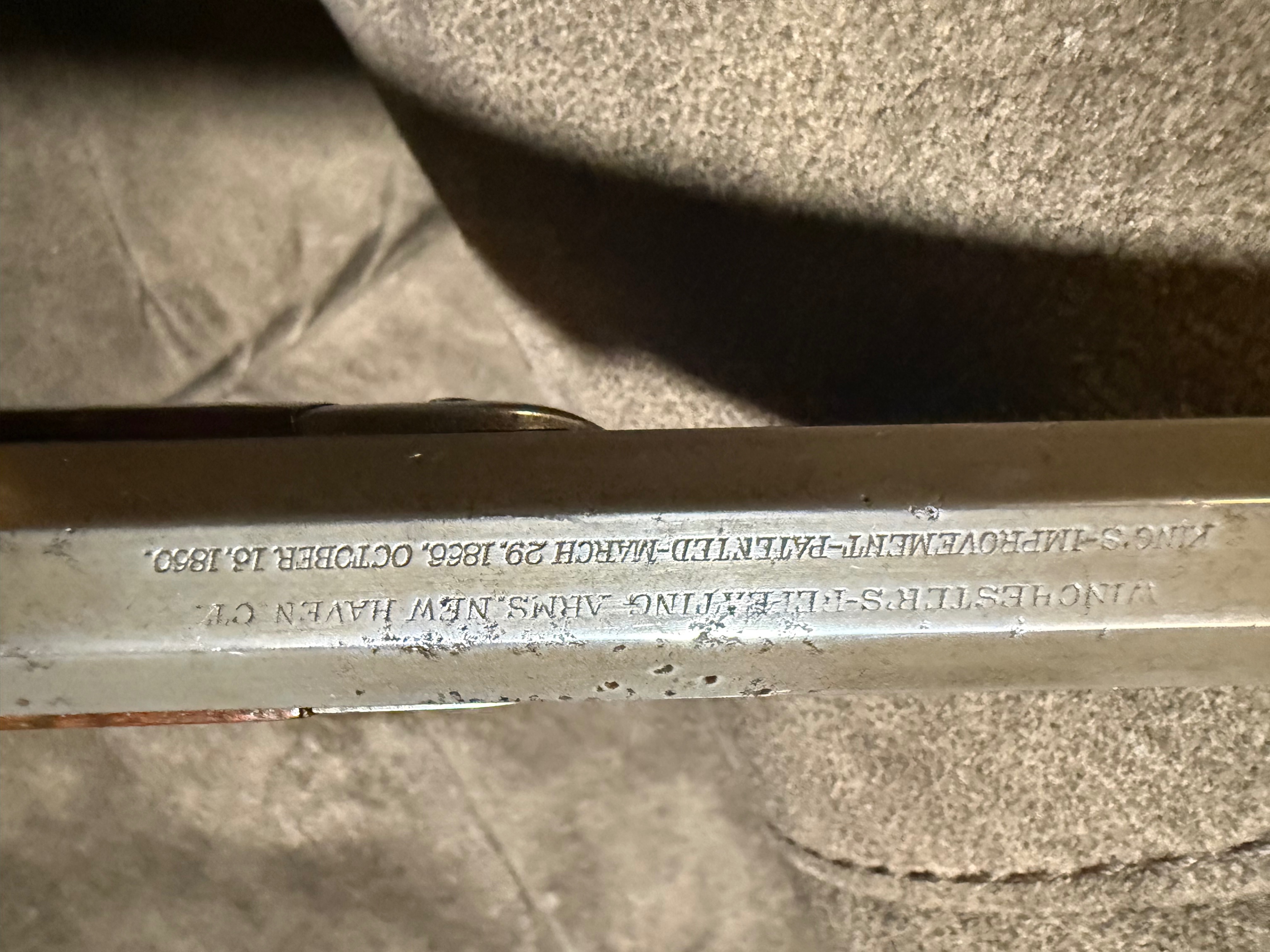

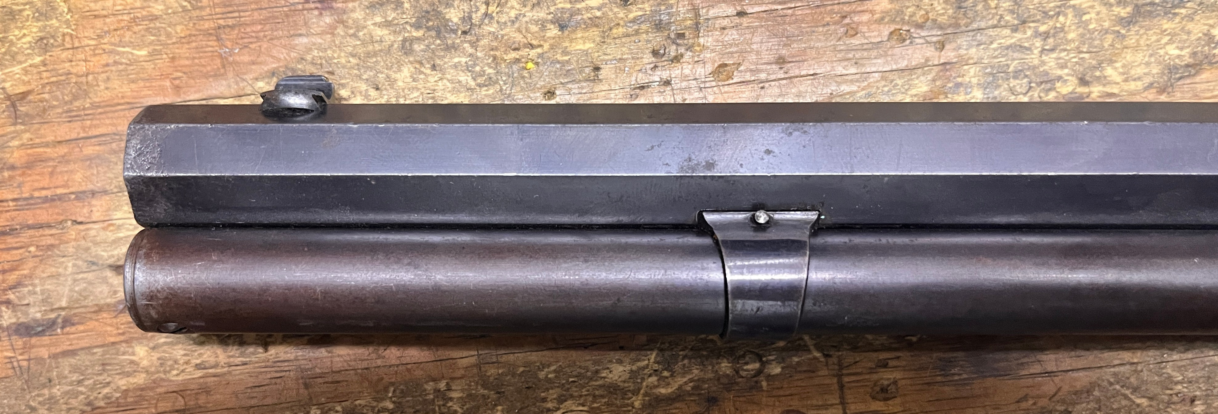

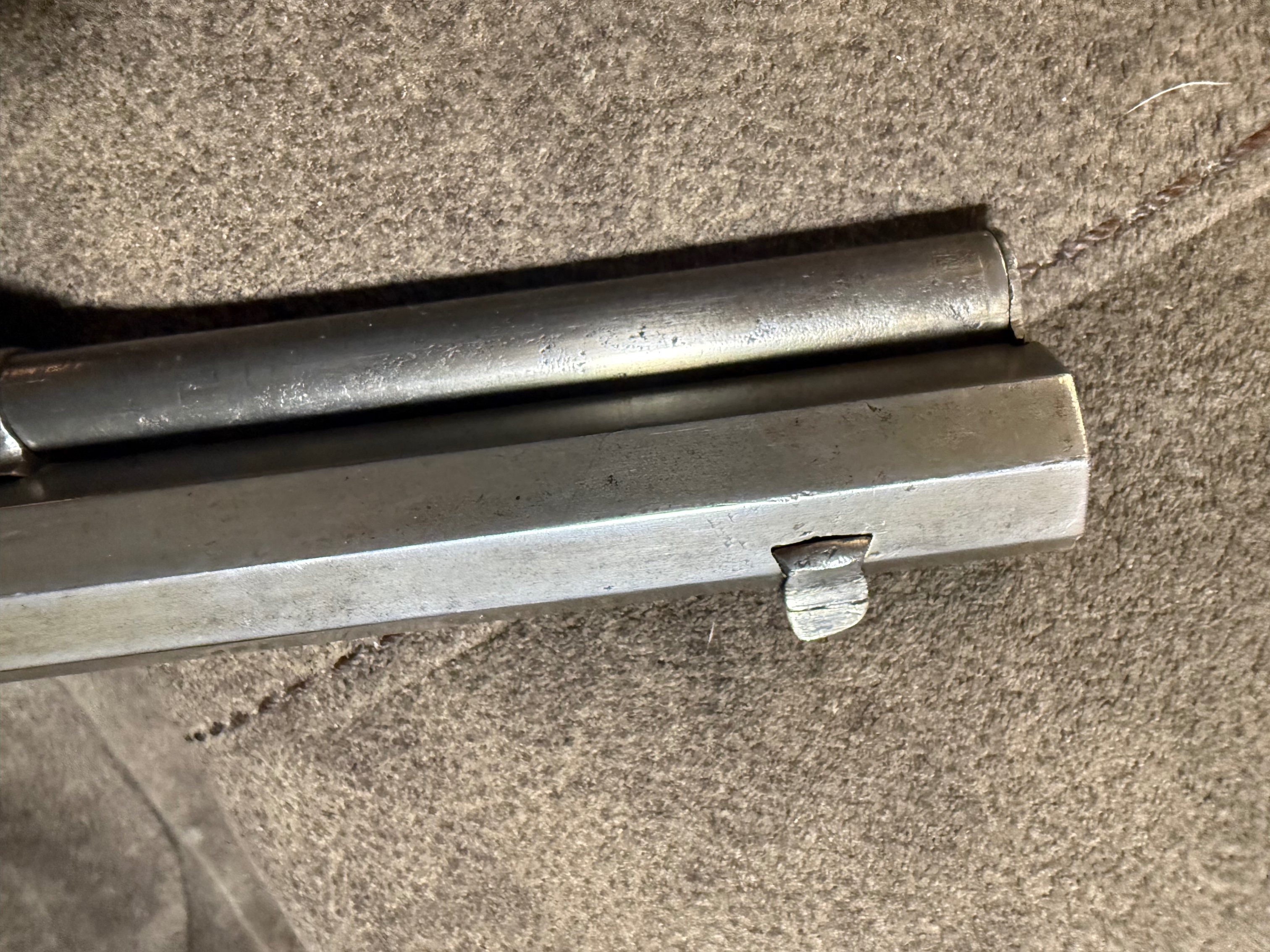

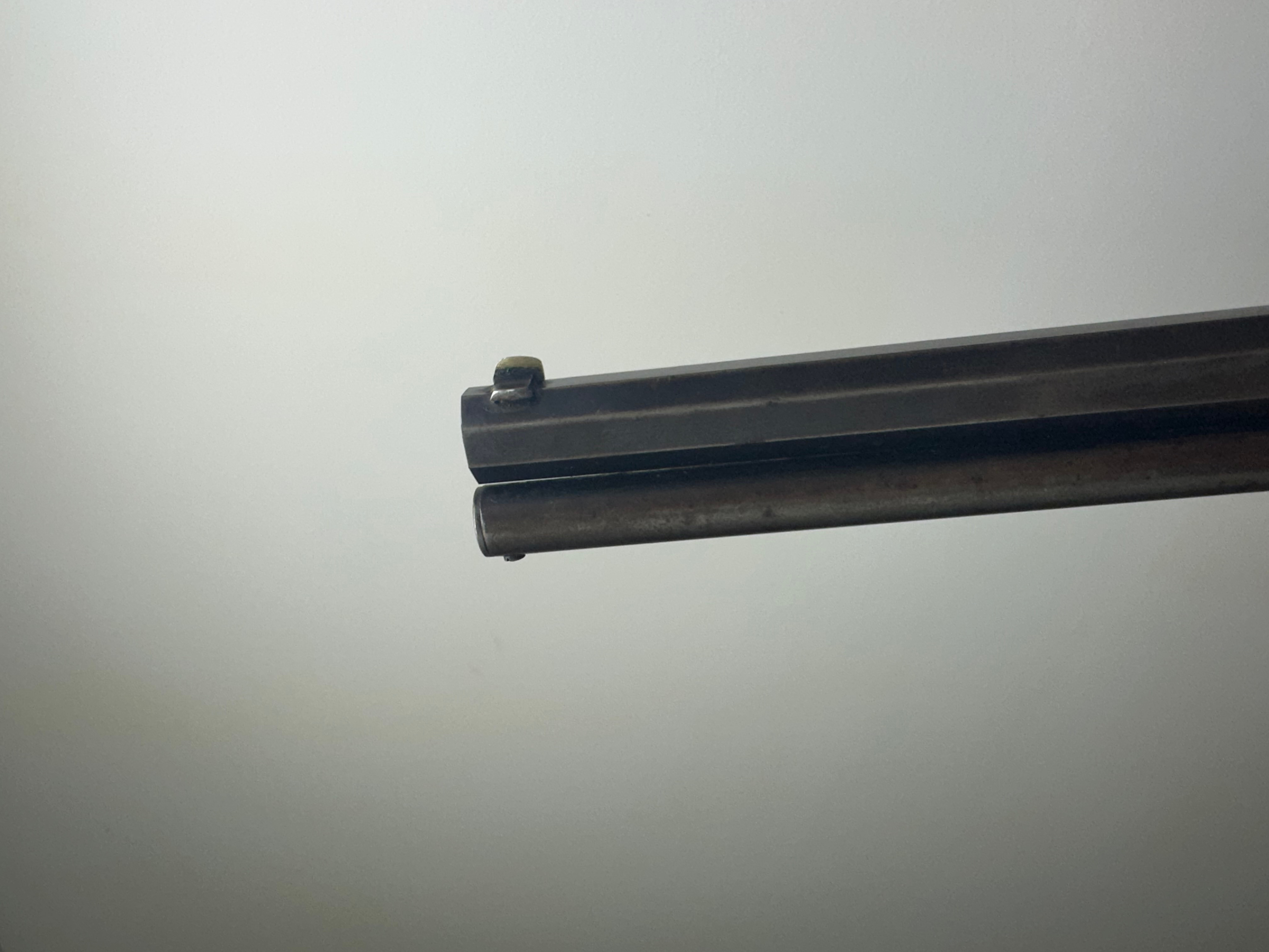

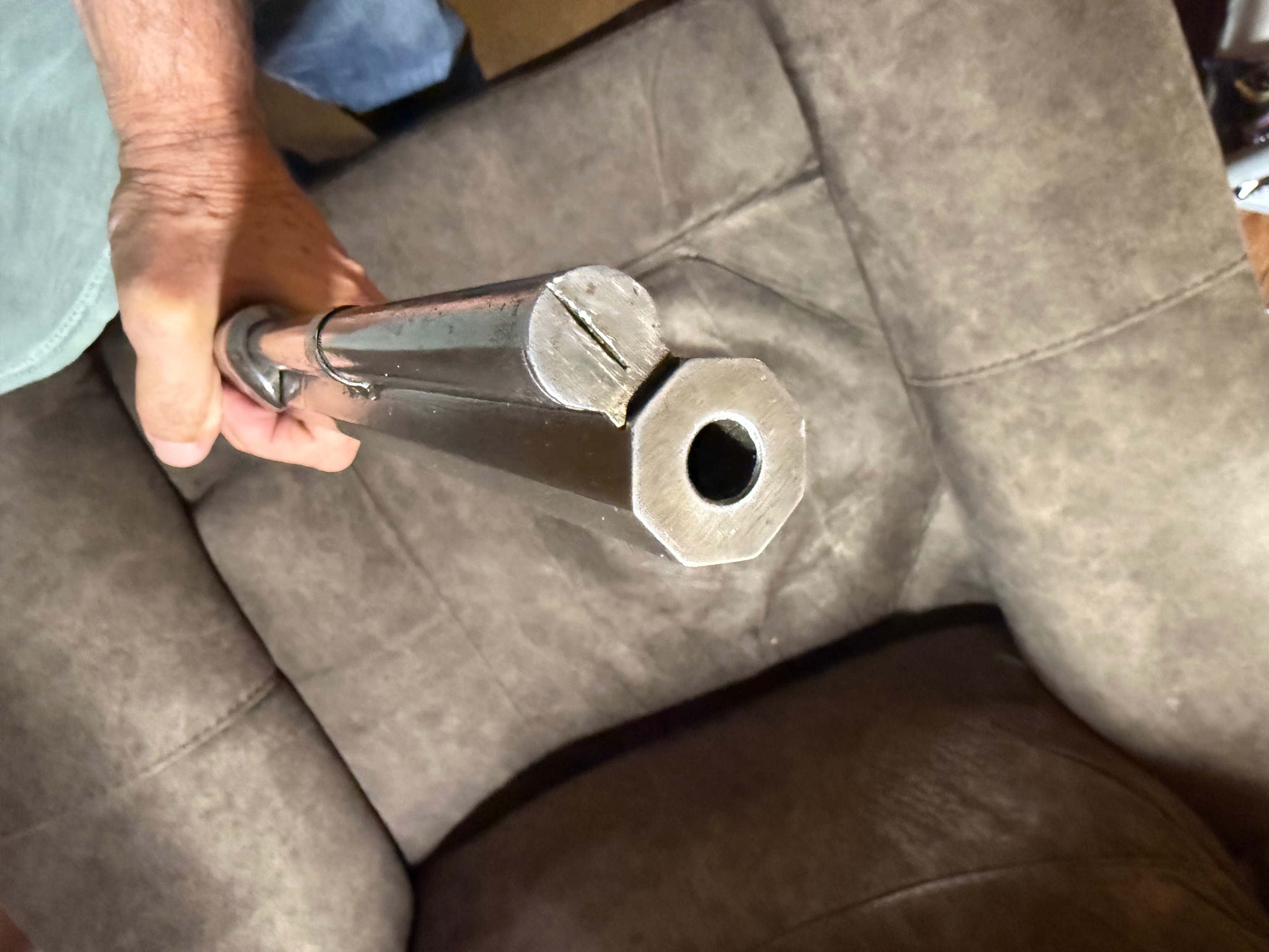

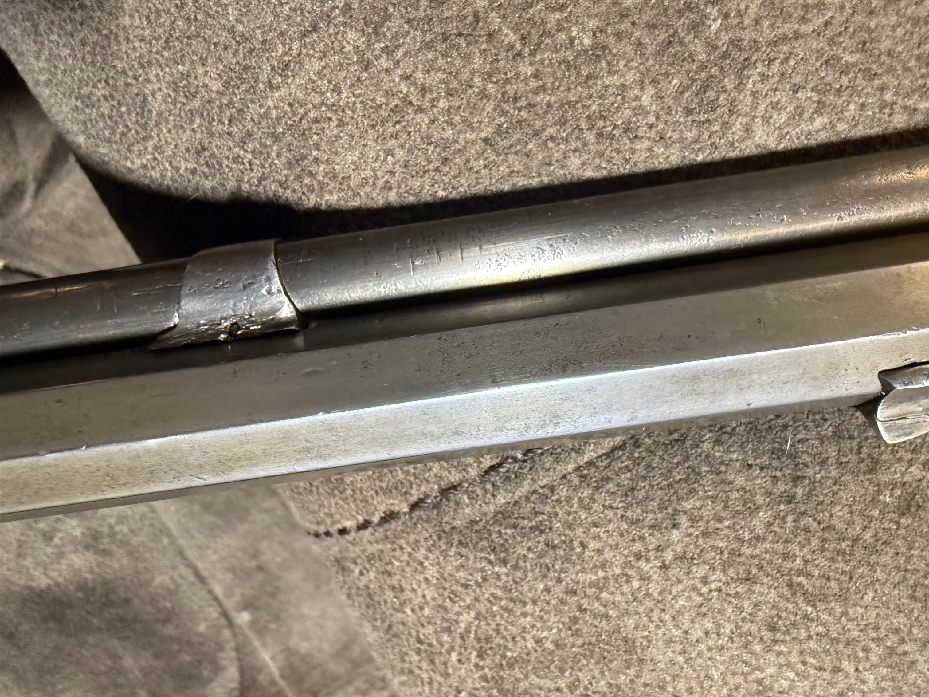

August 2, 2026 - 2:41 pm

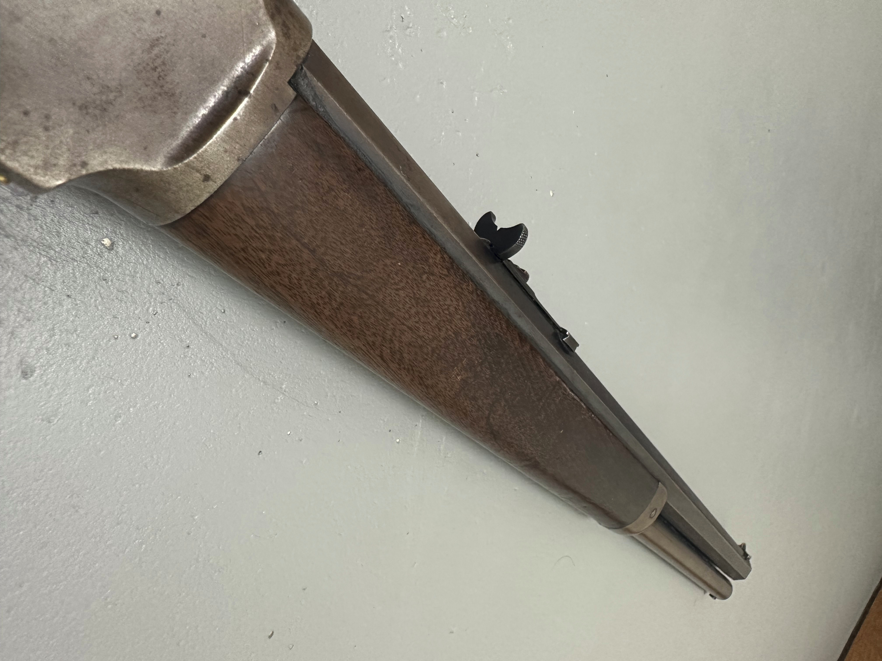

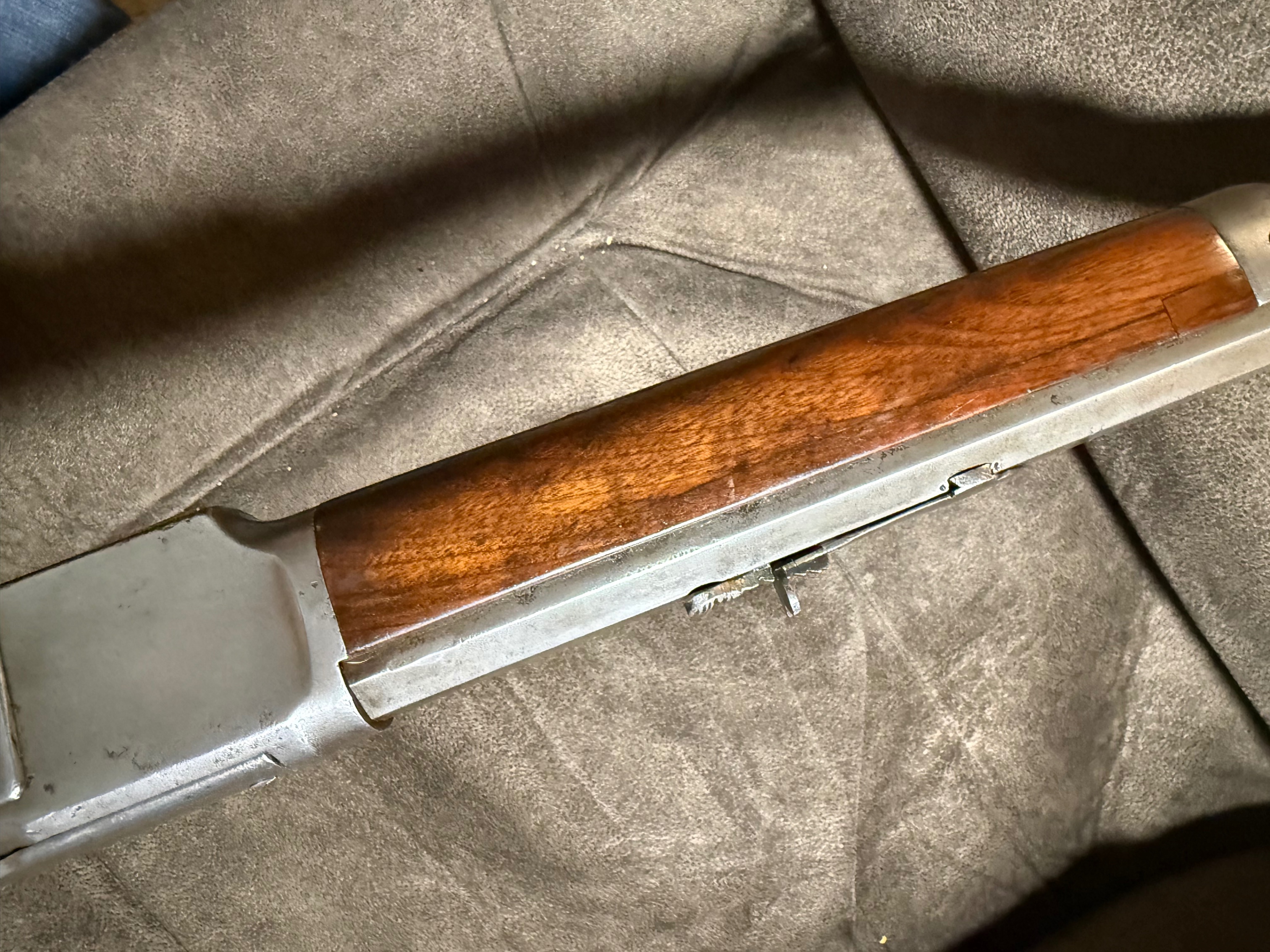

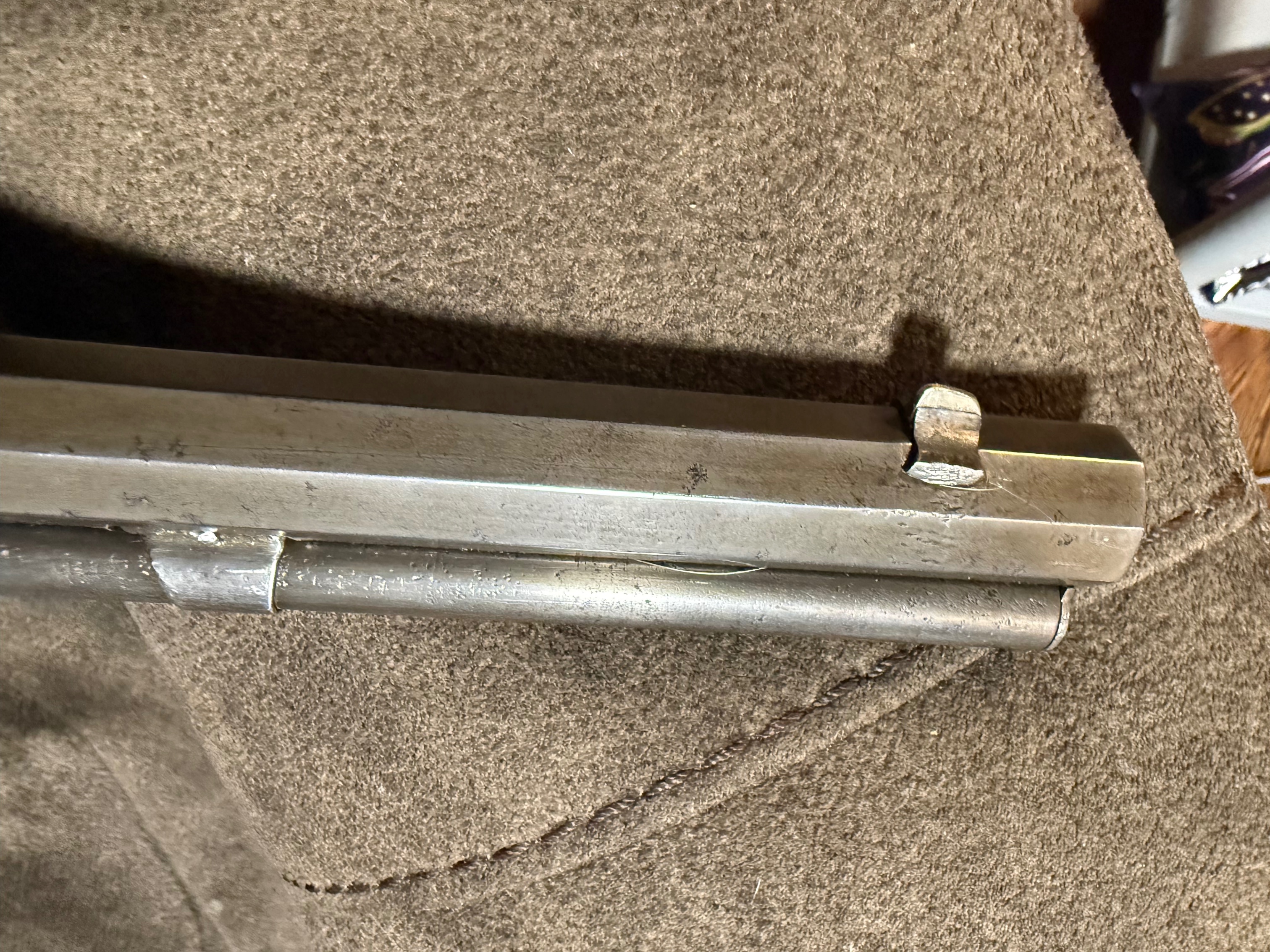

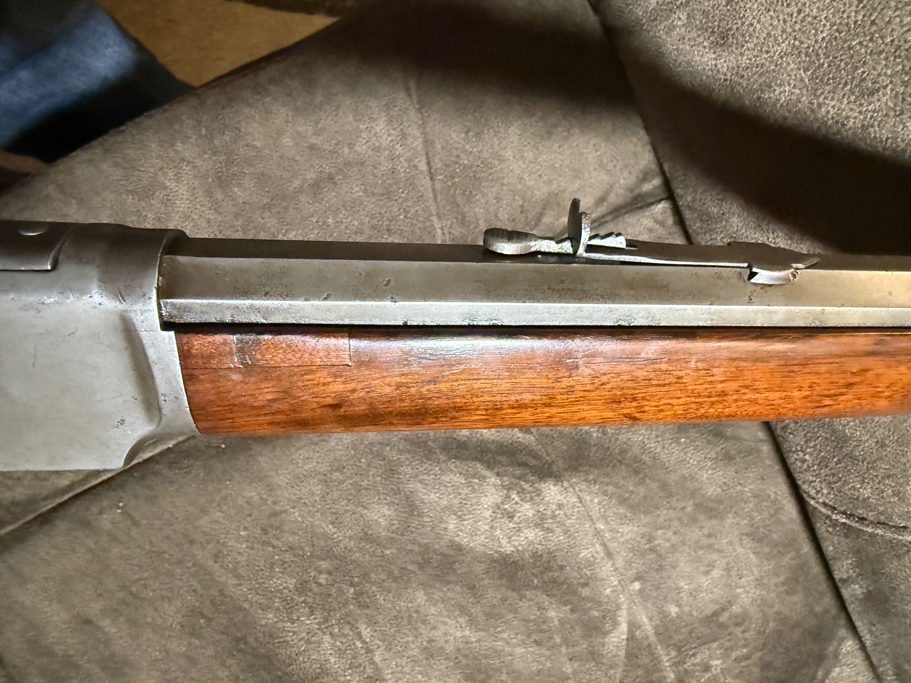

IMG_8392.jpegIMG_8389.jpegIMG_8390.jpegIMG_8391.jpegIMG_8388.jpegIMG_8385.jpegIMG_8384.jpegIMG_8383.jpegIMG_8381-2.jpeg

August 2, 2026 - 6:04 pm
I would say the barrel was bobbed from the big chamfer in the ID and the saw marks. The dovetail for the mag tube band is not factory. Wrench marks on the breech flats.

August 2, 2026 - 6:21 pm
This gun was aggressively cleaned by someone – even to the point they might have used a power tool – marks all over gun
