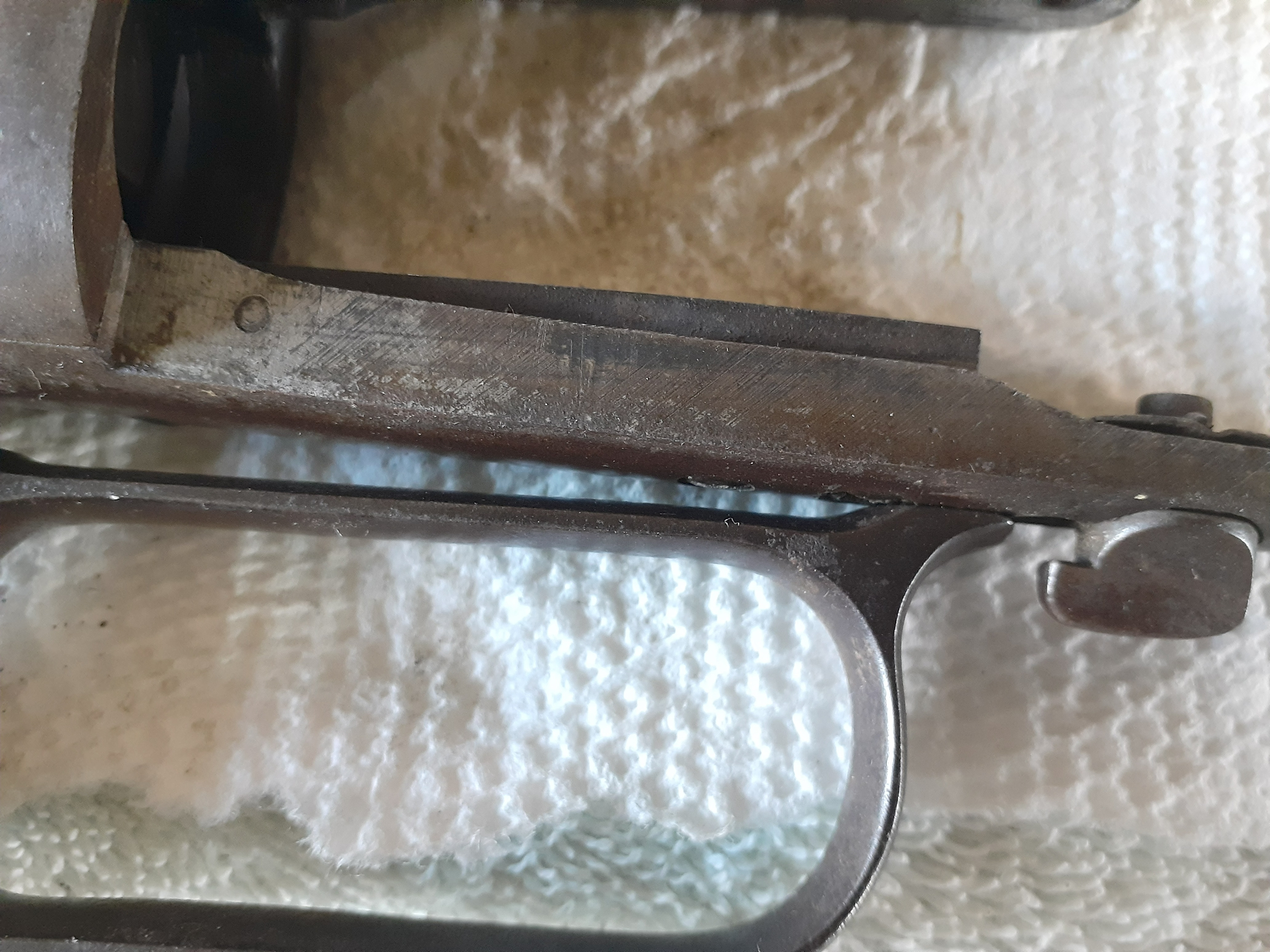

Right now I have a problem, and am hoping for some guidance on a second model ’73 in 38 wcf. This rifle came to me with a lever that when fully closed, does not reach the “catch”, as it falls short by about an eighth of an inch.The action felt tight and operates as it should, and my mind went to several scenarios as to what would cause this.
– (1) extended flat piece on rear of lever had been broken off a bit then smoothed down, causing it to be too short, (2) lever had been replaced perhaps with one that just wasn’t right for the gun, (3) lever could be bent slightly which causes said shortage. I research best I could online (including this forum) and found nothing conclusive, so I purchased a vintage and correct (from same 2nd model sn range), and this lever is the exact same dimensions visually.
So, I’m now back to square one but inclined to think the lever is not the problem.
I don’t see any apparent adjustment in positioning of the catch itself. Perhaps there is adjustment in how the lever rests horizontally or maybe a weakened spring that affects same? I have to figure how to get these two parts about a quarter inch closer together. See pics… Thoughts anyone ?

Welcome to the forum, Post a picture of the entire lever from the side with it in the closed position. It looks like the lever is bent.

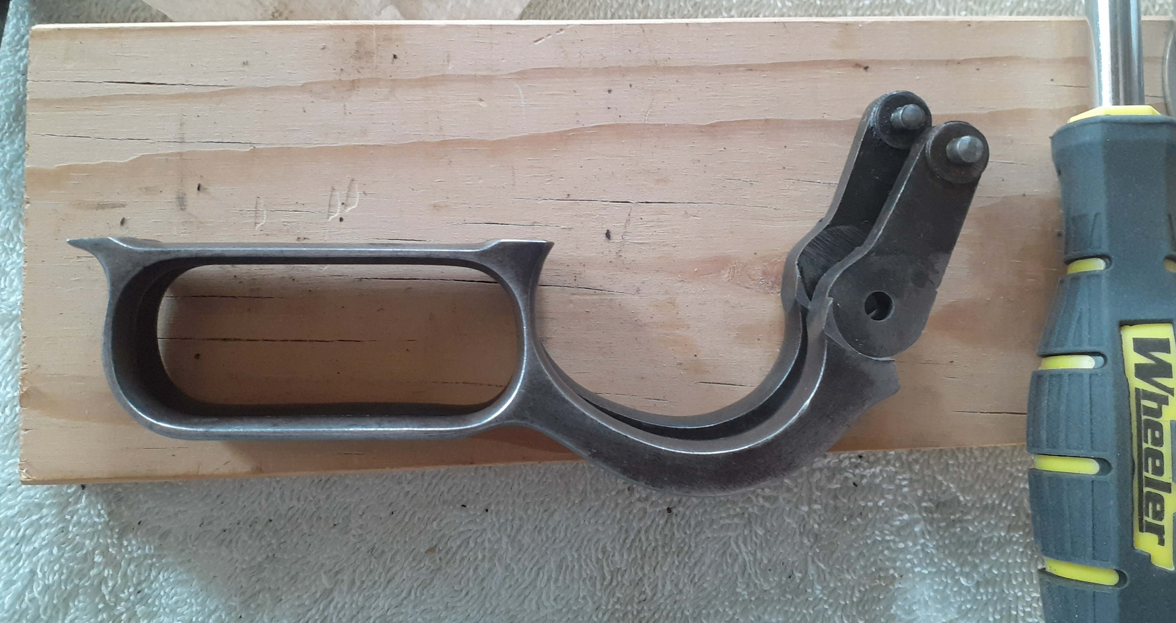

What I did not mention on my original post is that the pin for the lever was (is) seized, and I could not get the lever out… decided not to bang on it anymore (well supported with stack of washers underneath as to not bend the frame) after soaking in Kroil for 3 days. But, I decided to pull the screws to remove the lower tang then wiggled it down a bit and the lever came right out seized pin and all. The replacement lever pin is seized in there as well, but no problem the replacement just dropped right in.

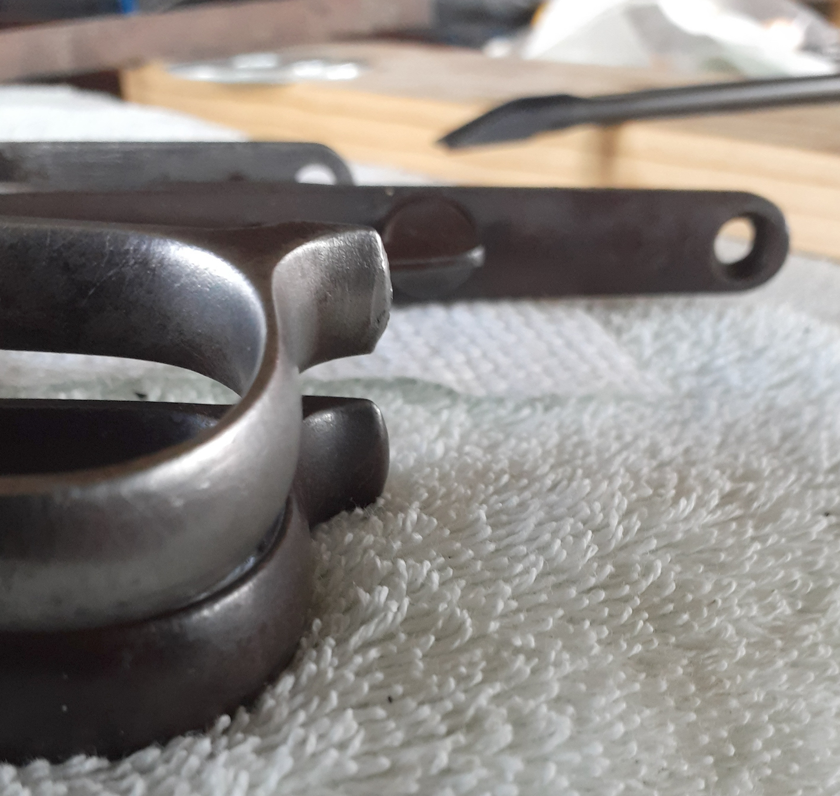

So with that said, the pics I posted were the original lever still in the gun, and the replacement lever setting on top… appearing to me to have no bend (all I based that on was by visually comparing everything hanging below the receiver).
Now, when I had original lever all the way out I did compare them more closely and take some pics before installing replacement lever.
And you are right, that son of a gun was well bent / stretched…. orig lever on bottom.

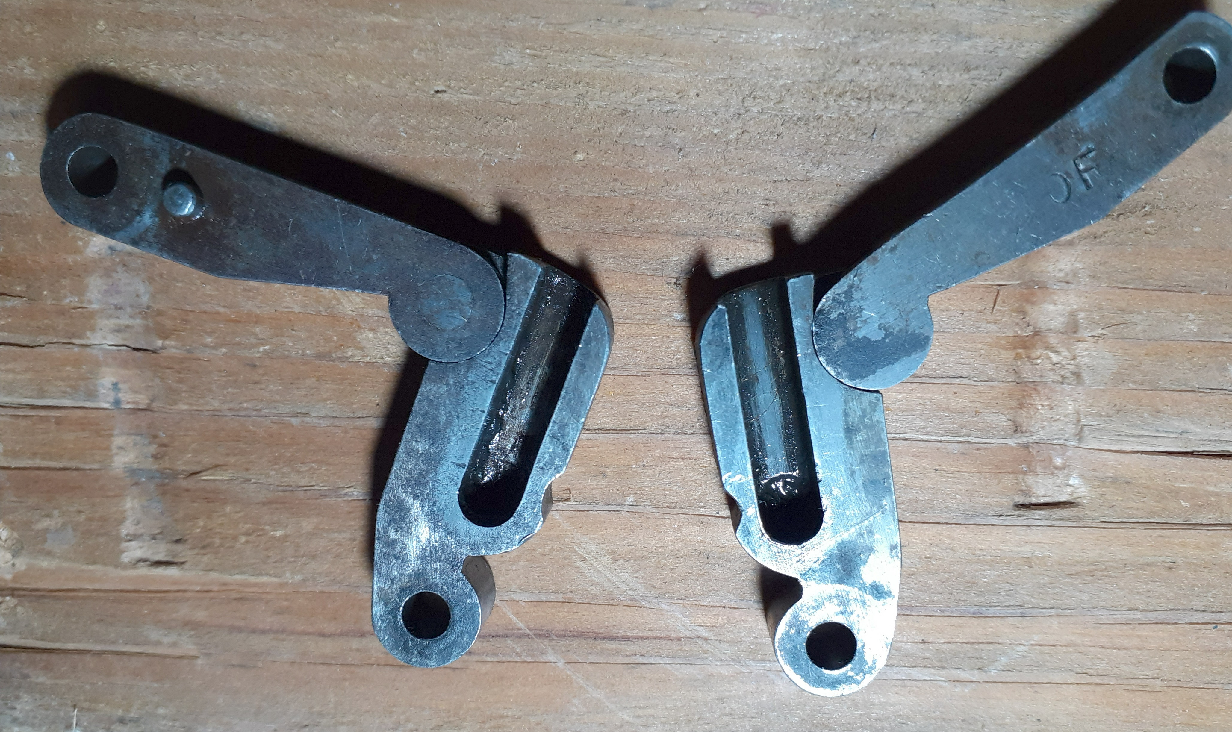

Toggles don’t look modern and I think are original, I figure hammer / mushroom effect.
I went ahead and took the lever back out of the gun and brought the lever and both toggles to my shop to do it right, in a vice.
Knocked mushroom off both ends of the pin and left a very shallow bevel with dremel, then started filing with fine diamond coated file.
The pins (.182) are still to big to go into the toggles (.145), so previous owner must have really took out some pinned up anger with that hammer.
I’m working them down slowly with the diamond file to end up with a nice smooth (and round) snug fit.
Wouldn’t think someone hammering them even that much wouldn’t fatten em up that bad, but I can’t imagine why else the size mis-match, unless the toggles are indeed modern production… but they do look old to me.20260422_204744.jpg

I’m wrestling now with the idea of drilling that pin out (or press it out) and order a new one, verses spending what will likely be several hours filing and hoping they end up true enough round (unlikely) when I’m done, and possibly end up compromised structurally.
The things we do as a labor of love for these old riflesEmbarassed
Forum Posts: 5014
April 23, 2026 - 3:47 am
The next step to get the pin out is heat the end  and press it out. My guess it was sweated in. The pin is slightly bigger than the hole in the lever. You would heat the lever and cool the pin and press it together quickly. They probably had a jig that had a hole the correct depth so the pin could be pressed in to the right depth in one motion.
