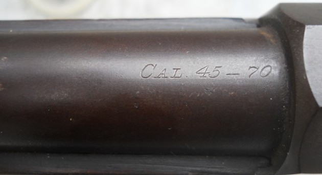

RIMG3830-Custom-2.JPGRIMG3831-Custom.JPGRIMG3832-Custom.JPGRIMG3833-Custom.JPGRIMG3834-Custom.JPGRIMG3835-Custom.JPGRIMG3836-Custom.JPGRIMG3837-Custom.JPGRIMG3838-Custom.JPGRIMG3839-Custom.JPGRIMG3840-Custom.JPGRIMG3841-Custom.JPGRIMG3842-Custom.JPGRIMG3843-Custom.JPGRIMG3844-Custom.JPGRIMG3845-Custom.JPGRIMG3846-Custom.JPGRIMG3847-Custom.JPGRIMG3848-Custom.JPGRIMG3822-Custom.JPGRIMG3823-Custom.JPGRIMG3824-Custom.JPGRIMG3825-Custom.JPGRIMG3826-Custom.JPGRIMG3827-Custom.JPGRIMG3828-Custom.JPGRIMG3829-Custom.JPGWould like some advice, your thoughts on condition, originality, price, on this rifle. It has a letter & 45/70 ser #737, round barrel. plain trigger. Received in warehouse on October 28, 1886.  I hope I have enough pictures for you to judge by. Would upload more of something if you need. It is not mine, but considering buying it. Thanks in advance, Rick

The photos are too small to tell much. A lettered, 45-70 caliber super low serial # 1886 is very desirable, however the stocks have been sanded as indicated by the tangs/receiver being substantially proud of the wood.

Agreed! Wood is refinished.
Also, early 1886’s had calibre markings in italic font, a carryover from the Model 1876. Not sure how long this was done, however, so calibre markings may or may not be correct, which may, or may not, indicate a replaced barrel.

$4K is too much.  In addition to the stocks being sanded and refinished, the barrel & magazine tube have been reblued.  Additionally the sights do not appear to be original, and the elevator for the rear sight is definitely not correct.

One of my issues with the photographs is that there was no really good photograph of the rear sight. Some of the early 1886 rifles contained a ladder sight marked ‘1876’, as these were initially manufactured for the Model 1876. Beer, any ideas as to what serial number range this and italic calibre markings ceased?

I do not know the answer to your question as it pertains to the Model 1886.  I can tell you that for the Model 1885 Single Shot, the italic caliber markings were used as late as December 1886.  The attached picture is a Model 1885 that letters as being received in the warehouse on December 11th, 1886.
